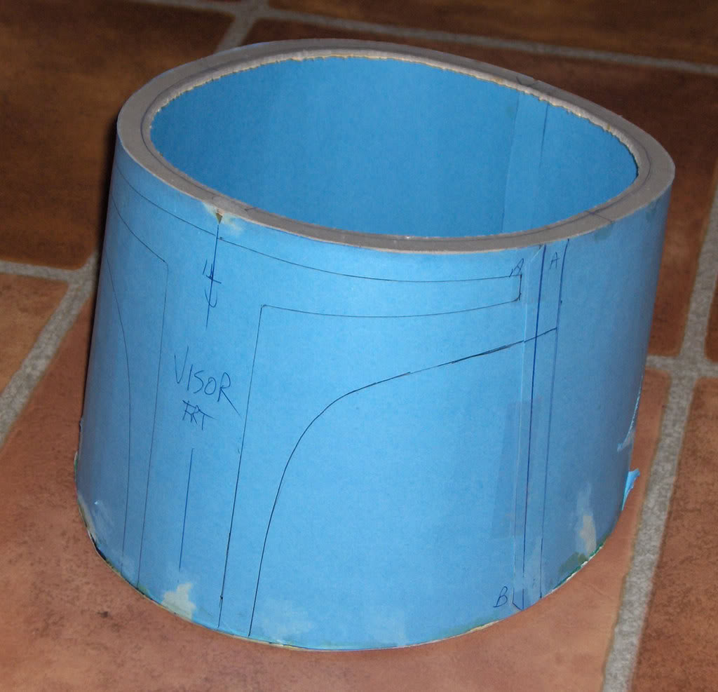

To clarify real quick, Sintra isn't styrene. Sintra is PVC. Beautiful job on that bucket so far. What did you use for the dome? Or did you scratch build that from the WoF plans too. Keep up the progress pics.
Thank you telling eighteendelta ! And I always thought Sintra is styrene, honestly I never heard the word Sintra before :o. Is it a another brand?
The dome is also scratch build and of cause with the help of the WoF templates. His work is so great ! I build the dome out of thick paper and laminated it from inside. More will come later :)

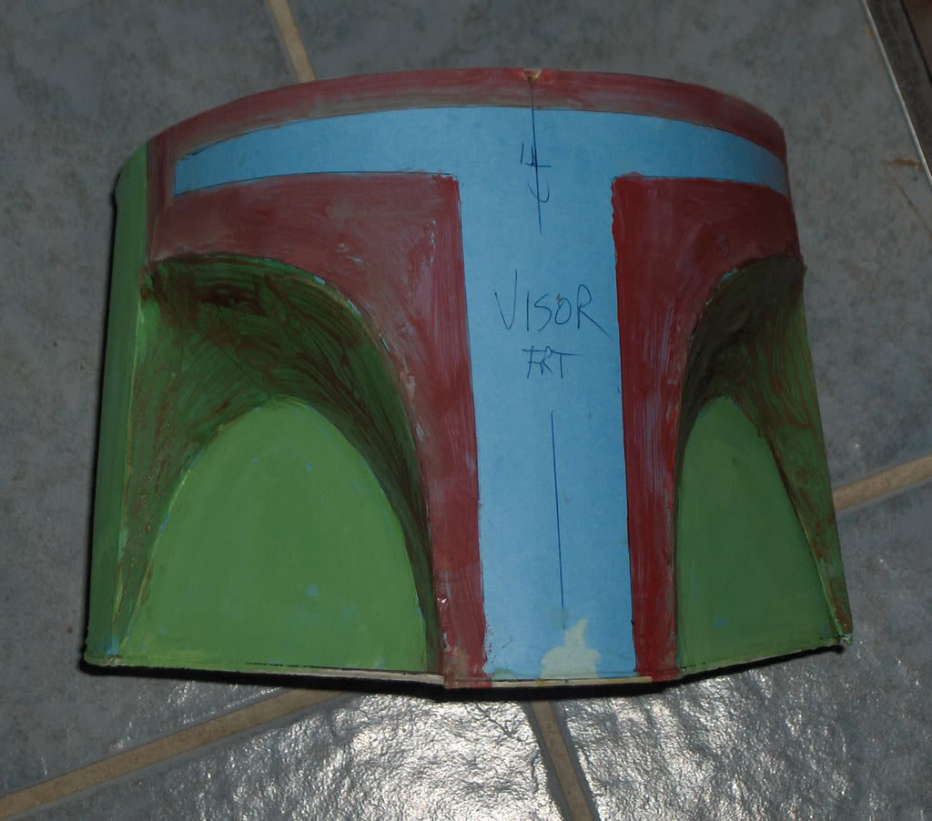

Been working with these templates in paper for the moment and I notced that a some peoples upper cheek pieces have a definate fold running diagonally at about 45 degrees from the top corner to the middle whilst some don't. Is there any reason for this? Is there supposed to be a fold?

Yes, there is, because of the plastic is much stiffer than paper, so the easiest way is to make cut at the most stressed areas. This corner is a real pain without beeing cut. After cutting you have to use putty to make it smooth again.
In the pictures you saw my helmet before, that was without the smoothed corners. Tomorrow I will have pictures of my bucket olmost done in its shape.

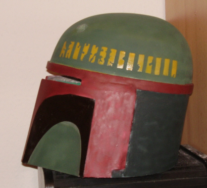

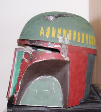

News from my scratchbuild:
After a coat of primer
and airbrushing (the killstripes are painted)
I´m beginning with the stencils.
They are a mix of painting and scatching.
How is it so far?
Criticism is really welcome!!!

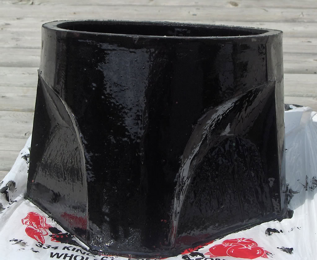

Just wanted to jump in and say I've started assembling my bucket from these plans. Not very far along yet. Still have to cut out the cheeks and insert the inset pieces. I used the plans as they were, just a tad small for full size perhaps... but I'm not very big myself, and if I want to wear the thing then I will pro'ly stick with this size. Maybe, if I get brave, I'll make a second one a little larger. Who knows.
Hope mine turns out as nicely as all these ones are coming along.
::Edit::
Now I gotta find something to use for the dome. I have something on hand, but I would have to alter it. I'll look around a bit more before I cut it up.
::Edit::
Well, no dome yet, but I had just enough resin left from my Vader project to coat the inside/outside of my construction. The main part of the helmet is bristol board (poster board - whatever), while the top and bottom rims are a much thicker and stronger cardboard - think of the stuff they use for backing on a really sturdy watercolor painting pad. The flat parts of the cheeks are also a heavier card than the rest of it. Looks kinda gloppy, but once it's fully set up I can start sanding it down and smoothing it out.
