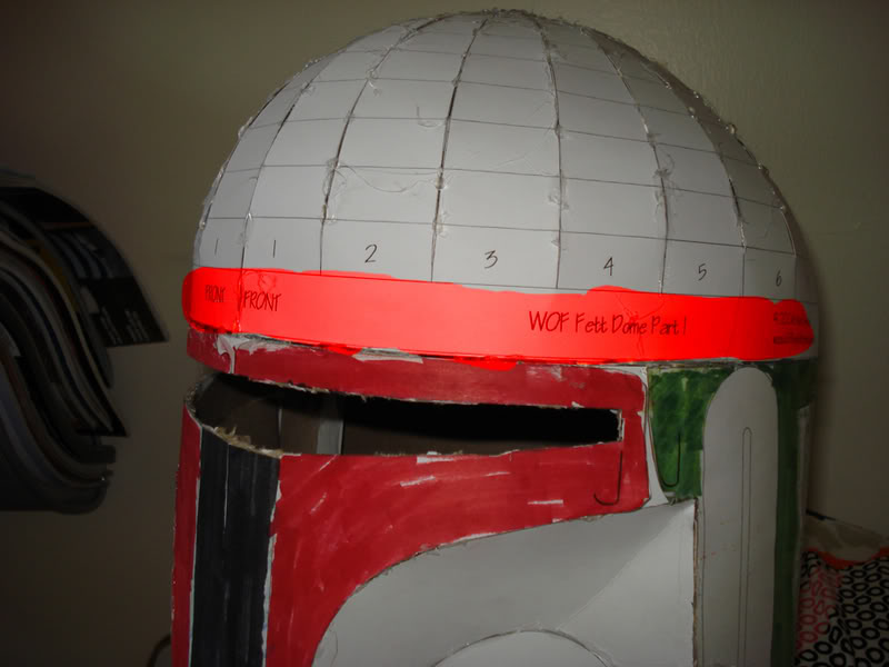

I've got some progress, and some questions. First off, I'm wondering if I was supposed to cut of the area of the dome that I highlighted in red. It seems too tall, and that's a problem. Also, is there any way to get rid of the point at the top of the dome? After I put bondo on it and sand it off I'm sure it will look fine, Just wondering if there was a way to get rid of it before that.
Also, any input from you senior TDH members? As I said before, this helmet will be far from perfect, But I still want to make it pretty good, so any advice will help. Thanks guys.

Yes, cut it off but only what you need. The amount to cut is relative to your material thickness, so cut some and check it out before you glue it. To get rid of the point at the top of the dome, you can glue a round piece of cardboard to the tips of the triangle shaped pieces. That will pull them together and eliminate the point. Or you could make the point end of the triangle sections the center of the pattern. It would end up looking like fan blades. If you do it this way, do it in 4 sections. Below is what I am talking about.
When I made mine, I too noticed that the dome is too tall. I printed my templates at full size ( 100 percent ), and I removed 5mm from the bottom of the dome. It looks pretty darn good now.

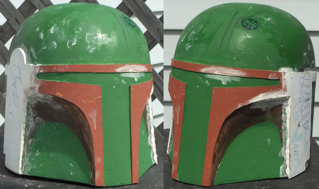

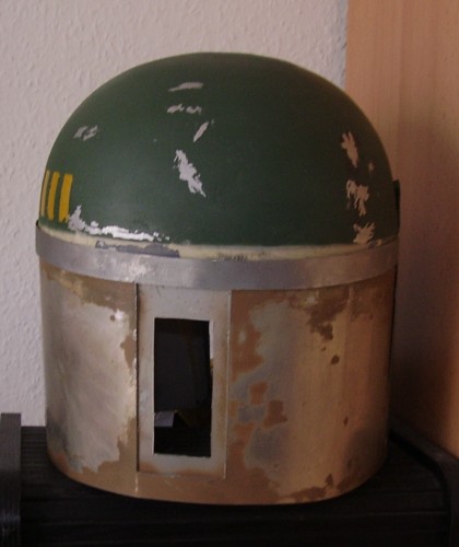

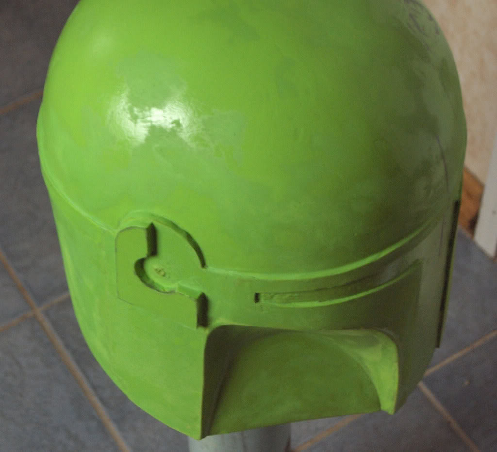

Put yer sunglasses on. Sorry about the offensive colour... it was all I had on hand to seal the surface with. Anyway, just thought I would post another couple pics. I wanna tell ya... cutting out those slots in the keyhole jobby was tricky. By the way, I found a piece of plastic pipe of just about the same curve as the inset piece. I cut it from that and then just glued my heavy paper cutout of the "slots" over it. I intend to use it as a guide for cutting them out after it is cast in resin.

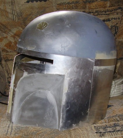

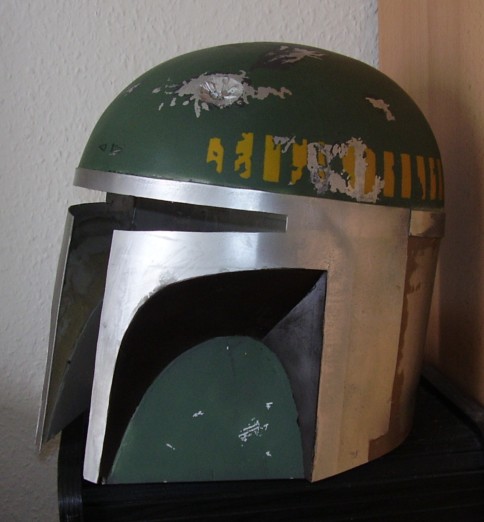

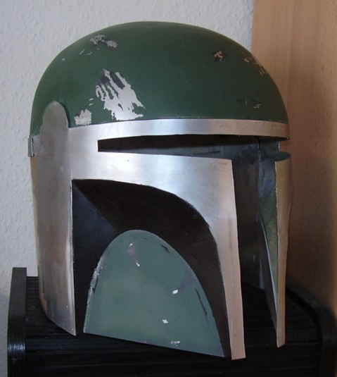

Hi!
After I wasn´t satisfied with my first helmet, I´m making a new one.
For the dome I used another skater helmet which I trimmed like the baseball helmets.
For the rest I used aluminium sheets 0.8mm thick.
Only the upper cheeks are made of 1mm sintra.
-Thomas
