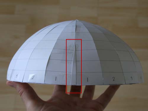

For the dome I did built a little extension first to compensate the very little size difference...
..but later on I decided to build a new dome from clay (I made some mistakes building the first from paper). By the way Alan, it's almost done! Picture will come up soon!

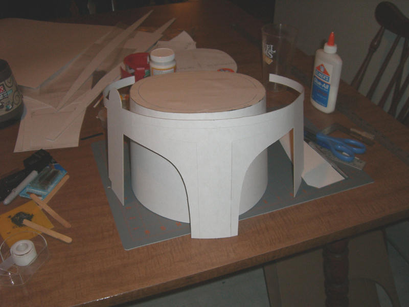

One sheet of matting board and a few hours later...
My only regret is that I have to get some sleep and won't make any more progress tonight. :lol:
I guess the big question now that I've started is, will this end up as a Boba or Jango? Hrrmmmm....
