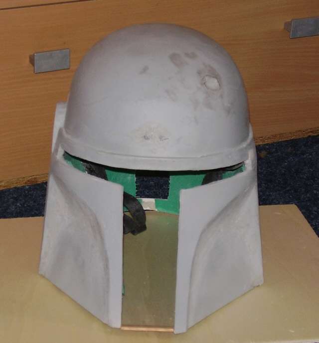

Look here are some photos.
I will start a new scratchbuild thread shortly, maybe you can adobt some things. I learned a lot from SD68's scratchbuild thread, look here :

Chris...thanks for the pics... those cheeks look sweet! You make it look so easy....and I'm doing 3 pots at once, so I wanted to make it as streamlined a process as I can...please, post your tutorial/thread as soon as you are able...I'll be eagerly awaiting it!

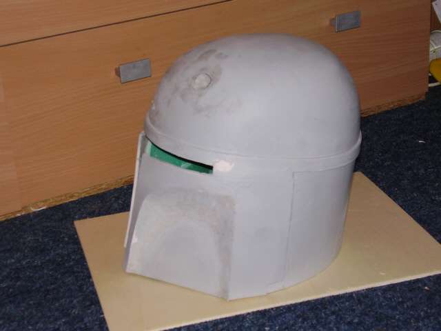

new pics of my "Skater helmet"
Here are some new pic of my scratchbuild helmet using a skater helmet for
the dome.
Hope you like it.

Yesterday I start detailing the cheeks, the photos you saw before was right after glueing and a little bit of sanding.
I think a good way maybe is to cut the 2mm sintra cheeks in ,say 6 pieces. I made 4... You cannot bend the 2mm stuff, so all you have to build is a n-gon. The rest does the putty...

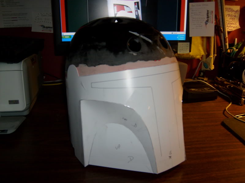

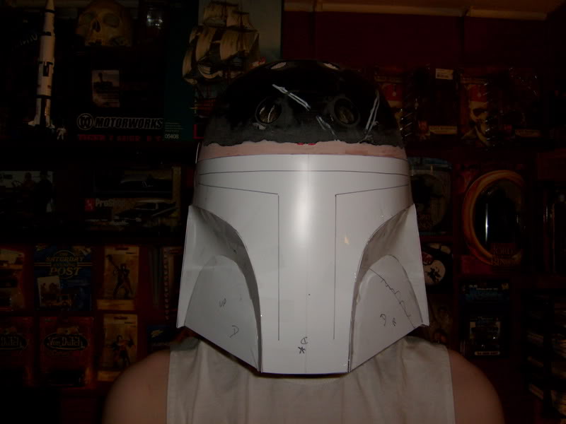

Here's a pic or two showing the fit of the cheekbones without having to cut them...these have been taped on; tomorrow I will glue them in and shape them a little better....but hey, Alan's templates are the bomb! :thumbsup:
Rob
