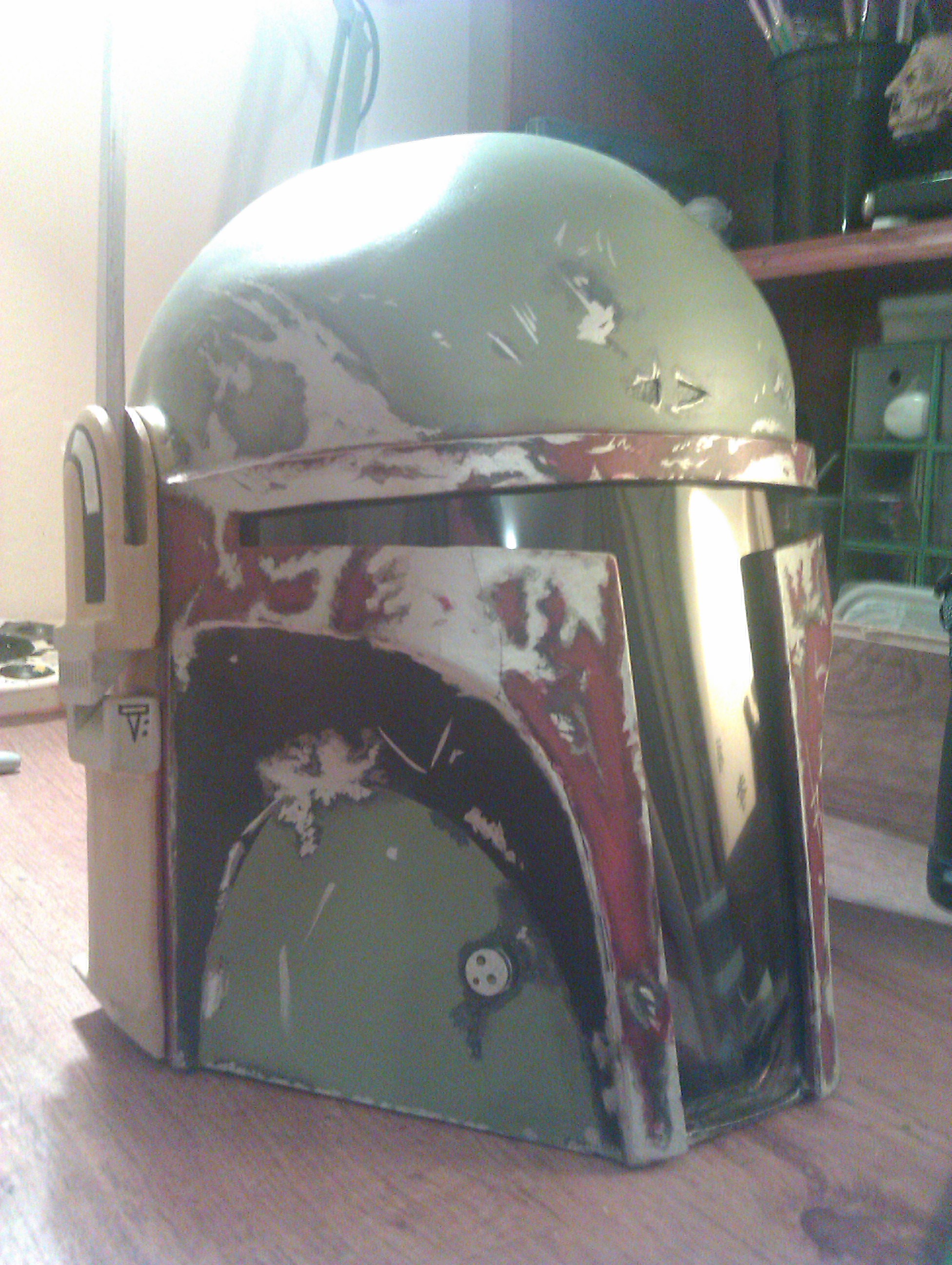

hi

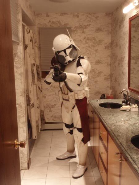

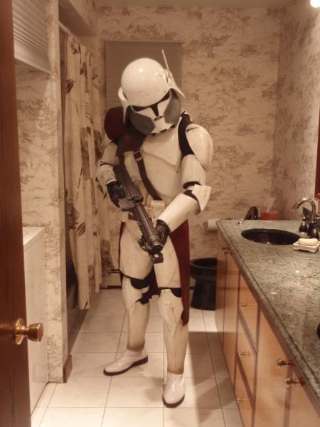

im new on this site, but i just wanted to say thankyou to you for your great templates.
over the past 2 years ive been putting together my scratch built mando armour and your template was a real life saver. I went to Star Wars Celebration Europe and got some real compliments.
so thanks againView attachment 101840View attachment 101841

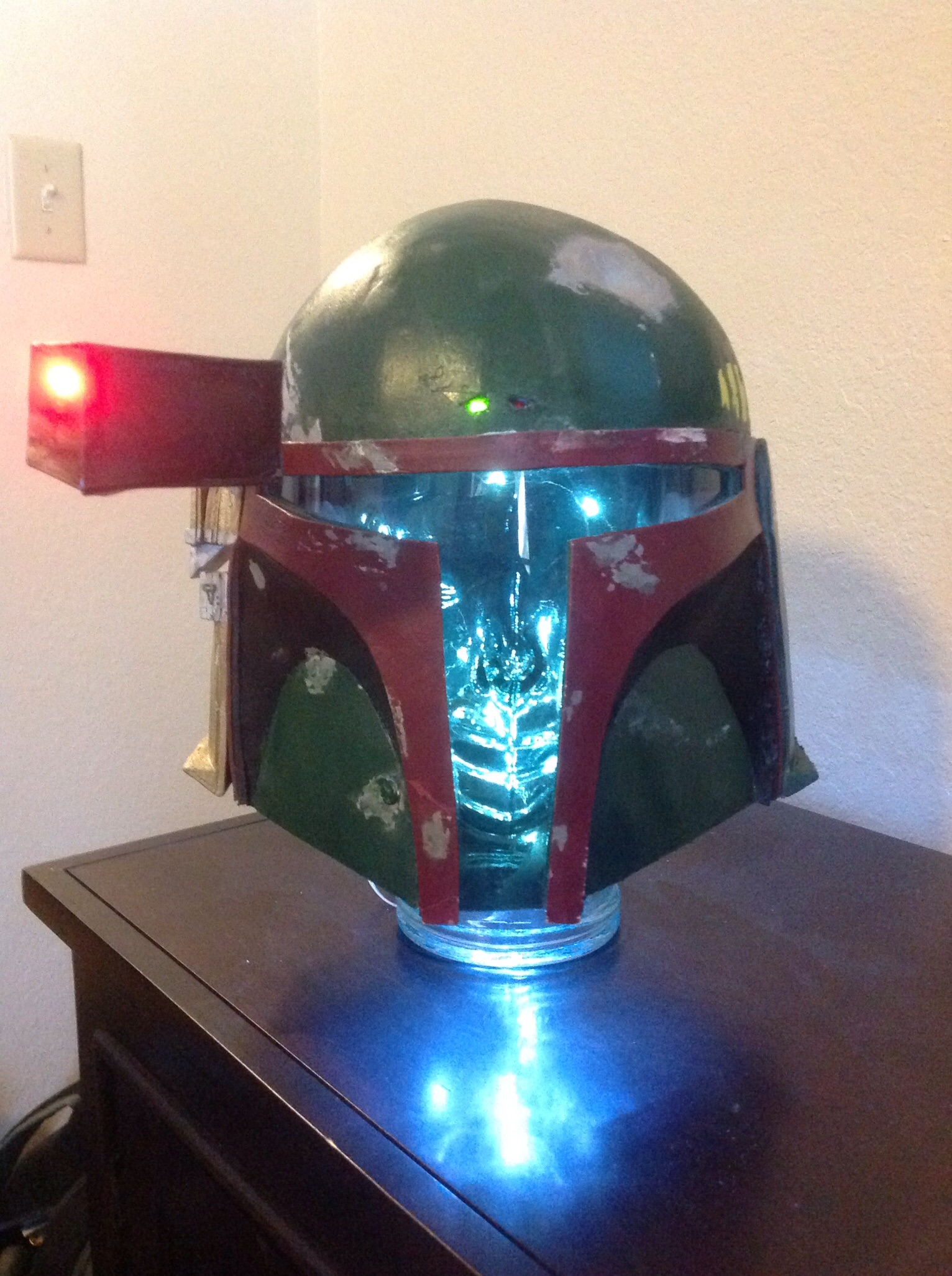

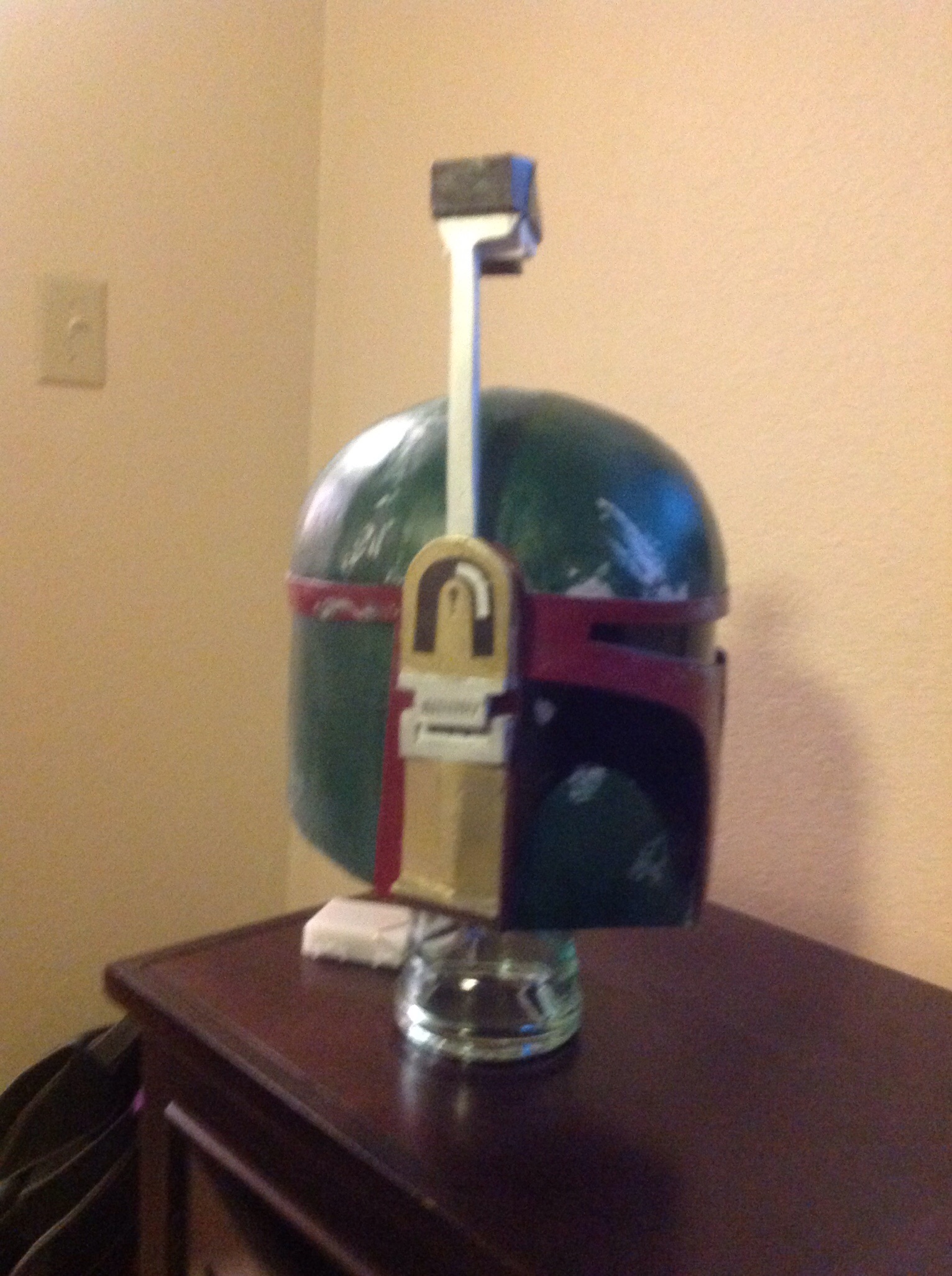

Thanks for the templates and this great site (The Dented Helmet) for all the great info to make this helmet. Made it from EVA foam and used other very useful INSTRUCTABLES for "How to paint a Boba Fett Helmet Using Spary Cans" and How to Make an Alternating LED Flasher." I placed alternating LEDs in the arrows at the top of helmet by makeing them in parralell with the LED's in the rangefinder. A separate LED was placed in rangefinder eyepiece to light up miniturized Star Wars "Stay On Target" targeting image. Use glass manequin head with it's own led's for holding helmet. I found it cheaper and easier to go to take apart cheap dollar flashlights to get off on switches needed for electronics. image.jpgimage.jpgimage.jpgimage.jpgimage.jpgimage.jpg

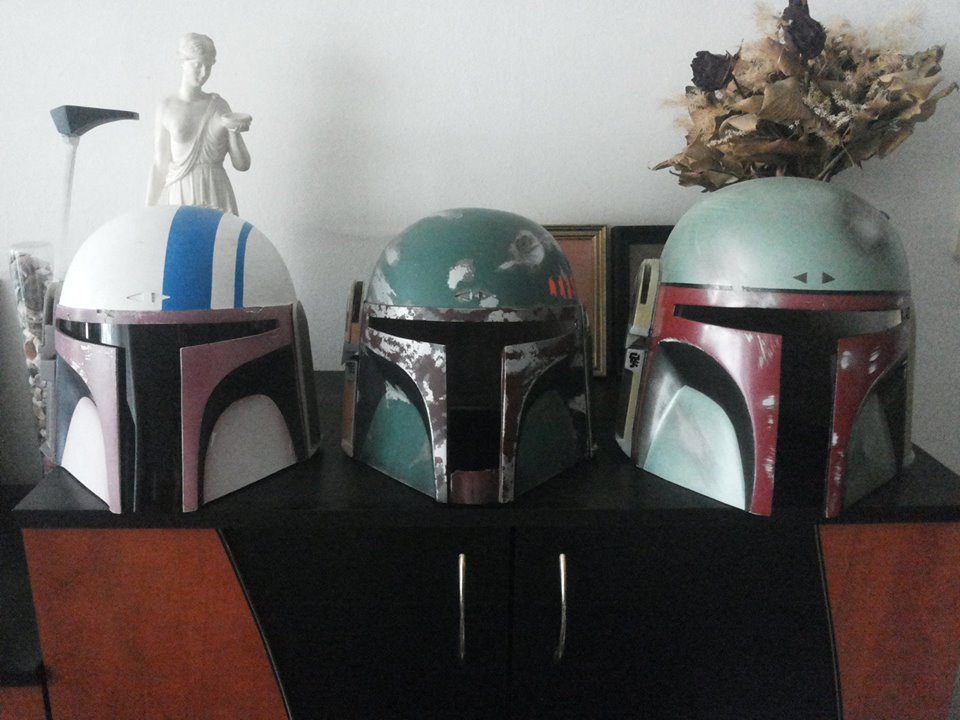

I've been lurking around the DH for years now, but I've never taken the time to actually thank you, WoF, for the awesome work on the templates! I made my first helmet based off of your stuff a long time ago, probably 6-7 years, but since then I've been procrastinating and tinkering with them until this spring when I finally made a legit Boba bucket, which I'm very proud of. Here's a pic of my new, finished ESB Boba in the middle with my custom mando on the left and my first mainly freehanded bucket on the right.
Kudos, WoF, you made this possible! :D

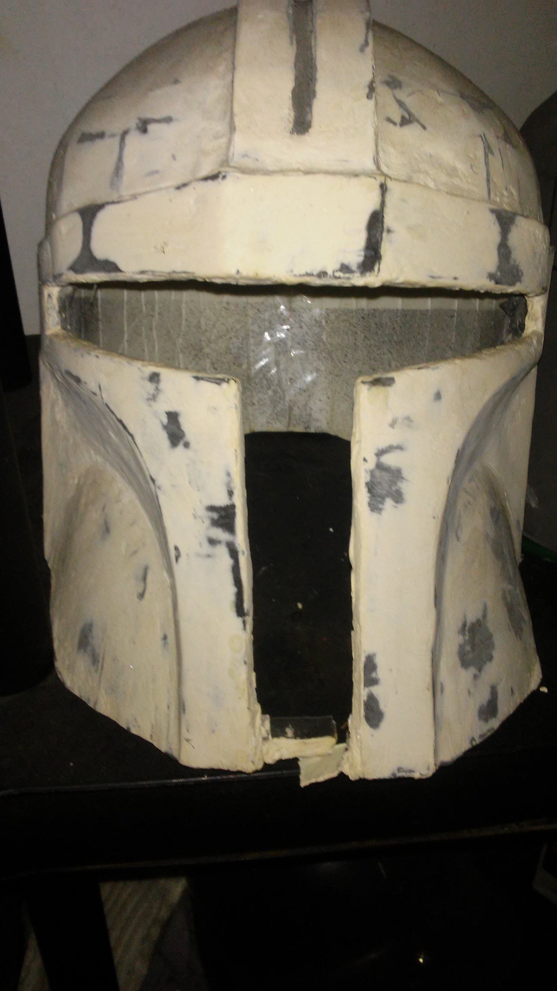

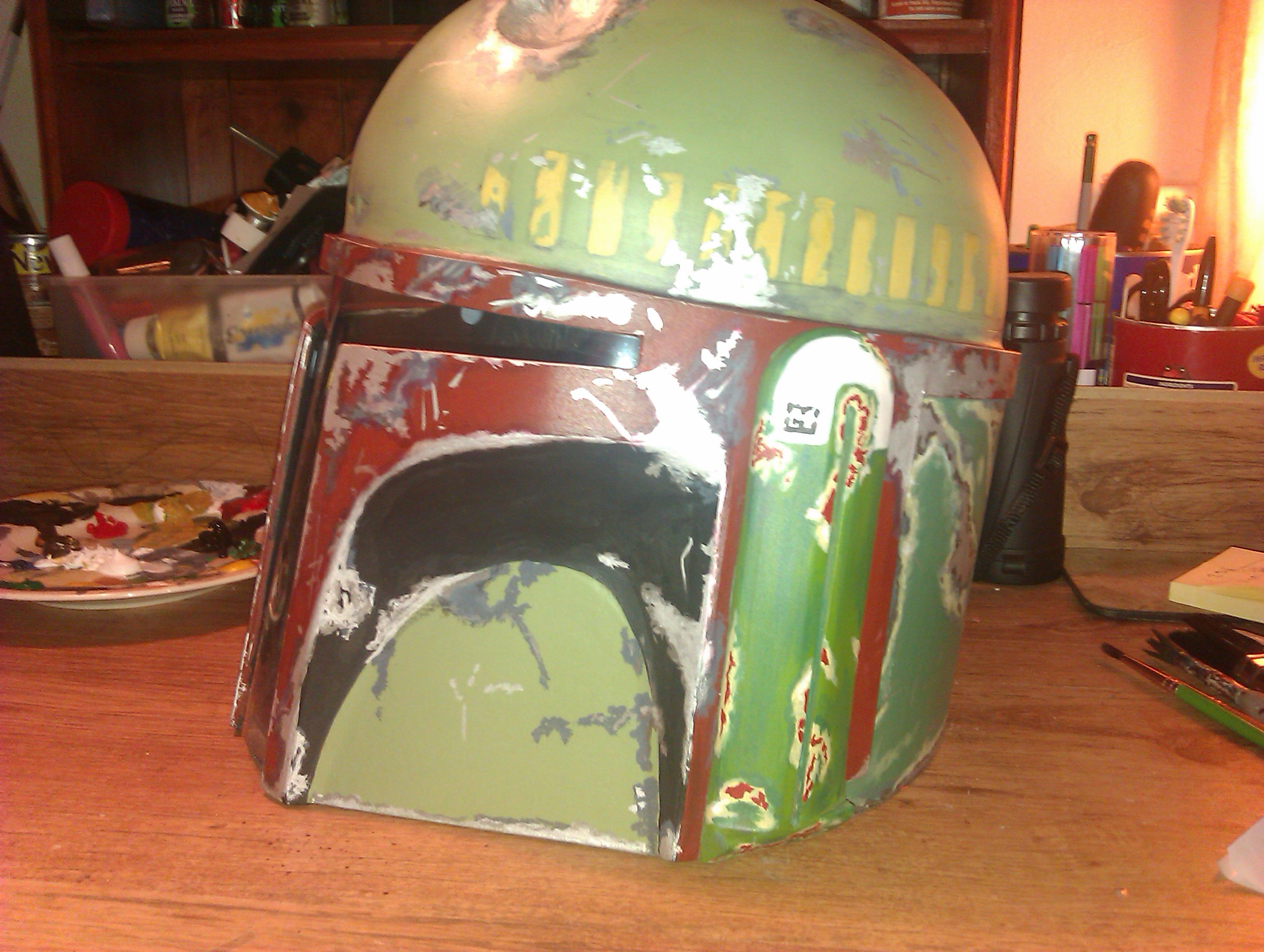

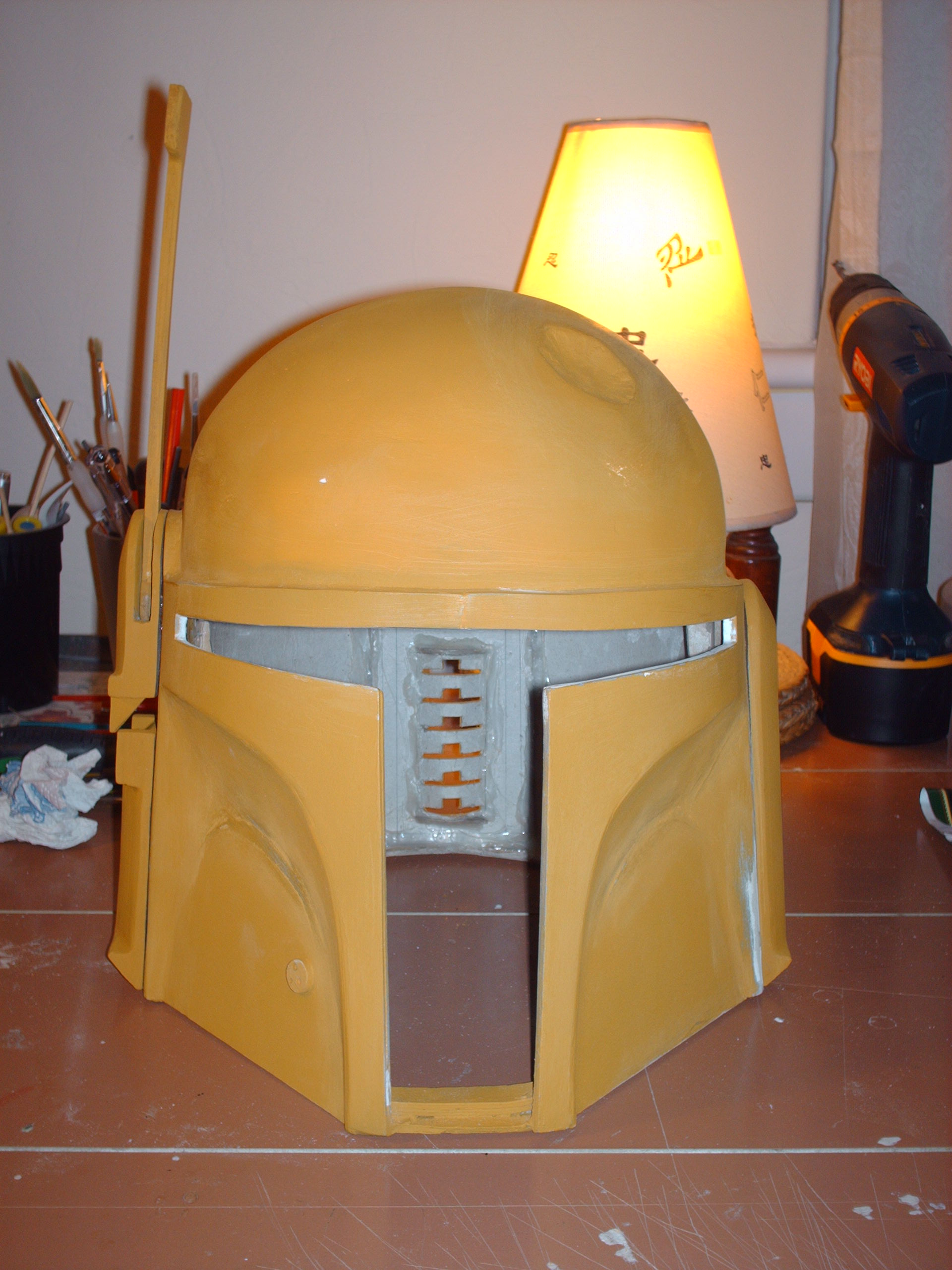

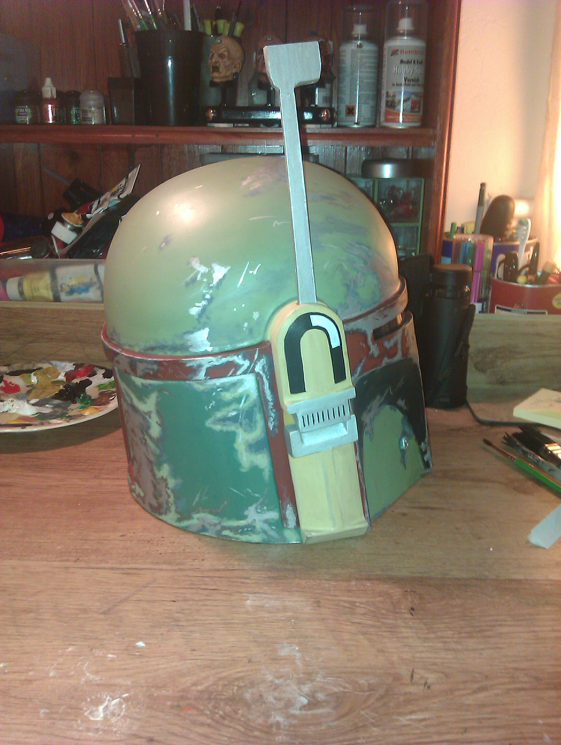

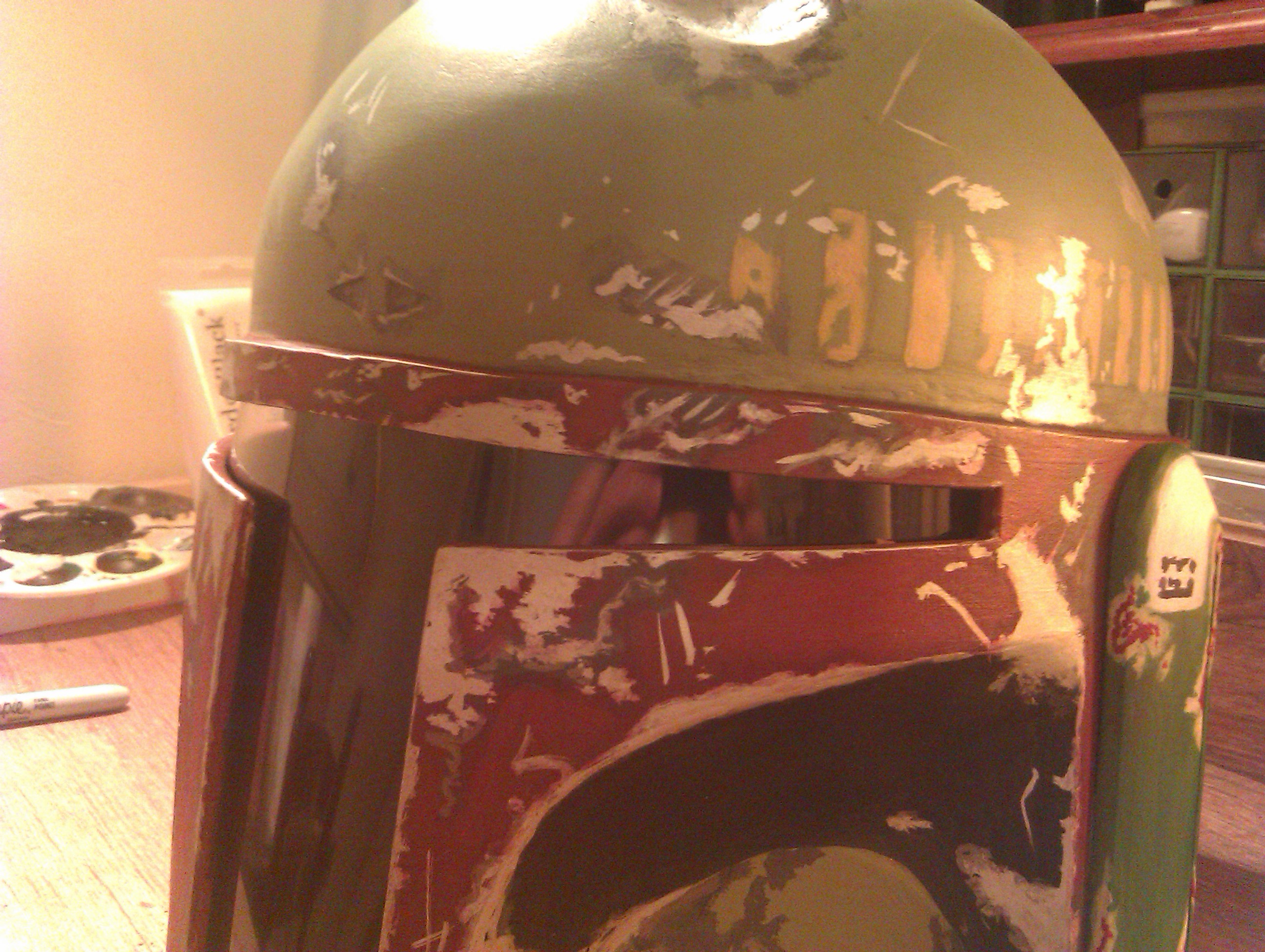

Beanster21, Did you use bondo and resin to get that nice smooth finish?
I recall it was Homebase's own brand tube of polyfiller. It's pretty much water based so I'd wet my hands when smearing it on. For the dome I used a Black & Decker sanding mouse. I remember the veranda looked like it had been snowing as I must've been over it at least five times. Inbetween drying times and additional coats of primer it took a while. The ear pieces were done by hand with sanding block........
Now that I think on it, it took absolutely ages...I'm going off the idea of doing it again.
Funny thing though, it sat with the base colours on it for about a year and then I painted it in the space of two nights in time for me mates's birthday, so always a silver lining. Speaking of lining, I couldn't find any smoked plastic in time so it's still got a piece of projector transparency in it for the visor.

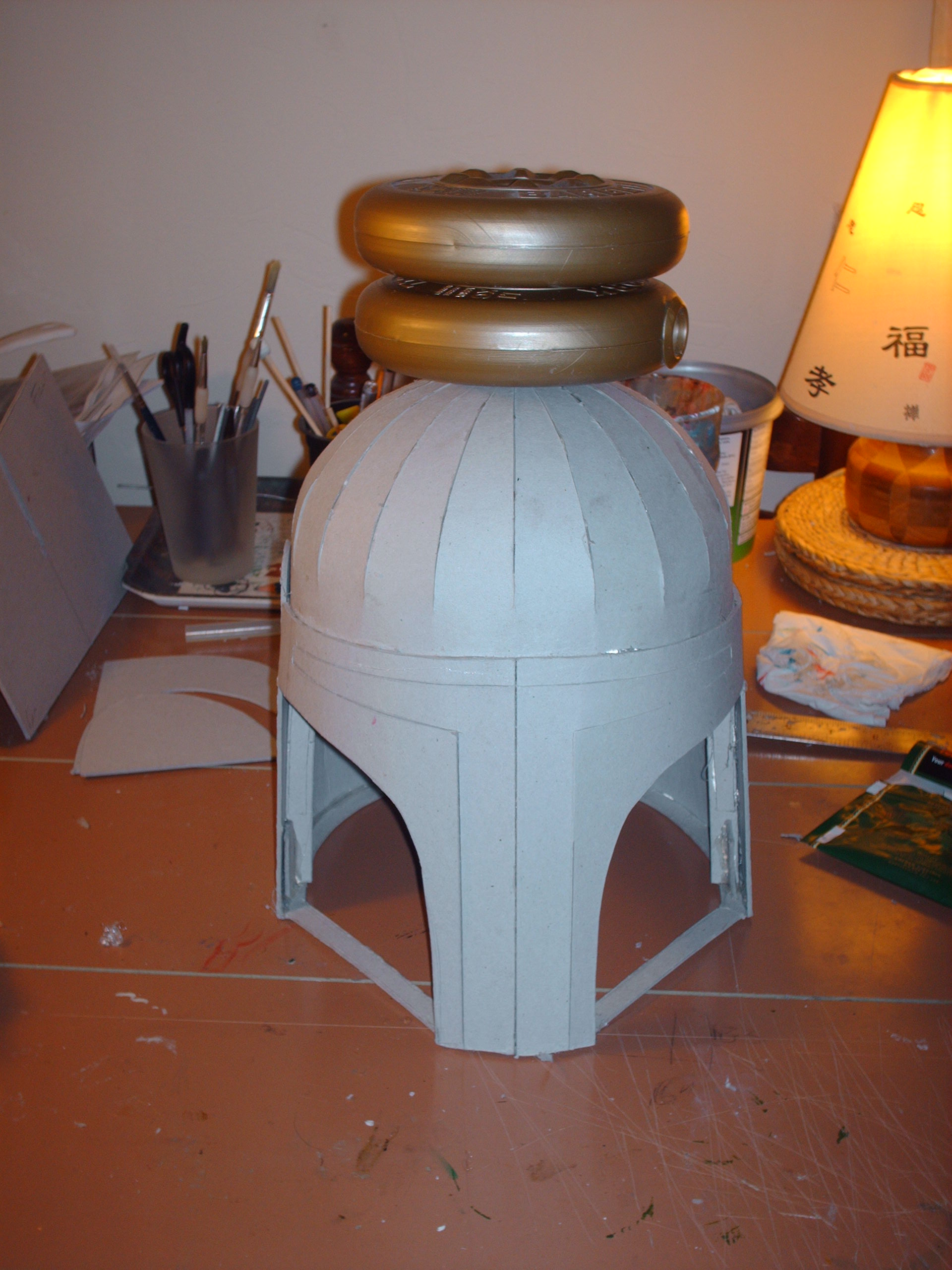

Hi, I'm just making my first greyboard helmet now (UK version of crescent board I believe) using the WOF templates (brilliant by the way :D). But I'm having trouble with the inner layer, I use the a4 templates and the inner layer doesn't fit my scaffolding unlike the outer layer. Am I missing something? As I'm sure the templates are fine and its just me being a clumsy Gungan. Any help is much appreciated :)
Check to make sure you accounted for the material thickness. You might have to trim the scaffolding. Let me know if there is anything else I can do to help
Needed to delete the message and write again, I made the scaffolding and have cut the inner/outer skins from paper but for some reason they don't fit? I'm using 2mm greyboard. I'm sure I've made a silly mistake just can't think where. The outer layer is just millimetres short whereas the inner layer is much smaller.
Are these templates for corrugated cardboard, non corrugated cardboard, or greyboard? Are some parts non corrugated or something? For example, what are the earcaps, topper, and stalkmade from? How will I run electronics through the topper and stalk?
Avoid corrugated cardboard, as its surface tends to warp when bent to shape. I only recommend to use it for the inner support parts, which you will discard as you advance in your build. Use 2-3 mm thick cardboard to ensure that all pieces will fit correctly.
