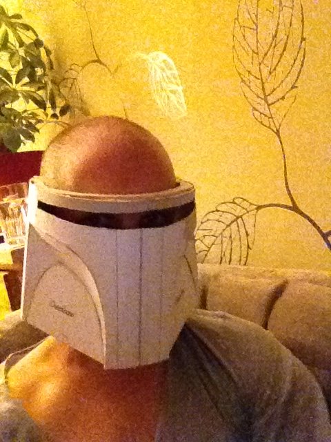

I started a paper template using the PDF's By WOF but soon realised that my very large, miss-shapen head wasn't going to fit :(
I made a number of changes and ended up with something that fitted well.
This is my effort so far, from the WOF templates and the skateboard/battling helmet method. I used 1mm mounting board (compressed cardboard) and my kids old skateboard helmet, all stuck together initially with hot glue.

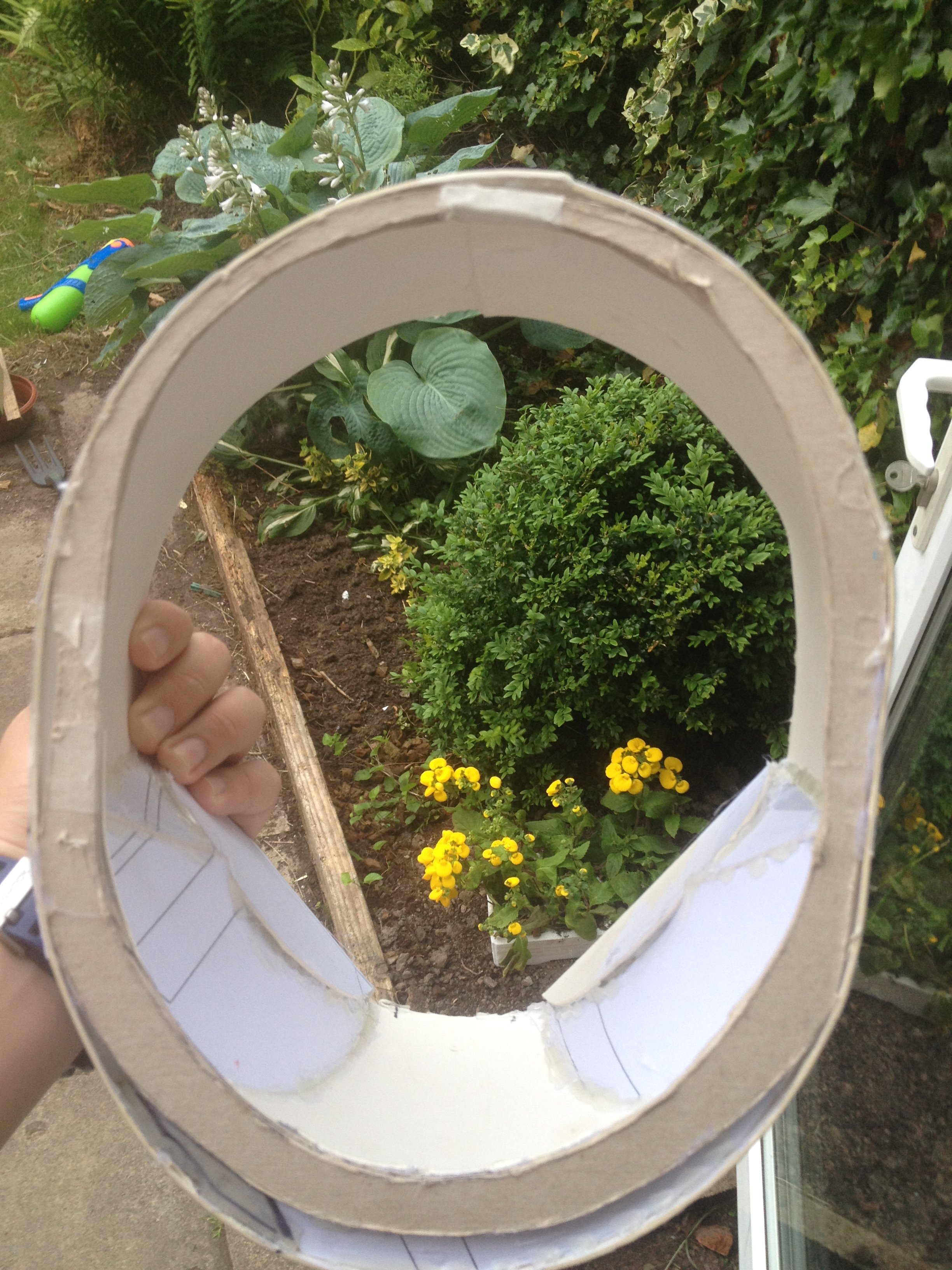

As you can see, the shape is a lot more squashed... the cardboard ring a here is the shape of my head.
Using the WOF templates as-is meant there was no room for my nose :)

The profile is a lot narrower, I think, than the original, but I'm not kidding myself that this'll be a full-on replica.
Once the sides are on, hopefully the profile will be a little better.
