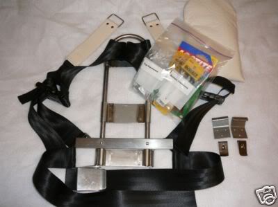

I am not familiar with this harness you are talking about.Any pics of it?If it looks like the one pictured here, no it will not work.The only harness that would work with my backplate would be a standard web harness with the extending loops.This bracket is just too large and bulky to work with my backplate.sorry bro!!
