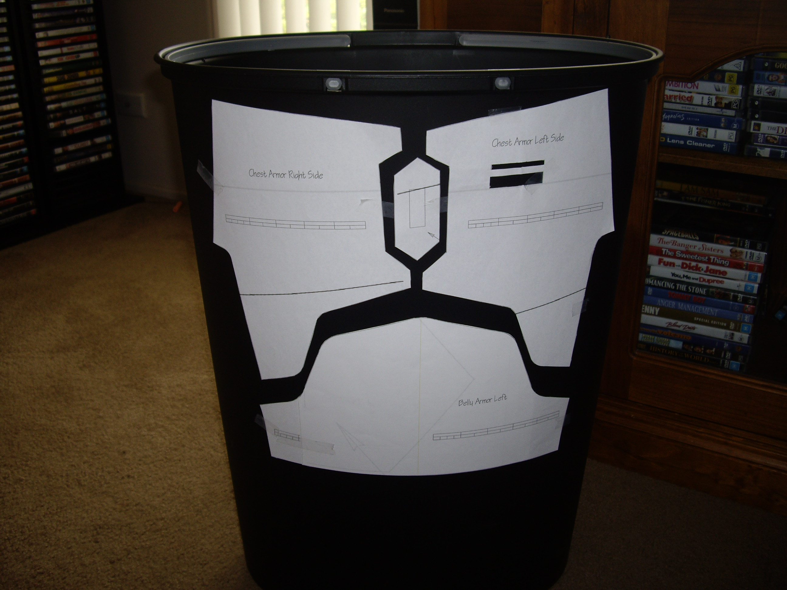

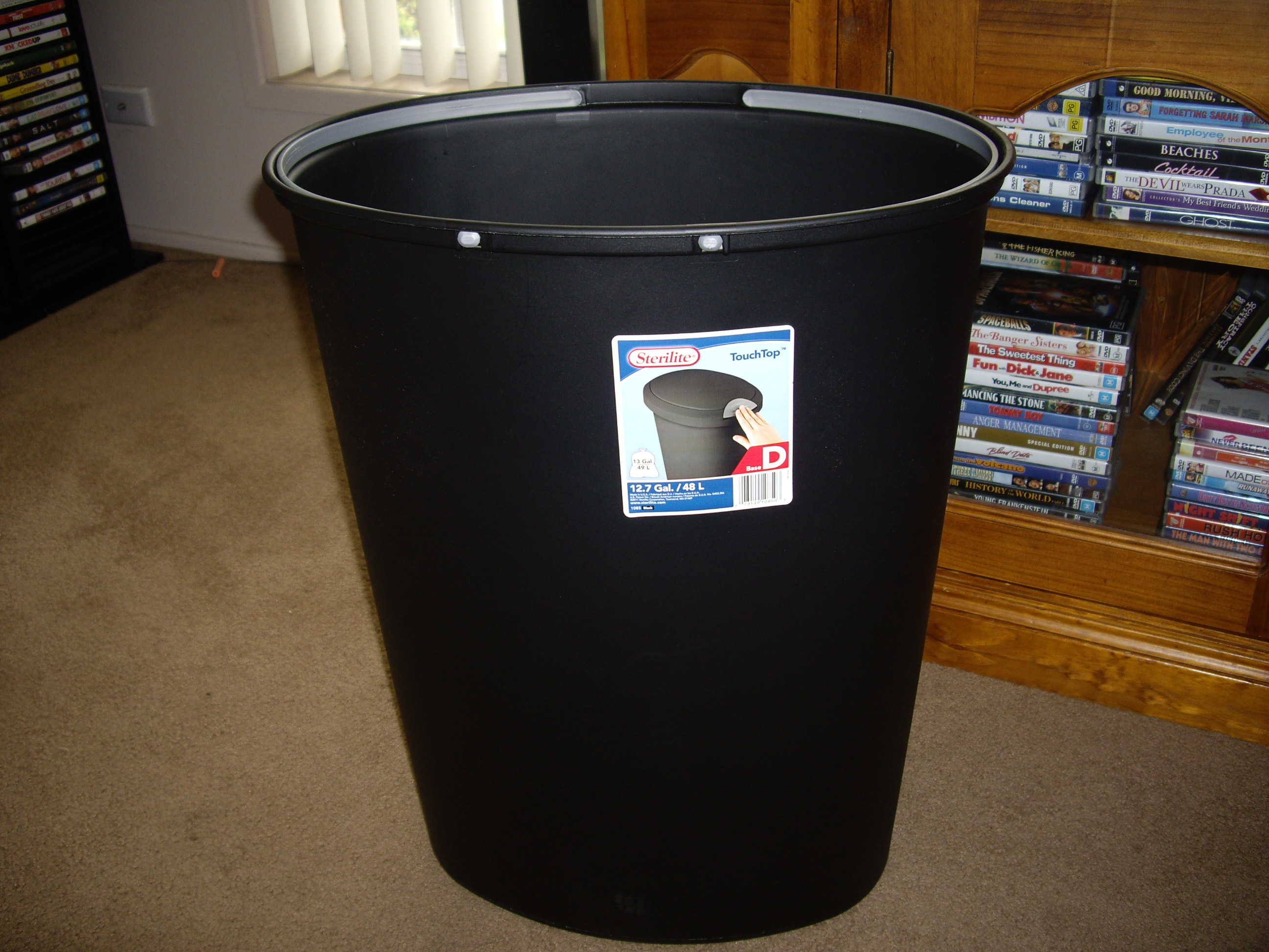

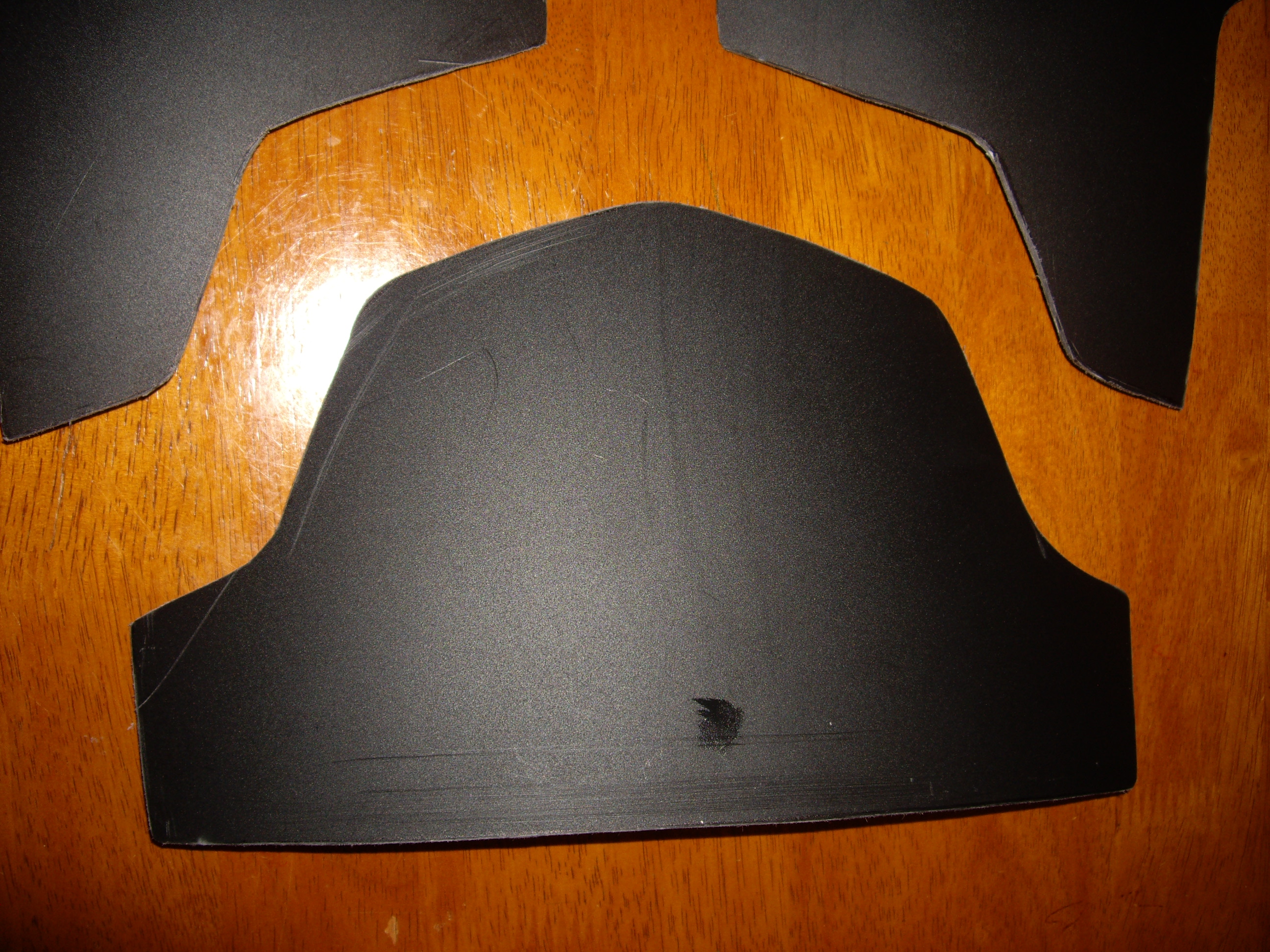

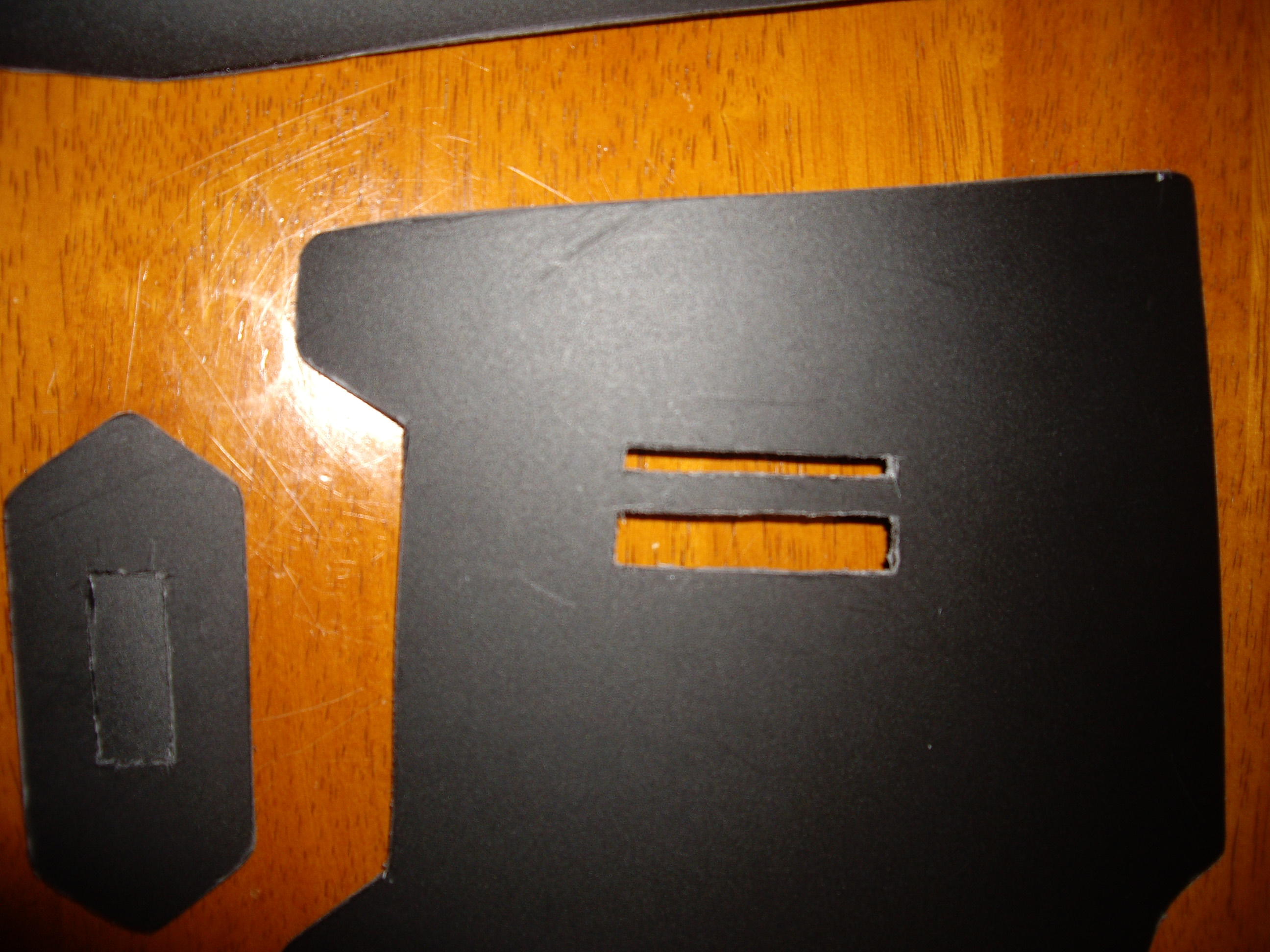

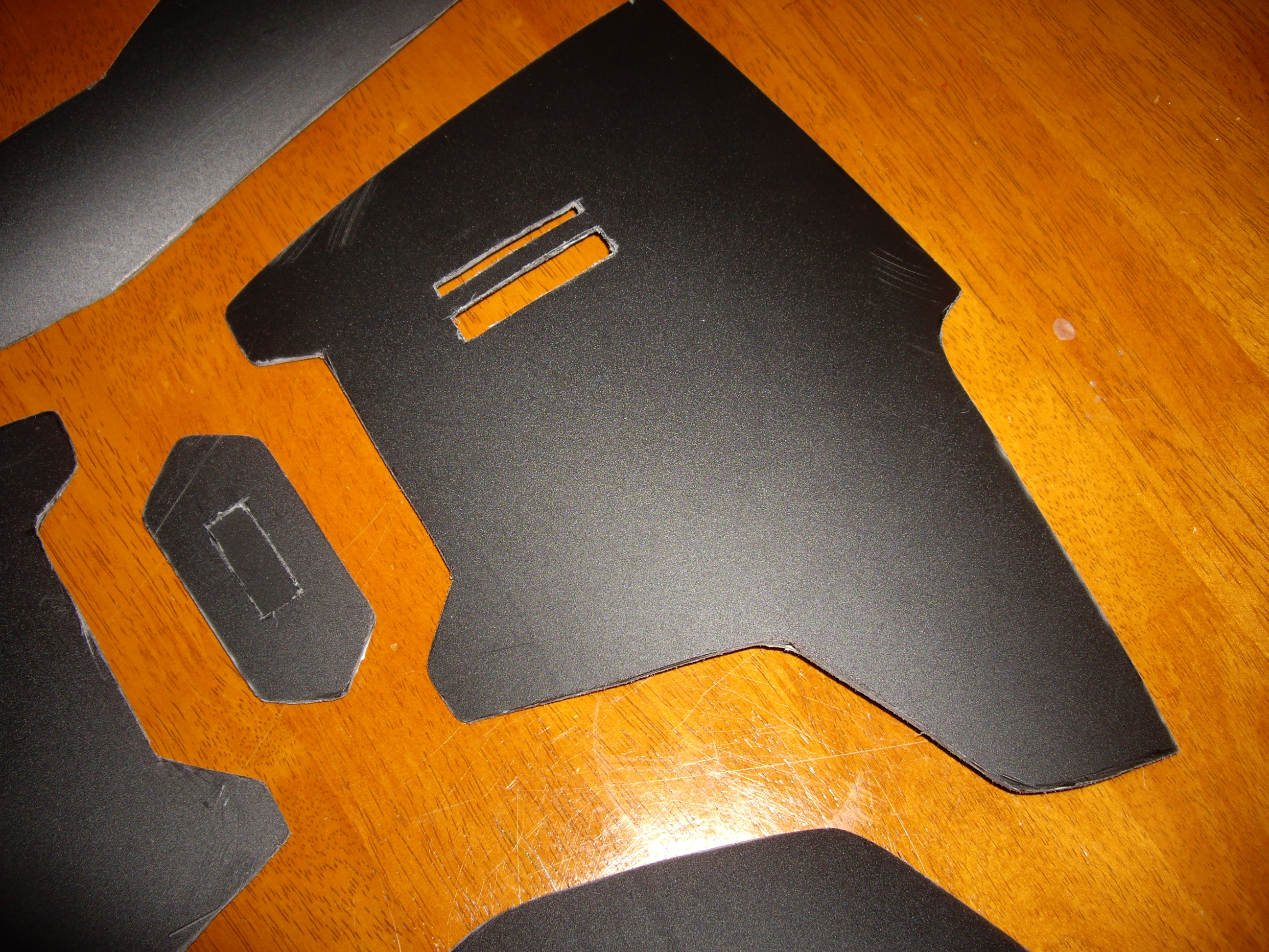

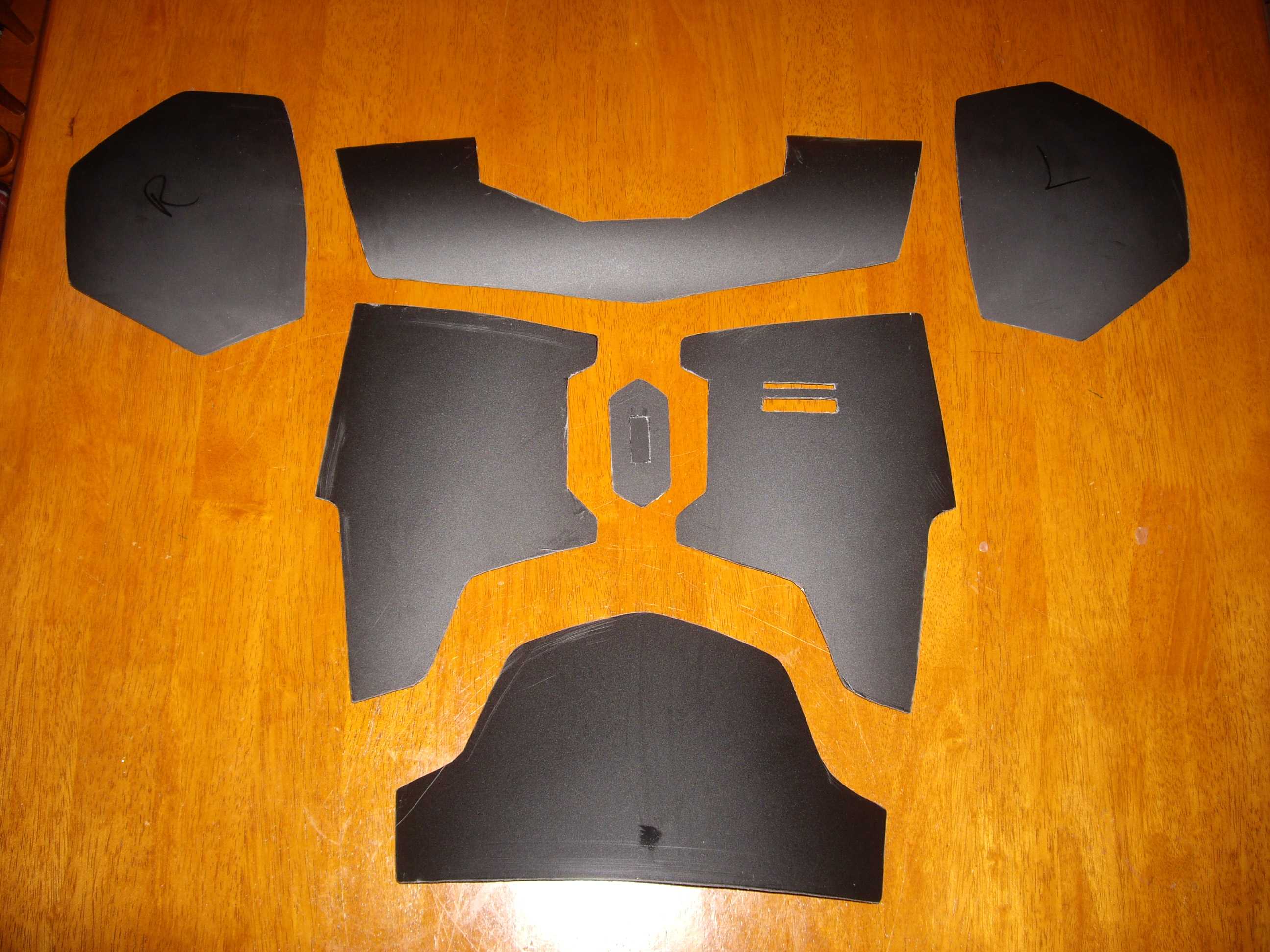

Hey guys, this is the start of my boba fett build. I have ordered a Bobamaker ESB helmet.... so as i wait for a couple of months for that to arrive, i thought i would keep myself busy by building the armour. So after seeing a thread on the dented helmet, i got the idea to build it out of a garbage bin! So i headed on down to bunnings to buy the biggest, roundest bin i could find! Then, $30 later, and a couple of days cutting, filing and snapping! Actually its been a pretty solid two days, i have taken over the lounge room and hijacked the tv with star wars movie marathons just to keep me inspired! anyway, this is what i have so far.......
now to paint!!!!

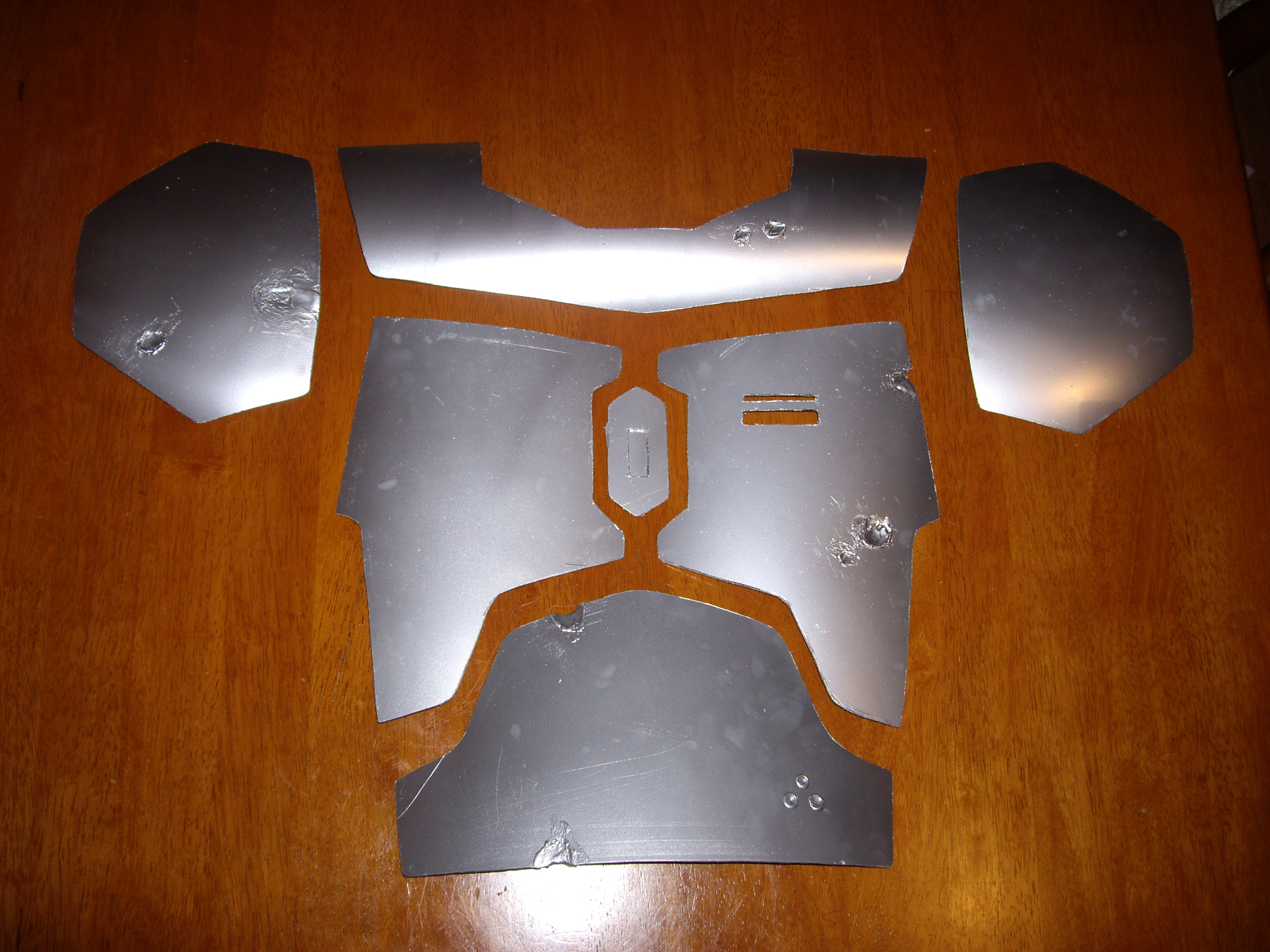

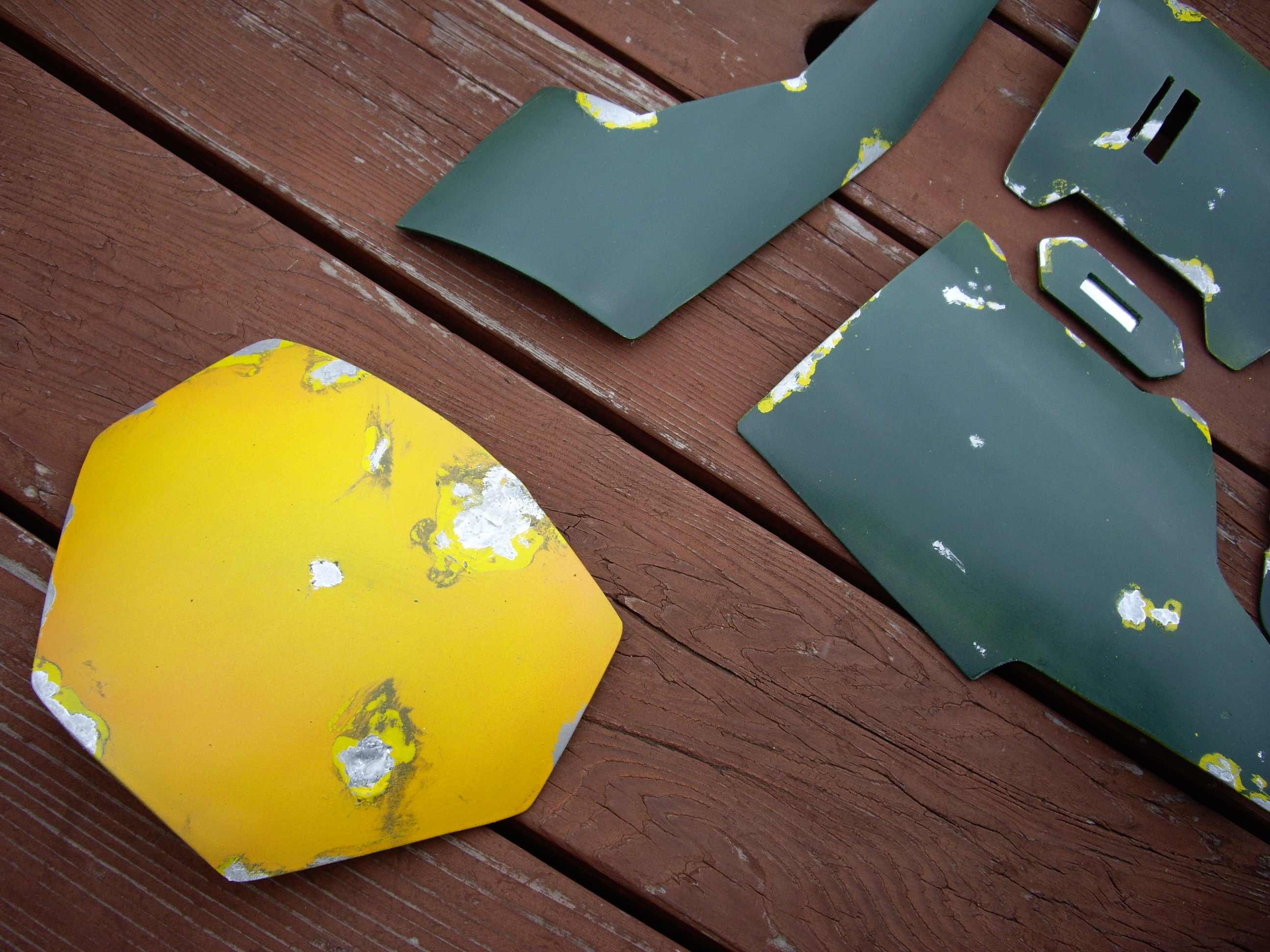

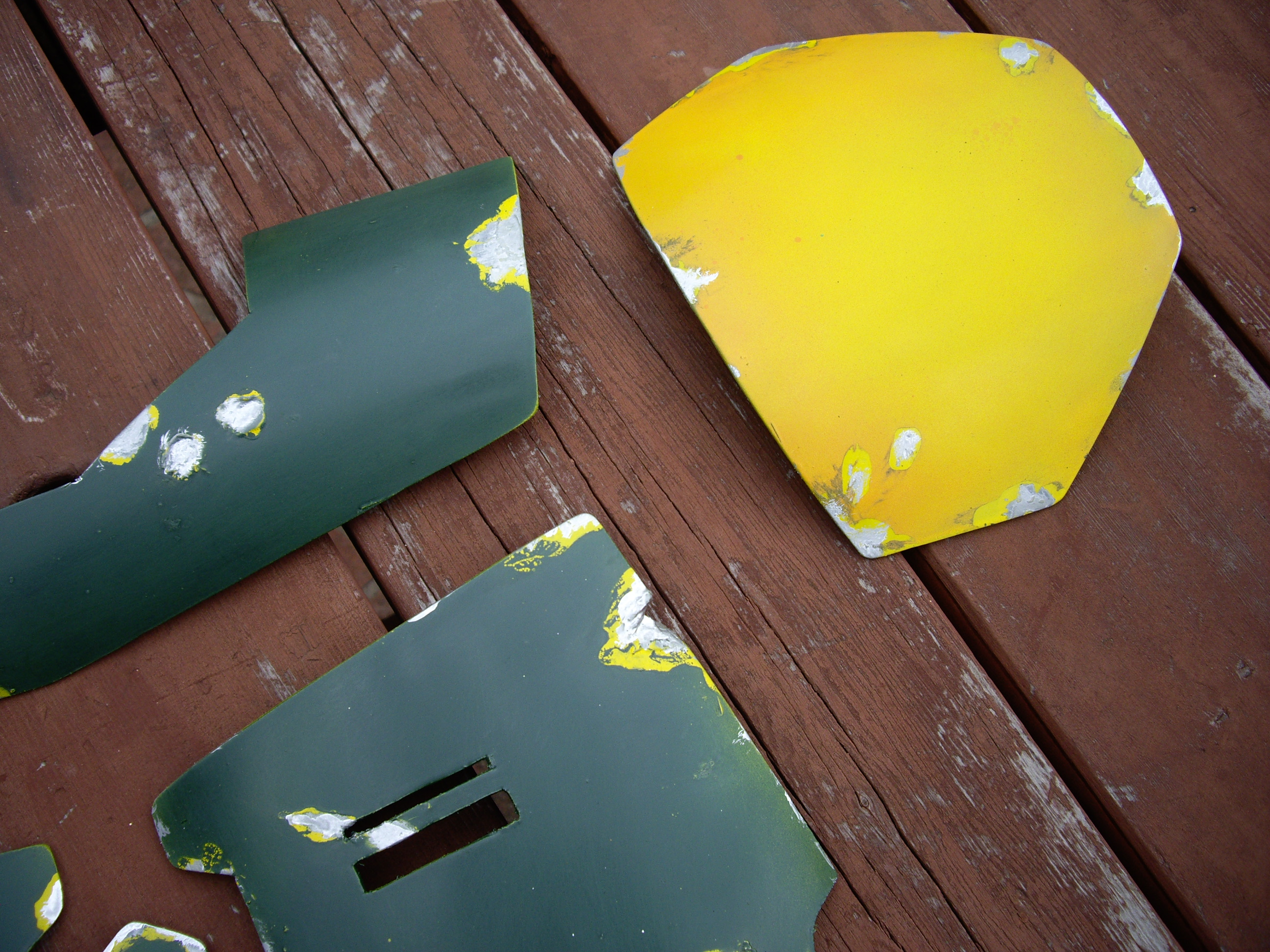

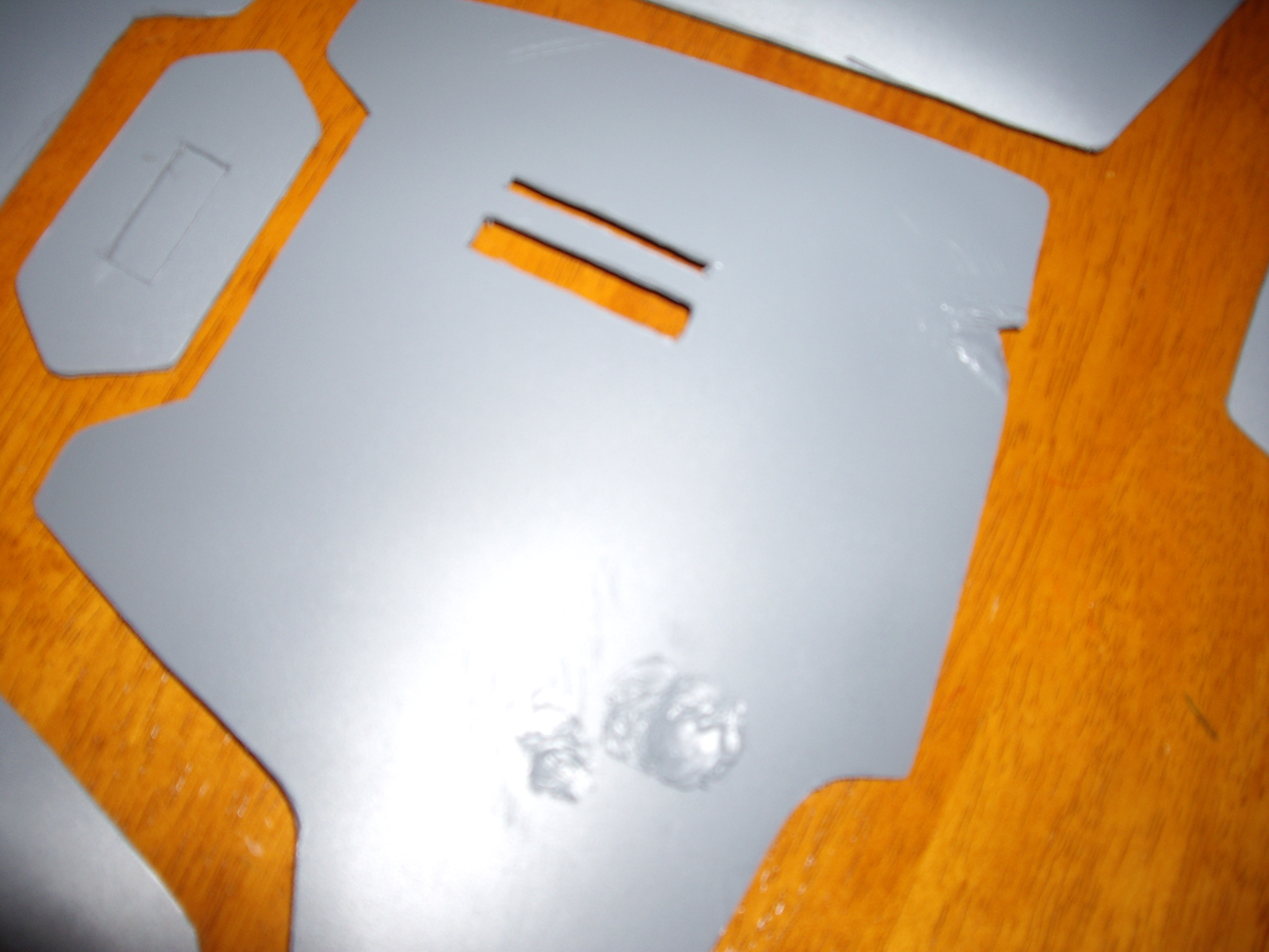

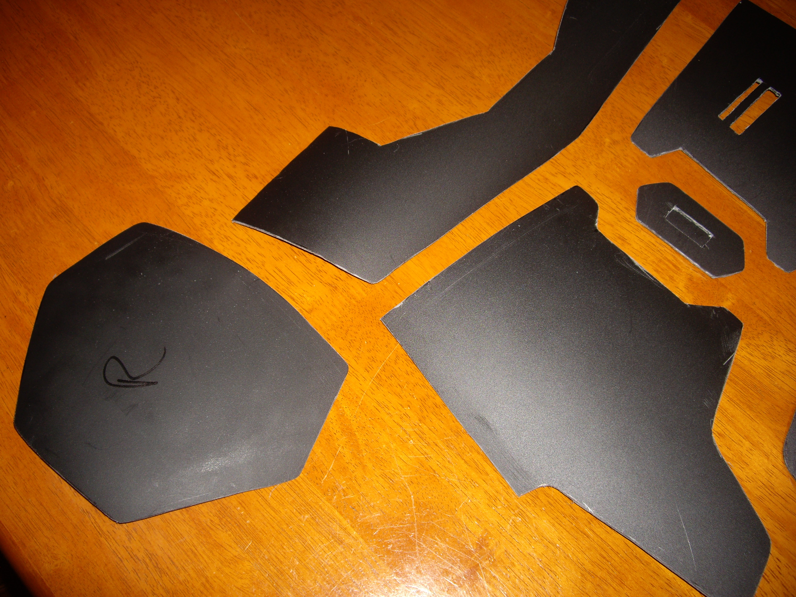

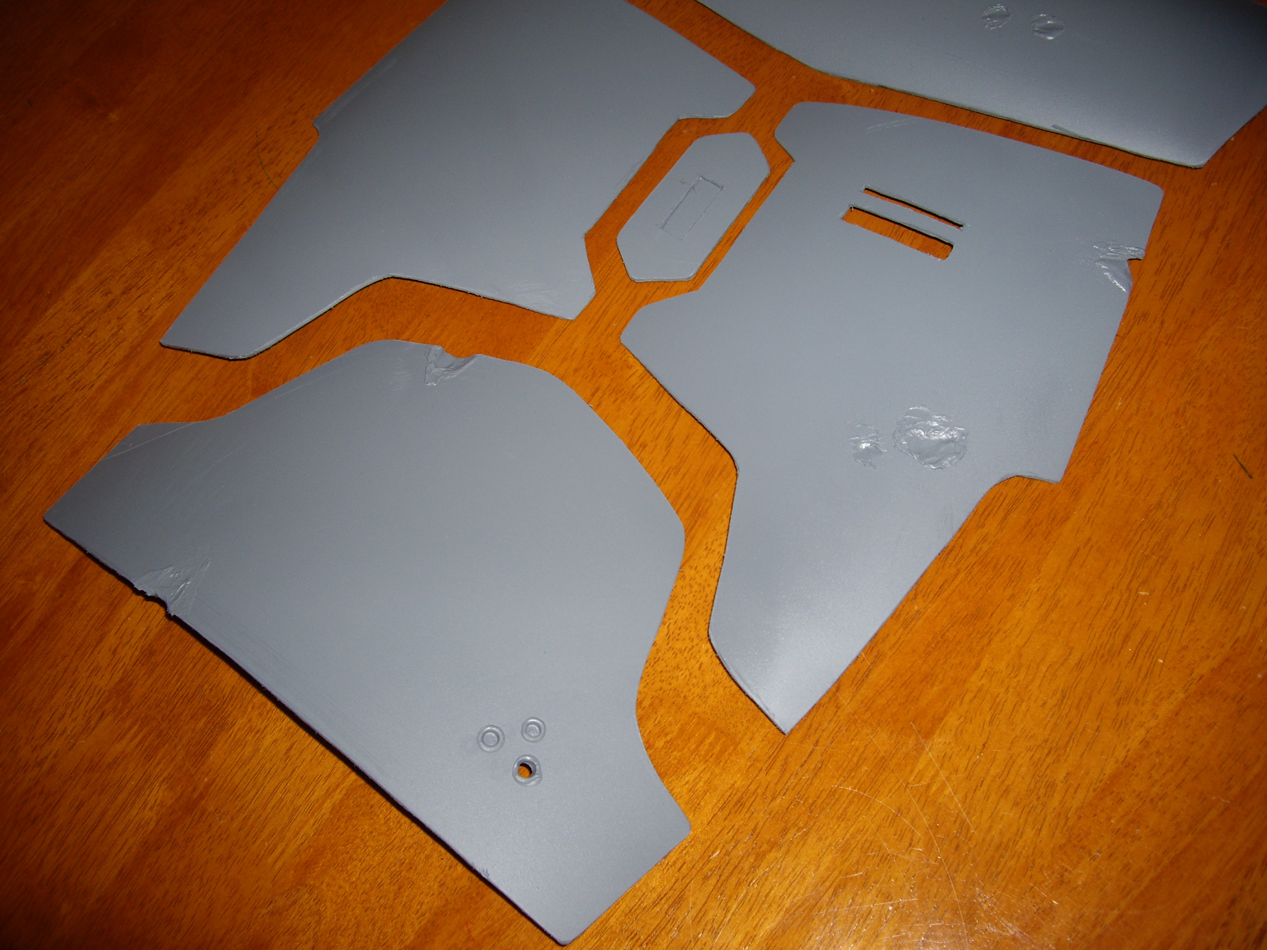

Ok, I have finally got some work to show!
I have had quite a few set backs but im fighting through my self doubt and "Homer Simpson" like skills... to bring this new update!
008.JPG005 (2).JPG002 (2).JPG022.JPG006 (2).JPG003 (2).JPG023.JPG007 (2).JPG004 (2).JPG

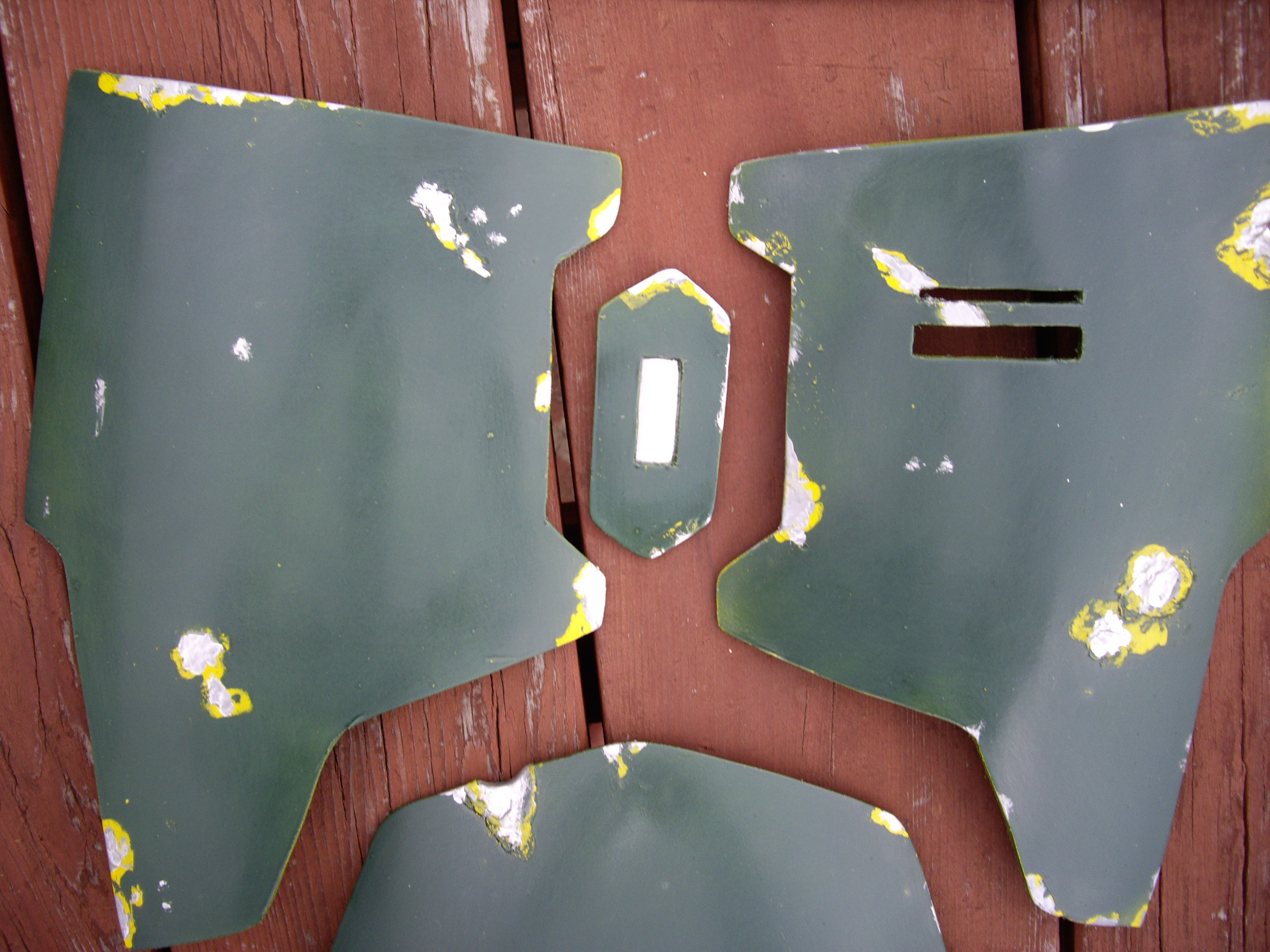

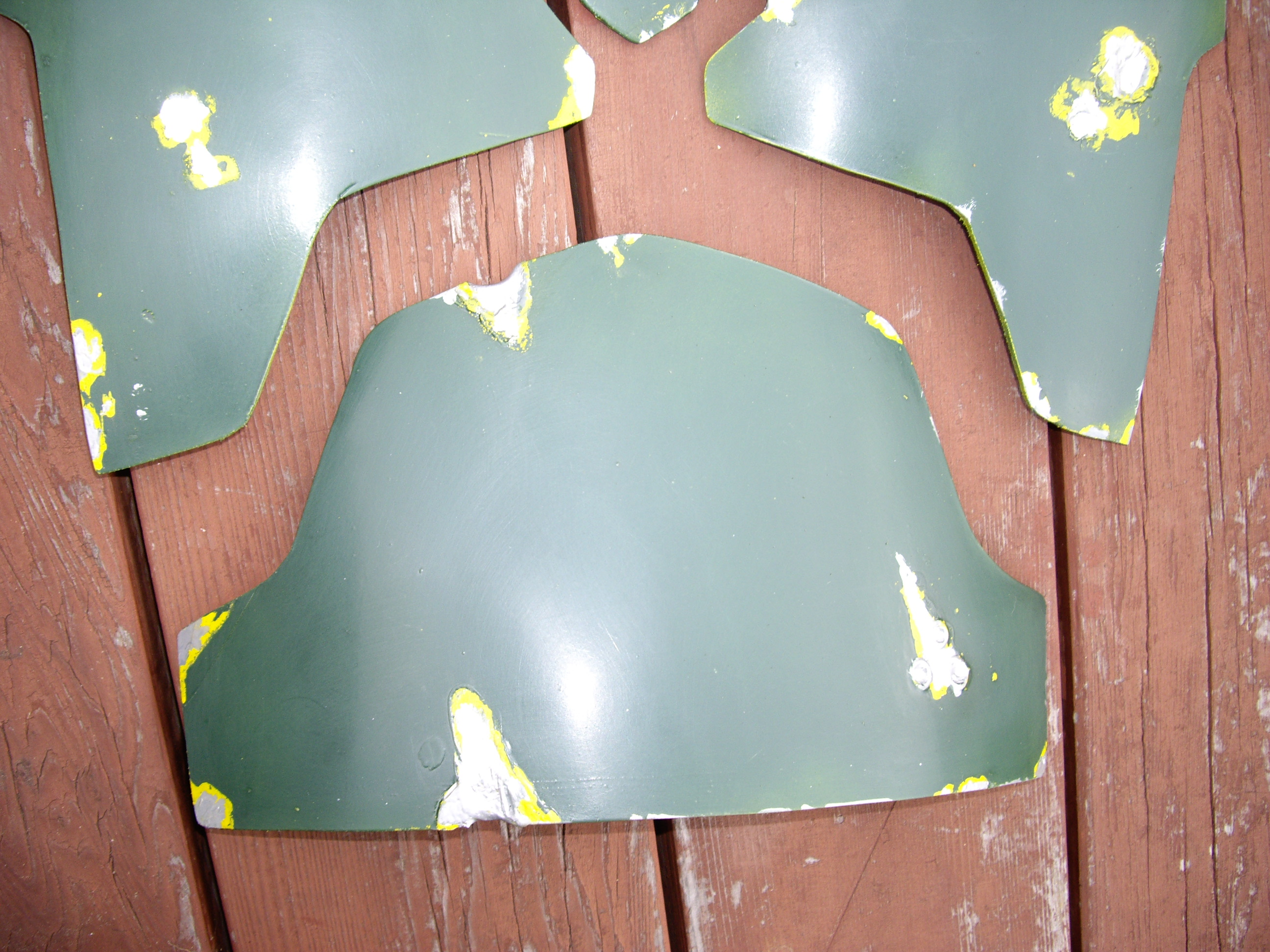

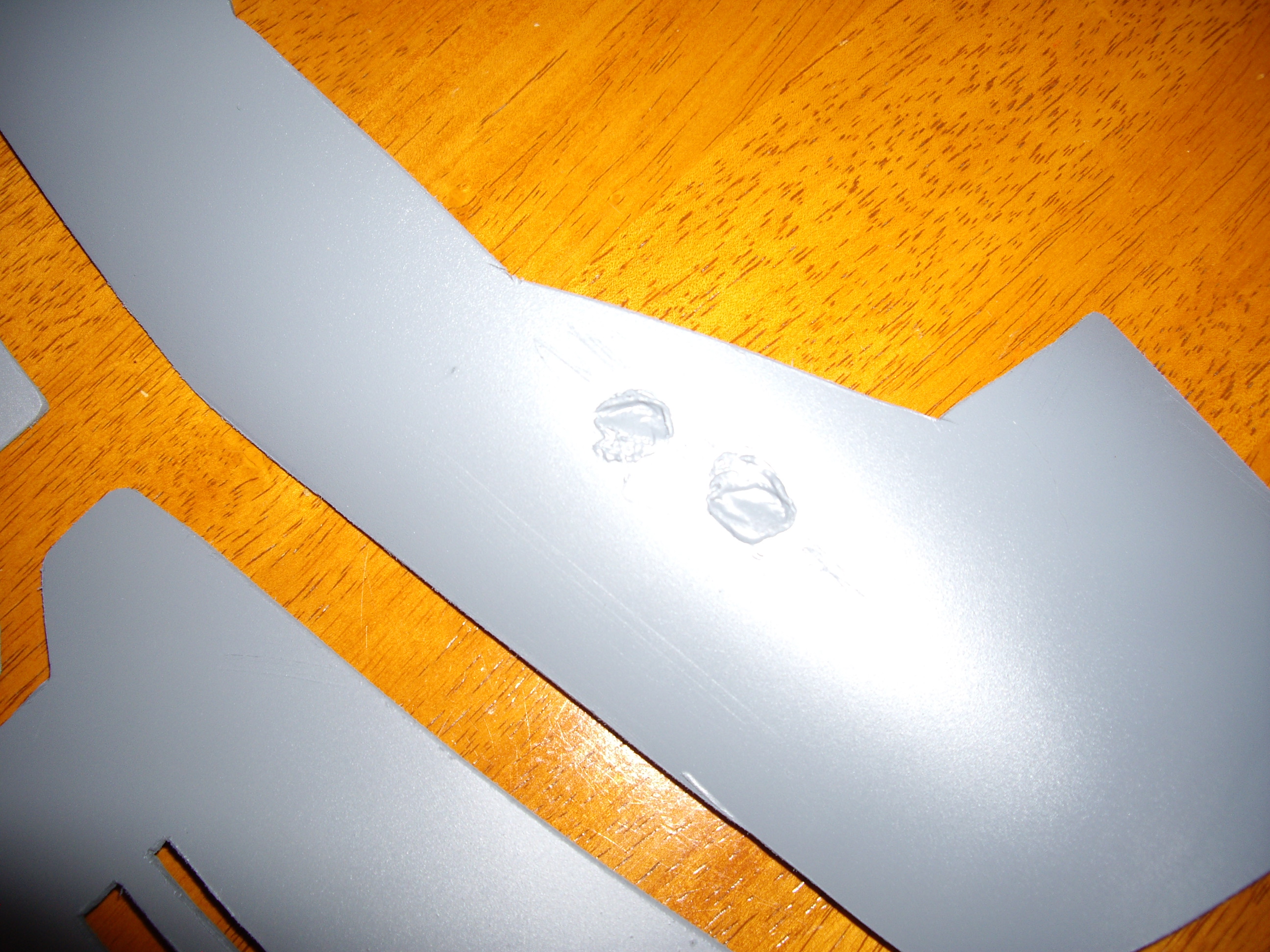

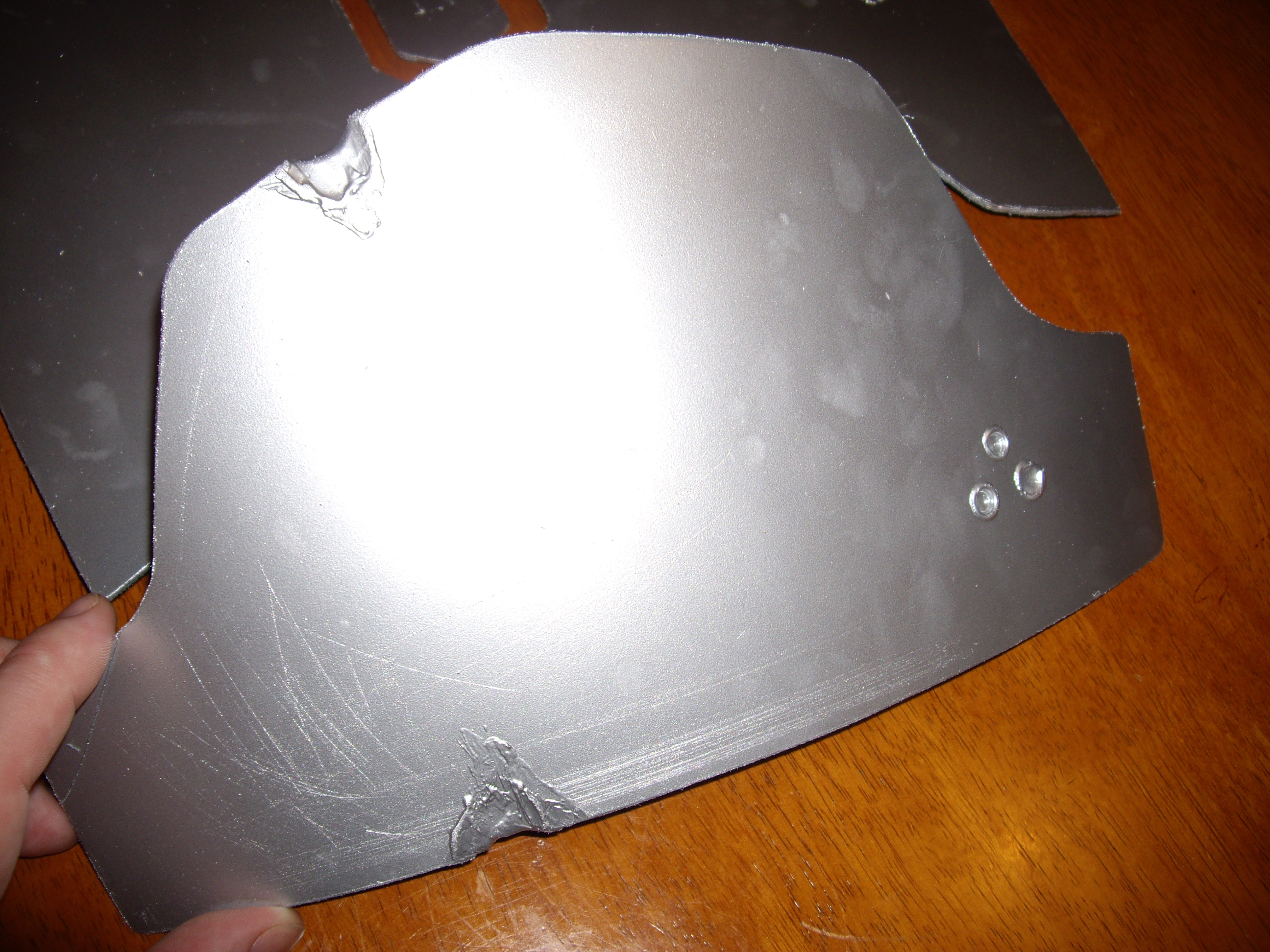

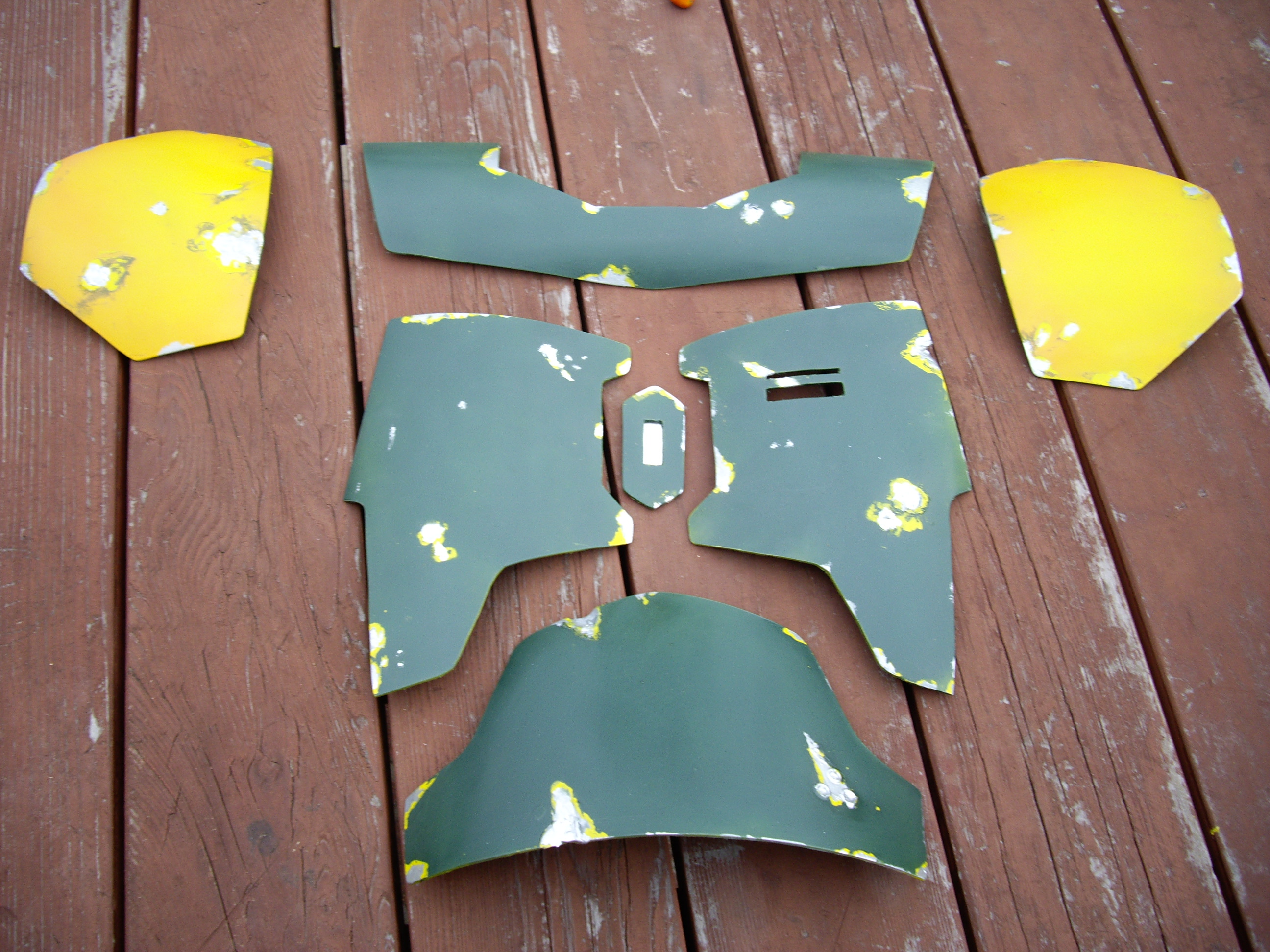

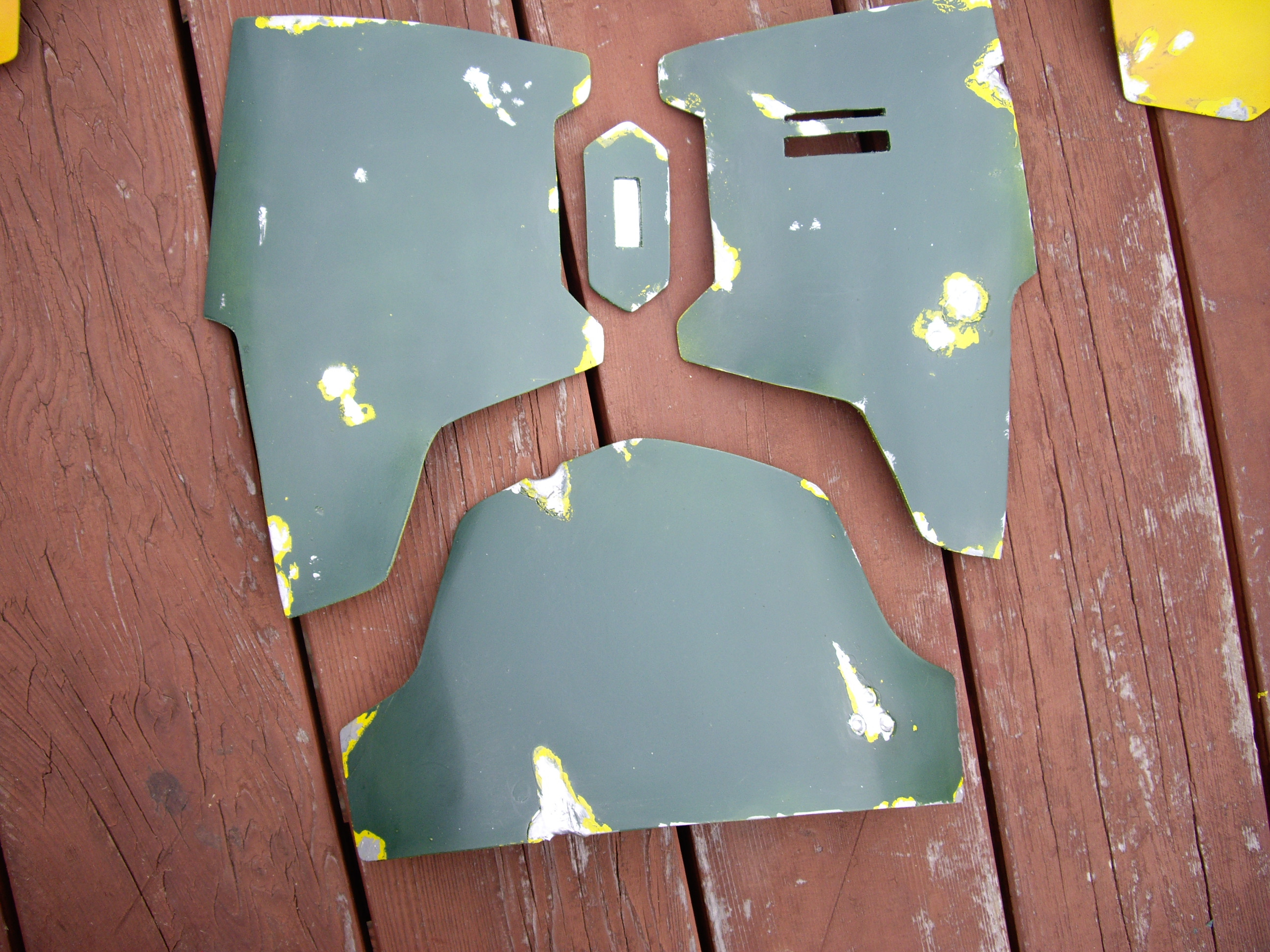

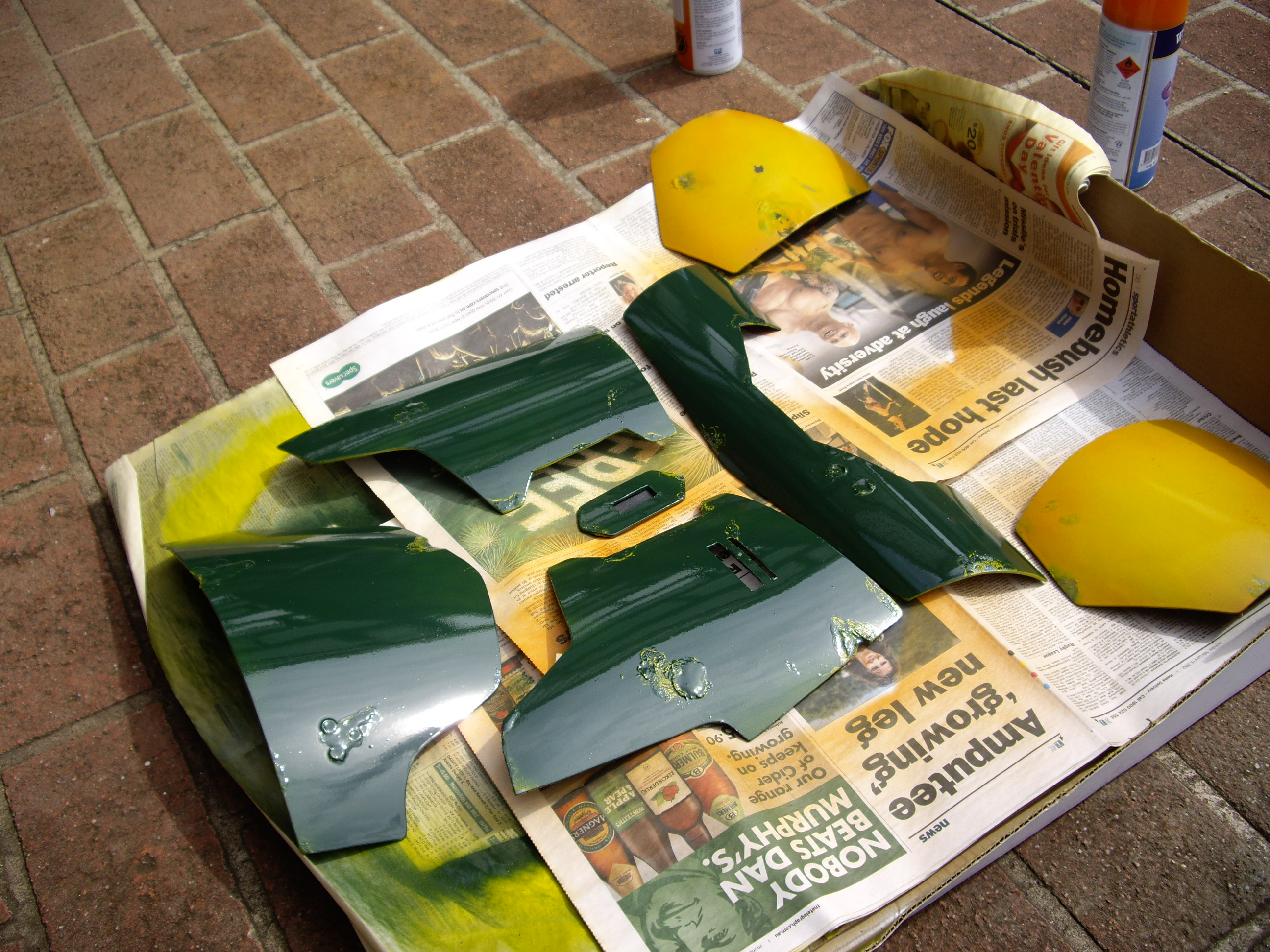

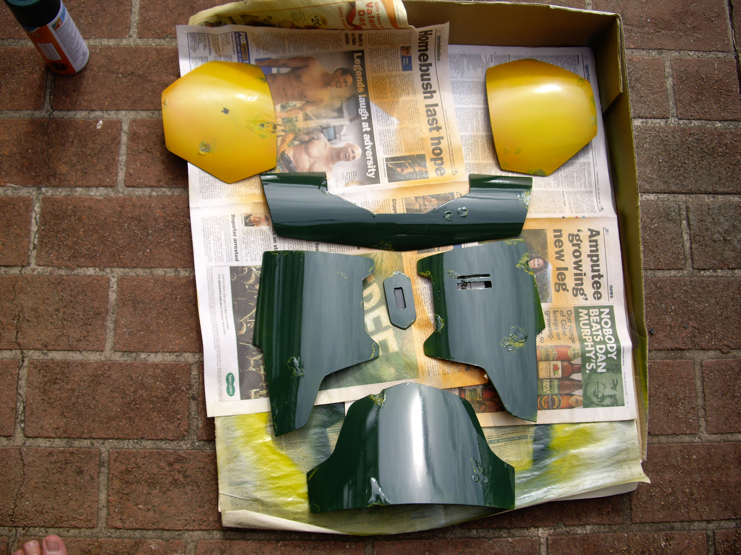

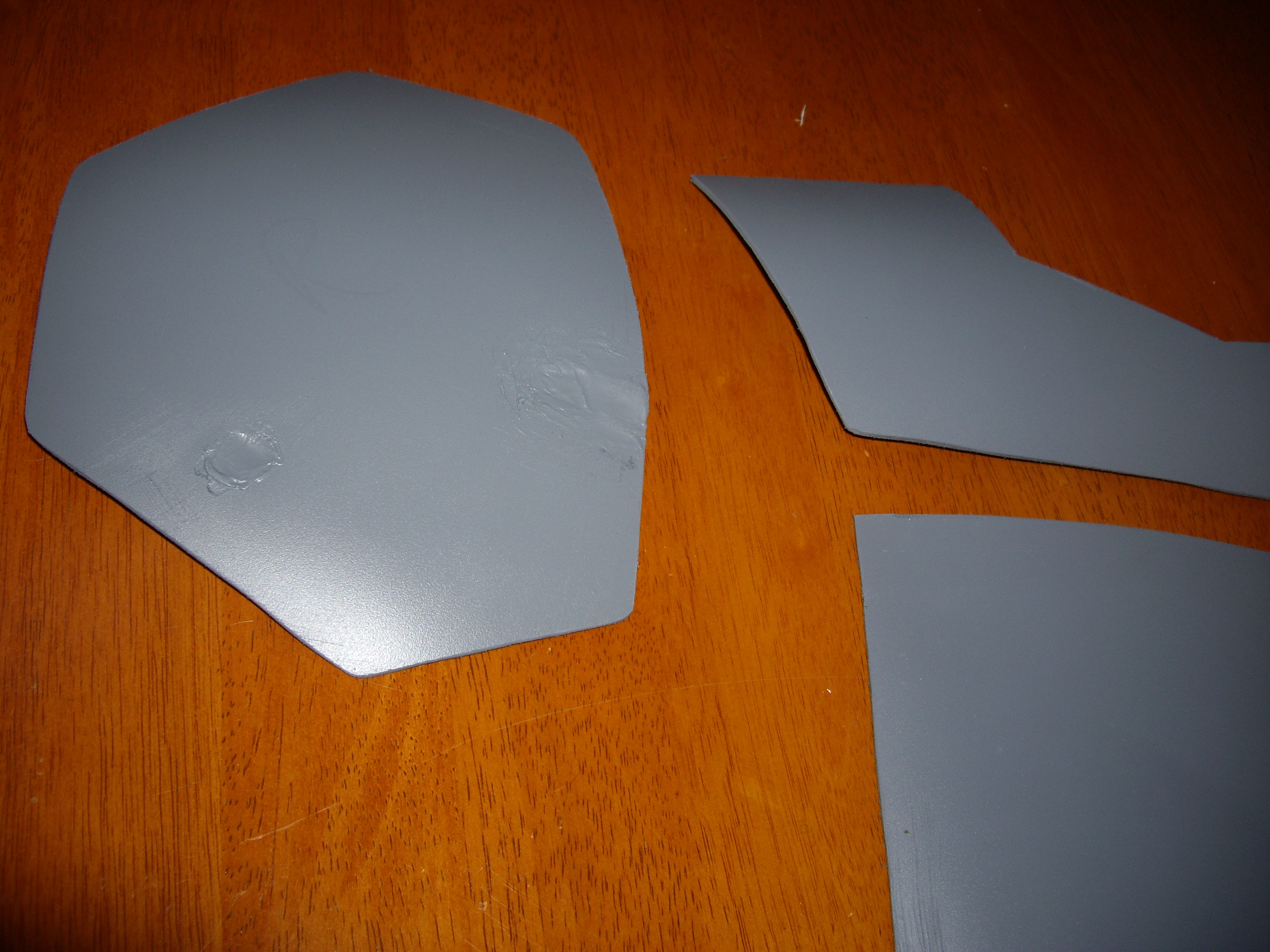

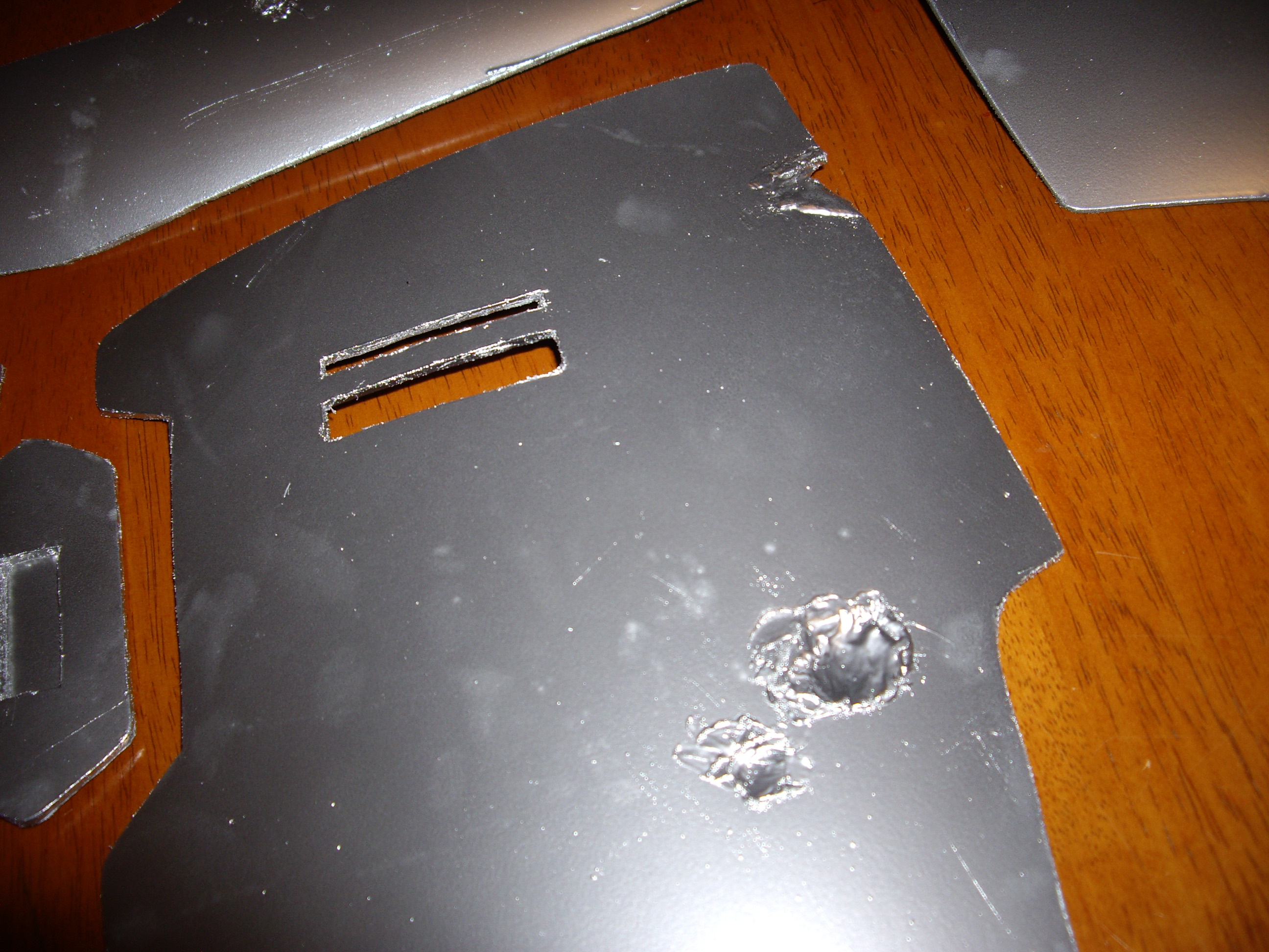

I have painted, rubbed back, painted again, scratched my head a few times....
anyway here are the following photos primed, melted dents, silver paint, forgot to take pics of the yellow. the shoulder bells are lightly sprayed with orange and yes there is a chunk missing right out of the middle of one of the bells, will touch up later! Oh and i used hair gel for masking paint, so far, so good!
sorry about the pics being all jumbled.... not sure why that happened....

I used an exacto blade or stanley knife, and scored the shapes with the templates off TDH.... then snapped them off. It really is a pain in the arse! It takes a long,long time but i guess its worth the effort?! The damage i heated up metal objects on the gas stove and seared the damage into the plastic.
