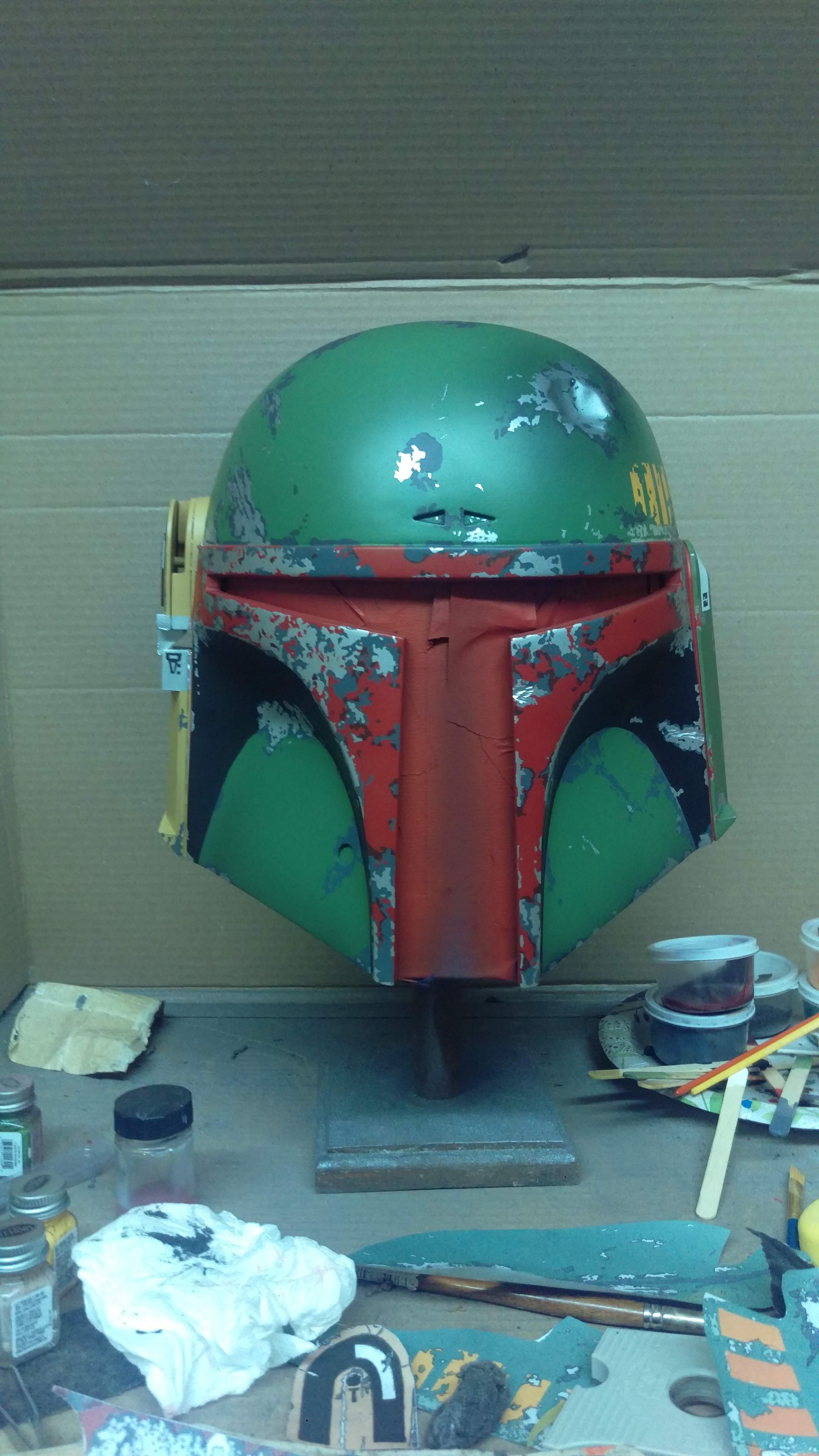

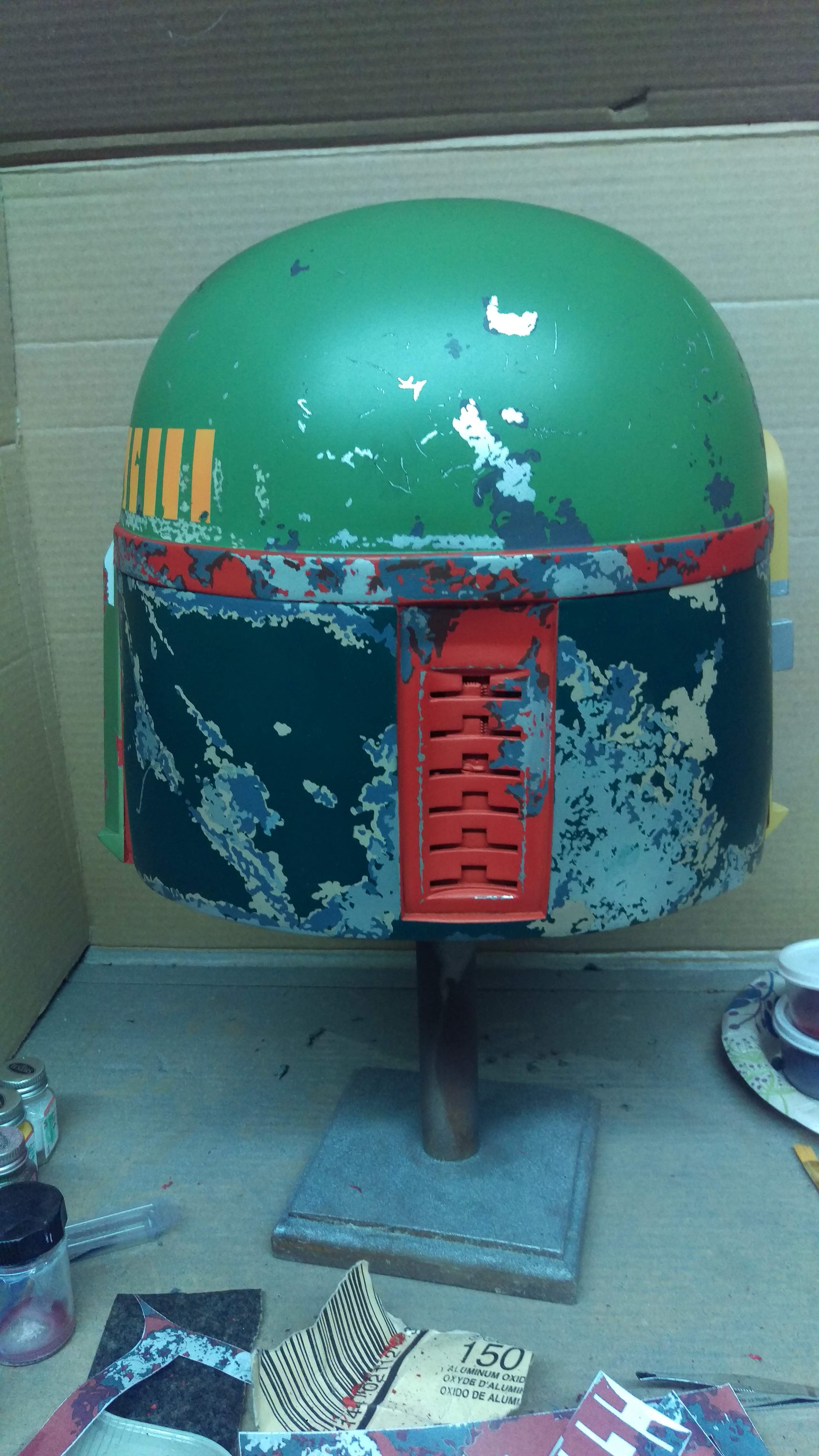

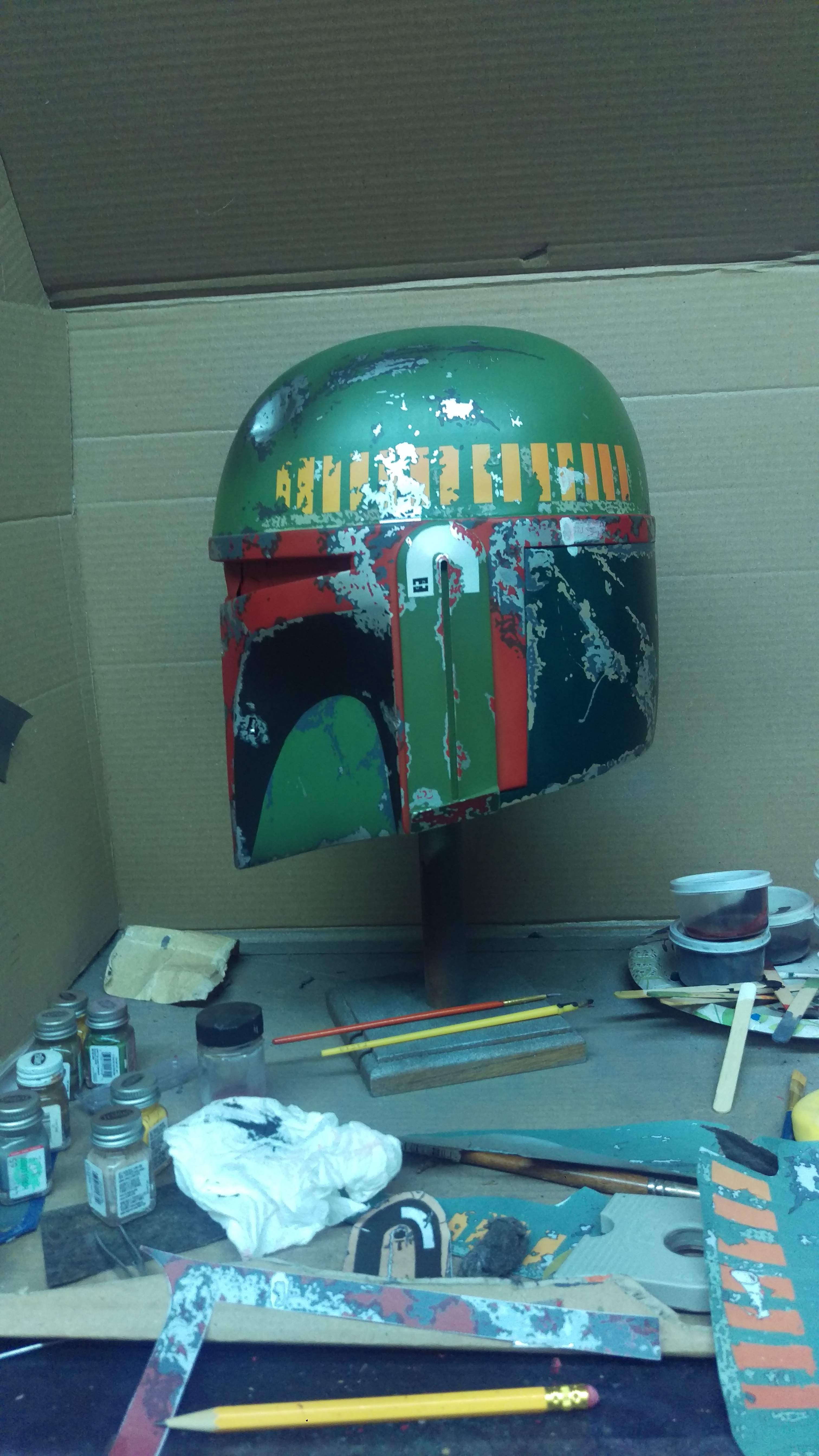

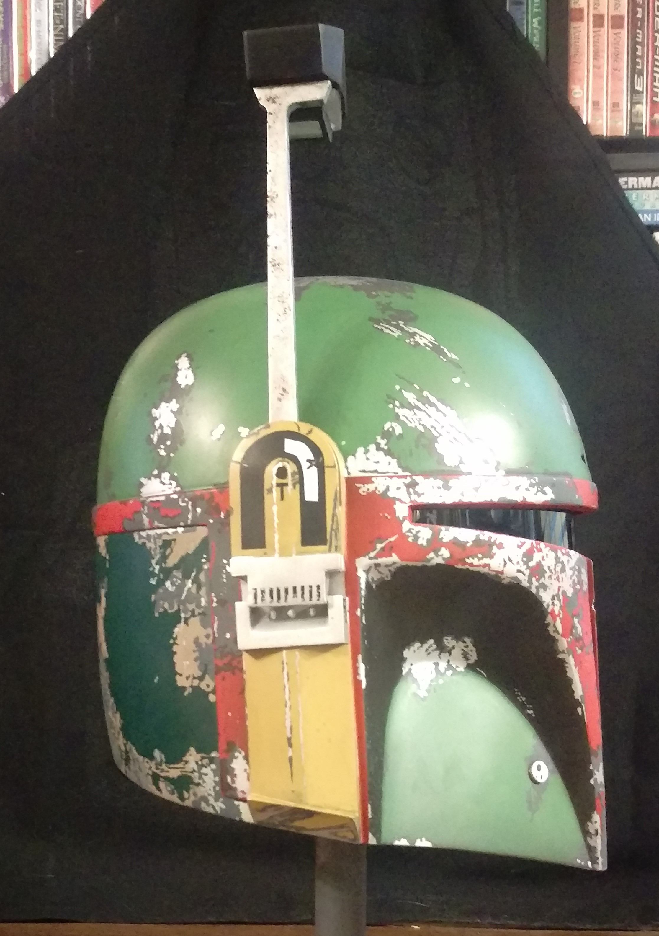

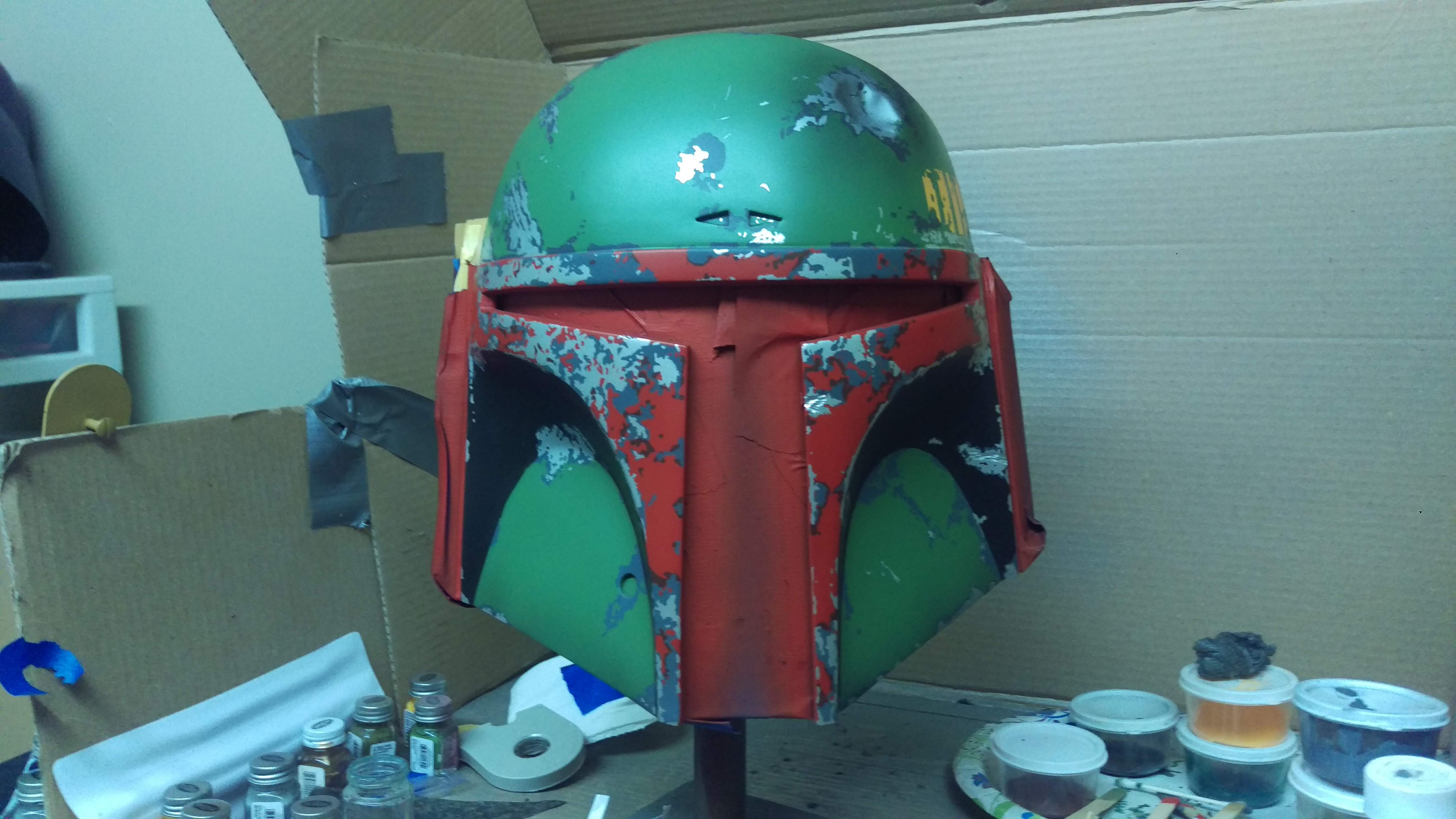

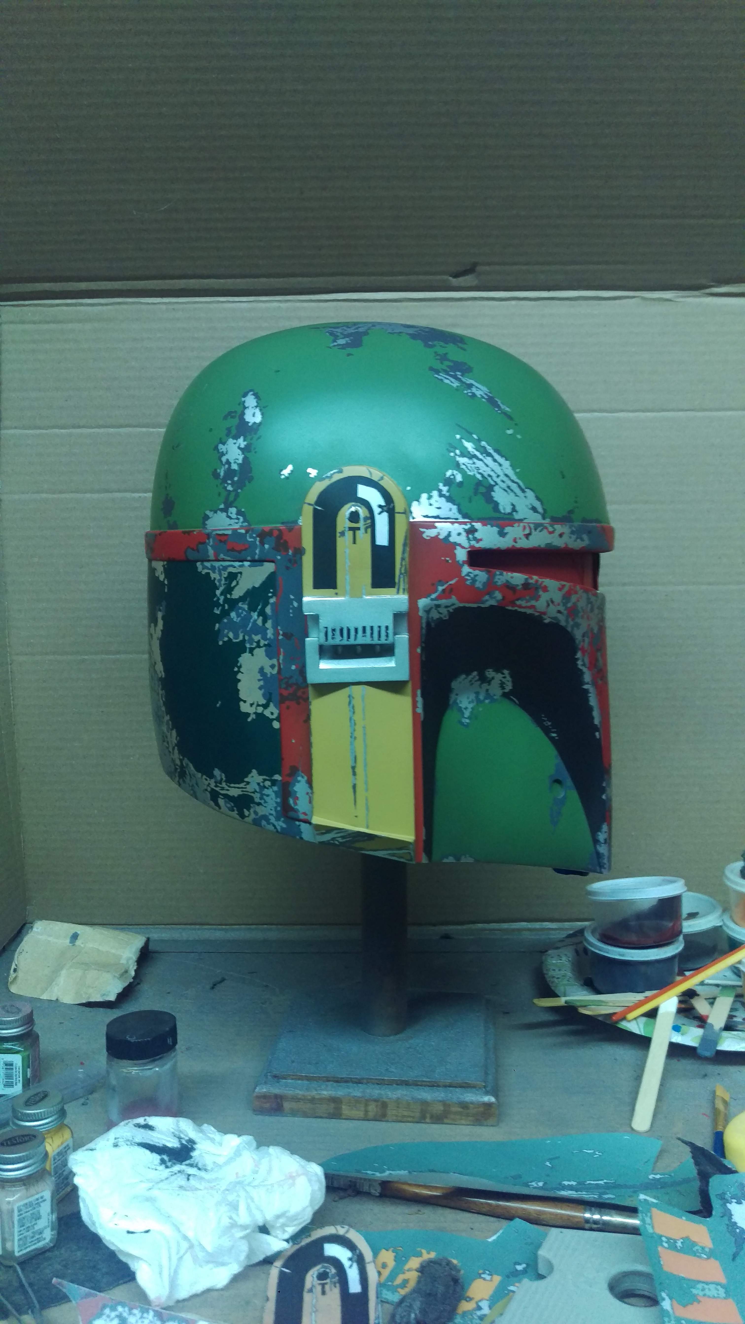

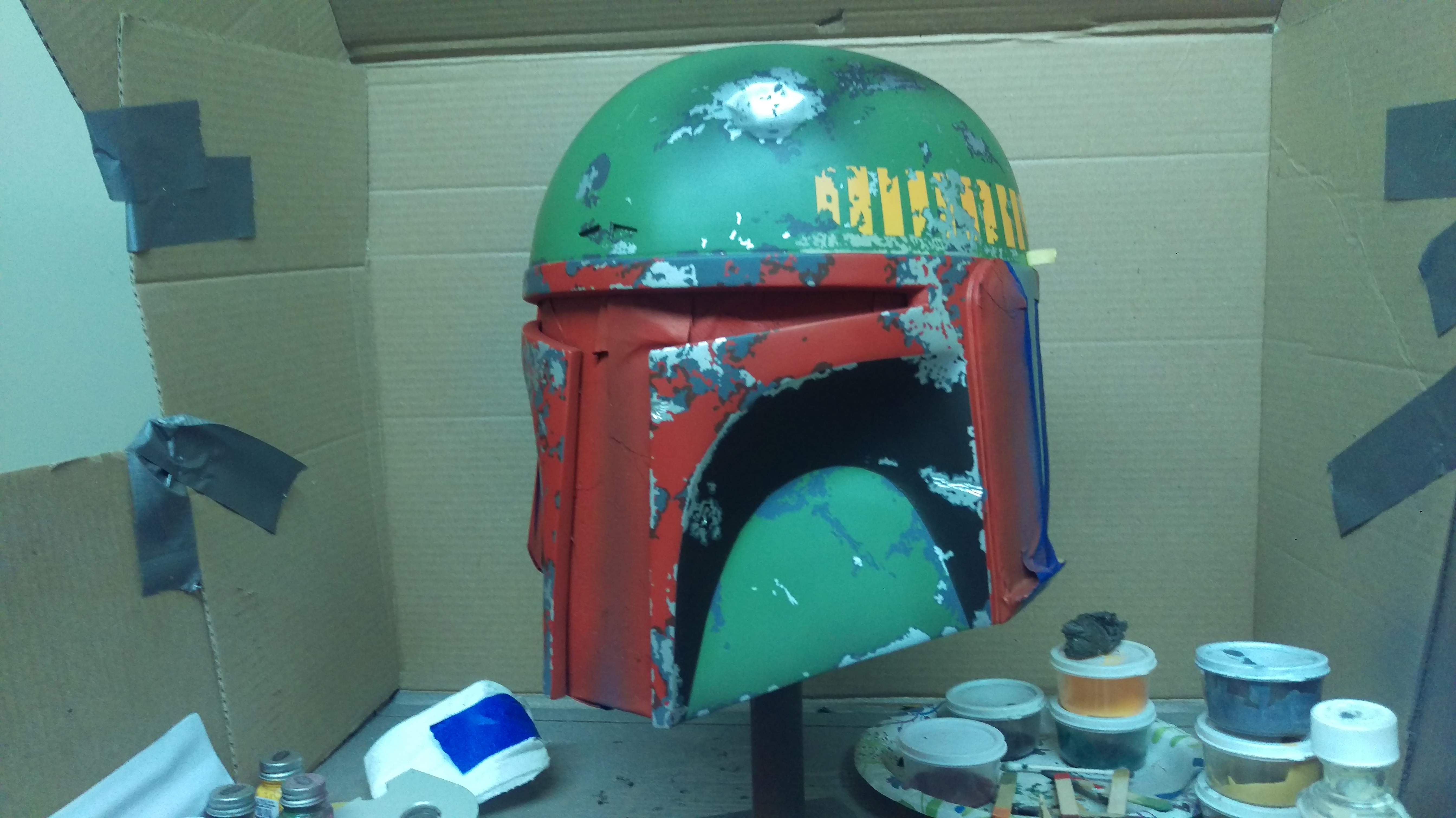

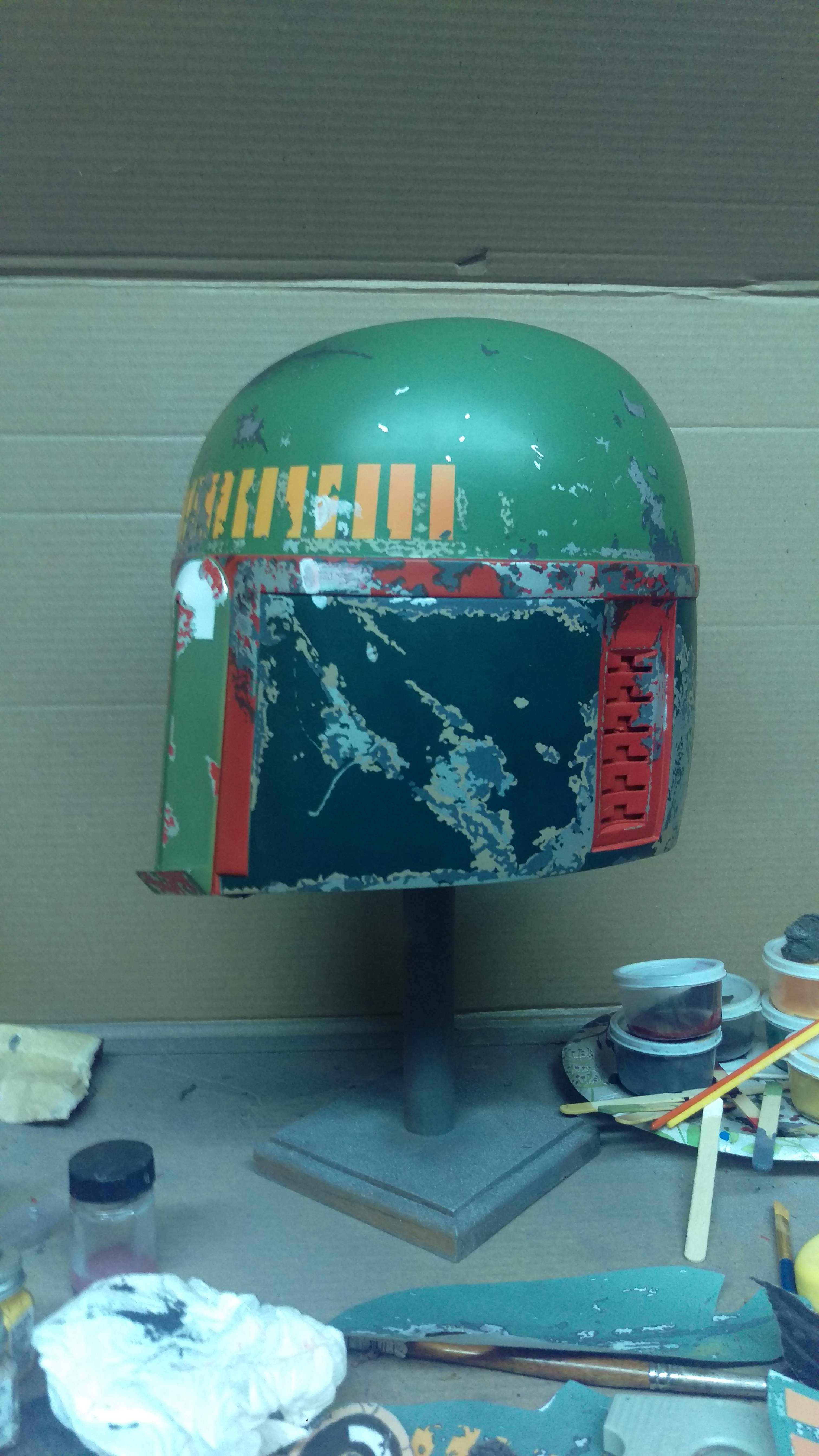

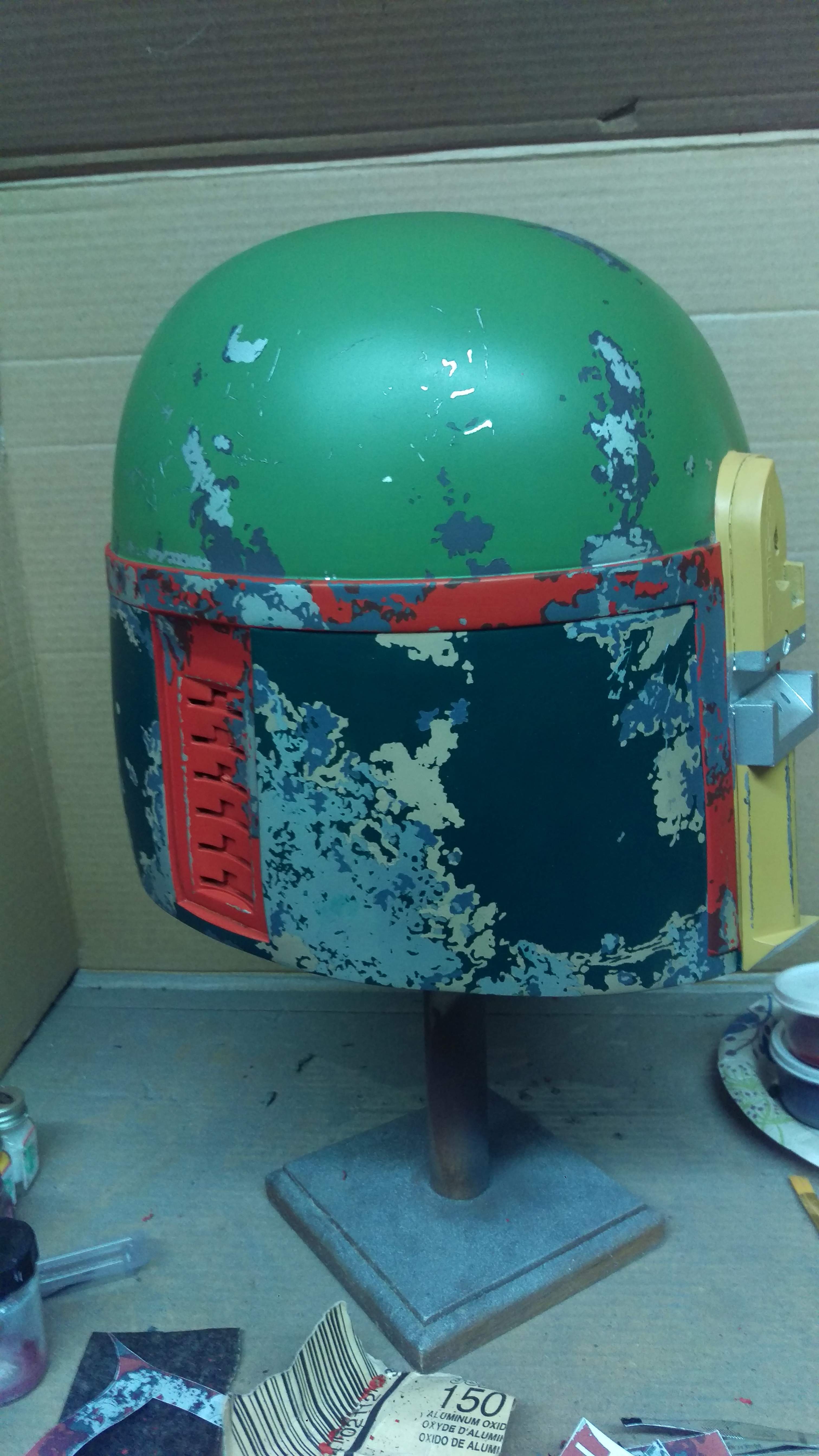

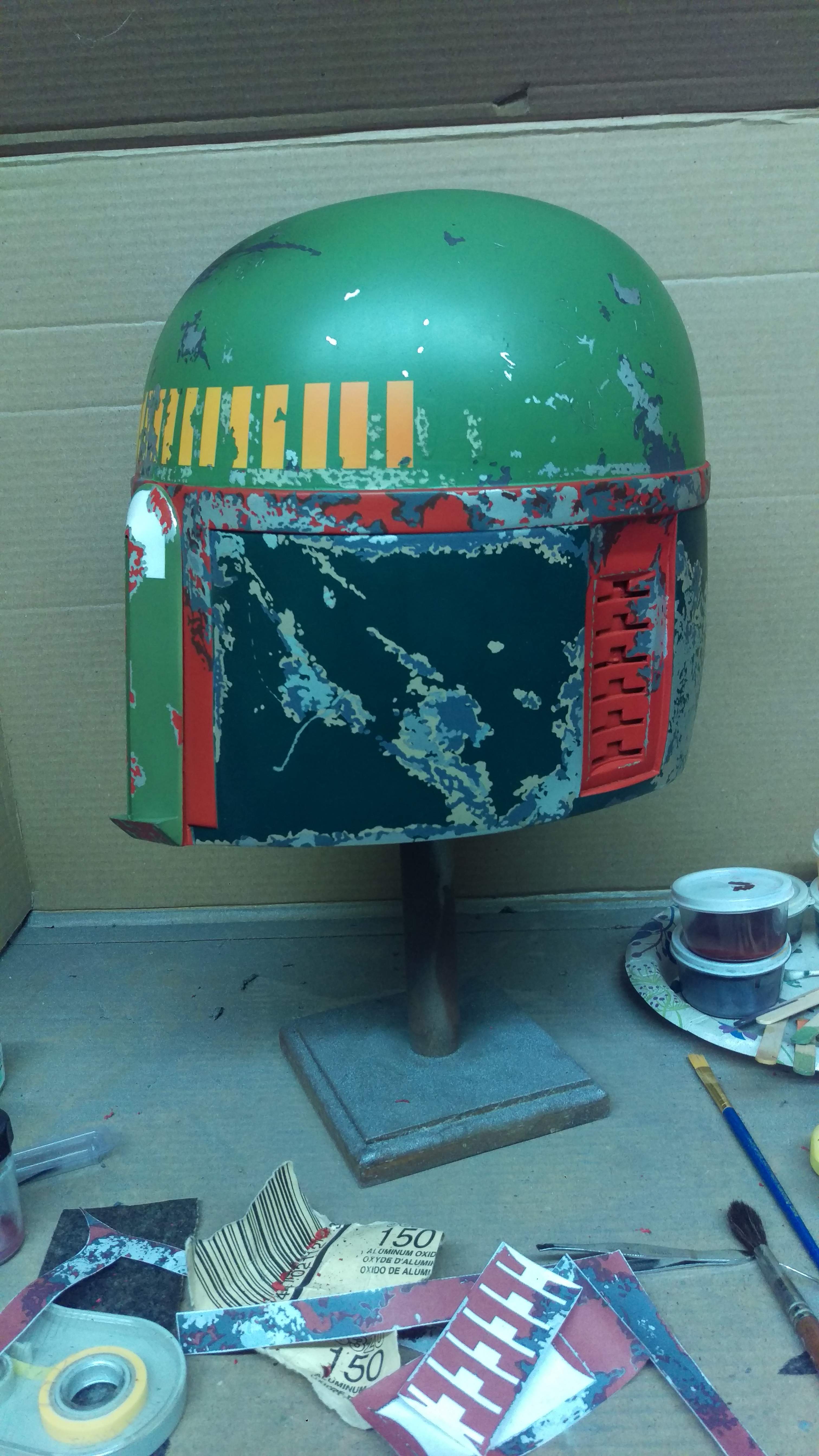

And this is where I got so far, main paint on mandibles done. Just have to knock out the red band on the back of the helmet then on to some finer details. Let me know what you think, have I missed anything, Im going cross eyed staring at stencils, tracing and trying to decide which colors should end up where lol. Enjoy!
Plan of attack from here:
White smudges on kill stripes and back band.
Decals on ears.
General dirtying and weathering of whole helmet.
Assemble, paint and mount rangefinder.
Done. Have I missed anything? Any suggestions? Comments and ideas always welcome.

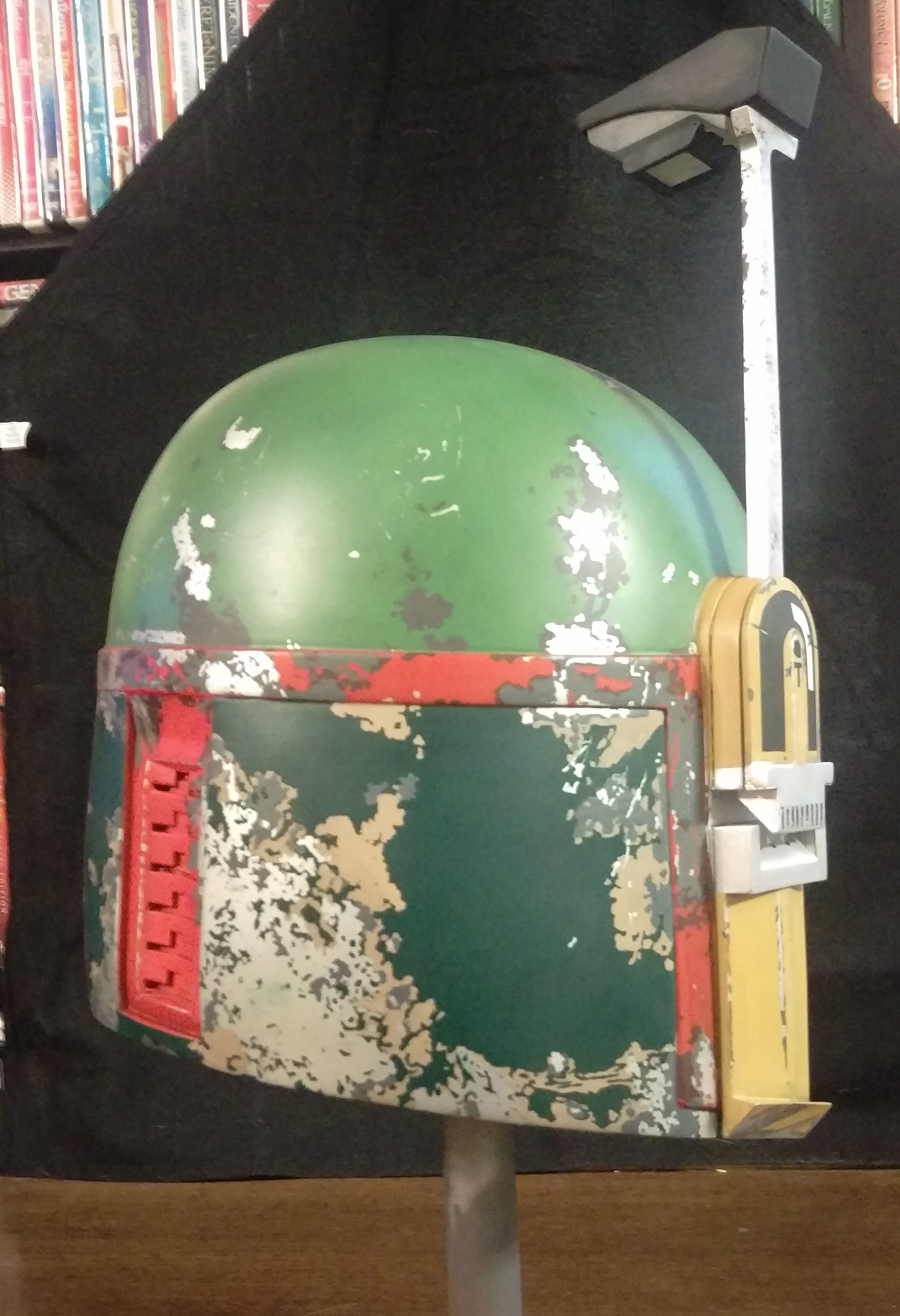

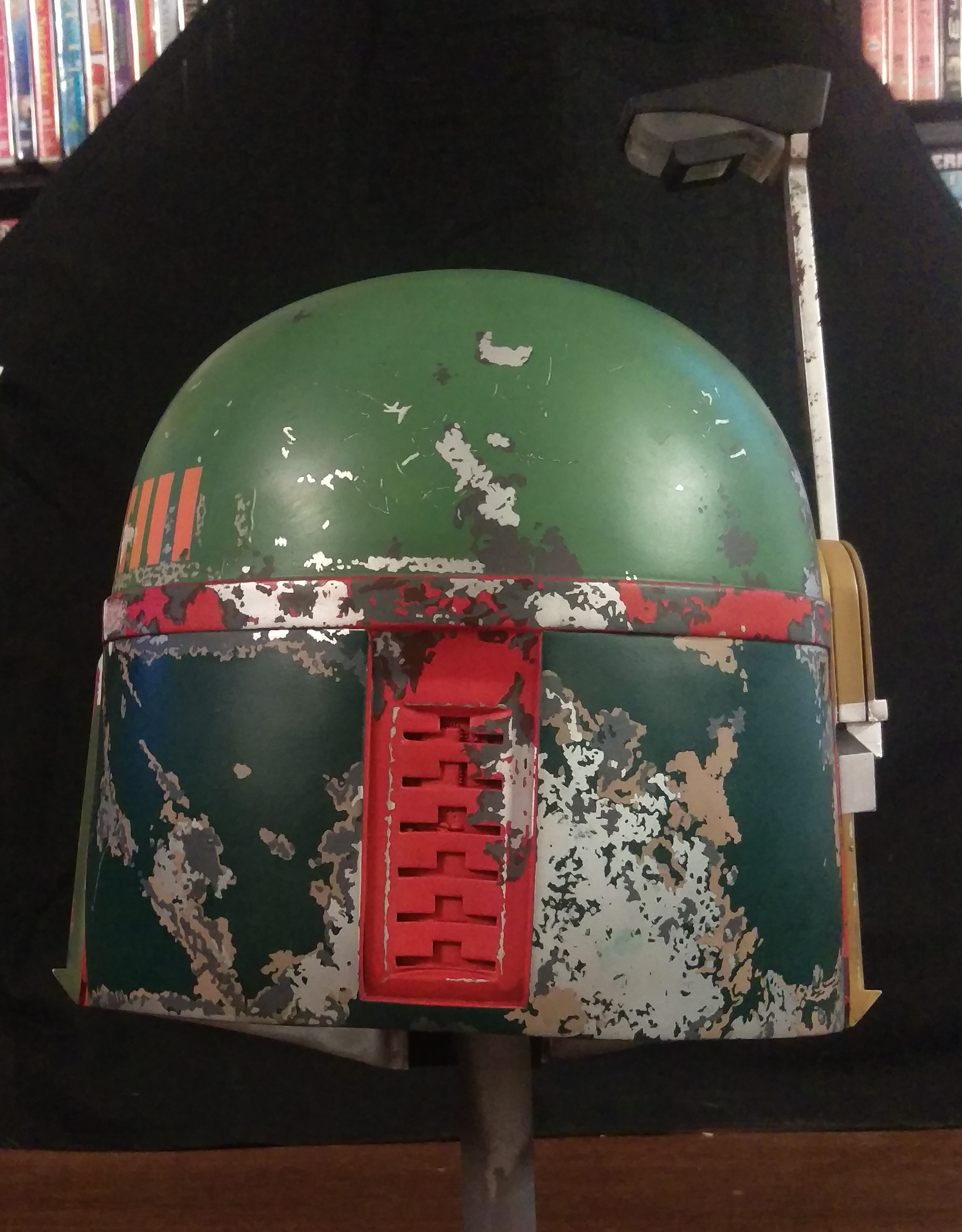

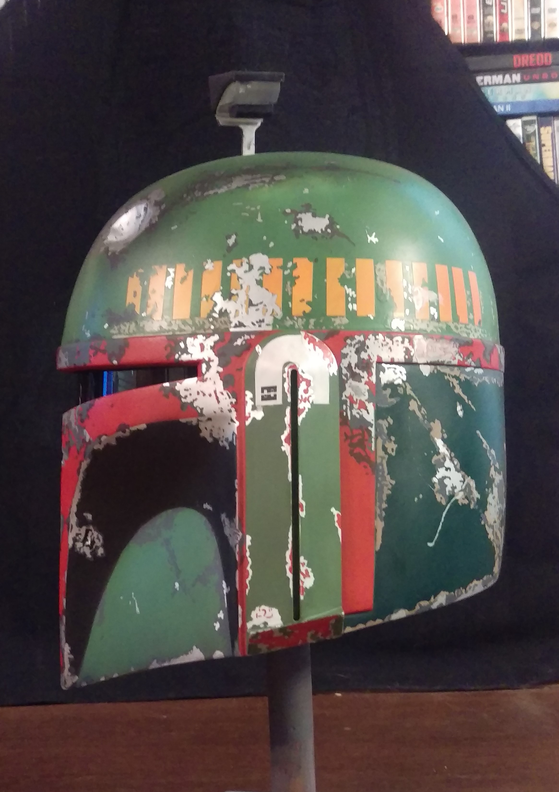

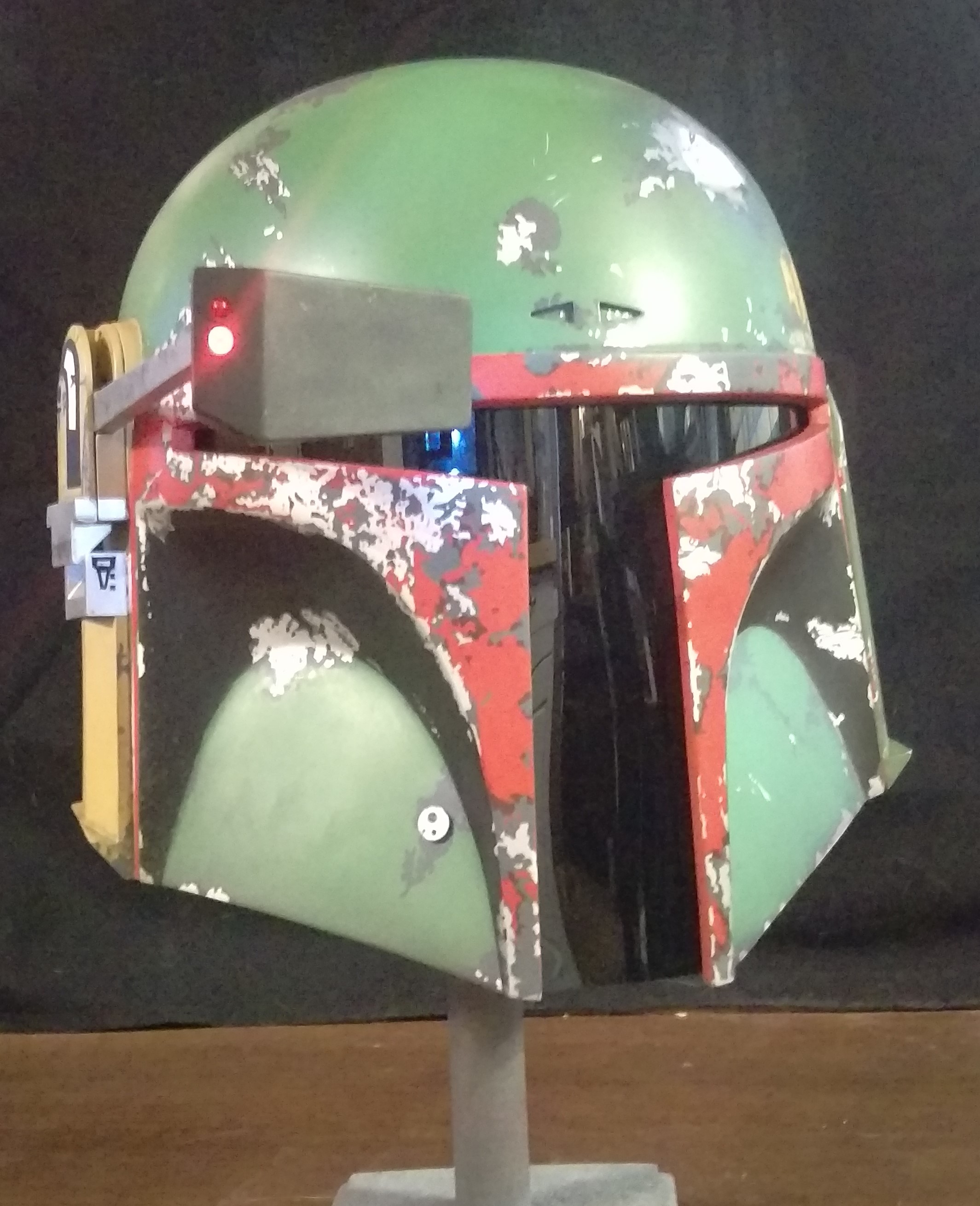

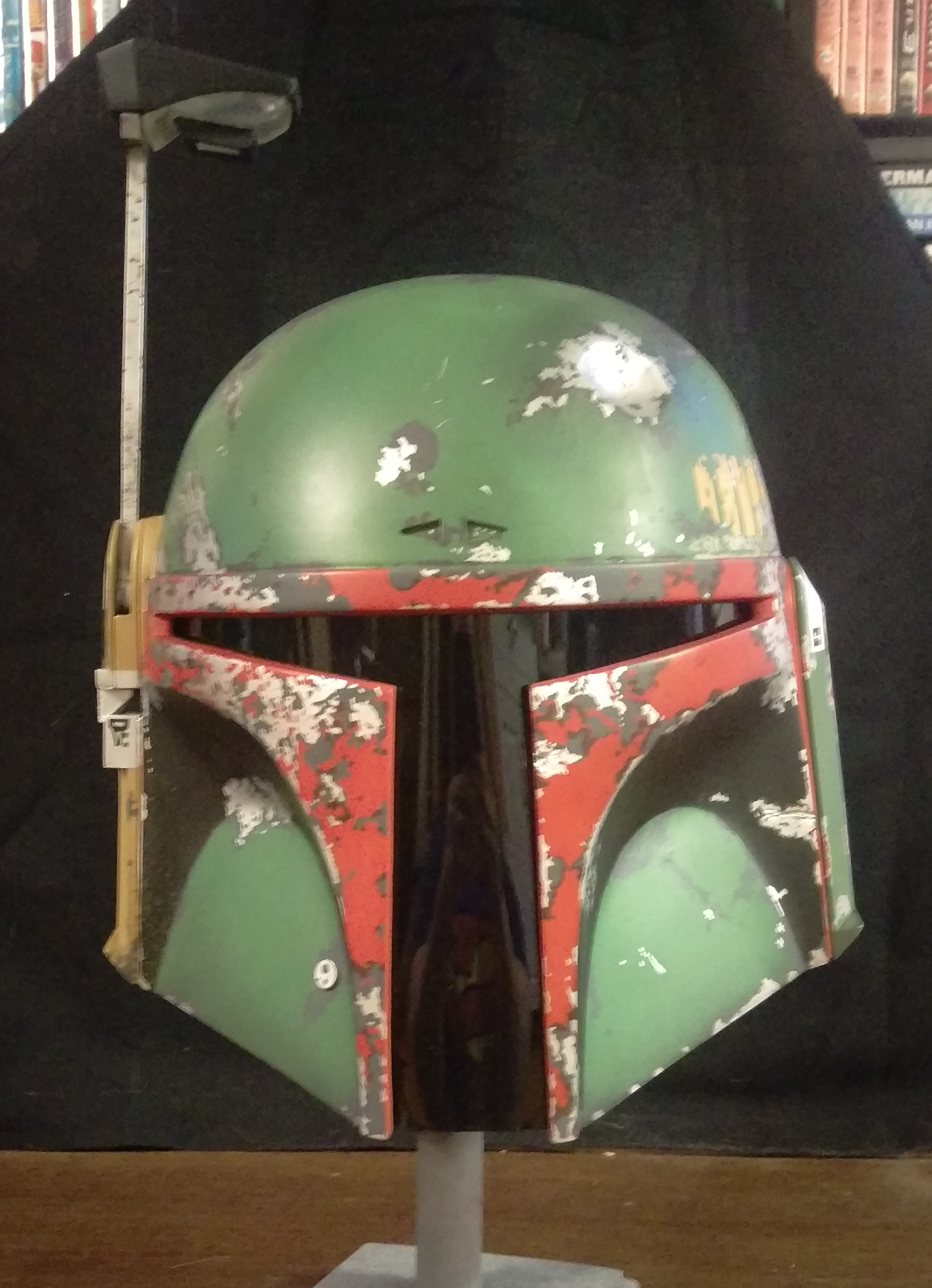

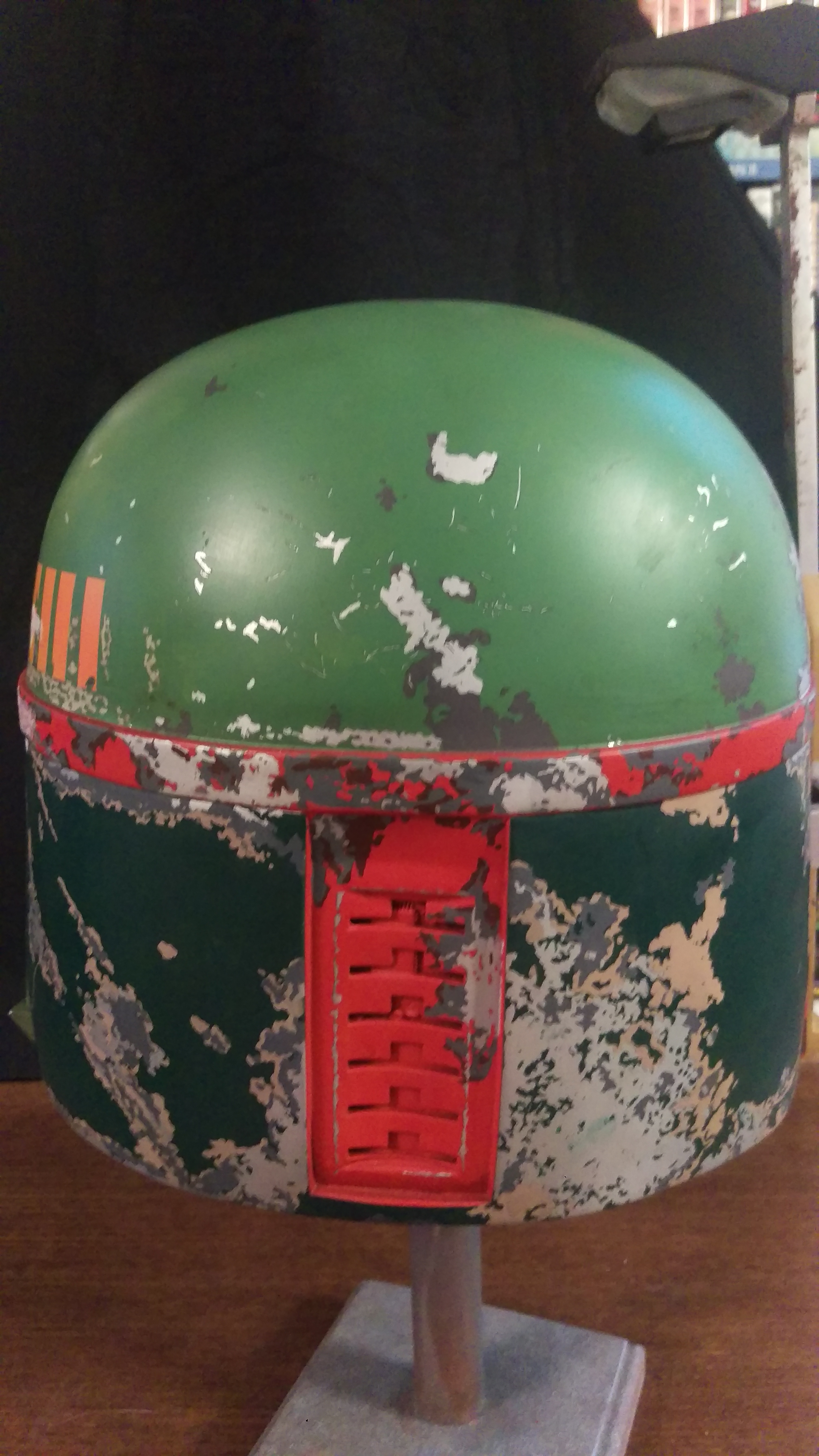

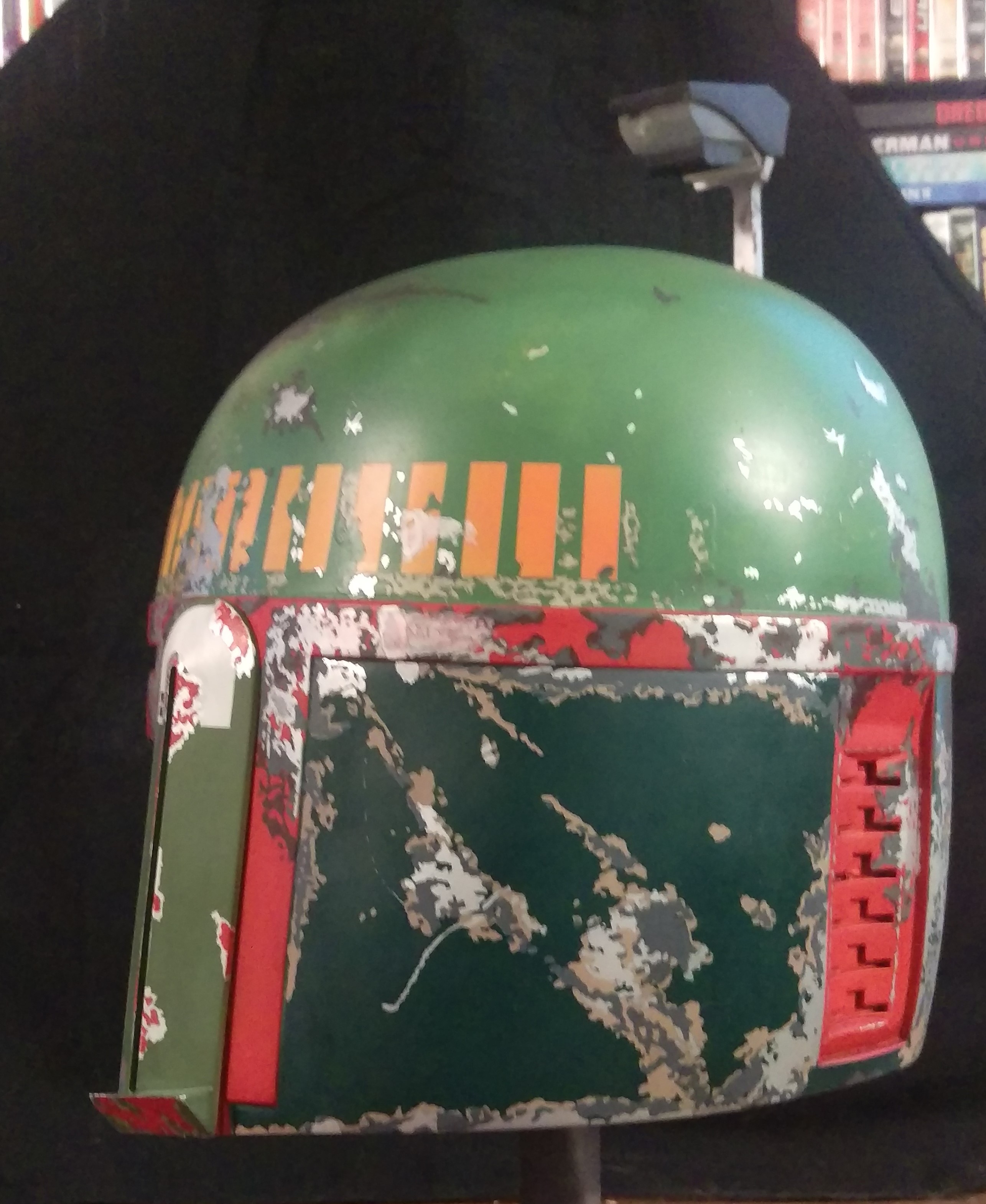

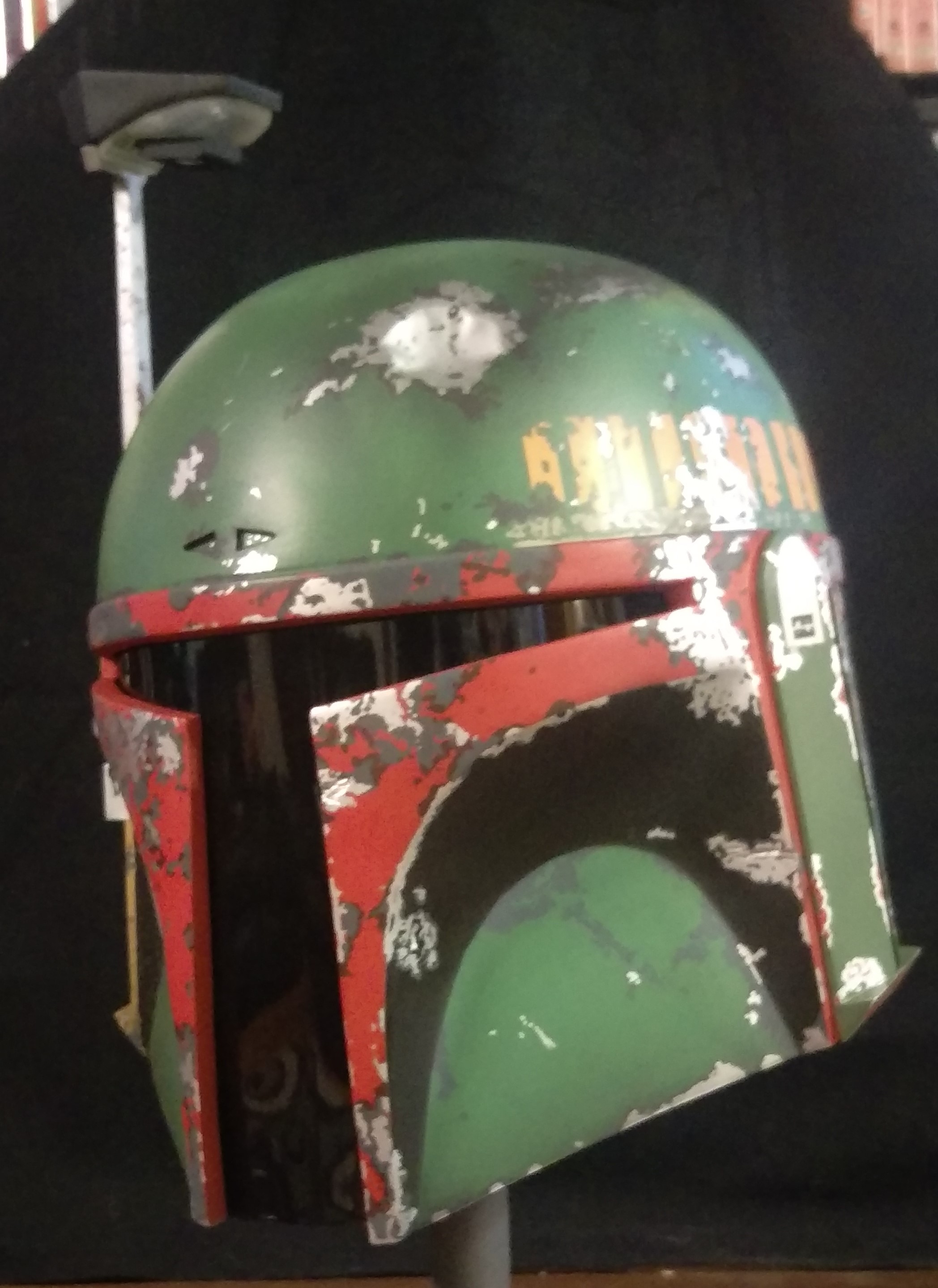

AND DONE! Well with the airbrush at least lol. Ears are finished, white paint smudges done (first time Ive ever painted them on a lid!) All that is left is an all over dirtying, the light brownish yellow smudges on the dome the "mud" spray on the inner right cheek/ ear and all of the pin head sized dots and specs inside of the mandible and back red band areas! With any luck I'll have her done this weekend!
Thanks very much for the kind words! Still a little bit to go, then I can paint and assemble the range finder and finish this bad boy off.

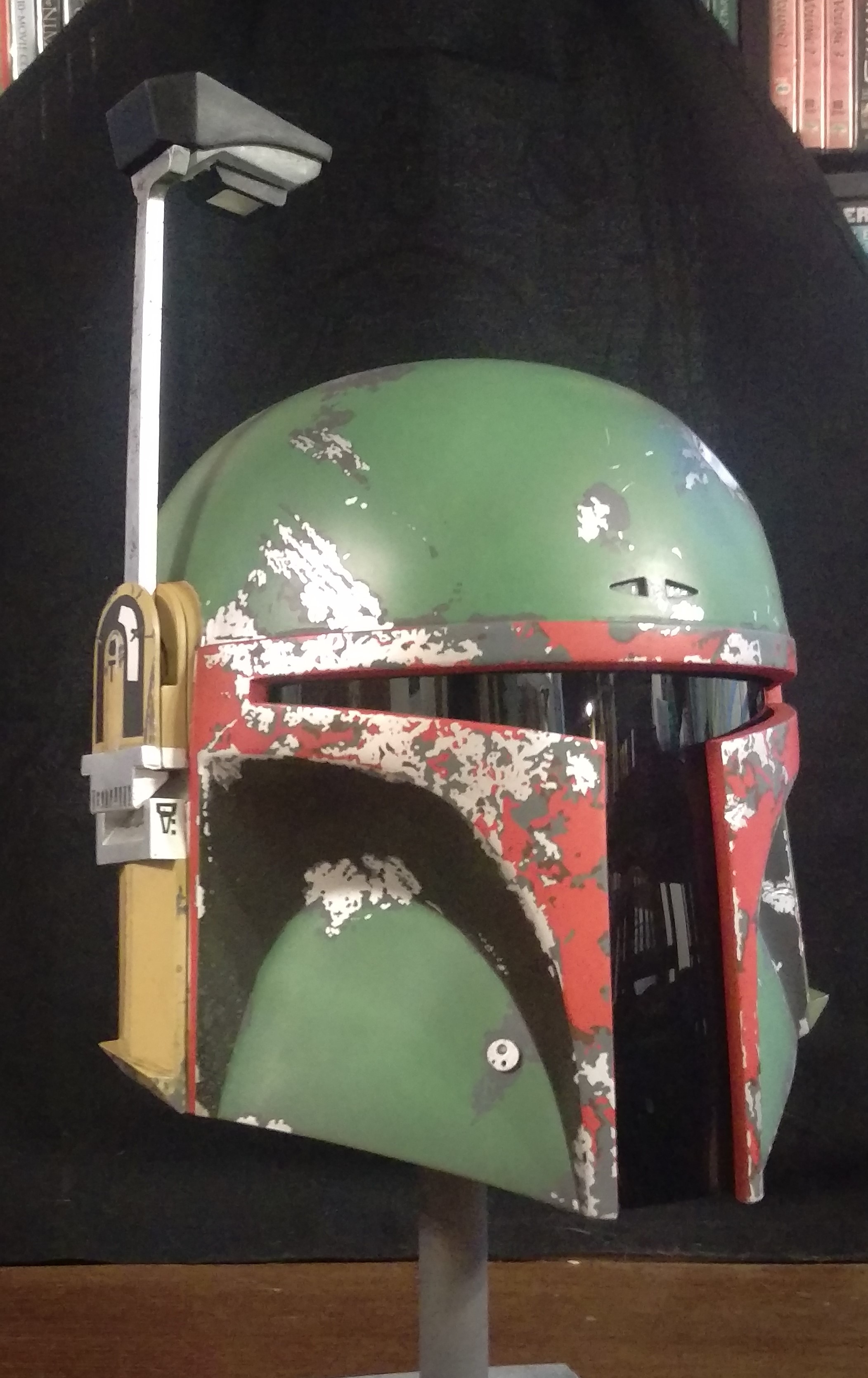

FINISHED! COMPLETE! Unless someone sees something I missed at least lol. The most detailed Fett Ive done yet. Id like to thank the following: Animefan for providing an excellent helmet from which I could make this possible, RaffelFett for his amazing stencils, whos hard work alone has helped so many create theses things of beauty, and ToEleven for helping me with some awesome weathering advice and reminding me that there is an extensive "GALLERY" from which to check my progress! Im sure there are others and I thank you all as well! Enjoy!
