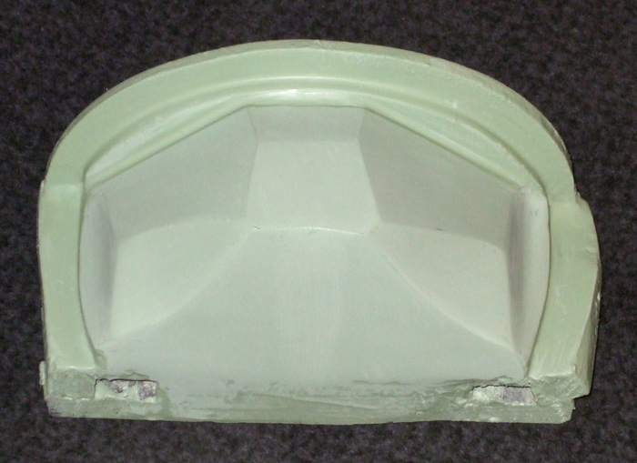

We'll know soon enough! I'm going to have a go tomorrow.....
If I can't manage it (or get as good as I'll want) then I'll have to have a rethink.
I think the former is OK though! I've just ordered some fuchsia dye so the first few are going to be the purple colour.

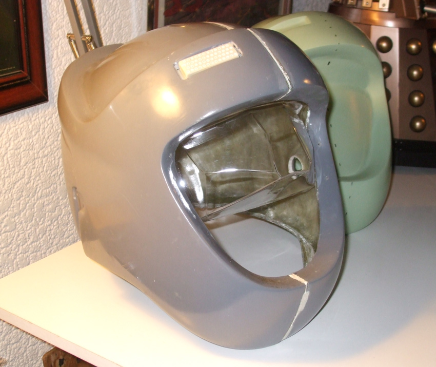

Here's the first 3 helmets and I'm trial fitting the connector (greeblie) on the brow of the grey one....
Lets see how we go!

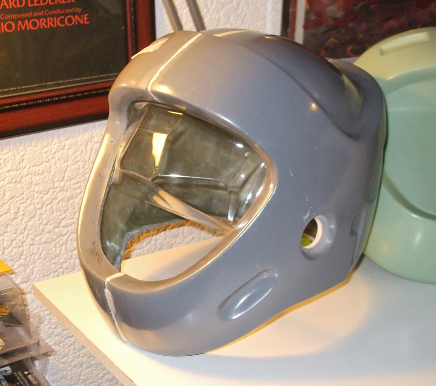

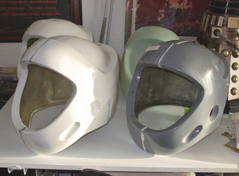

I've just done a small run of 5 test pulls with the University Vacuum former! Great bit of equipment!
It was just going to be a test 1, but I though, mmm these look pretty good so I did 5!
Here is a pic, which needs trimming down by the bridge of the nose area and colouring of course.
2mm Acrylic which seems pretty tough actually. I may even be able to go 3mm which is definitely thicker than the one in Jedi.
Frank(Y-wing fighter is having the 1st one and I bet he gets it built almost overnight!)

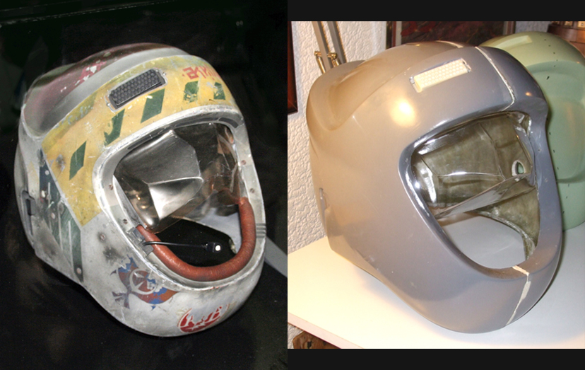

Here's a quick comparison shot. The angles of the photos are slightly different and there are bound to be some slight differences,
but I don't think its far off...

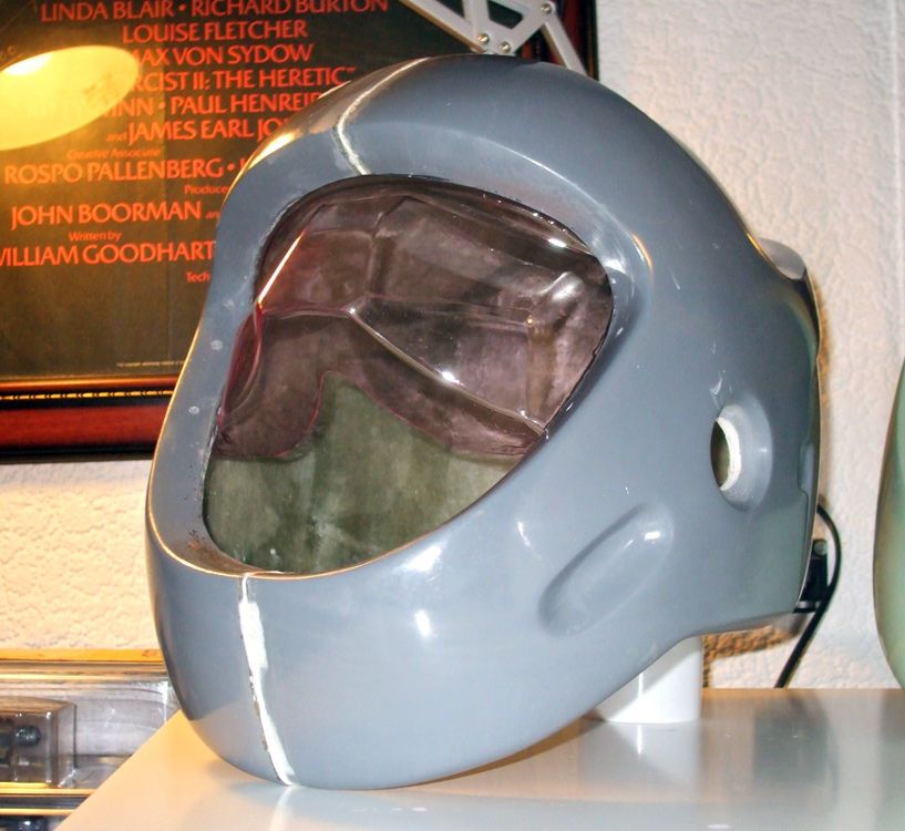

Here's todays progress with 5 of the goggles trimmed and dyed.
View attachment 58474 View attachment 58475 View attachment 58476
Looking OK!
Hard to tell with flash photography, but the tint looks good to me.
