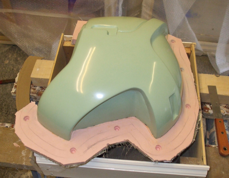

Hi, here's a quick update of the box and the cross section piece of wood just before I start with a 2 piece mould in Silicone...
Just got to close the gaps and add the pieces to align the 2 halves. Anything else I need to do? (Nate, I'm looking your direction!)

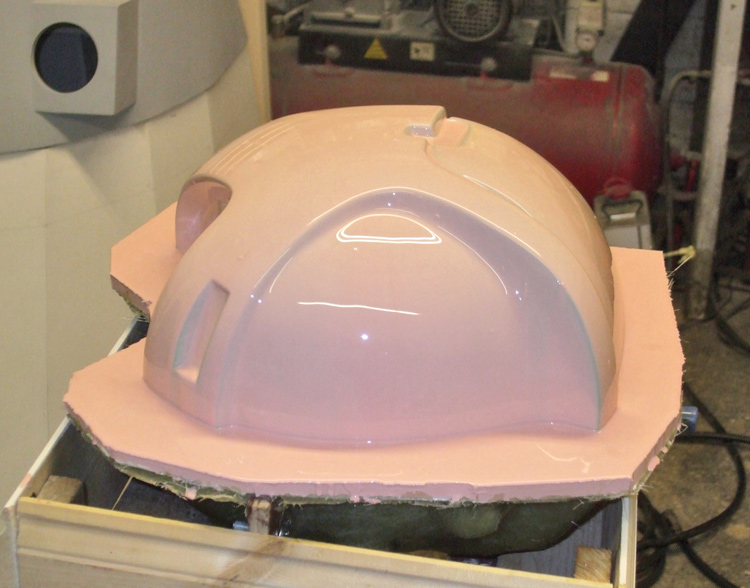

Hi all,
Here's another quick update of the process so far...
Since these pics I've removed the wooden section and will be casting the 2nd side in RTV shortly.

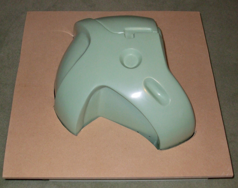

My only concern is is that MDF board you're using for your flange?
Be extra careful it doesn't get wet and possibly warp, bro!
I've removed the board since these pics. It stayed nice and dry and flat.
I'll upload some other other pics in the next day or two.
Thanks!

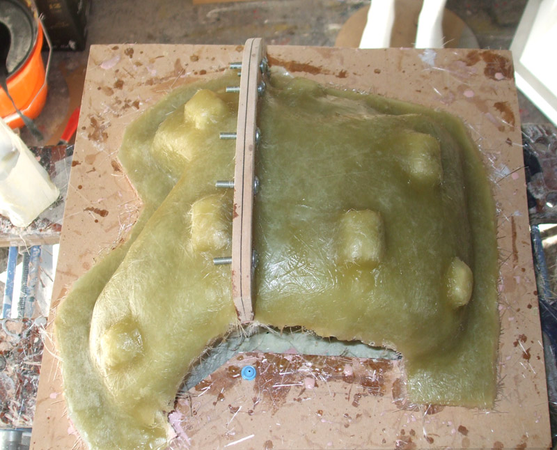

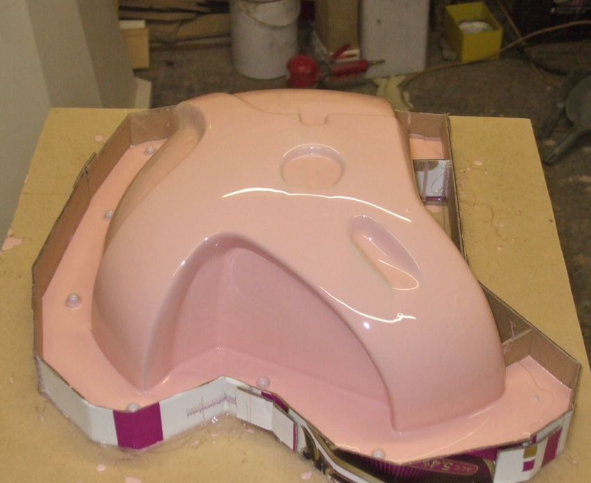

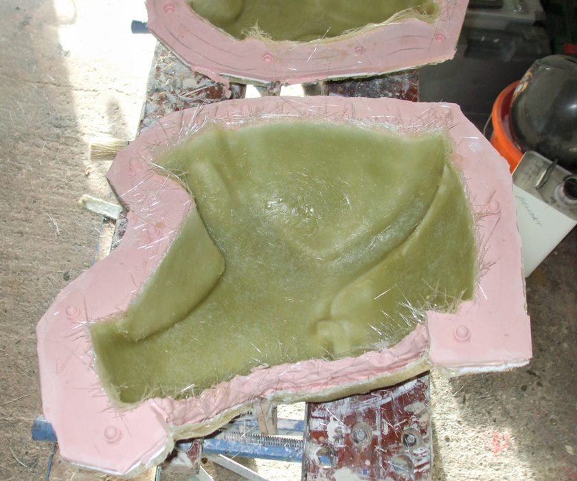

Here's another couple of pics of the progress.
since this I've done more pours and it needs just 1 more later of RTV with thixo then I'll make the jacket in glass for this side.
I will be removing the plug from the moulds this week! :)
Rich

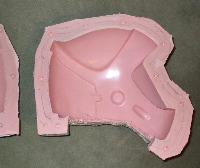

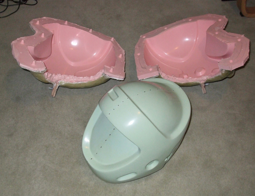

Hi all, at long last...(seemed like forever to me) I've got my moulds almost ready to go!
I removed the fibreglass mother moulds OK and the plug came out fine.
Big thanks to Nate (Heatshock) for giving me plenty of pointers as I went! Thanks dude!
I plan to go the fibreglass route and see how I go for the 1st pulls.... stay tuned rebel pilots!

Rich - was my pleasure mate, the more UK makers the better in my book ;P
mold looks excellent !!!! Very nice work mate
and dont sell yourself short mate, you obviously already knew a lot of what I was talking abt - glad I could help
good luck with your castings!

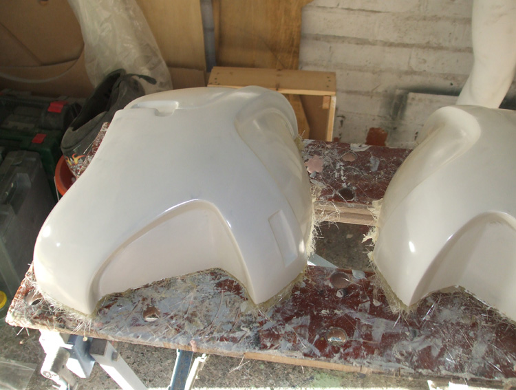

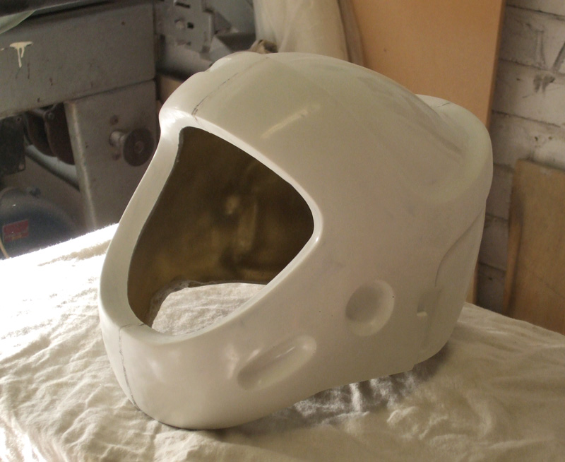

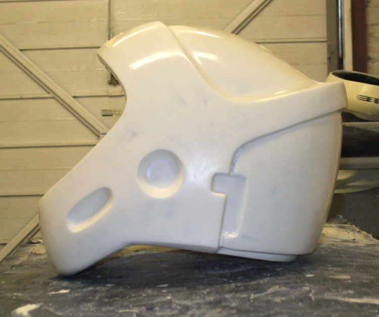

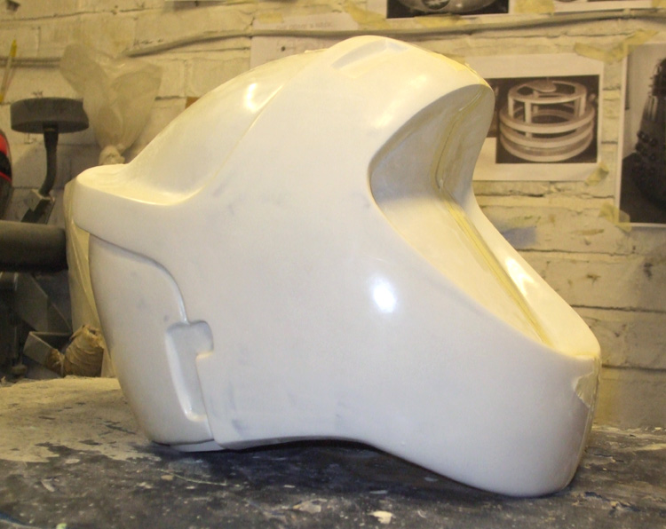

Hi all,
Having gelcoated and glassed the 2 sides late last week, I removed the 2 halves today from the moulds.
In these pics the majority of the sanding is done, just a little more to do before bonding the helmet together.
Once done it will be time to trim the front section out and starting thinking about making a former for the visor.....
Rich
This is really a good looking build.
Very clean.

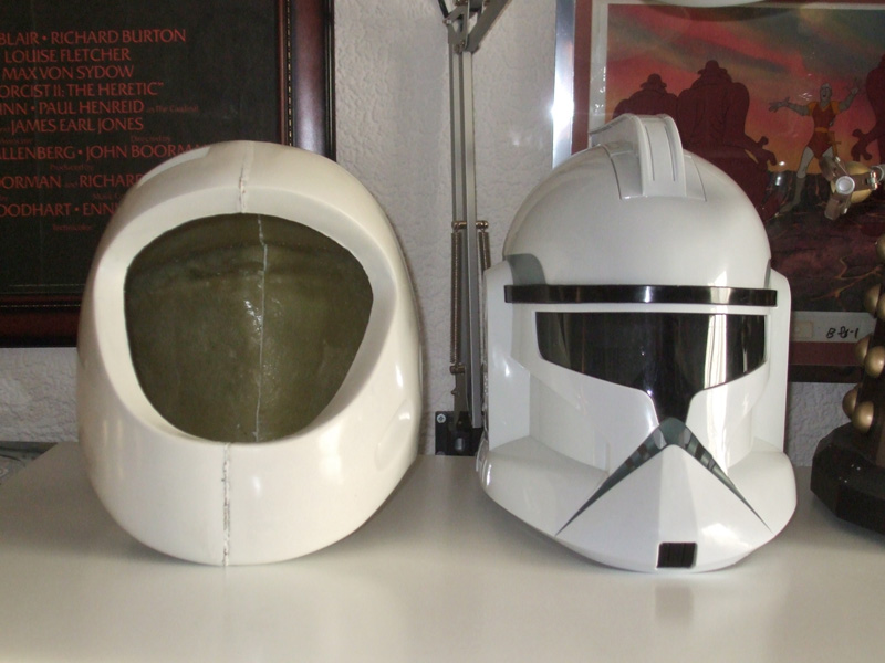

I may have missed it, but is scale 1:1 with the screen used version?
There is a Pep version available, but seems a little small.
Hi, yes full size with dimensions as close as I can guestimate!

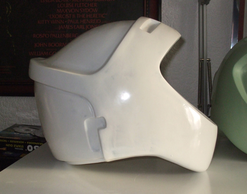

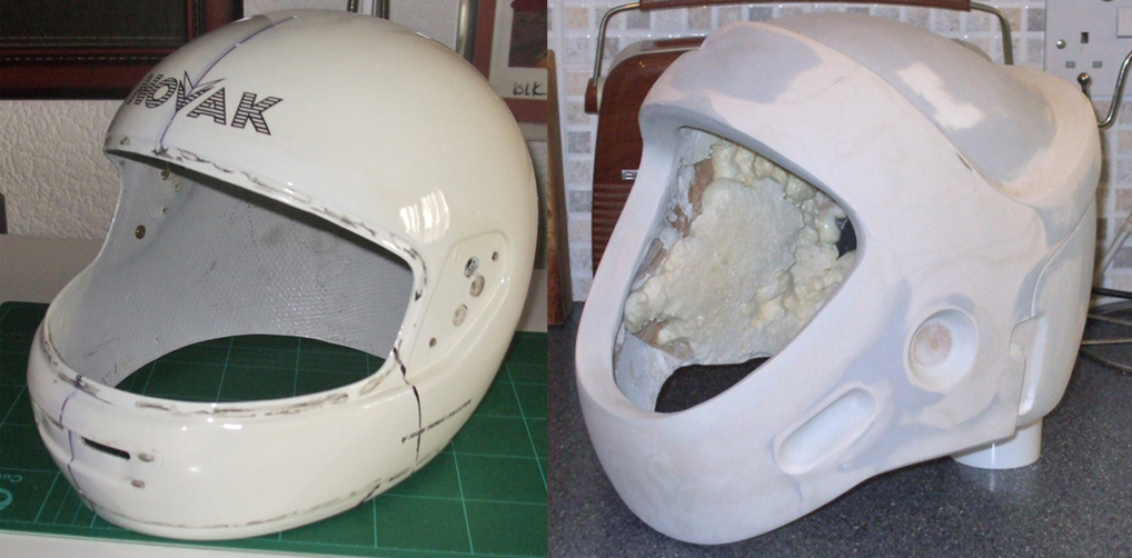

It started with a (Medium) 80's motorcycle helmet as a start point (as you can see in this picture here)
Regards,
Rich
Well I don't know how many I'm making yet (this is #1). It is a big helmet that will need padding so your head sits where it should.
It's not that its oversize and the start point was a Medium...
I'll have a measure and let you know.

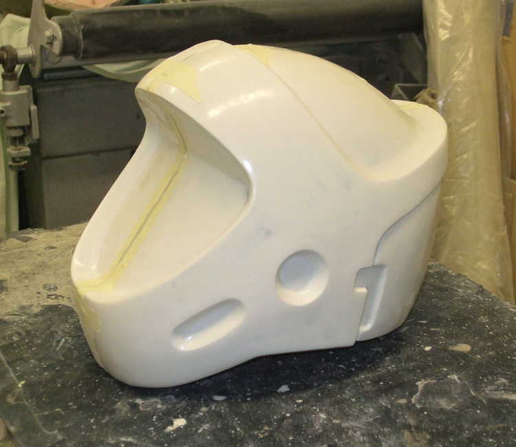

Here's a few more with todays progress.
Here you can get a good idea of scale compared to a Hasbro Clone Trooper lid.
Rich
