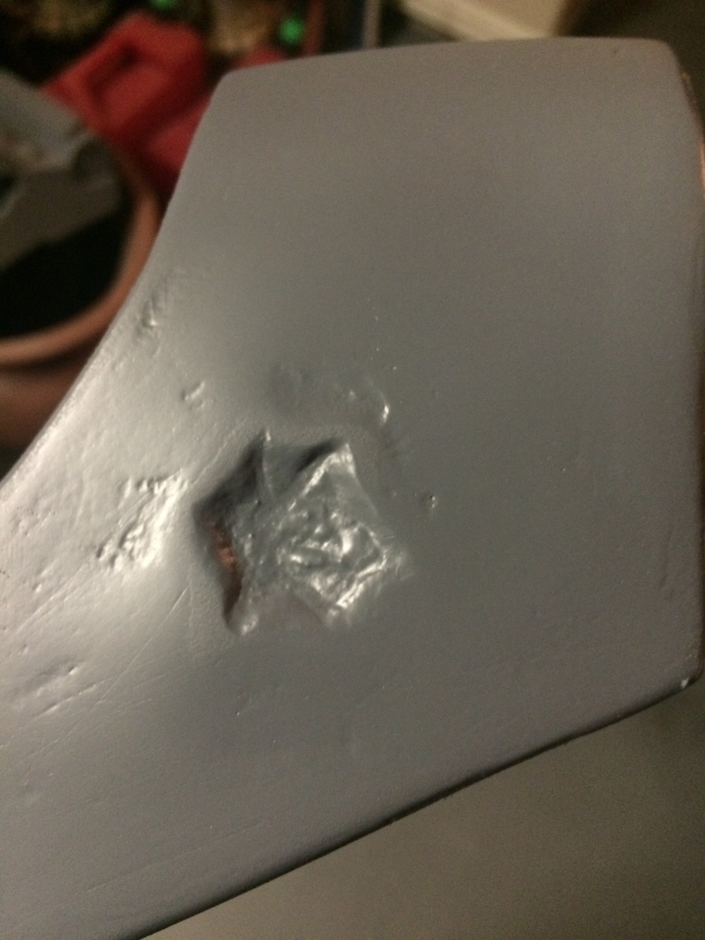

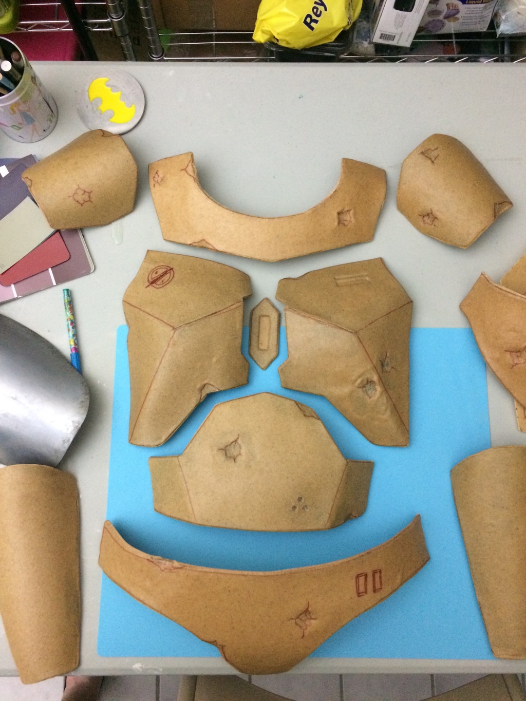

The armor was designed and made out of worbla and craft foam. It's fairly sturdy and holds up well. I have worked with Worbla before and thought it would be a good alternative to sculpting and molding. Plus she already had a few sheets so that cut down on cost as well. I got the collar, shoulder bells, chest, ab, cod, and butt plate made. The backplate will be made shortly. I have been working all day today getting the worbla smooth for a armor finish. The process is as follows:
1. Trim and sand edges to a smooth surface.
2. Apply wood putty (elmers without sawdust filling). This is just to fill in that "orange peel" texture. You really don't want to use it like bondo.
3. Sand the dried putty till it is smooth.
4. Apply a few coats of Golden's "Hard Sandable Gesso." This is like a creamy white paint. I applied it using a cosmetic sponge and sanded with 220 grit between each layer.
5. Apply a few coats of Shellac. I sanded this with 320 grit in between each layer.
6. Apply a coat of primer and paint the pieces as needed.

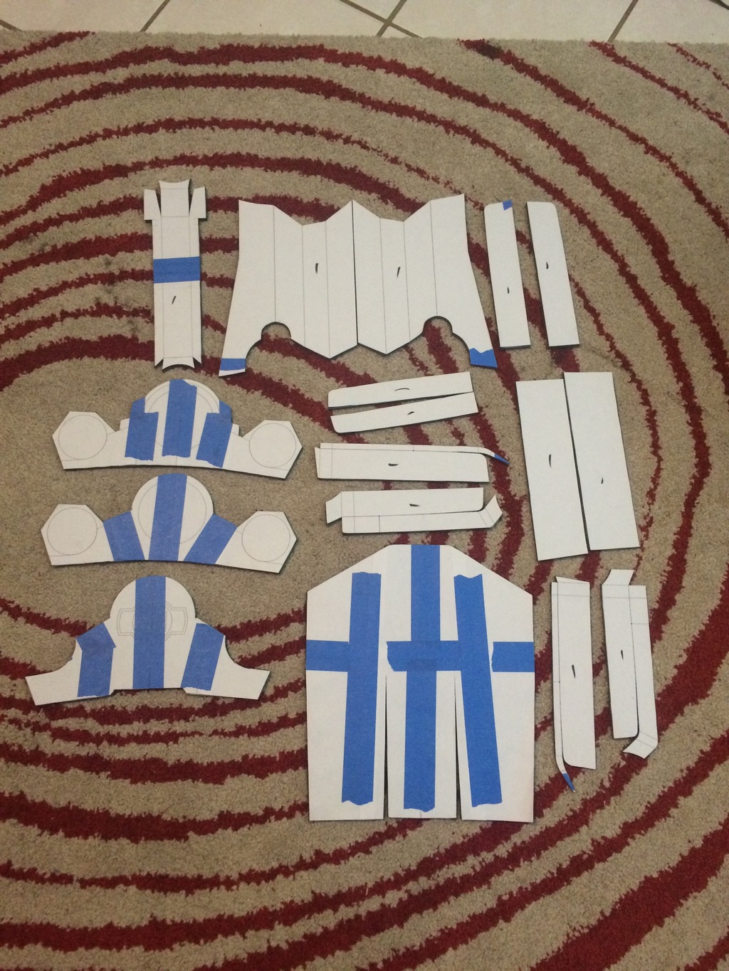

Here is a quick photo of the start of the project.

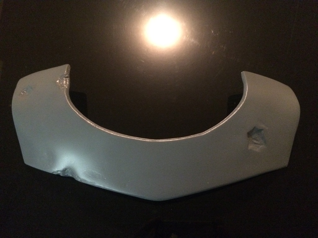

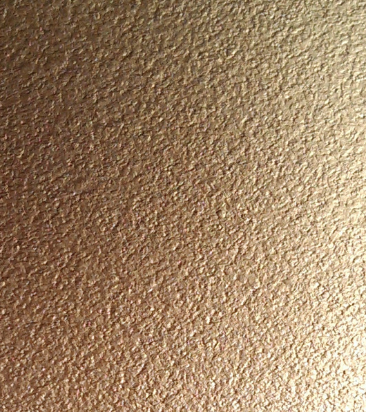

Ok so here is a quick update. I'm still finishing up the last bit of the armor today and will have it ready to paint around noon. I wanted to show a quick picture of the work that is paid off. Now I know this isn't completely smooth in some areas but I wanted to have some areas with battle damage so thats why there are a few "imperfections." Other than that I'm very happy with the outcome of the work. I have pulled a quick picture from the internet of what raw worbla looks like. The best way I can describe it is like an orange peel. It has a lot of dimples and texture.

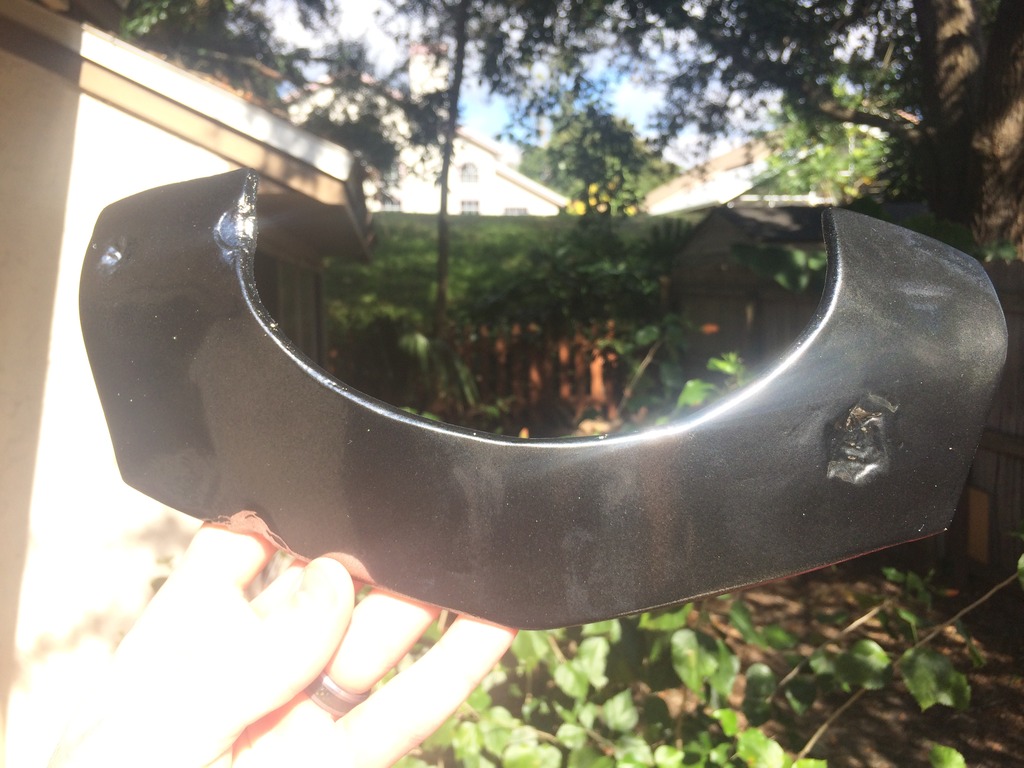

So here is my collar plate I did with the steps listed above.

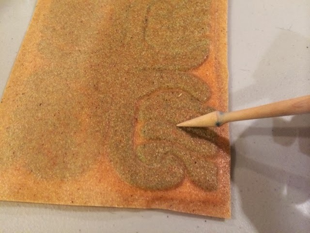

And here is a few samples of what raw worbla looks like. One piece has straight gold paint on it and the other is just in its raw state

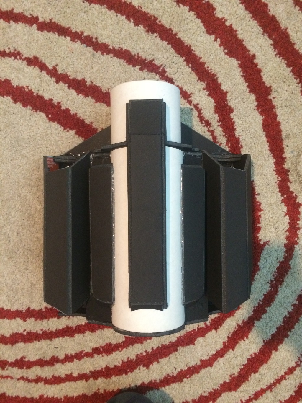

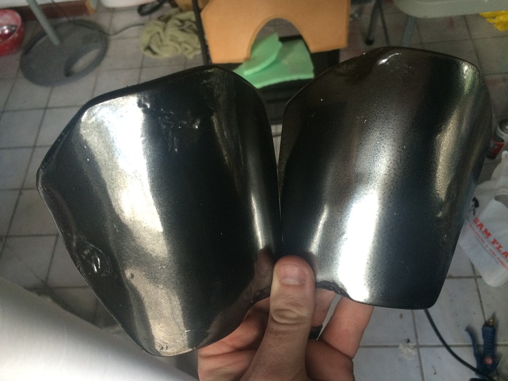

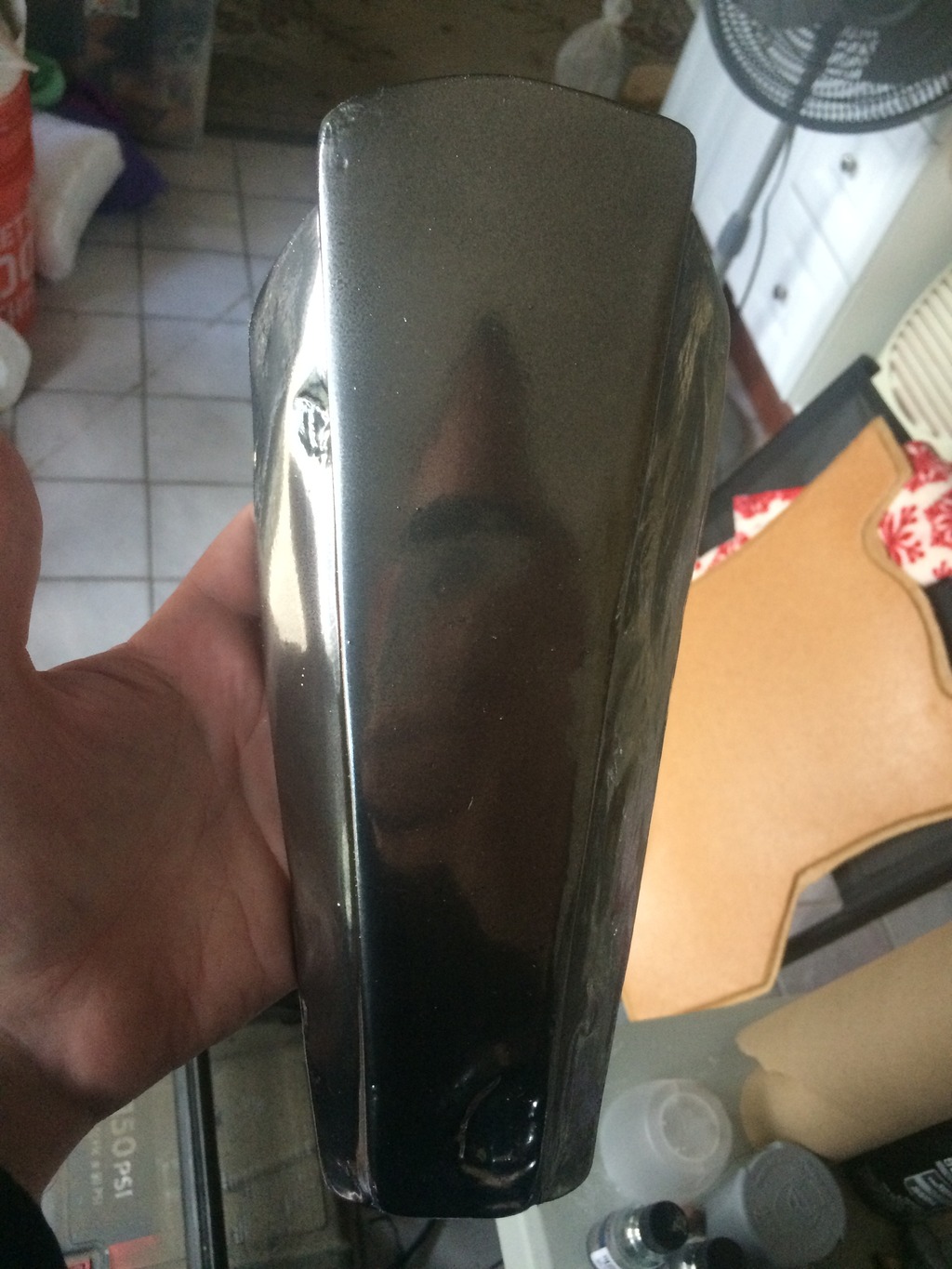

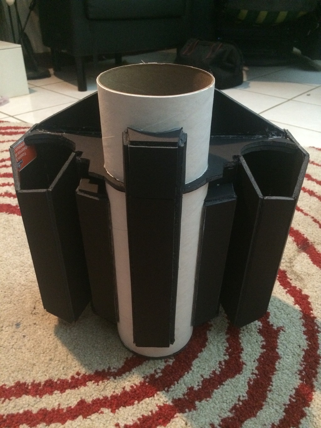

So it's been a long week but I finally got some time to work on this project. It's coming along quite nicely. My friend is pumped and we are excited to see it all come together. So what we have done so far is chrome the armor, pick out our paint colors, and started work on the jetpack. We decided to go with a gun metal chrome in stead of a true chrome for the damage. Thought it would bring a unique twist to the costume. I know the color looks black but it does have a metallic chrome look to it. The jetpack is a take on the traditional pack but we slimmed it up to fit my friends slinder frame. We are also going to add a few custom features to add a different look to it all. And lastly, we picked up the paint colors. I have labeled them so you can see how it will tie together. Now to the pictures. =)

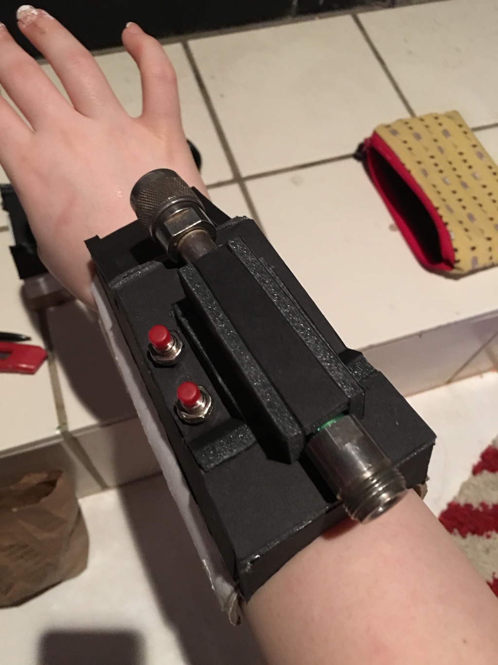

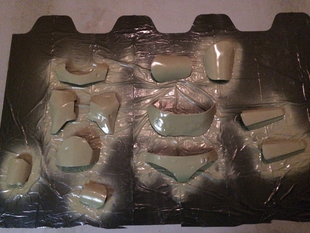

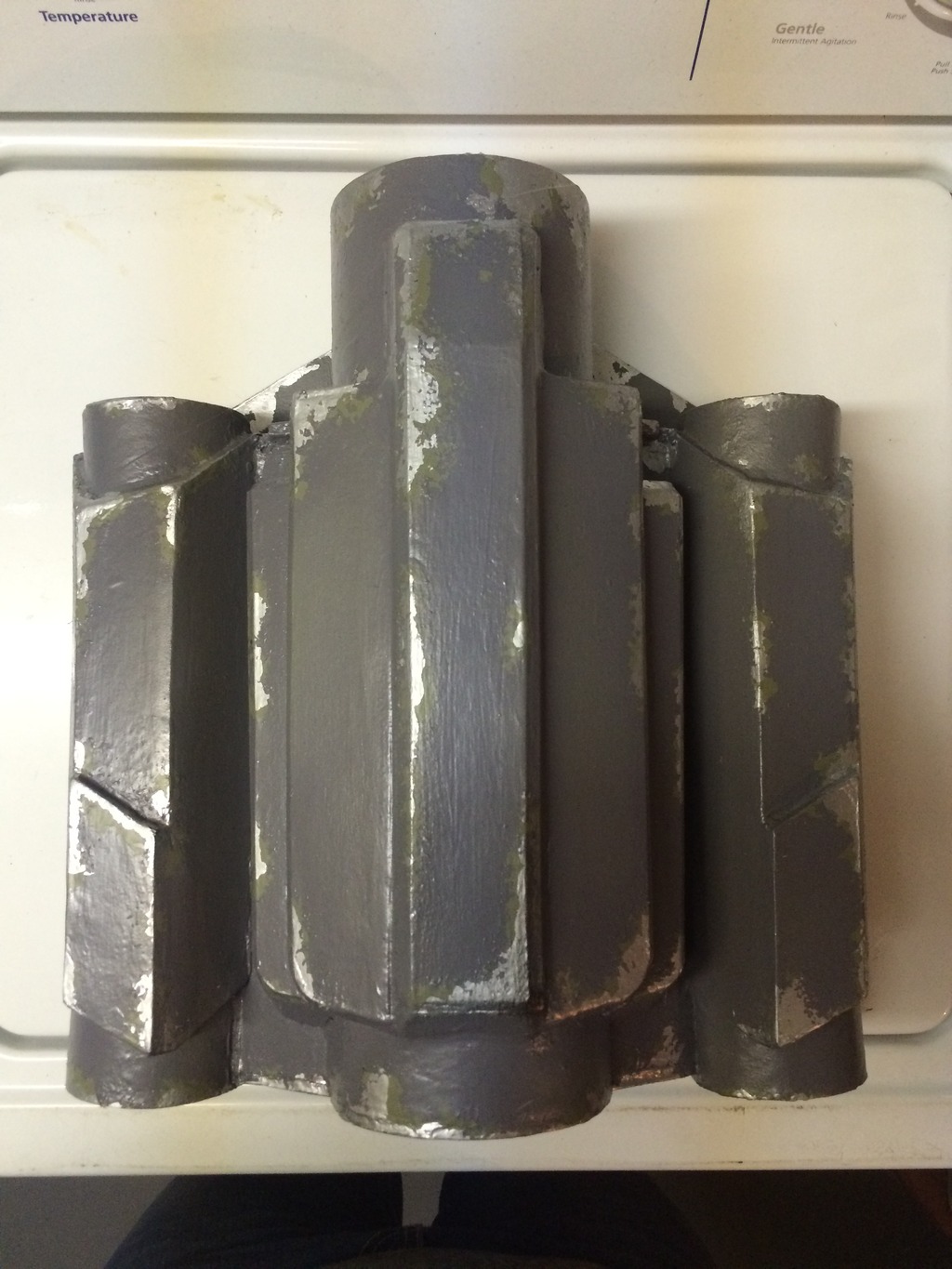

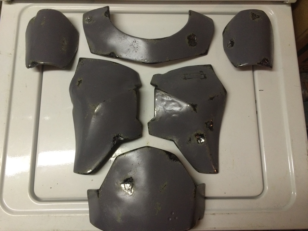

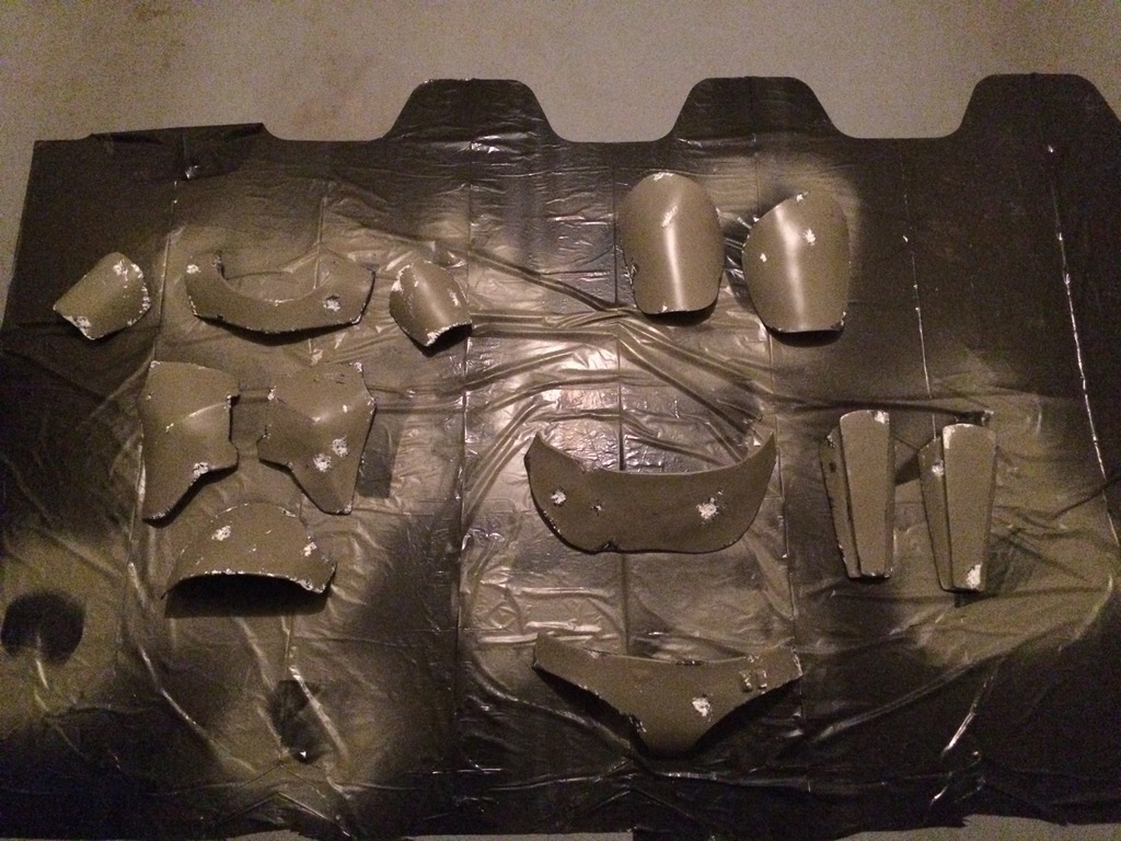

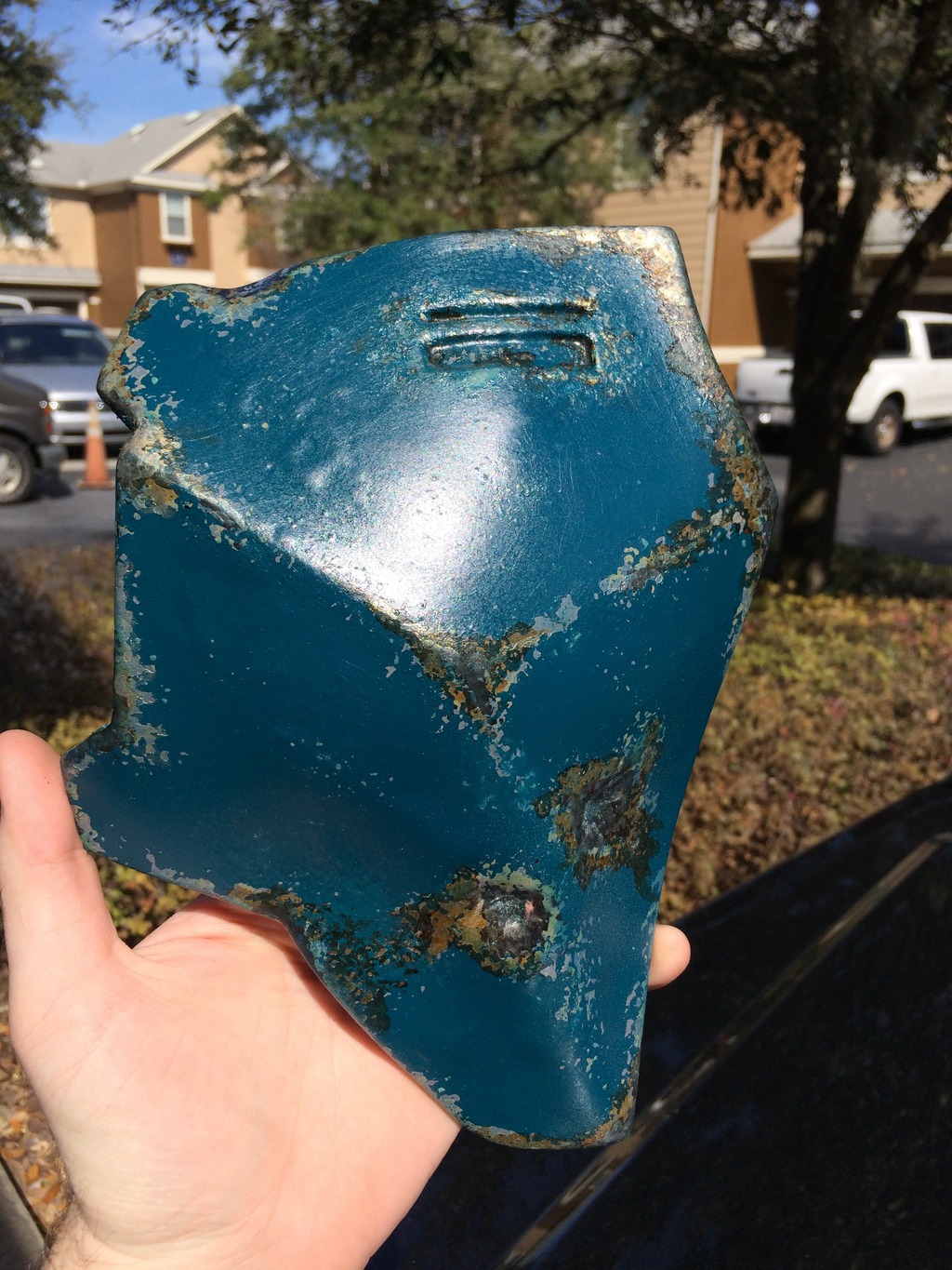

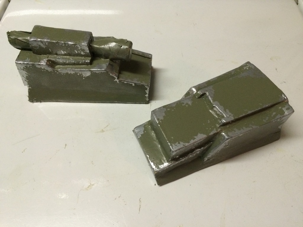

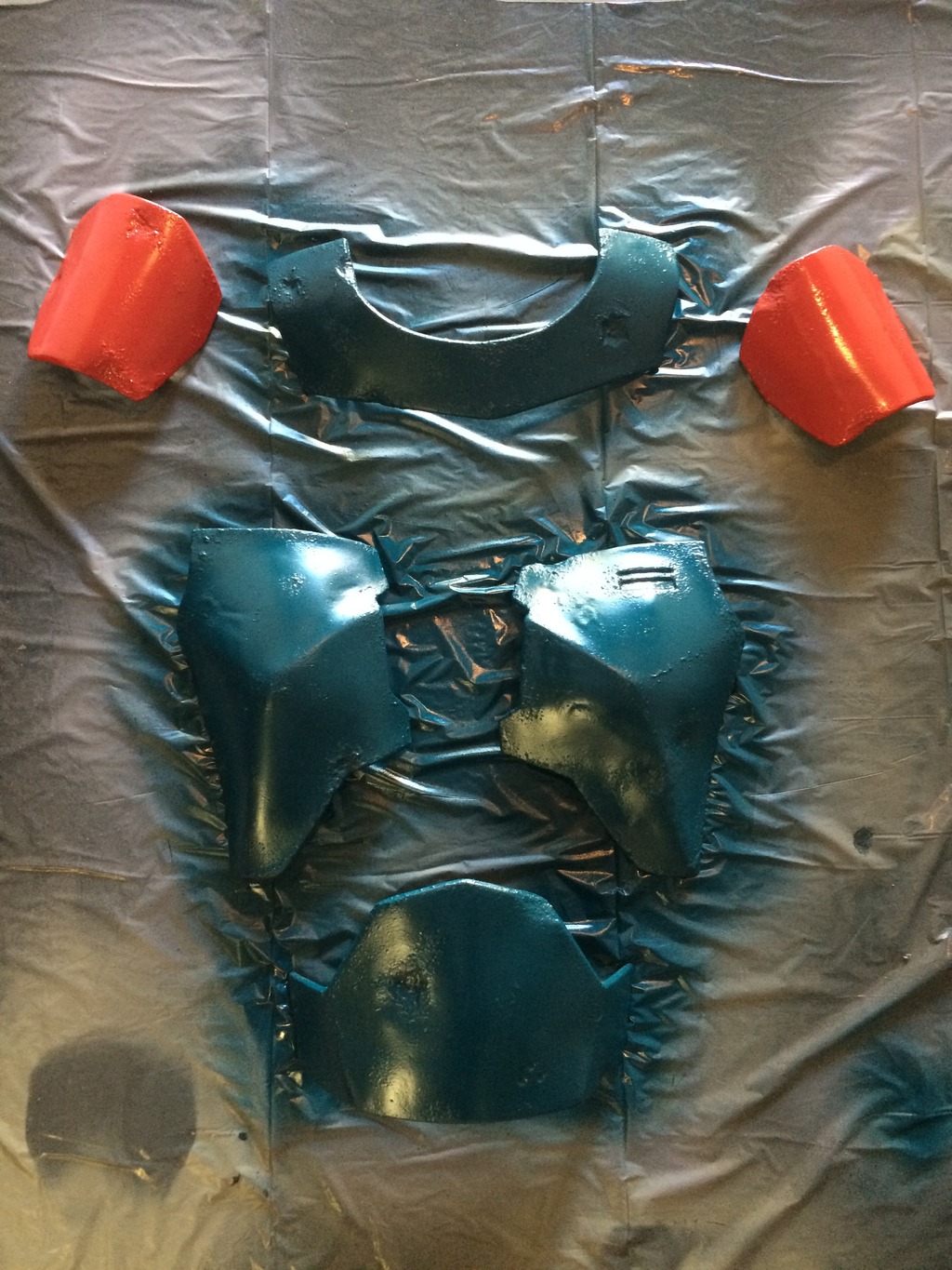

So after a long time away from the computer I can finally update some progress. It's been a long few weeks but I think things are taking shape. I got the armor paint going. Got the first few layers of paint on and just put the last layer paint on. I just have to take the latex off and will update some pics. I got the helmet going but need to get some pics of that. A basic kit my friend was making so I grabbed one from him and need to get it primed and painted. The jetpack has been refined a bit and have been filling in the gaps. Got a basic shape for the gauntlets. They are so tiny. :lol: But they fit my friend just fine. Will refine those down and will start filling them in and ready for paint. My friend is working on the soft parts and have ordered them. We also got the leather holster started but will take pics as that comes to shape. Enjoy. =)

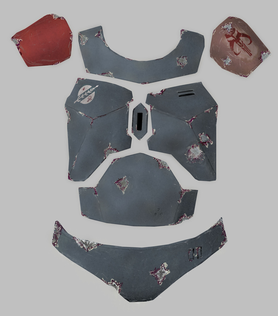

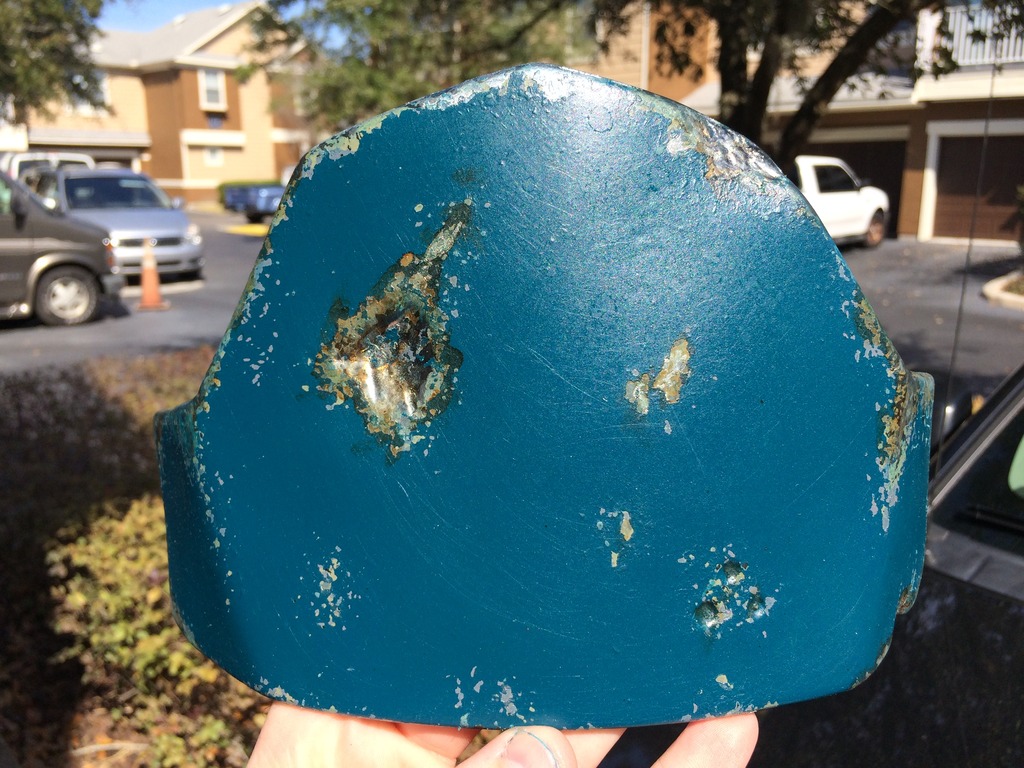

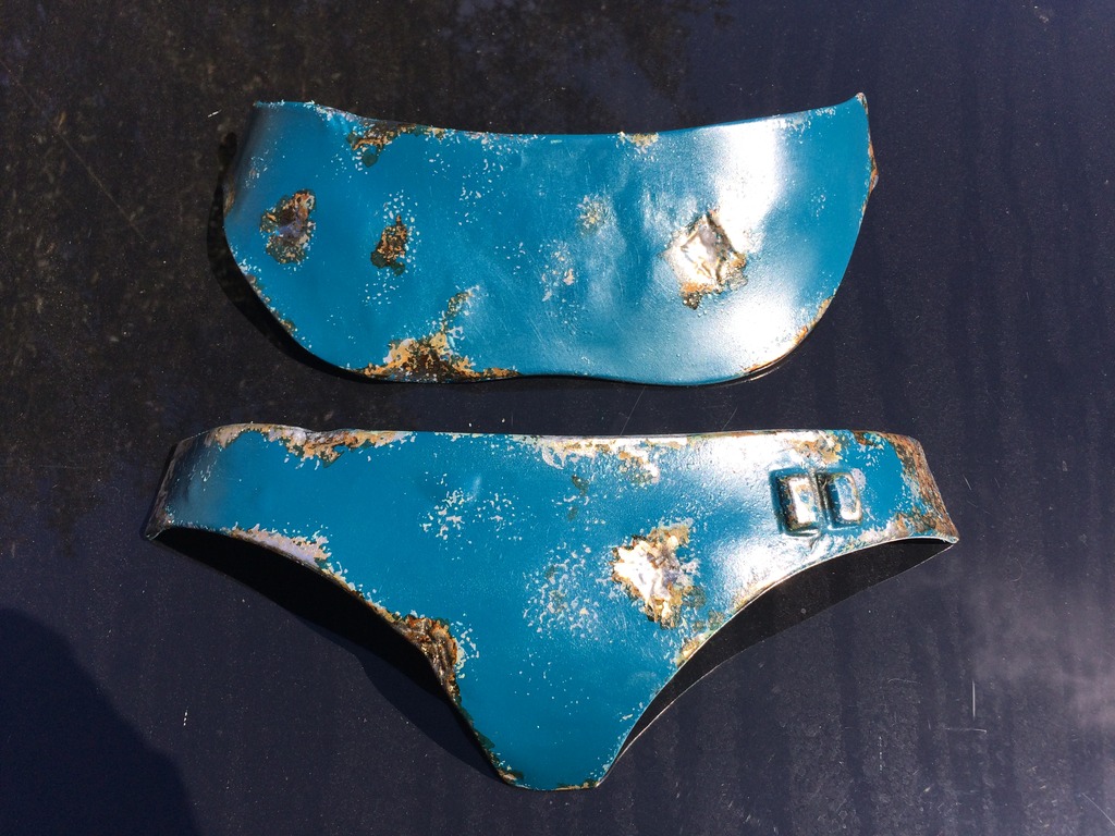

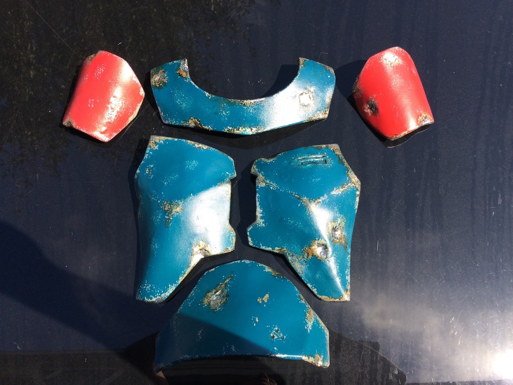

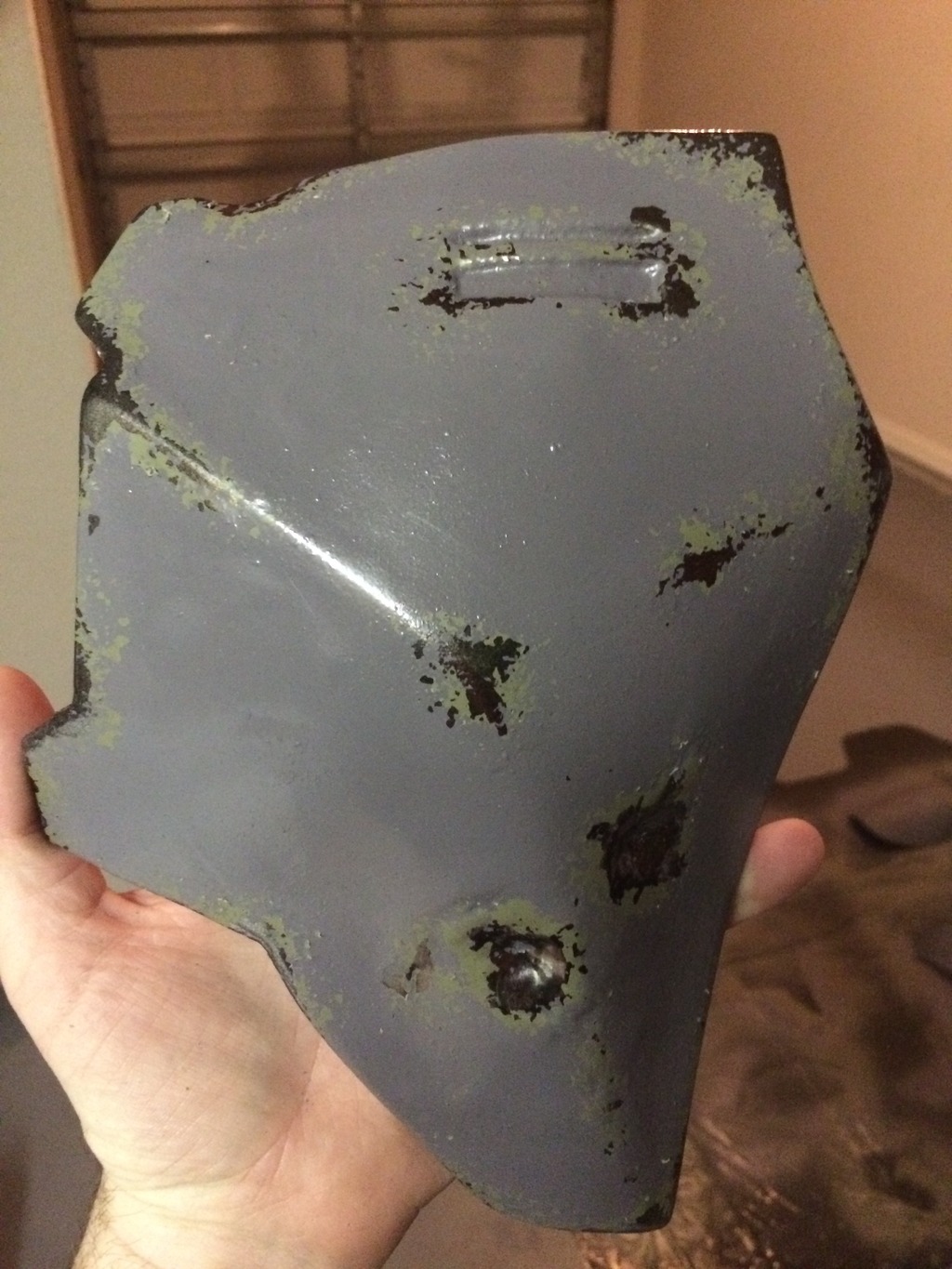

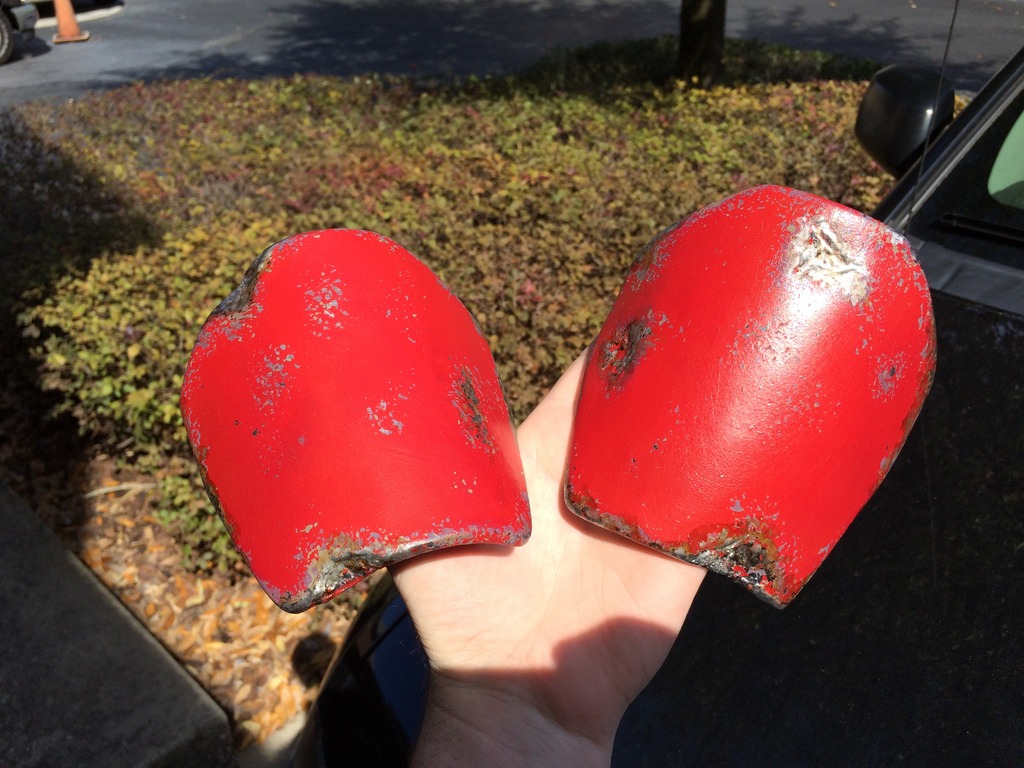

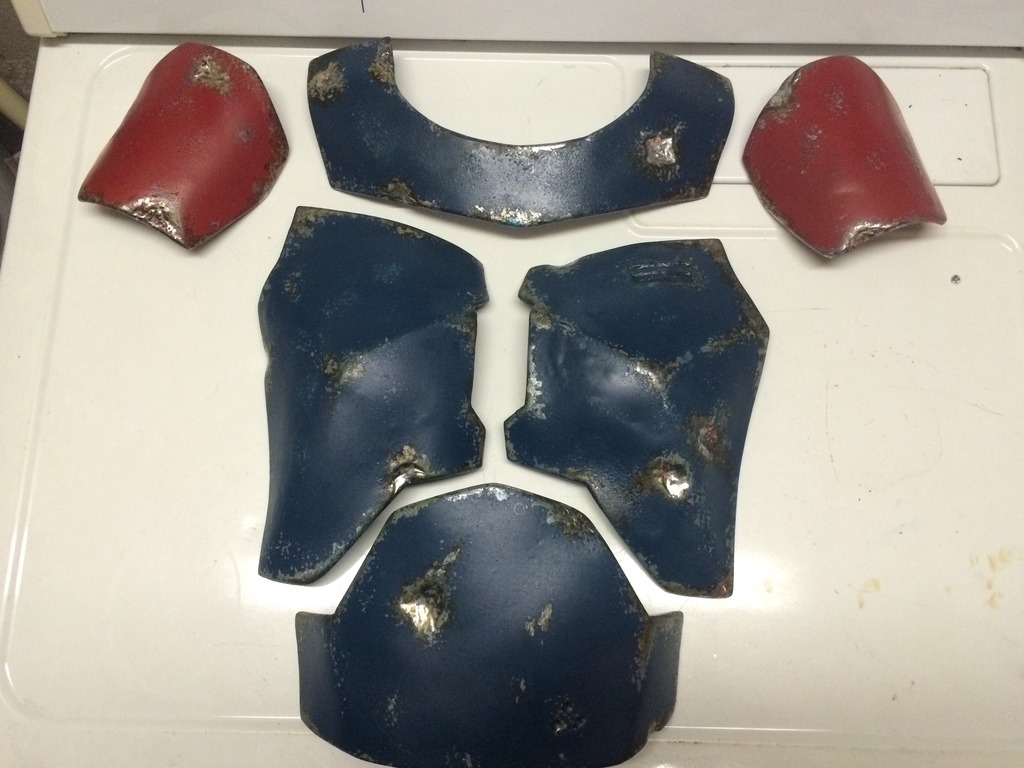

So I wanted to update the progress on the armor paint job. Removed all the latex and did some minor weathering to it. Honestly I think its too much "chipping" and may need to tone it back a bit. Should't be hard to do but just a little time consuming. Anyway, would love your opinion on things. Any bit helps.

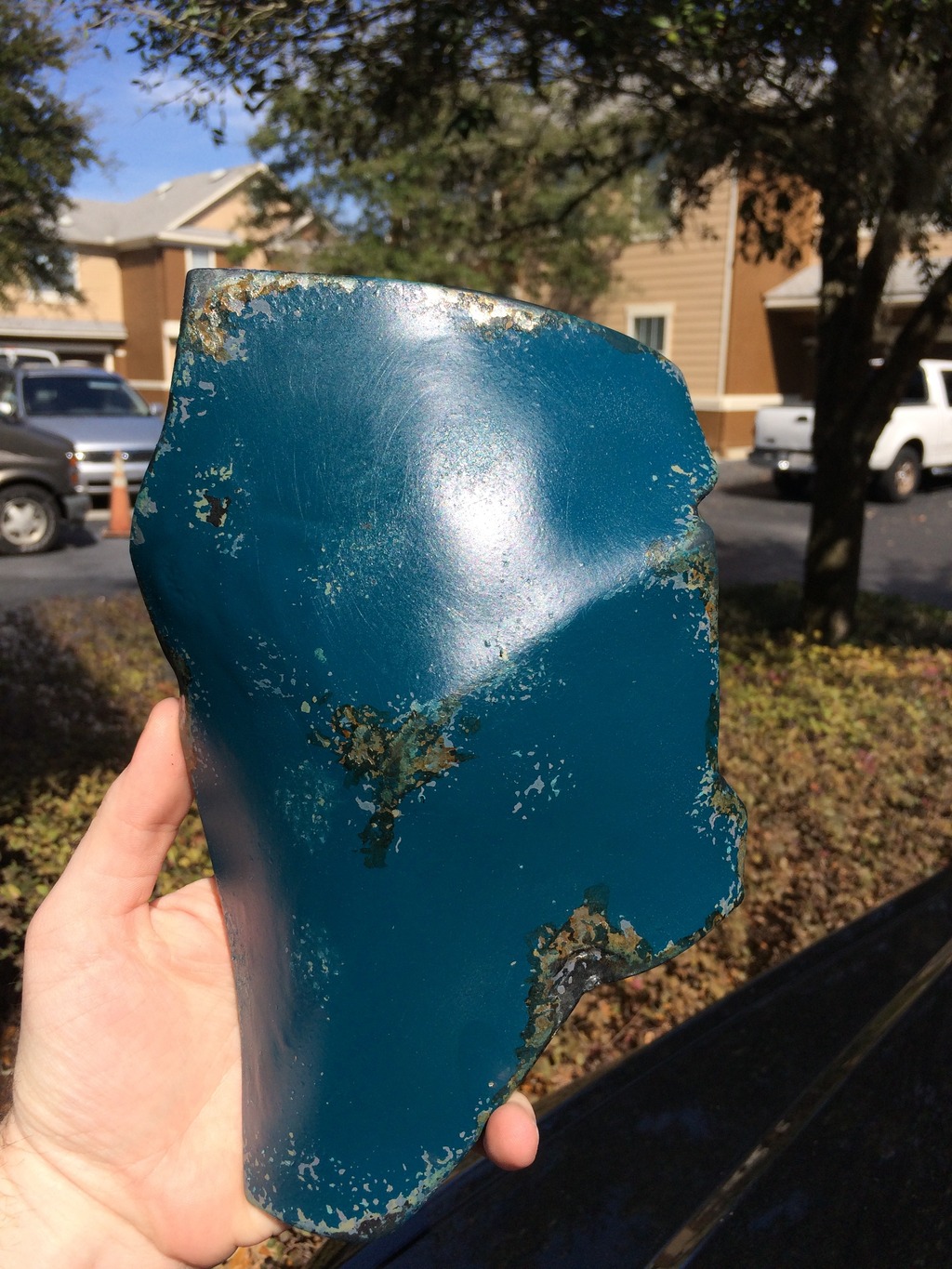

I got a few pictures of the armor in the sunlight. Wanted to show the pieces in actual light rather than garage lighting. Still not too sure about the amount of damage but will cross that bridge soon.

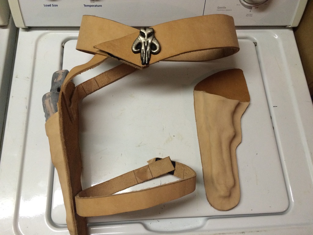

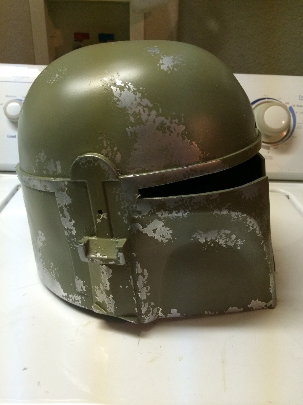

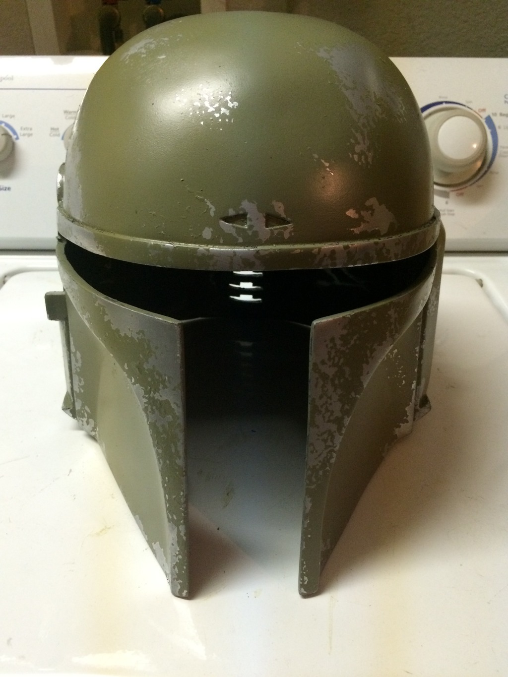

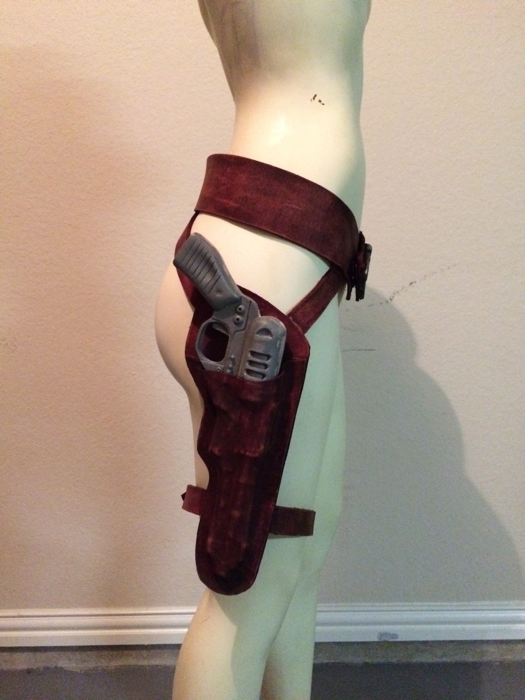

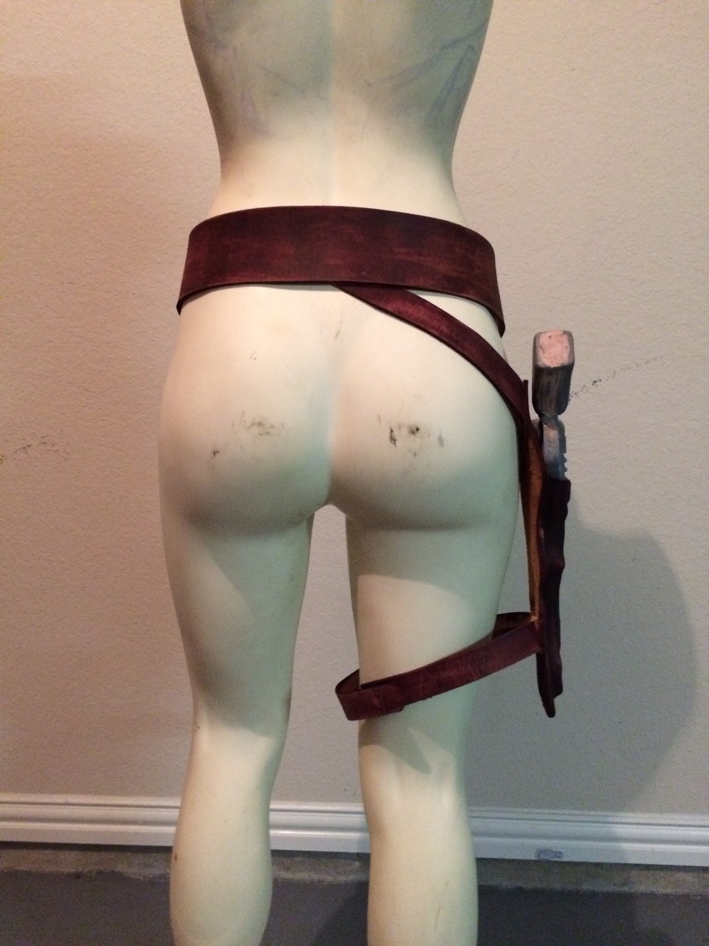

So we are getting to the end of this project. Just a few days out. But I wanted to take a moment to update our progress and show off some photos. New to this addition is a leather holster. Whipped this up in a day. Still have one holster that needs to be attached to the other leg but it looks good for now. I stained the leather a mahogany color and did a little distressing. The emblem on the front buckle was made from worbla and painted with some gold and black paints. The helmet started to get some paint on it and will finish that up later tonight and tomorrow. The gauntlets and jetpack are getting paint as well and will hope to have it all done by wednesday.
