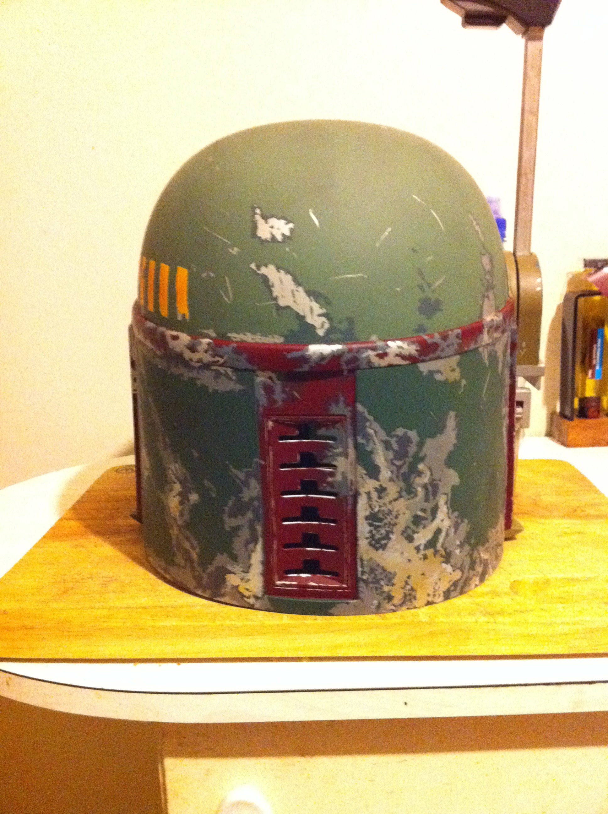

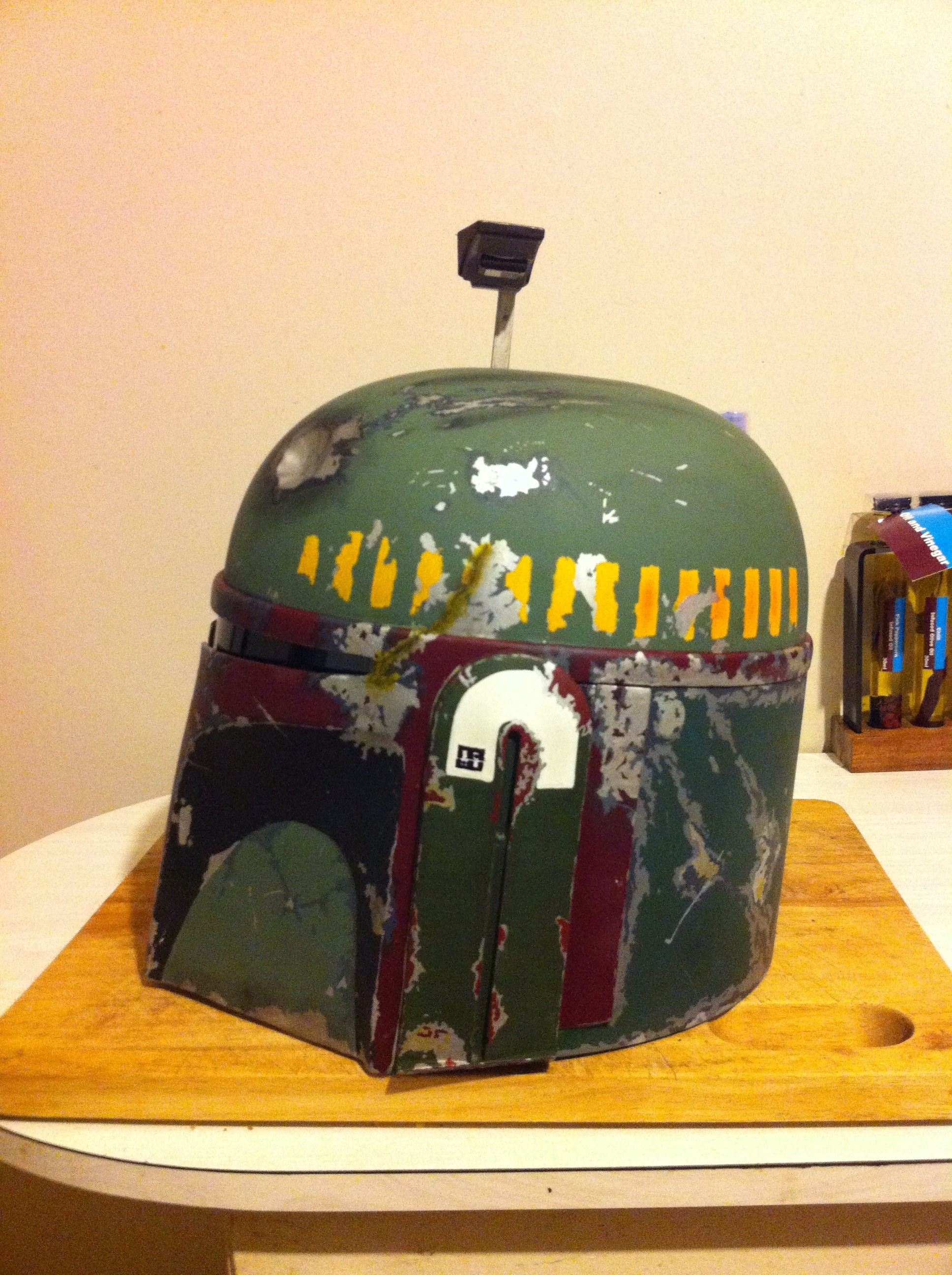

Gave the testors dull coat a crack today man its realy flat! Didnt affect colours and hasnt muted down the silver too much! Dunno how i feel about it right now does the original helmet have a bit more shine to it or is it matt?
Heya Josh. Your helmet is looking sweet, love the paint job ( I really must get round to painting mine sometime...).
I have had a play round with a Helmet that Boba Maker painted up for a friend, and as I remember it it was completely Matt.
But as most say here though, its personal choice.

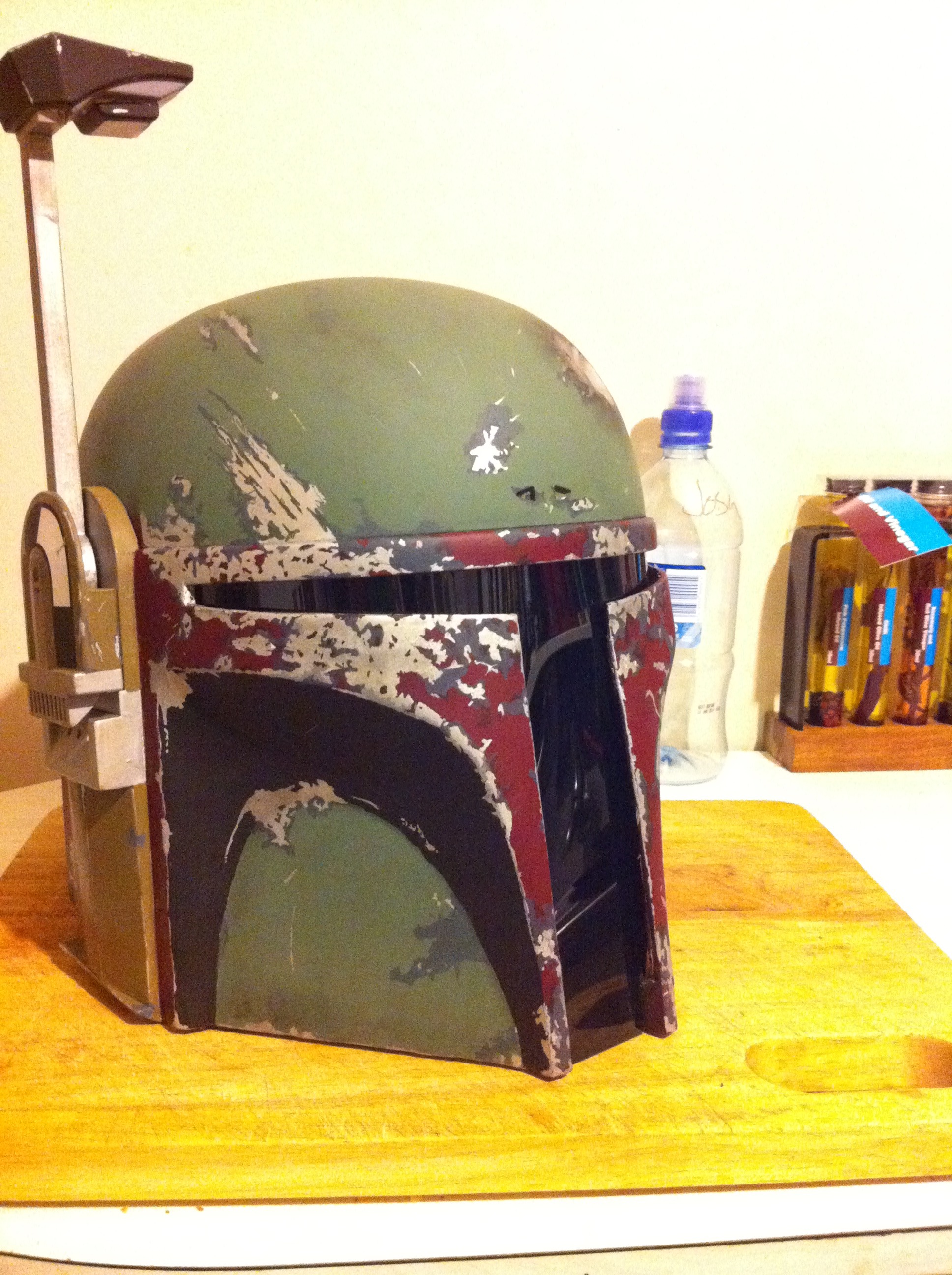

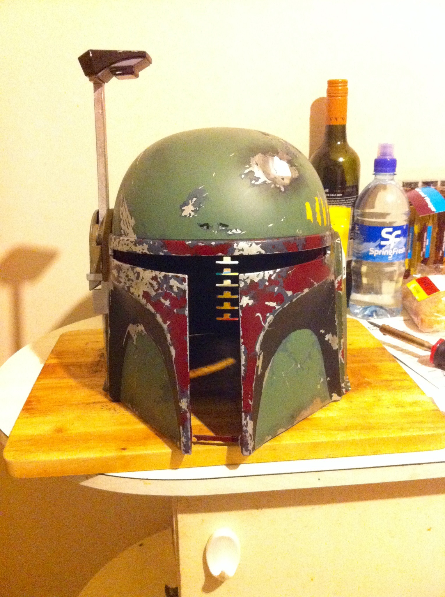

Thanks guys for advice went with testors dull coat in the end it didnt mess with the colour depth at all! Which is a relief! Only thing is that its really matte. I mean dull as! Is fett supposed to have a bit of shine to his dome? Its hard to tell in the images.
if you want a little shine, plain old hand sweat/grease will do that for you. If you want to speed up the shine that way, rub your hands through your hair to pick up some extra oil... not that I'm saying you have oily hair or anything:lol:
Lol just get some nice greasy chips from the chippy.....!:D
