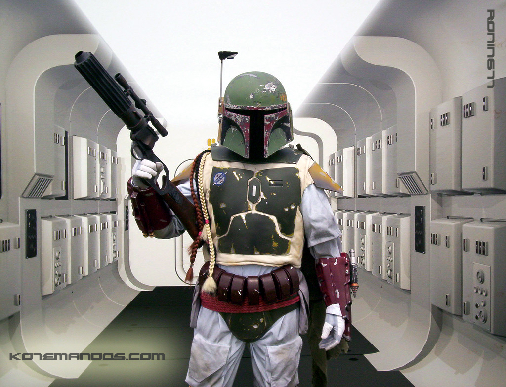

I dunno why so many folks are talking about the flak vest being beige or brown lately. I have never seen a pic that shows any brown tone on the thing.
I think people are referring to flak vest similar to the one I have at the mo.
Thanks for the tips though, plently of sutble grey tones :)
J-
That looks like it is a BM's vest. I actually had fixed one of these for someone and it is very off white to me, not beige or tan. I think that alot of people are confused by its color.
We all tend to make ourselves nuts over this stuff don't we? LOL
Haha, we do tend to go nuts over it... So you need to overweather the suit and ouches. Do you have to be careful with the flak vest? What colors would you suggest to use on the neckseal and flak vest? What colors would you suggest on an ESB flightsuit? Is it worth going out to get a cheap airbrush or do you think spraycans are good enough?
