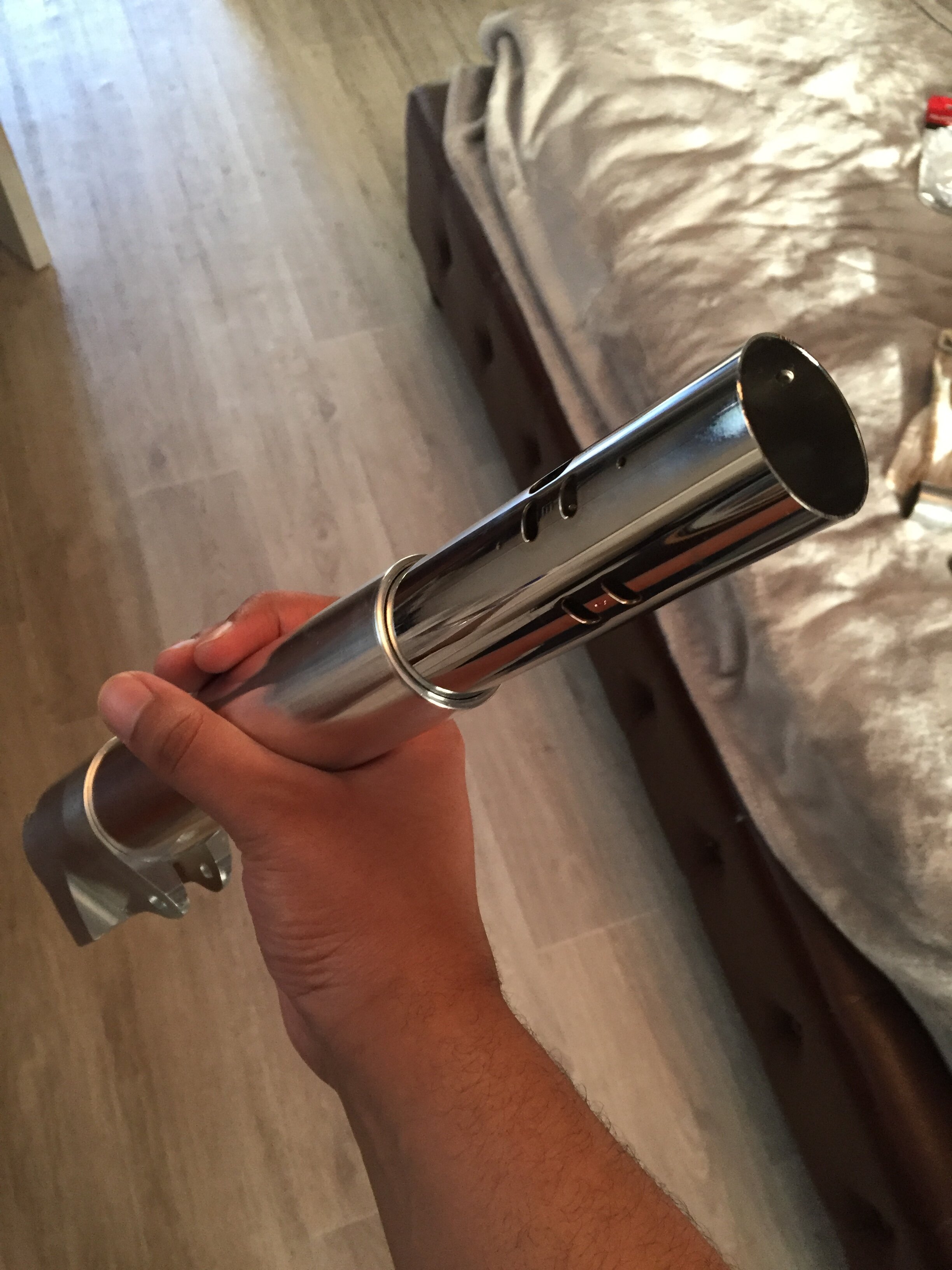

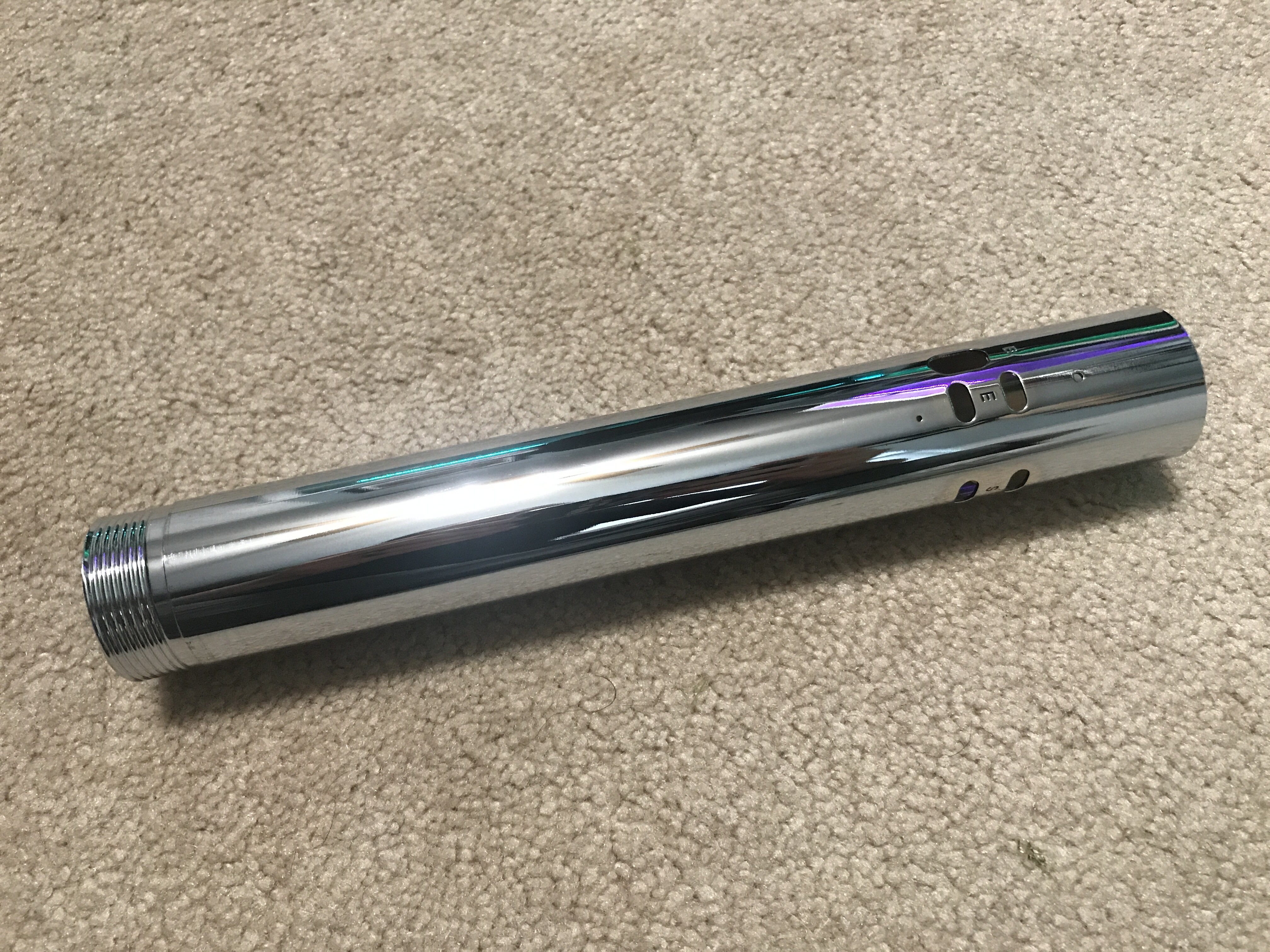

just received my MPP from roman also. Can i ask, did you manage to fit the tube, inside the aluminium EE3?, if so how would you go about doing so.
I'm actually running into the same issue.
I'm going to try sanding down the inside of the barrel to allow the MPP to slide in easier.
Yes I did message Christopher aka fieldmarshal, he said it should fit, as he owns a Roman MPP also, but my guess is Roman’s first batch were a little oversized.

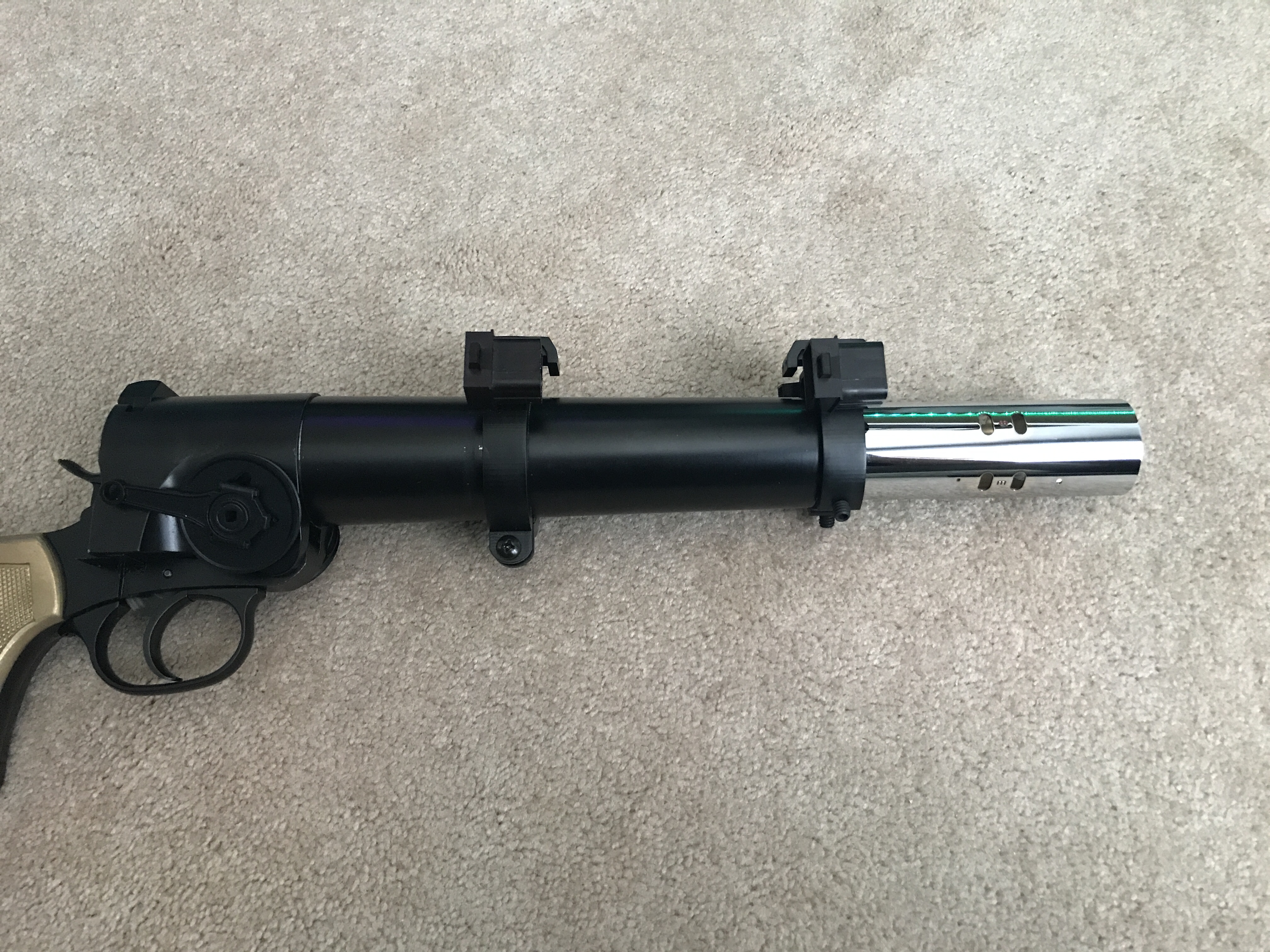

Here is my MPP from Roman. It’s a beautiful piece and I’m thrilled. As far as my EE-3 goes I noticed that the tube fits in the back of the barrel much better than the front. When I looked in the barrel I saw a small lip where the barrel tapers. It’s a super small lip but my plan is to bore out the front until it gets past the lip. Then I’m hoping the MPP tube will slide in with ease. I’ll keep you guys posted as my bit should be in today to make that happen.
On mine, I noticed the same thing. I first tried to dab a little wd40 inside the barrel but noticed that there was too much friction as I attempted to insert the to the correct depth so I ended up cutting the MPP back about 1 1/2 “ filed and sanded the edge and repeated the process.

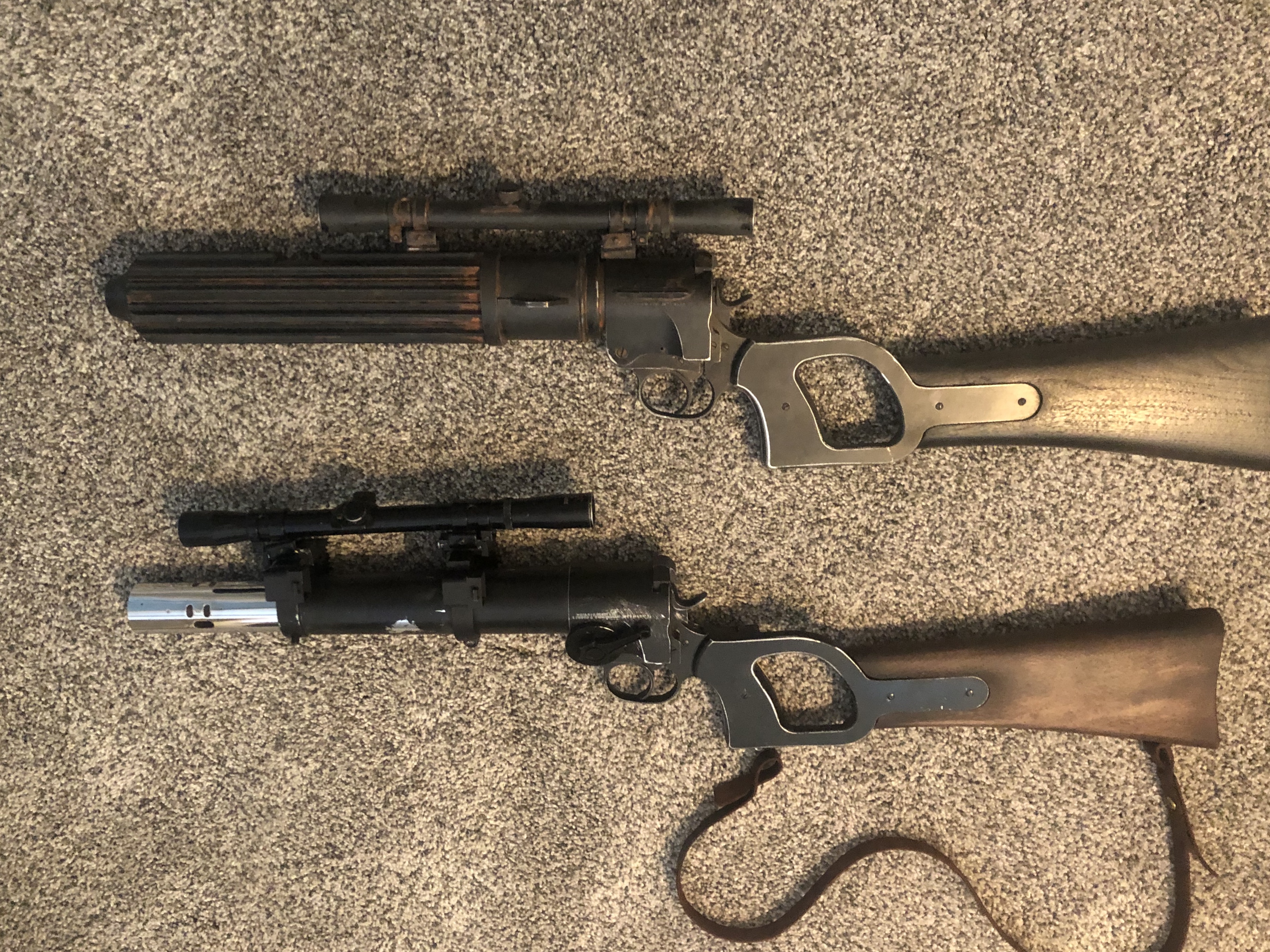

Here are some photos of my ESB and ROTJ FM kits which I have almost completed. Just need the rear stock greeblies and sling rings.

I’m gonna have to try that out, thanks for the notice. Awesome weathering on those EE-3s, especially the mk1. Could I just add that your scope on the ESB EE-3, should be back to front. Aside from that, you’ve done a fantastic job.
So I got it to work. I ordered a 1.5” drill bit from Lowe’s and was able to bore out the barrel. Once that was done I used a Dremel bit to fine tune the barrel until the MPP tube could slide in but still with a snug fit. I then went back to the drill bit to smooth out any rough spots I may have made inside the barre. The MPP fits nicely and looks amazing. Overall time was maybe 2 hrs taking my time to file things back. I’m super happy overall.

Thanks for the reminder about the scope on the esb.

Managed to get the Roman MPP to fit the barrel, after hrs of sanding. Now it’s fits like a glove, to extra space for it to move :).

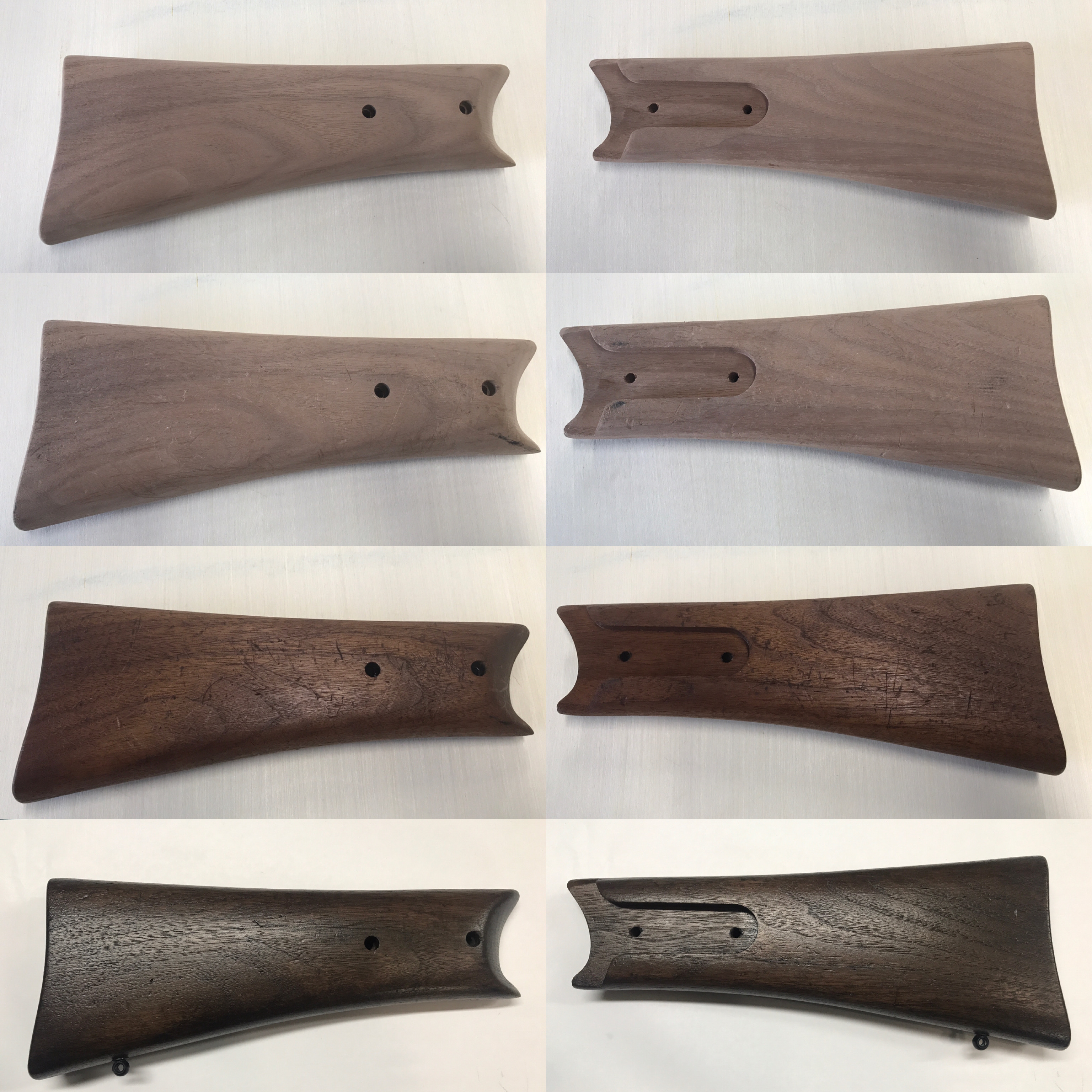

I had printed an MPP flash tube from Rafalfett’s models to do a test fit. And boy did this thing fit like a glove. I plan on smoothing out the print and painting it up as it’s the closest thing I’ll have to a flash tube for now. My first order of business was to sand the stock a little bit and give it some dings and what not to give it character. I used rocks in my flower bed to achieve organic “dings” and dents but made sure to not go overboard. I then used some walnut wood stain to stain the wood and I love the color it came out to be. After the wood dried I sealed it with a layer of wood sealant. I then distressed it a bit with a few washes of black to get into all the dents and dings I put into the stock.

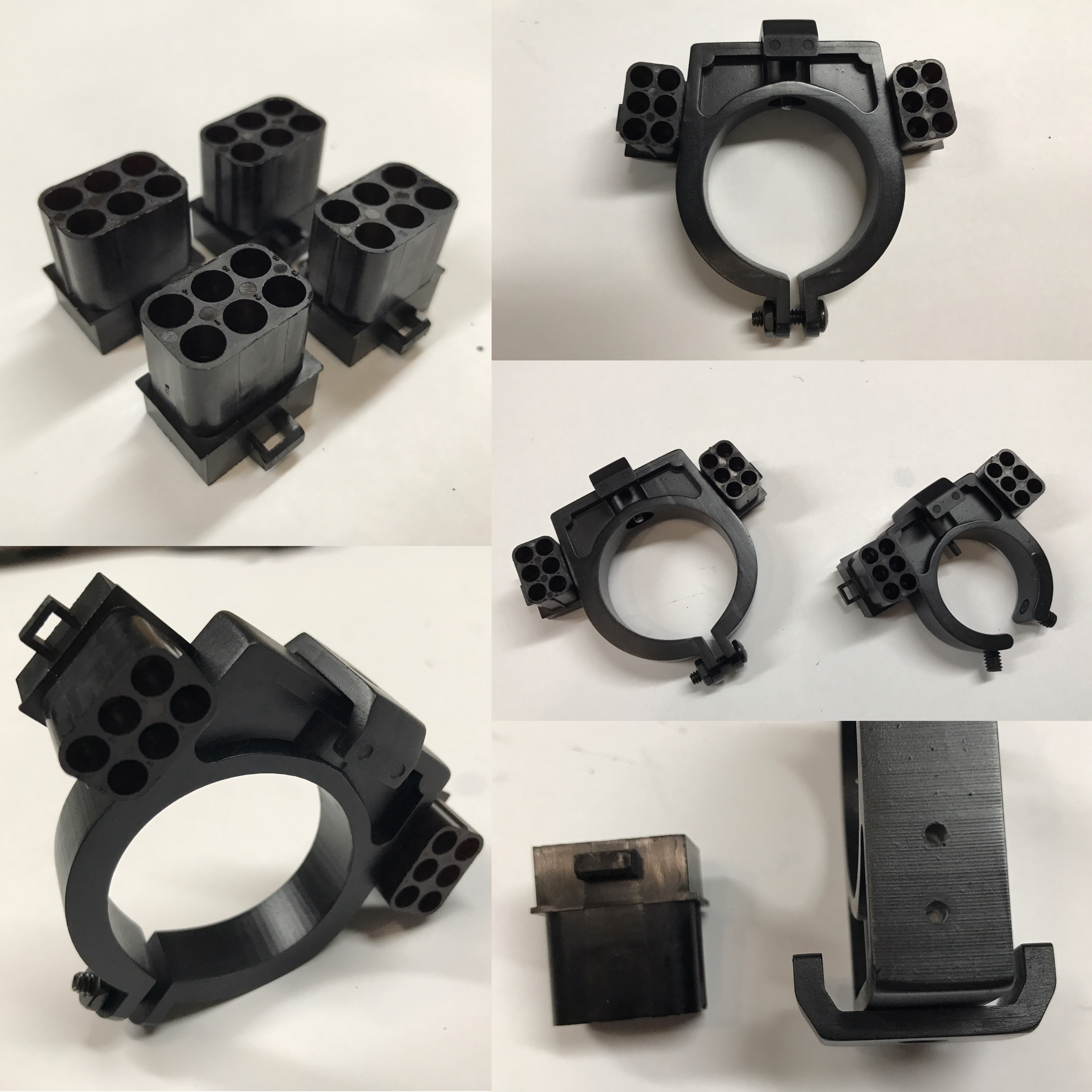

I then got to work on the barrel clamps and molex connectors. I dyed the molex connectors black and they turned out very nice. I drilled 2 small holes in each side of the barrel clamps and inserted small pins to support the molex connectors. I drilled corresponding holes in the connectors and glued in the pins to both sides. I’m re-making the clamp top adapter parts as I’m not 100% happy with those. I’ll post photos of the 2.0 versions when they are ready.

if you don't mind me asking, where did you find the the two barrel clamps to which the Molex connectors are attached? This are really the only two parts that are giving me problems at the moment. There are two other clamps that are suggested on Amazon but they are unavailable. Please help. jonbonzo_97@yahoo.com
