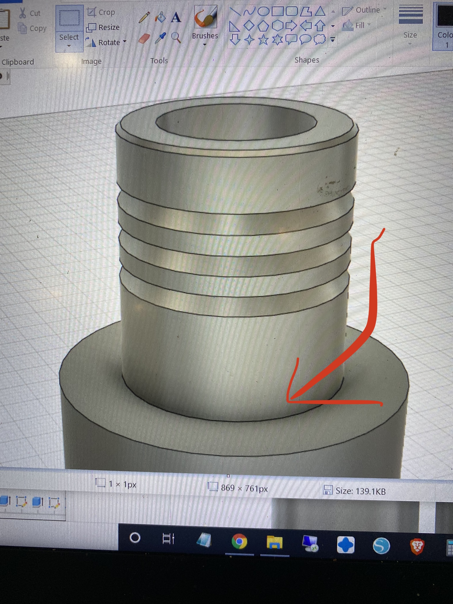

See the red arrow you pointed at? That’s a chamfer. It’s flat. The fillet (round) is what you installed in the recast you made of my drawing.
See my last post for explanation on how parts
were measured and drawn. I've quoted it right above this comment.
See red arrow added to your picture. This is a chamfer.
View attachment 215406See the red arrow you pointed at? That’s a chamfer. It’s flat. The fillet (round) is what you installed in the recast you made of my drawing.
If you’re going to recast my pictures, at least try and get them right because I don’t have a chamfer on that part
You just said you didn't have a chamfer on that part. I pointed to the chamfer in your picture.
And yes, you do have a fillet (or radius) in that corner. You didn't draw one, but the machinist who turned these on the lathe used a .008" radius cutting tool to turn them, which is why you have fillets both here (although this radius is closer to .015" on your finished parts) and in the 3 angled slots at the top section. When I get home tonight, I will be happy to put your dart on the optical comparator and show you. Or you could just take a picture of an actual part on your phone and zoom in.
He may have put a slight one in there for ease of that cut. Should we call him out for recasting
Radius cutting tools are the industry standard for lathe work, which is why there is one there regardless of whether or not you specced it. The only reason the radius isn't the exact same is because you did not know to look for one and/or have the proper equipment to measure it on my part. All evidence suggests you used calipers (and possibly mics) to pull measurements from my pieces.

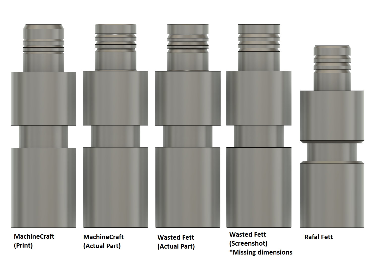

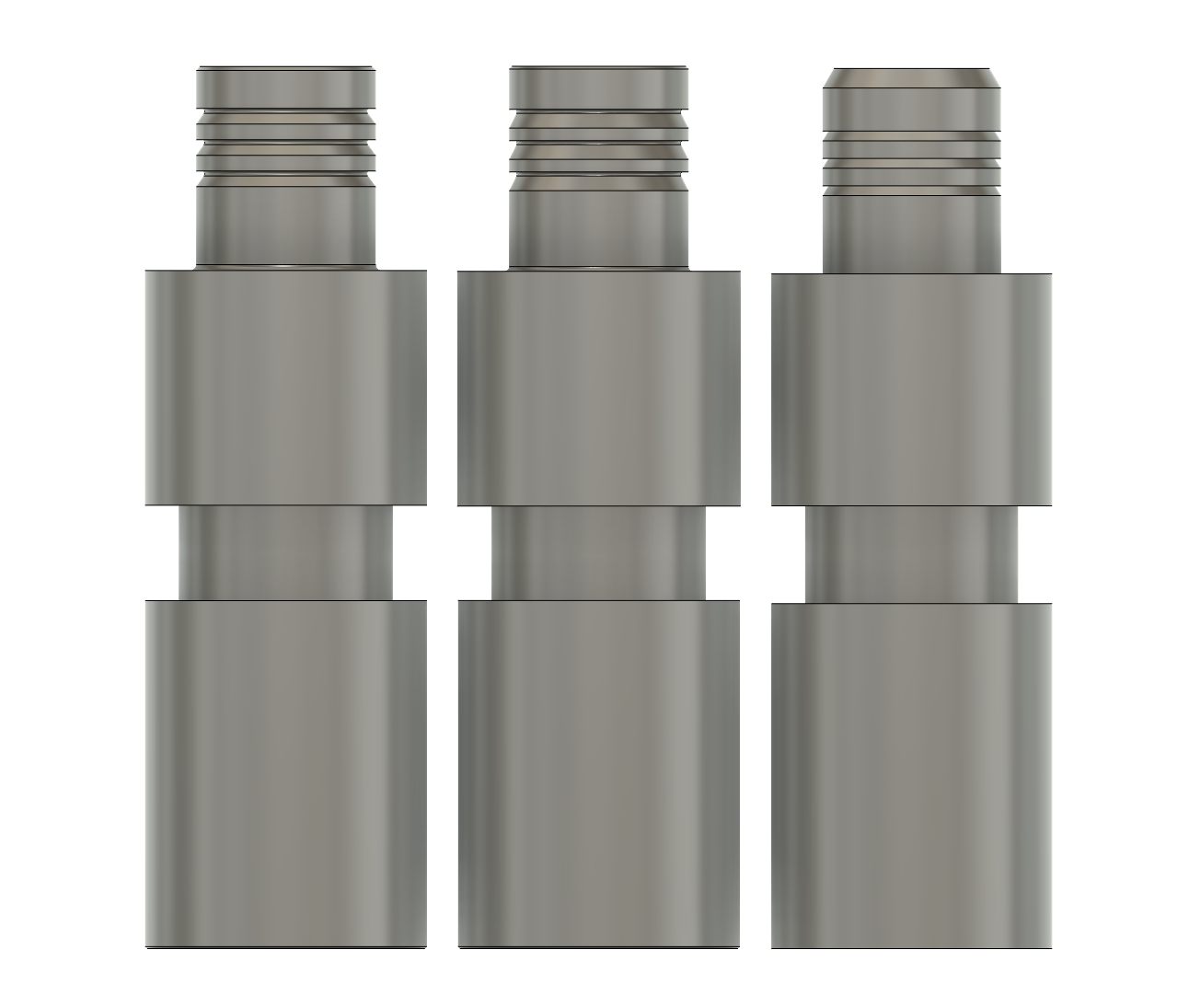

Here is the comparison of the MachineCraft finished part, Wasted Fett finished part, and MachineCraft print. The model on the right is how the actual MachineCraft part (on the left) SHOULD have come out. Nowadays that part would be rejected for being so far out of tolerance. But back then I lacked the proper tools and was too naive to catch this. This particular model has been retired for years now, but this is the part Wasted Fett would have received when he purchased his.
The order from left to right is: MachineCraft (Actual Part Measurements) -> Wasted Fett (Actual Part Measurements) -> MachineCraft (Print)
Please look at my drawing and the rafalfett drawing. Thank you
"Your" drawing is missing some dimensions. I had to infer the OAL, groove depth, top height, and height of the lower section you have hidden. ( I just used the figures from your finished part). I don't see any cues taken from the Rafal Fett templates. There is no rational explanation for how you're within tight tolerances of my part other than you copied it directly.

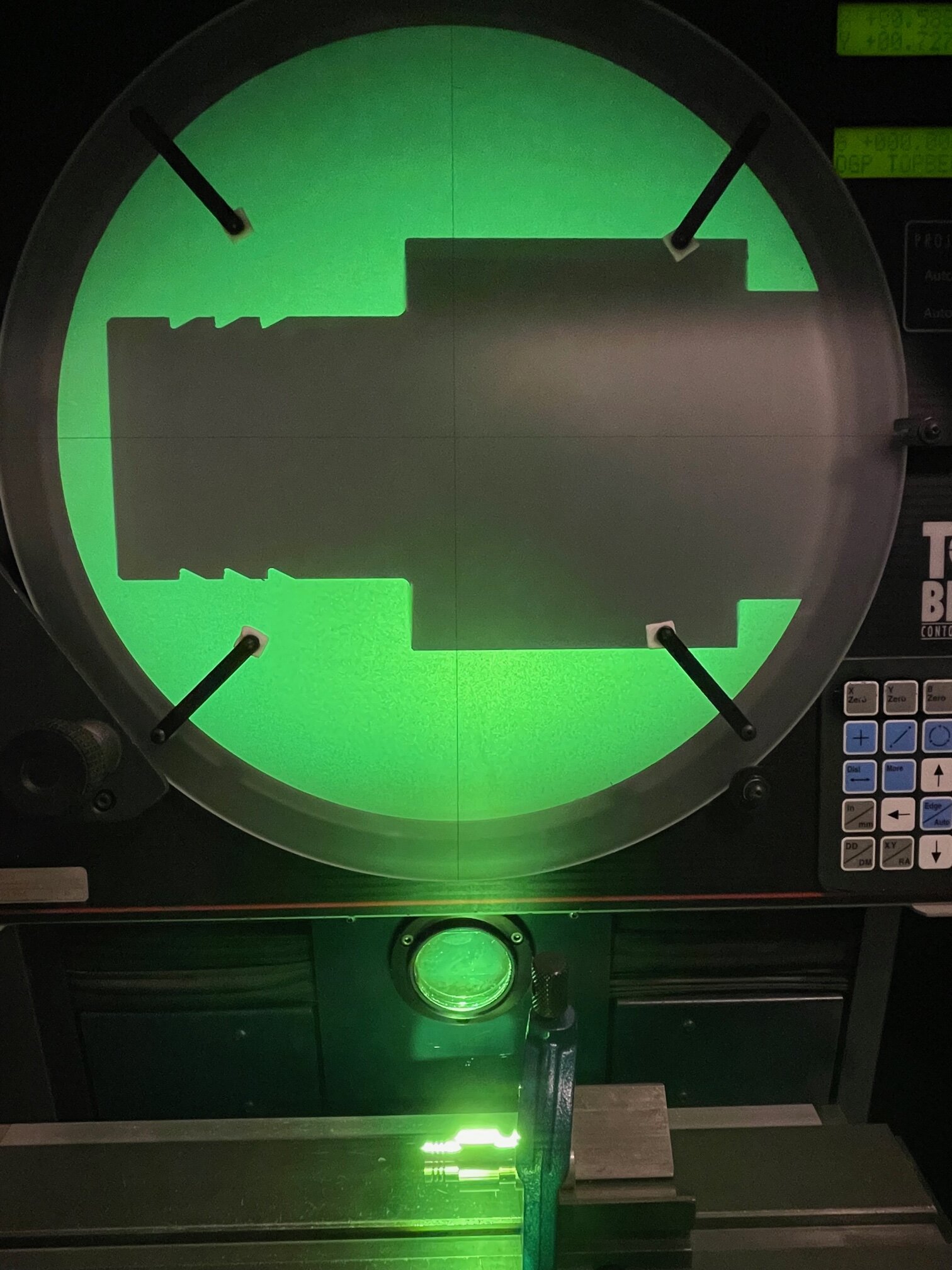

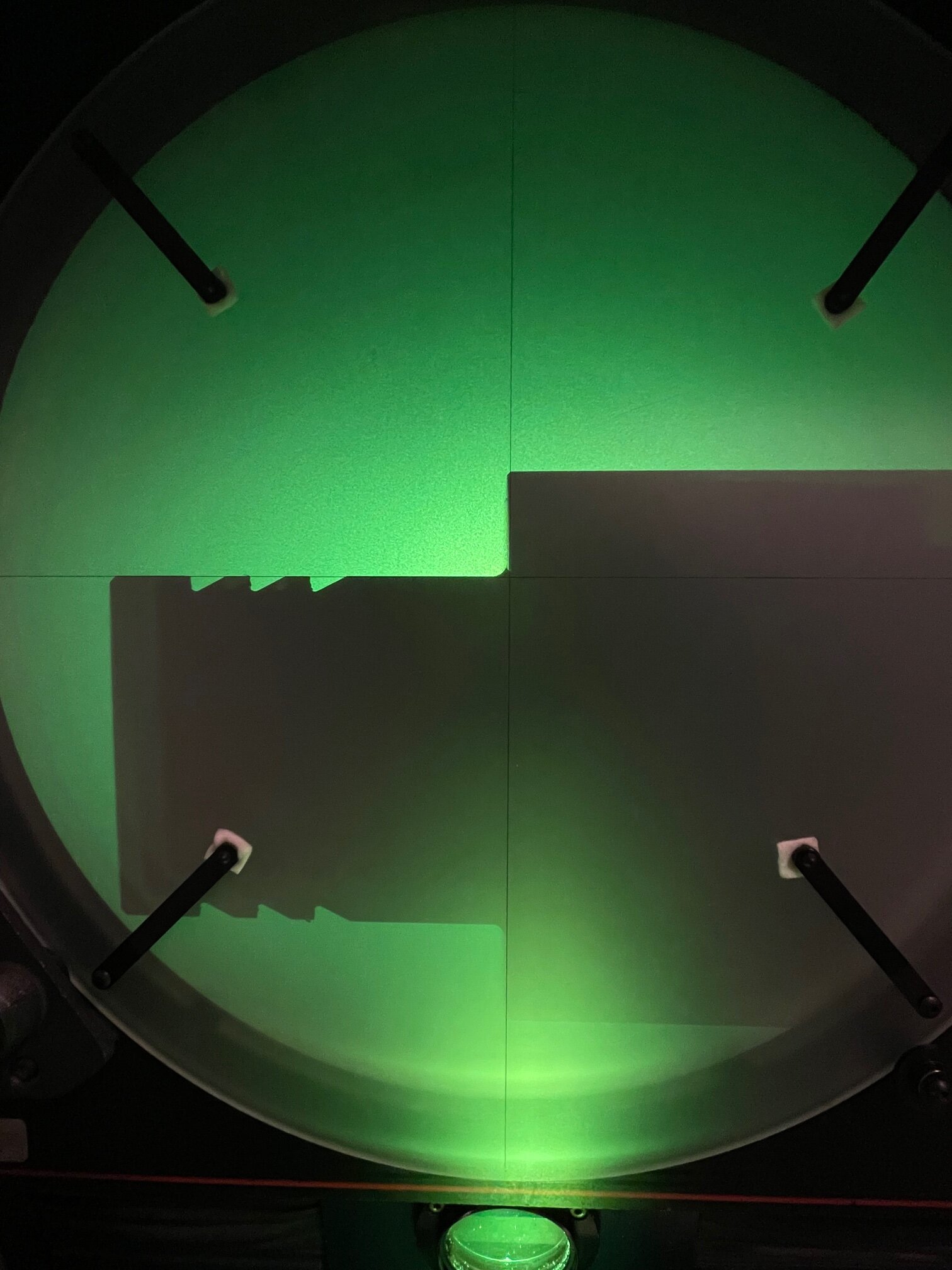

For anyone curious about the optical comparator process and usefulness, this is what it looks like:
Light is beamed across the part and into a series of mirrors onto a large display, and you use the shadow to measure. This unit has a digital readout and edge detection with all sorts of geometric functions to measure angles, radius, distances, etc. Edge detection takes all the guess work out of inputting the points so it makes measuring and drawing a super quick and easy process. I wish I would have invested in one of these YEARS ago.
Oh, and here's the fillet that isn't in your drawing but is in your part, Nino.

Yes. I am saying that your actual part is different than your own supposed drawing and lightyears away from the Rafalfett drawing. Although it does look like you grabbed the groove spacing from the Rafalfett template for this screenshot. That is not what is on your actual part though.
I am also saying that the drawing in your screenshot is missing several dimensions that would be needed to complete the model, thus I used the dimensions from your actual part to fill in the gaps. I was under the impression you are an expert on these things now, so I assumed you would understand and be able to follow along with these very clear and basic points - I apologize.
