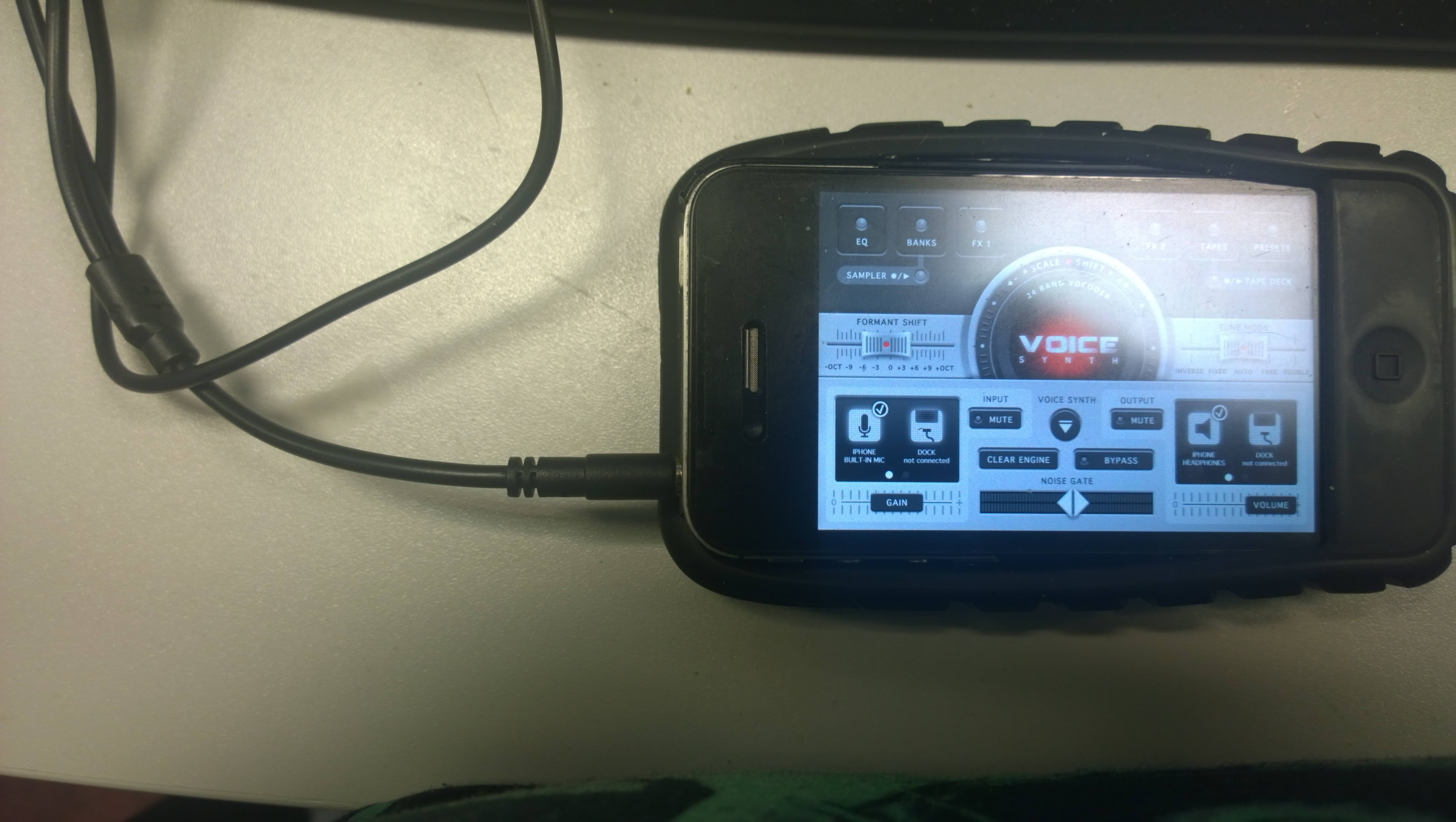

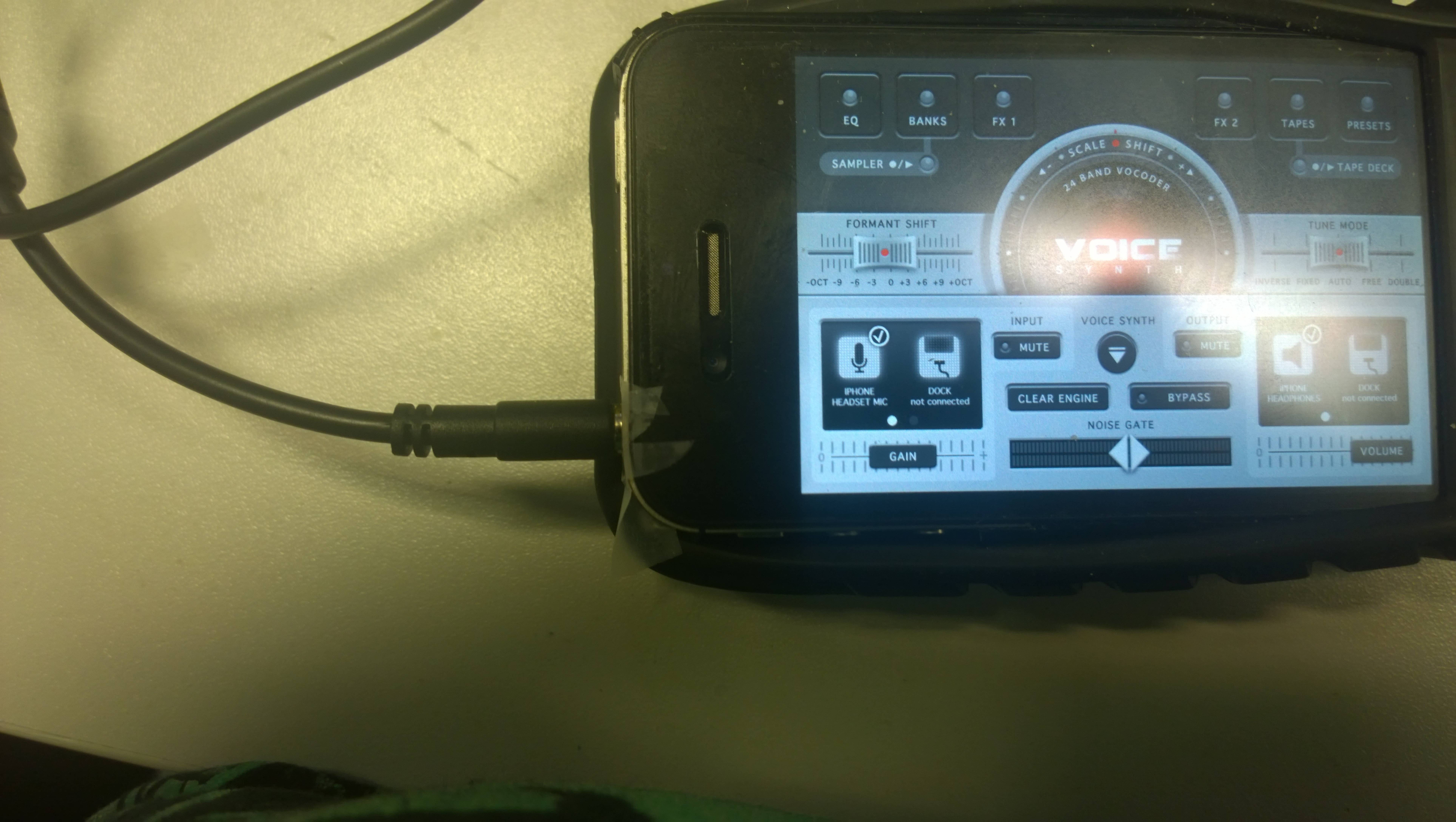

When i got back i looked closely on the app and noticed it was still preferring the built-in mic even though for days it had worked flawlessly, so i searched around and found it's a common issue to have strange issues with non apple Jack/TRRS sockets i checked the tolerances and was sure everything was in spec then it hit me .. the input must be isolated (on the image below you can see a small black isolating black plastic ring between the jack input and the rest of the chassis

on all iphone jack you'll notice the sleeve and the base of the jack are plastic, now compare that with 99% of all other jacks and we have a difference, on close inspection of the Jack input on the phone you can see a small black plastic isolation ring that separates the jack from the rest of the case so my jack was shorting on the case, and seemingly this problem that has plagued many third party apply accessories could be easily mitigated with some insulation

Without insulation (see input mic on app, bottom left)

with Insulation (satin gift tape for now haha)

I discovered by close examination and experimentation Apple in there infinite sneakiness have added in a little trip up for all 3rd parties making TRRS 3.5mm connectors I've discovered the base perpendicular to the actual jack shaft of the TRRS connector on all Apple approved devices is insulated if its not insulated the mic line can short to the chassis/GND on the iPhone which and MIC to GND activates Siri.
what I've done is wrap the base of the jack in a single layer of 0.2mm Kapton tape a suitable alternative would be well cut gift tape (electrical tape cant be cut that accurately and moves) the issues have now gone for me although the y-splitters I've all tried don't seem to survive more than 6/7 troops and yes jesuit any knock will cause pickup seemingly as any momentary drop in connection is amplified by the voice synth app making it sound wayyy worse. I'm not convinced any 3.5mm female jack will be immune to this as they are all more or less constructed in the same manor with floating contact pins that move when the jack is inserted and as both the socket and the jack can be in motion as opposed to just the jack in the phone there just seems more scope for failure. due to this effect if the iPhone decides the disconnect was long enough it can decide to revert to the internal mic which is feedback city (as my phone and amp sit in the same pocket and total game over as i'm sure you've probably experienced yourself.
