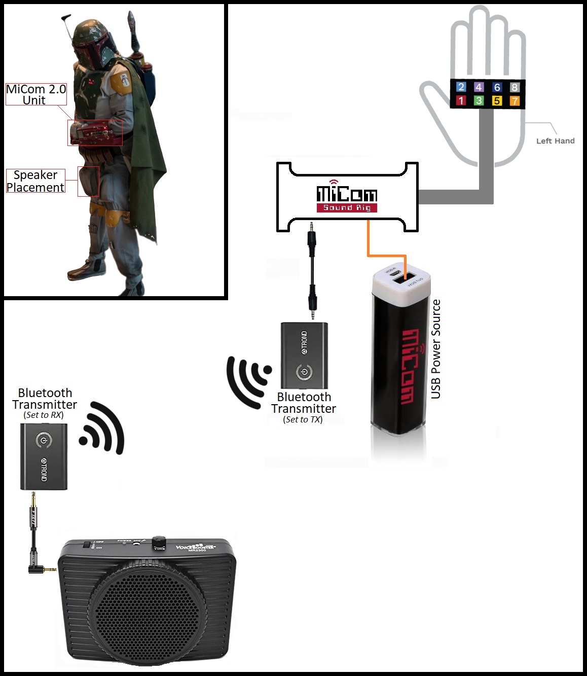

It's always interesting to see what kind of setup folks are rockin' for their 'Fett Voice'. I myself use the MiCom 2.0 setup and went wireless with Bluetooth. Here is a list of the stuff I used:
Part
Vendor
Link
Notes
MiCom 2.0​
MiCom Sound Rig​
Comes with 8 button module and USB Power Bank.​
Voice Booster MR2300​
TK Products (Bought from Amazon)​
20 Watt Speaker.​
Bluetooth Transmitter/Reciever​
Trond (Bought from Amazon)​
You'll need two of these (RX/TX).​
Compression Glove​
Mueller (Bought from Amazon)​
Stitched 8-button module to the glove.​
3.5mm Right Angle Cable (20cm)​
Shuigu (Bought from Amazon)​
Bought two of these.​
And here's a diagram I created for this...
Your looks (and sounds) great too!
