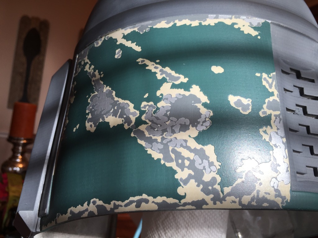

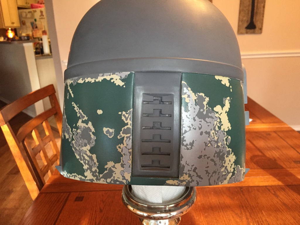

Greetings all, hope your all doing well. My eyes are feeling better after all that straining from all the painting and all the detail type work on the back panels this past week. So today I am focusing my energies on getting the bucket prepped for more paint. Maybe even put on some of the physical damage.

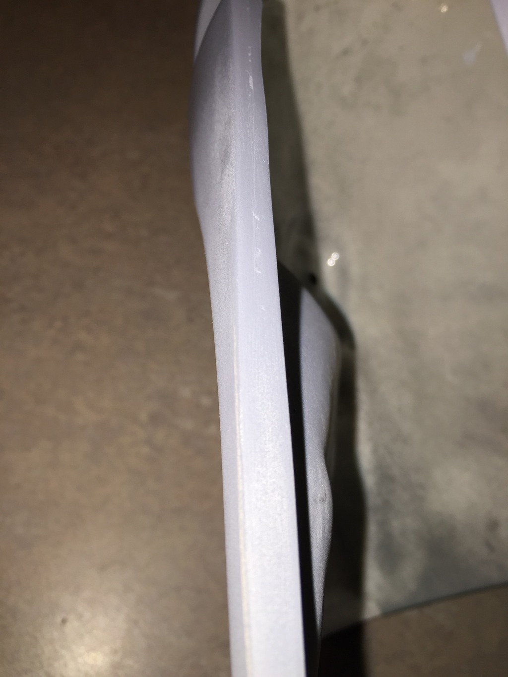

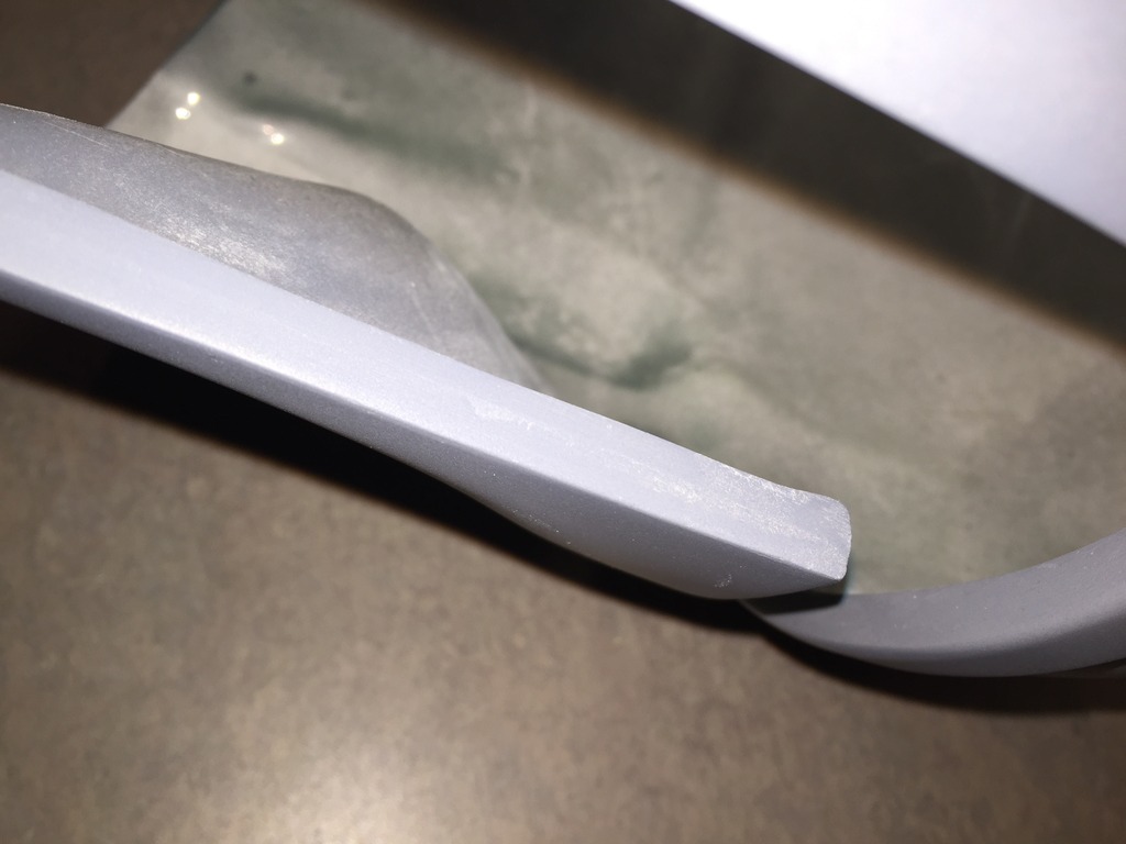

you can (hopefully) see that when I dremeled out the visor area, it left behind a few little divots, blemishes and bubbled areas behind that need to be smoothed out.

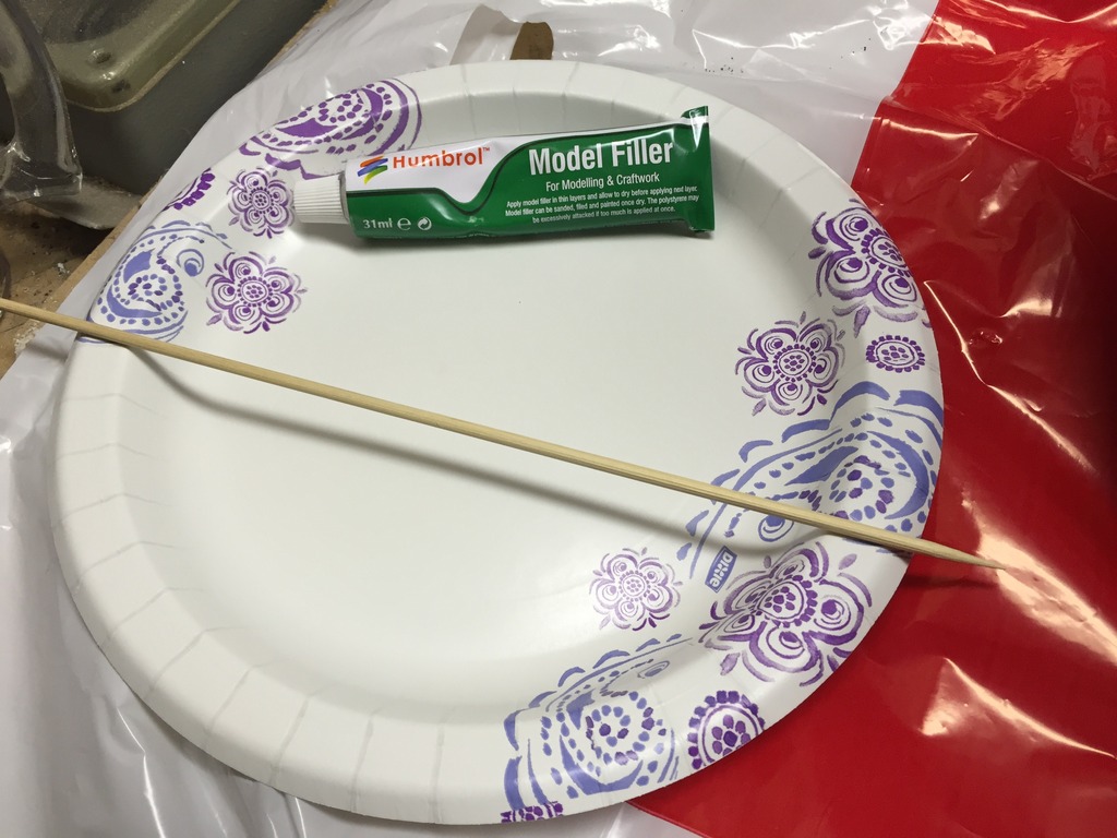

That is what it so great about this particular helmet, and helmet maker, Animefan. He did such a great job on this cast that there was very little to prep and finish except for these little areas that were of my own making. But, rather than using bondo for these tiny areas, I went and purchased the humbrol brand model filler. I have never used the stuff before so this will be new to me. I have used bondo before and I would rather not use it unless I really, REALLY have to, I am not a big fan of it.
((SAFETY WARNING, just like bondo please use this stuff in a well ventilated area and be sure to read all directions and warnings prior to use!))

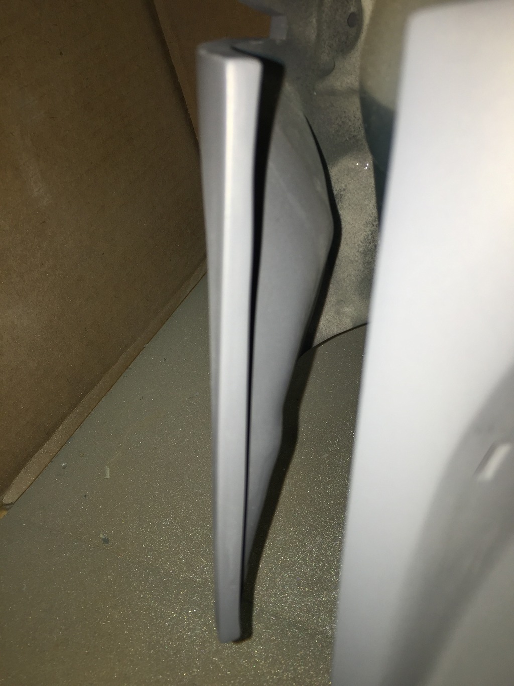

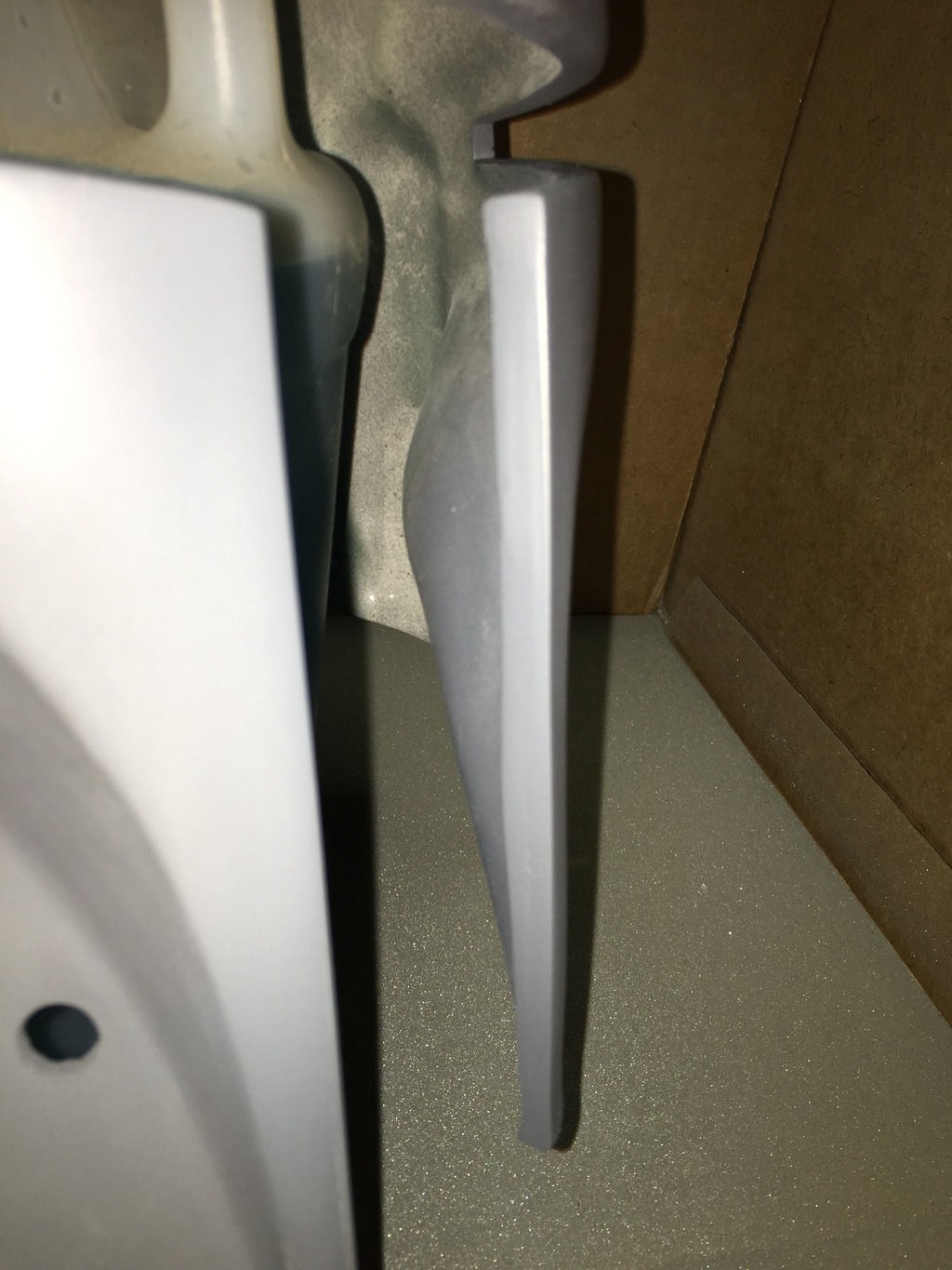

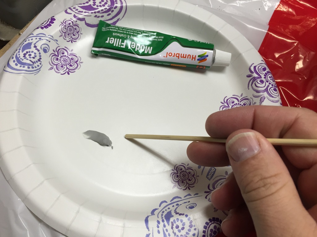

a little dab should do it...
just gotta give it a little stir with a bamboo skewer to "activate it" and apply only enough to fill in the imperfections.

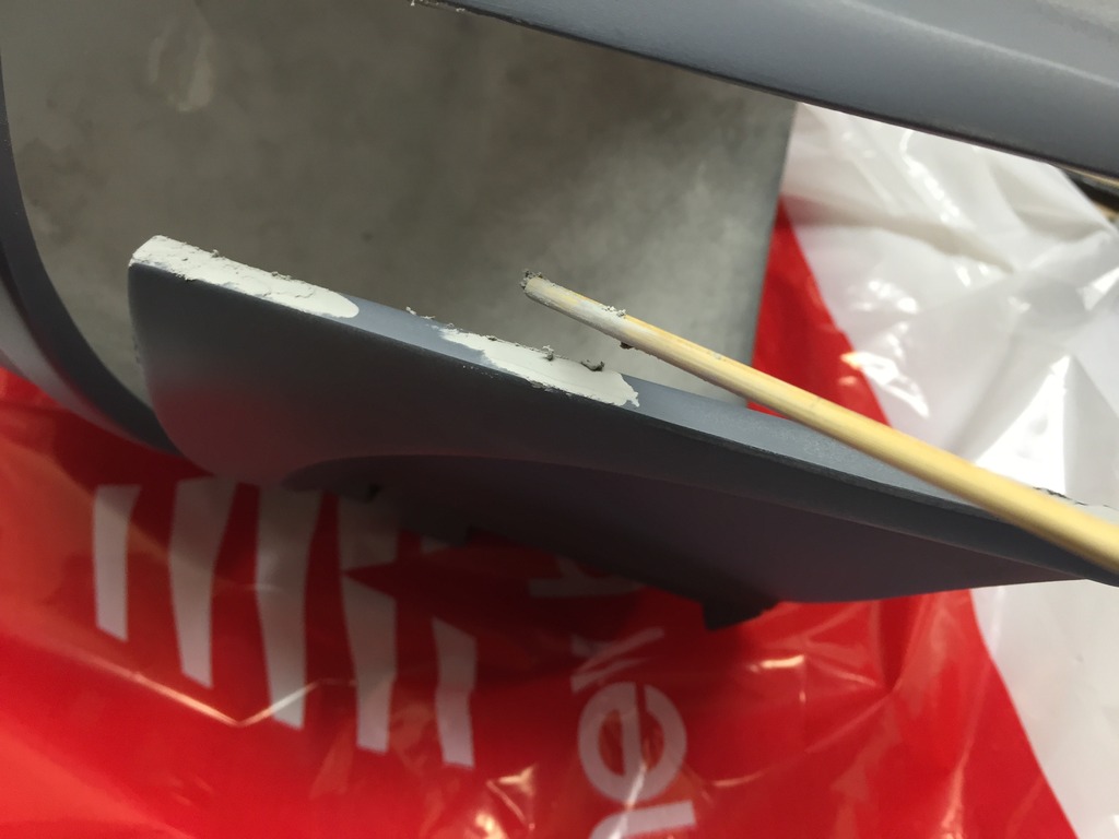

and whoa lah
now just gotta let it dry, sand it, buff it and re-prime it and should be good to go. I also recommend using a dust mask when sanding this stuff to try and keep the filler dust out of the lungs!!
