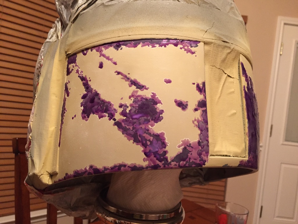

Holy Heck am I glad to have finally finished with this freakin' panel! This thing made me it's B**** for what seemed like an eternity!
Thankfully Now all that's left, once my eyes heal, will be to mix up the custom green, humbrol(s) 76/96 and get these bad boys painted.

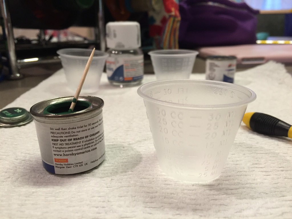

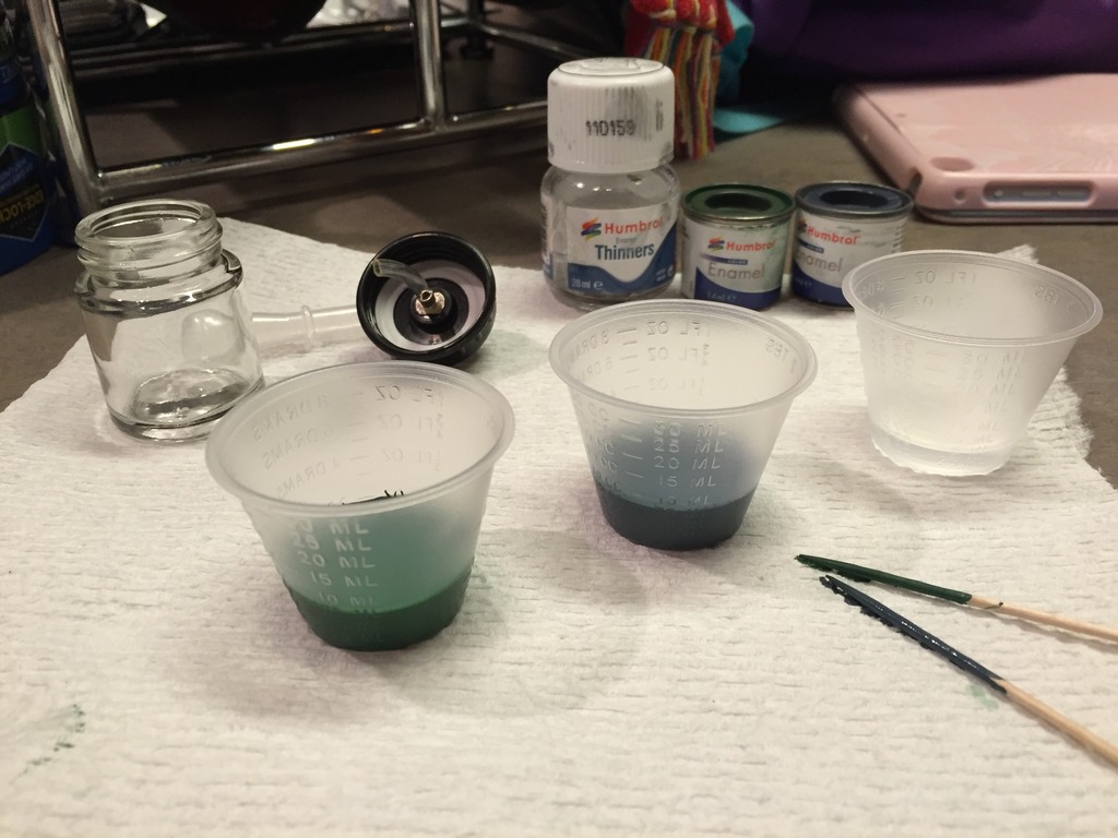

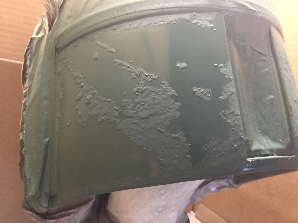

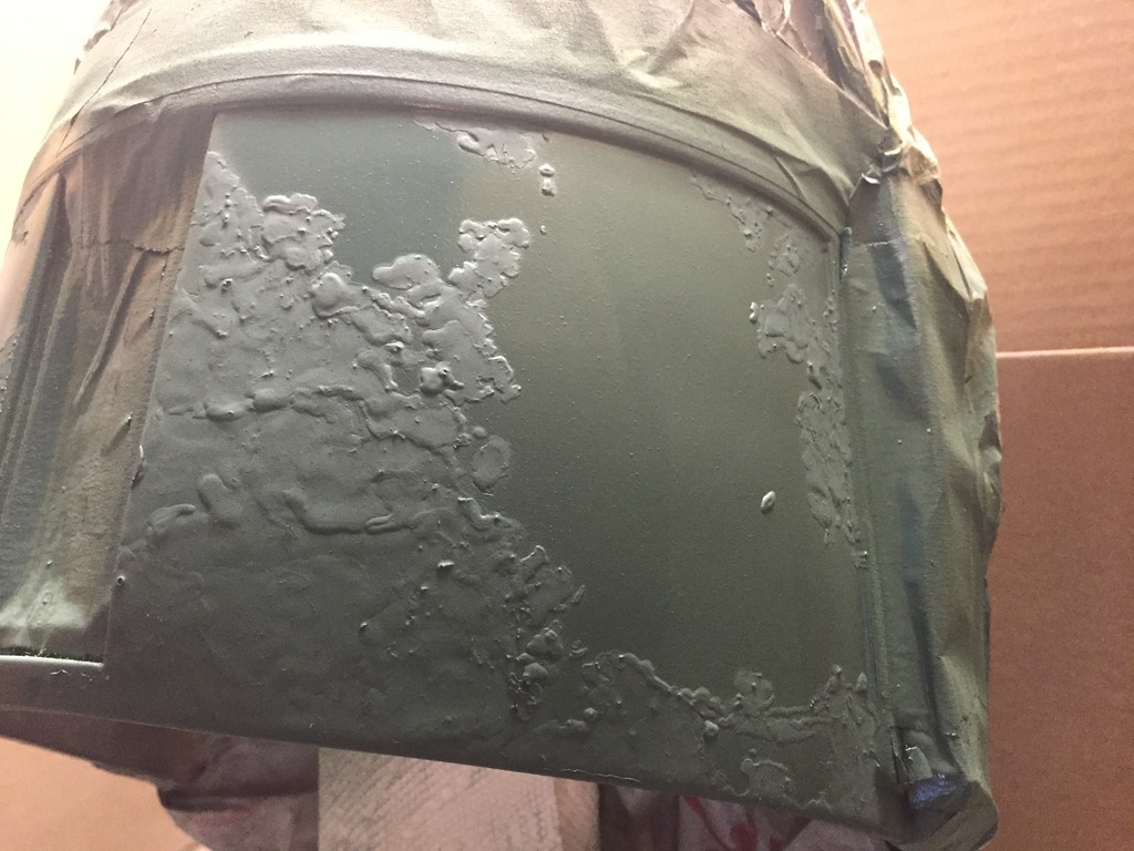

Time to do some mixing! I picked up some cheap clear mixing cups at my local hobby shop that should help a TON! Should limit the mess anyways.
after giving the individual colors a good mixing with a clean toothpick (about 5 minutes each) I measured out 7.5 mls in each cup along with 0.5 ml of thinner.

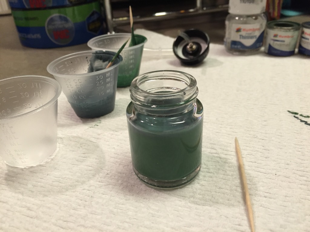

Bing Badda Boom, here it all is all together in the spray bottle. Just gonna give it a good 5 mins of stirring with another clean toothpick and give it a go,

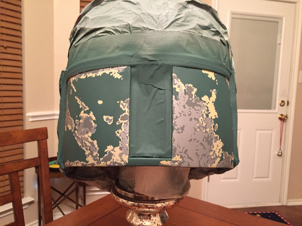

here is the first coat...looking okay so far I think...
Here's another shot (after the second coat) with flash.
- - - Updated - - -

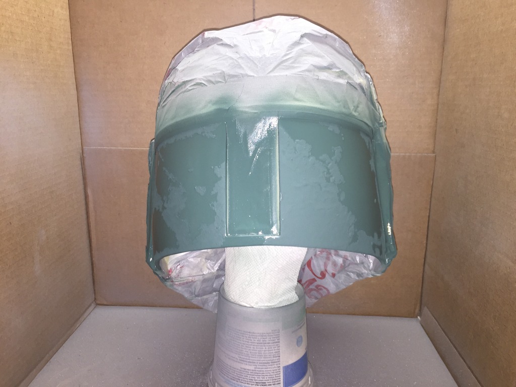

Both sides no flash, with fluorescent lights above
i figure another coat or two and I will let it sit for the night to cure.

well, not too bad figuring that the green has only been on for less than 6 hours and it has yet to be hit with 0000 steel wool to blend it all together,
but overall I think I am pretty happy with these.
