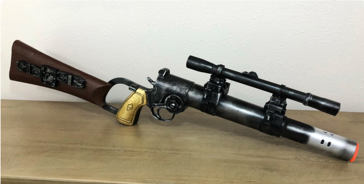

It looks like your Webley kit came with attachments on the bottom of the stock and pistol grip. Did you just attach these rings to those for threading the leather strap? My dilemma is that the 3D printed EE-3 I have on order, does not have attachments so I'm trying to find the best option.
Yes. Rings just attached through the posts that are in the stock and grip. You’ll need to find something similar.
Funny aside. I ordered that same 3D EE-3 from Etsy that you show! I ordered it in November and the guy still hasn’t shipped it yet. I figured it would be a decent trooping blaster when I don’t want to carry the weight of the FM. When mine comes in i plan on rehabbing it a lot so I’ll post details on attachment methods and such
I ordered mine in late October and got notification that it shipped the week before last. It was supposed to arrive by the 23rd but isn't here yet. USPS is still playing catchup from the holidays so I expect it will arrive shortly.
