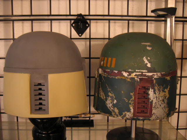

OK, couple pics below. Here's a side by side with my MS1 helmet.

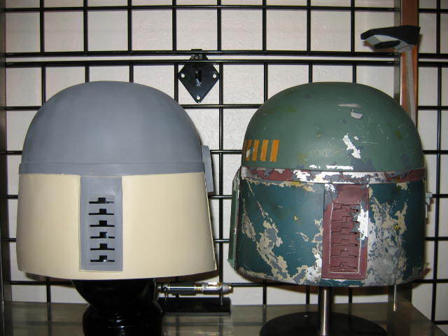

PROGRESS--Sep 30th:
OK, priming is done. And I have sprayed the light color on the back panels of the helmet. This was a custom color I mixed using Polly S "Doped Linen" as a base, then added some generic acrylic gray and brown to get it to more of a sandy tone. It looks light, but once all painting is complete and I give it a wash, it will darken up a little.
Here are two shots, with and without flash.
Next up will be outlining the areas for the dark blue-green on the back. :)

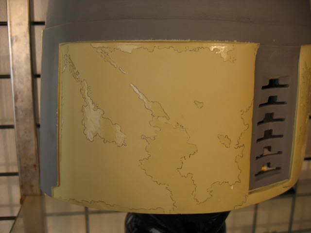

OK, the back of the helmet is well under way. I traced all the damage and scrapes, transferred them to the helmet, and applied masking fluid. I use Winsor & Newton's. It's really easy to work with! Below, the shiny areas are covered with the fluid.
Once the liquid mask was dry (only about 20 to 30 minutes), I sprayed on my blue-green mix. I waited several hours for that to dry, then rubbed the liquid mask off, leaving my sandy color exposed. I just rub over the surface with a piece of tracing paper, and the masking fluid just rolls right off! :) Here's the back of the helmet now.

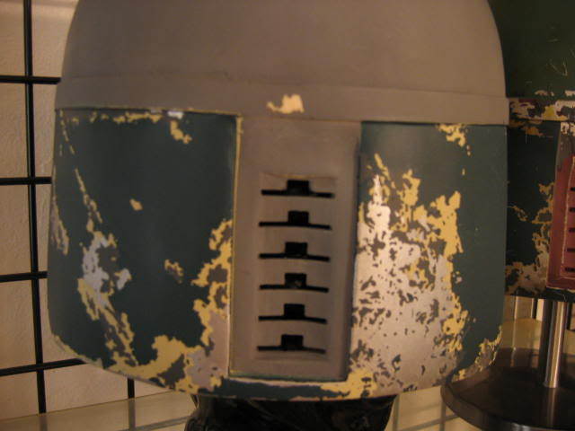

MORE PROGRESS--Oct 1st:
Whew! OK, enough for one day I think. . .
I've traced and painted all the gray and silver damage on the rear panels. The colors are Polly S Lark Dark Gray, and Floquil Bright Silver. In the ref shots, there's a secondary silver shade. . . almost like a pale blue, and I may go back later to add this. But for now, it's supper time! :D
Here's where she stands until tomorrow.

Talk about doin' an outstanding job with the weathering! The weathering on your new helmet looks IDENTICAL to the weathering on your MS1 helmet. Absolutely amazing ... way to go!
Man, I have never seen an ESB helmet back, come together so quick and look so good. Your MS1 is amazing by the way, but I believe you are working on a rival to it. Great job:cheers
DUDE!!:eek: ....you're just Flying through that thing...Freakin AWESOME:cheers ....
Looks Fantastic SJedi.....:thumbsup:
