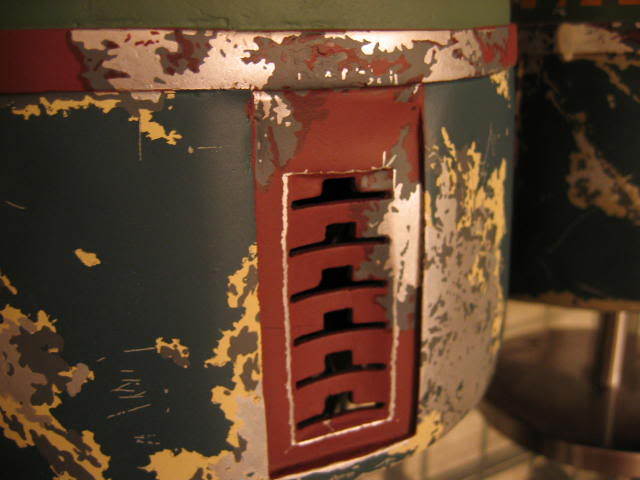

PROGRESS--Oct 6th:

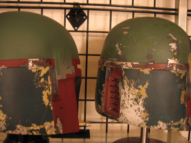

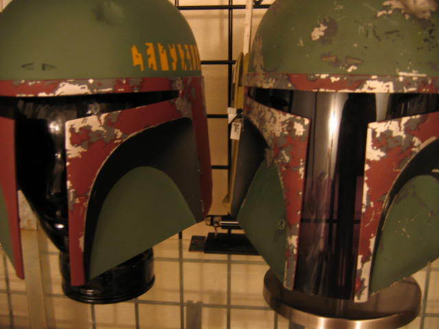

Whew! So it begins. . . the tracing/mapping/transferring portion. Lots of detail to do for the damage. I started on the keyhole rectangle on the back, and I'm moving around the "hatband" toward the ear areas.
For this damage, I'm using my Floquil Bright Silver, Polly S Lark Dark Gray, and Polly S PRR Maroon for the darker reddish areas.
This is where I really have to make myself go slowly and check my references often! :)
Thanks again for everyone who's sticking with my progress. :thumbsup:
More to come over the weekend!

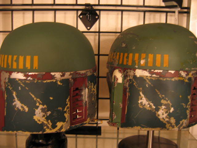

PROGRESS--Oct 7th:
Ow! My back. . . :p
I've continued on, adding more damage to the Boxcar Red areas. I've pretty much completed most of the main areas on the back, and have started sneaking around onto the left mandible. :)
Technique is same as described previously. I'm saving the right mand for last, cuz it has the most detail.

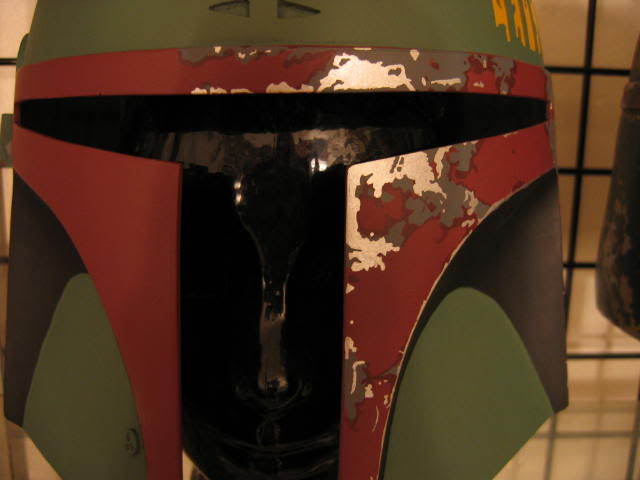

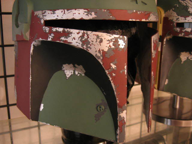

PROGRESS--Oct 8th:

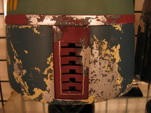

OK, something a little different as far as pics go. I wanted to show a section of the helmet, and how it progresses as I add the different colors.
I'll show the right mandible, seeing how I needed a break between each color! :lol:

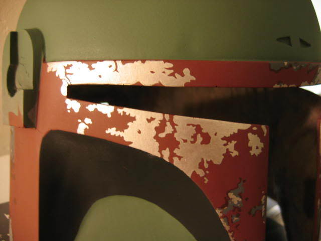

First is the Floquil Bright Silver. I traced the damage areas, then painted them in. I try to leave any small chips within the larger areas unpainted. It gives me a much better visual on where to line up the next color.
While the silver is drying, I trace out my next color application. In this case, Polly S Lark Dark Gray, just as with my last couple of updates. After I lay down the gray, this is what it looks like.
The third step is to add the darker reddish damage. Again, for this I'm using Polly S PRR Maroon. This was one alteration Rogue Studios made to his famous color list. And it's much easier than mixing a custom color! :) I'll also use this step to go back and touch up any silver that got covered over, or needs to be reshaped due to painting the other 2 colors. Here's the mandible with the maroon added.
*Whew!!* Lots of work for a small section of the bucket. This represents probably around 4 hours of work.
Hope everyone's enjoying the tutorial! :)

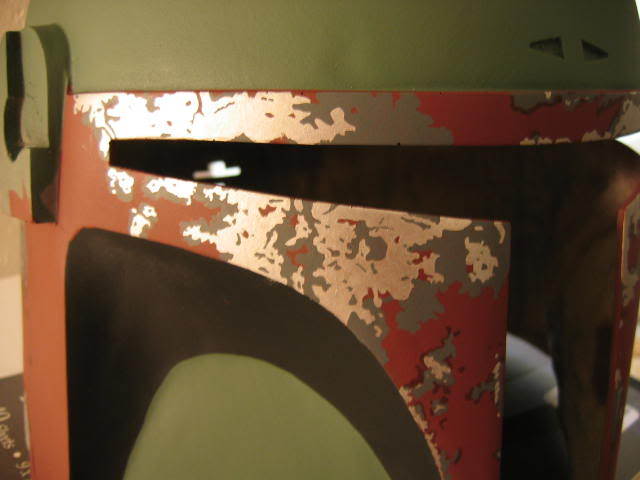

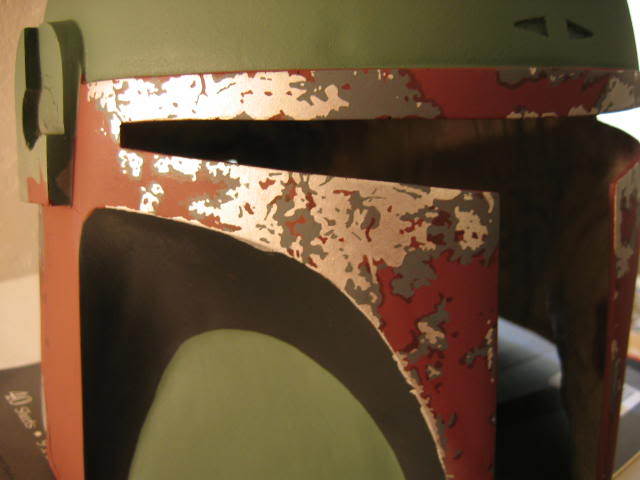

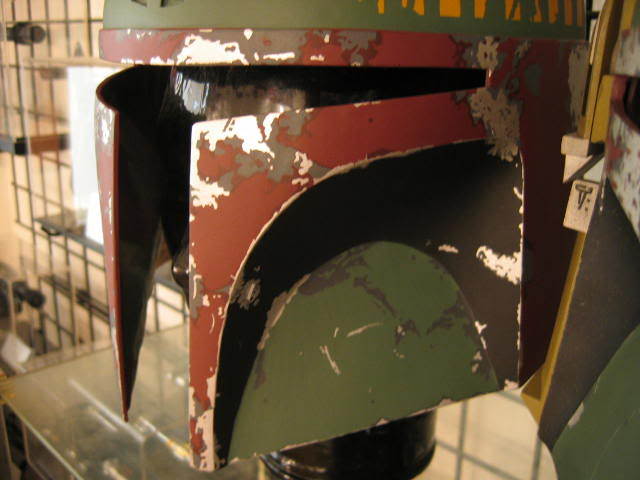

PROGRESS--Oct 9th:
OK, the face is pretty much done. I still have to go back with my sharp little implement of destruction (compass) and put in the really fine scratches, but the painting is finished. :thumbsup:
For the gray on the lower cheeks, I darkened up the Lark Dark Gray using some PRR Brunswick Green. The Lark by itself just kind of blends into the Panzerolivgrun. There's not enough contrast. I just added a few drops at a time until it provided enough of a difference to see. (This isn't my idea. . . I can't remember who recommended it. I thought it was Rogue Studios in his color thread, but I can't find the reference for it. Nevertheless, it works great! :))
Next up is starting the damage on the dome! :thumbsup:
