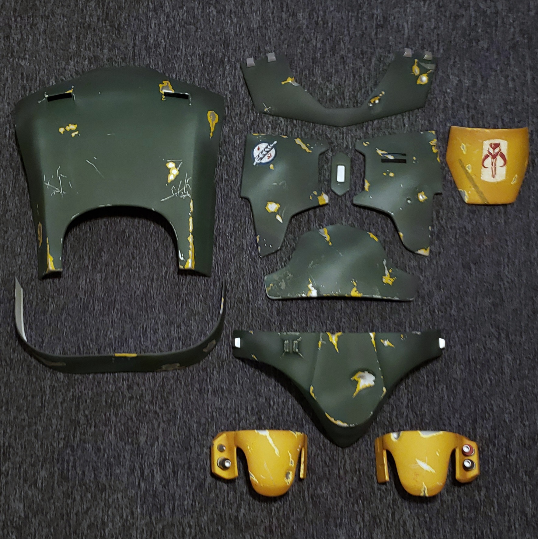

Superjedi's SE armor

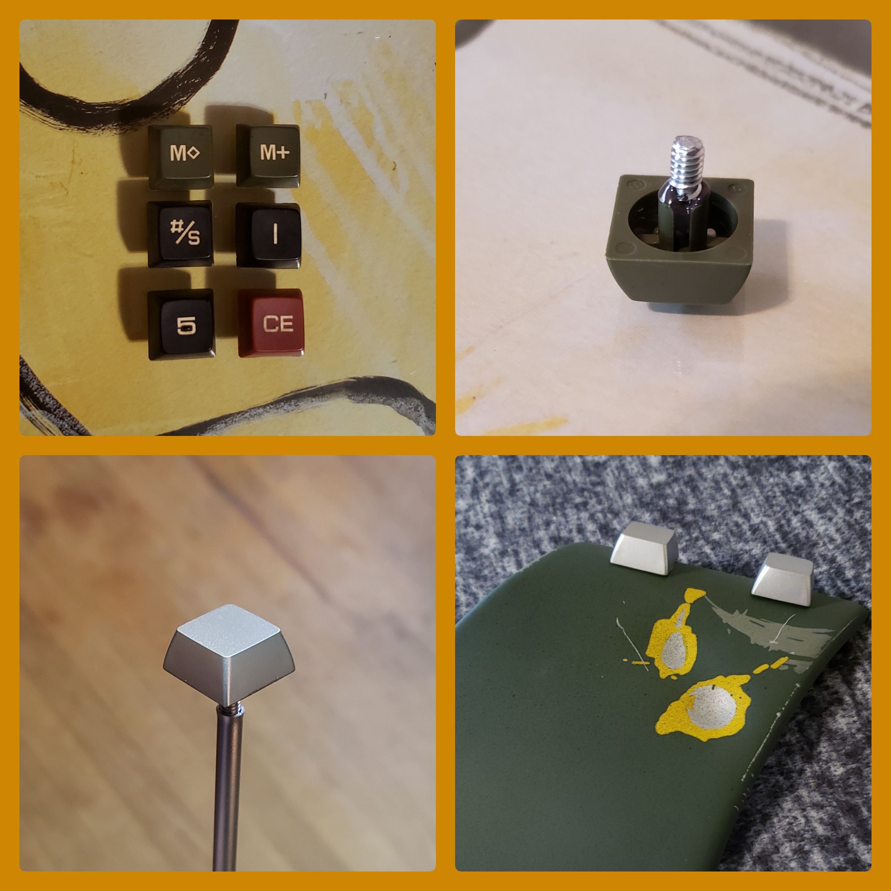

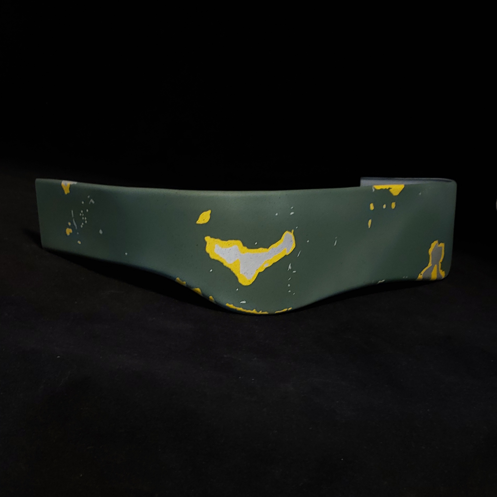

Another piece of armor down-- the kidney plate! This one was relatively quick.
I still need to measure and drill holes for the studs so I can mate this with the cod piece.

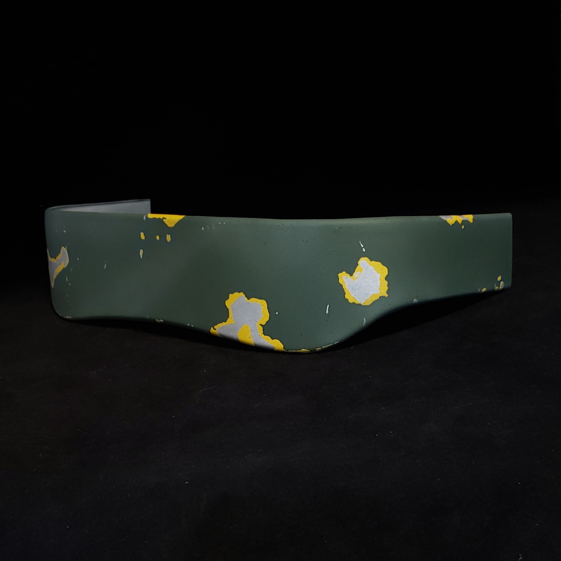

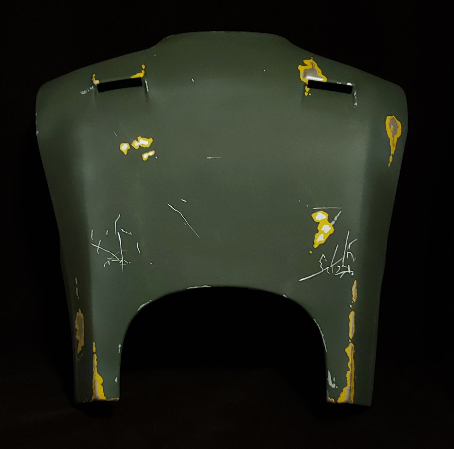

Finished up the biggest piece of armor today... the backplate!
Wow is that a lot of real estate. :)
I'm including a reference image that I used to place the big white scratches that I assume were made by the jetpack. I guess paint from a long time ago in a galaxy far, far away wasn't very durable. ;)

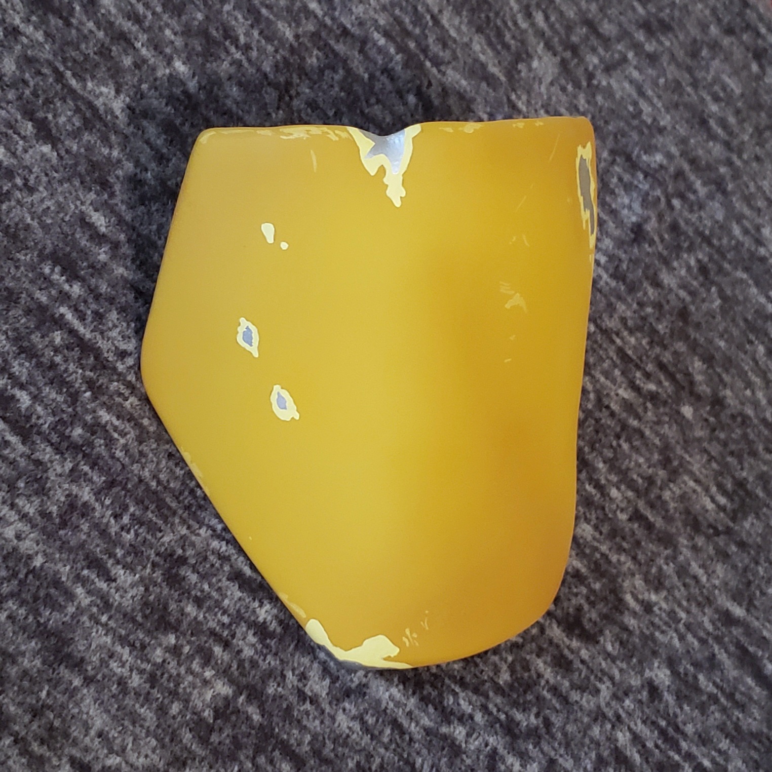

I'm between commissions for a couple of weeks so I have some time to work on my armor again!
I got this set of shoulders in a partial trade recently. These were pulled from the ROTJ stunt set that was auctioned off a while back.
I received them prepped and partially painted, so I wet sanded them and then hit them with a coat of Tamiya fine surface primer.
After that, I airbrushed on some Archive-X acrylic SP Armour Yellow, same as I used on the previous shoulder and my knee armor.
They're nice and clean right now, but not for long!

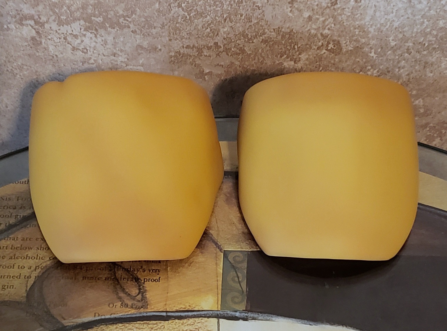

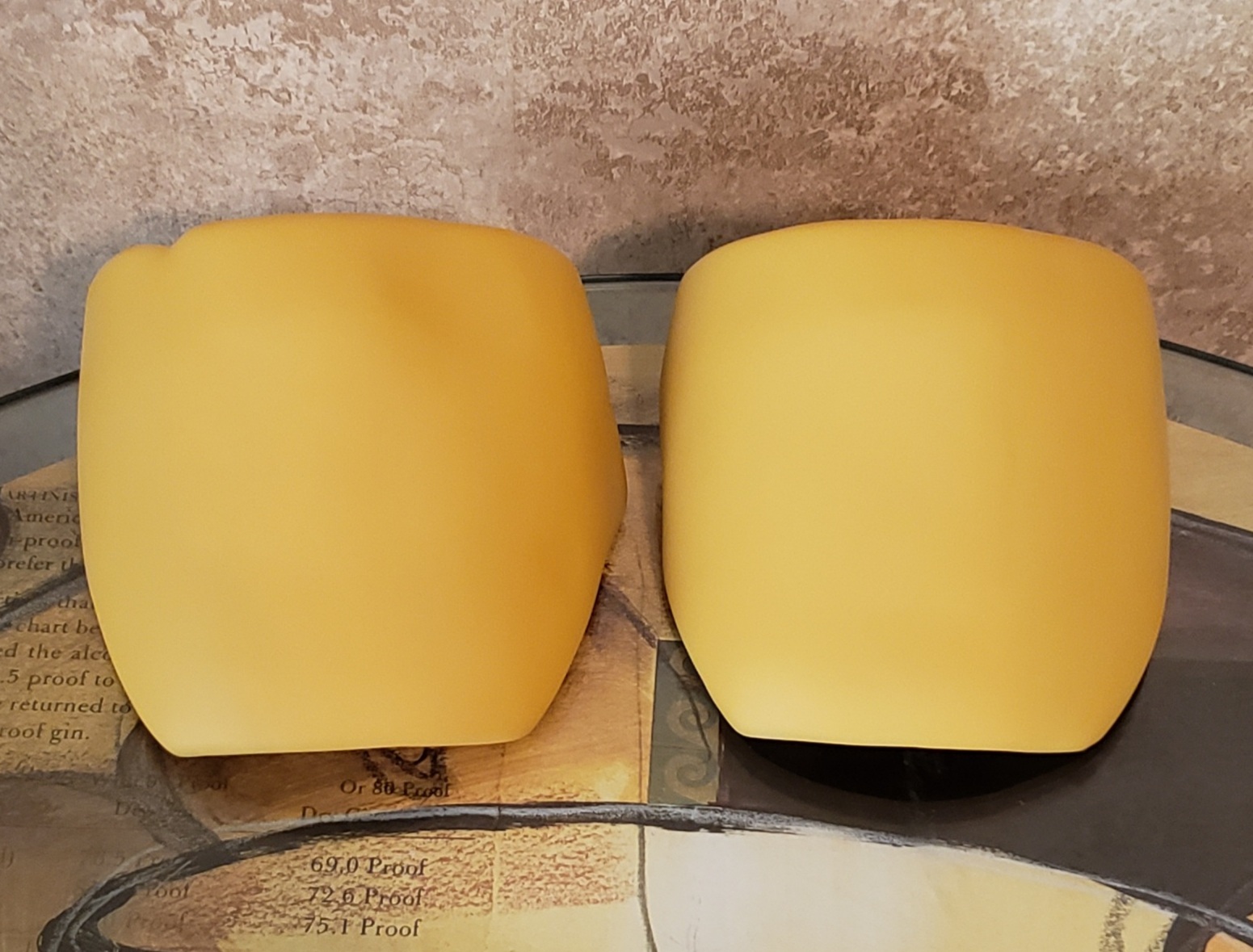

View attachment 224585 View attachment 224586
left side looks a tad darker yellow, is it my eyes? camera trick?
It does kind of look that way, but it's a trick of the light. Oh you naughty light! ;)

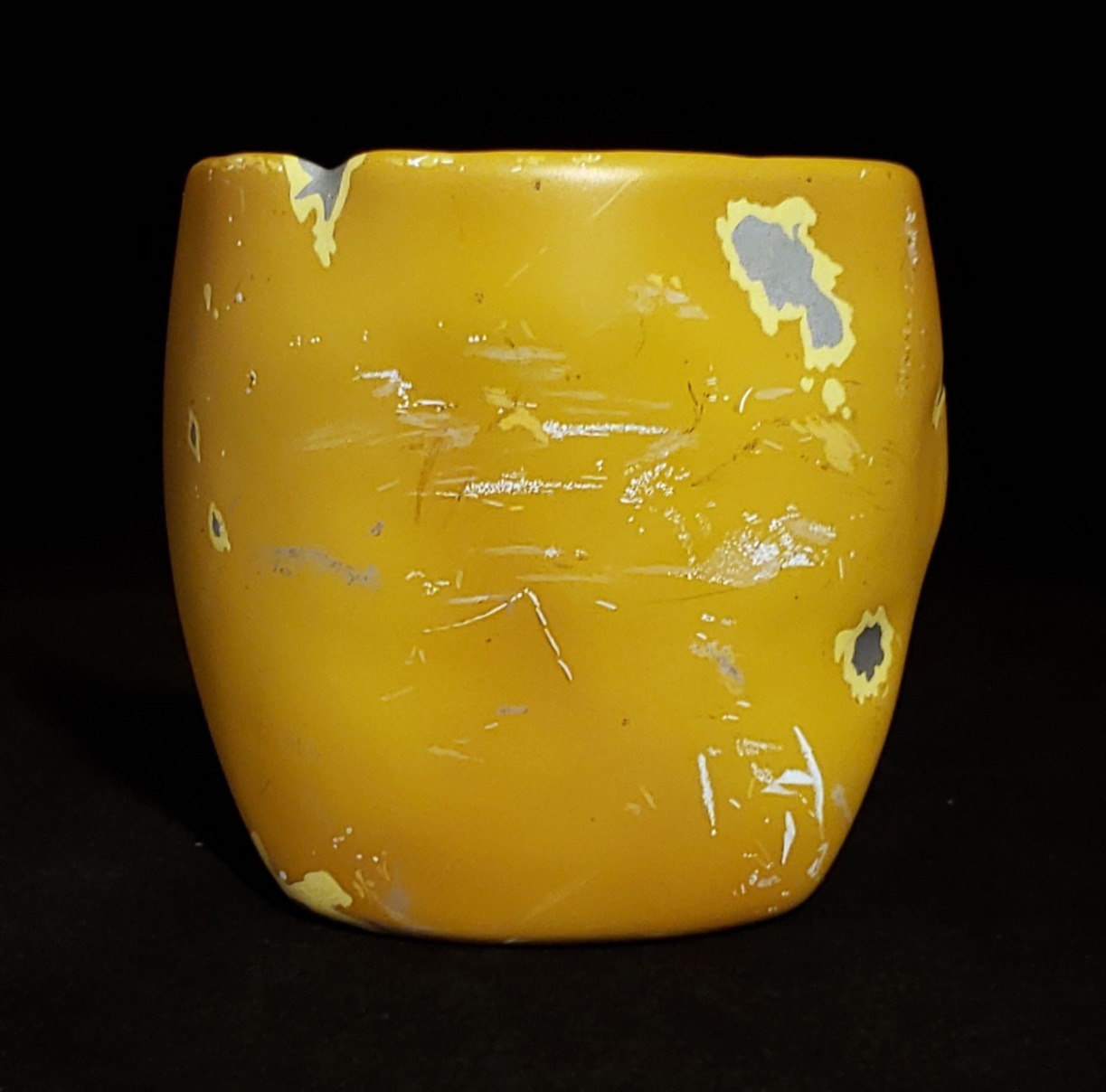

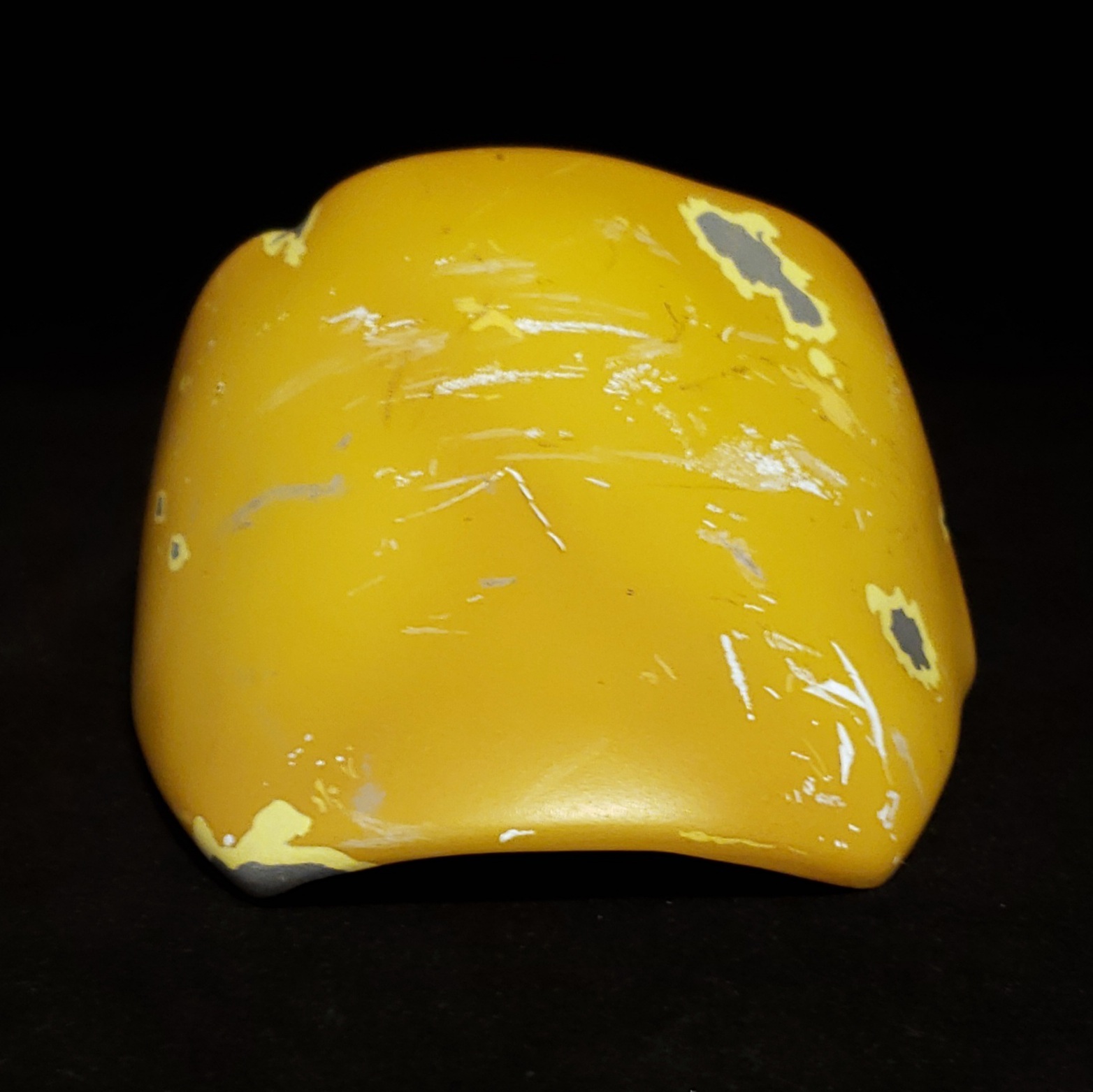

I did some shading on the shoulders. Reference pics of the original pieces show that the color isn't uniform over the yellow parts. There are areas where a darker tone is misted on. I used Archive-X acrylic Roof Brown thinned down quite a bit to get this effect.
I'll begin adding the damage next.
I added the main damage on the right shoulder. The colors used are vintage Polly Scale ATSF Catwhisker Yellow and Floquil Bright Silver.
The mid-tone yellow chips which are slightly lighter than the main color is a custom blend of Archive-X SP Armour Yellow lightened with off white.
The SE grunge is coming next!

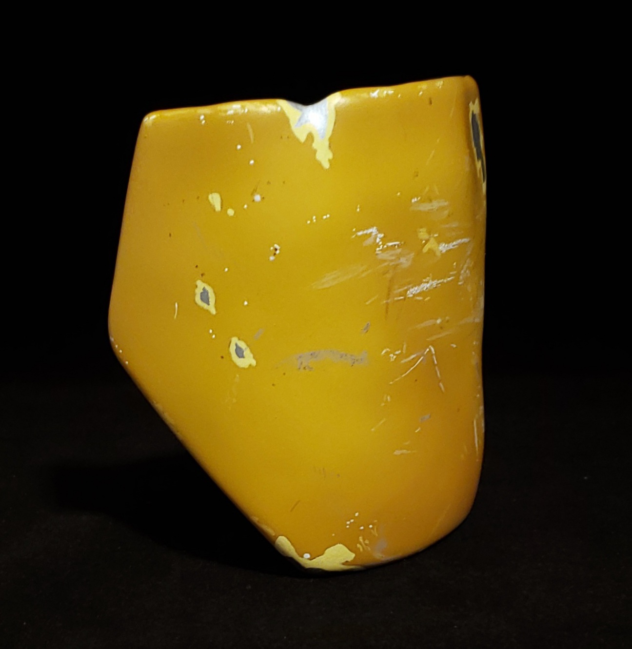

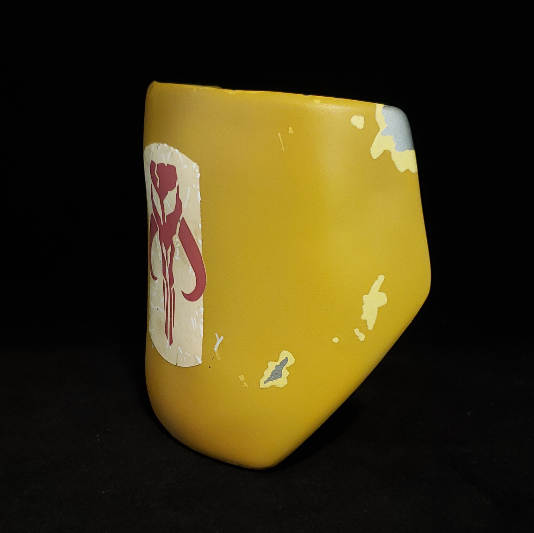

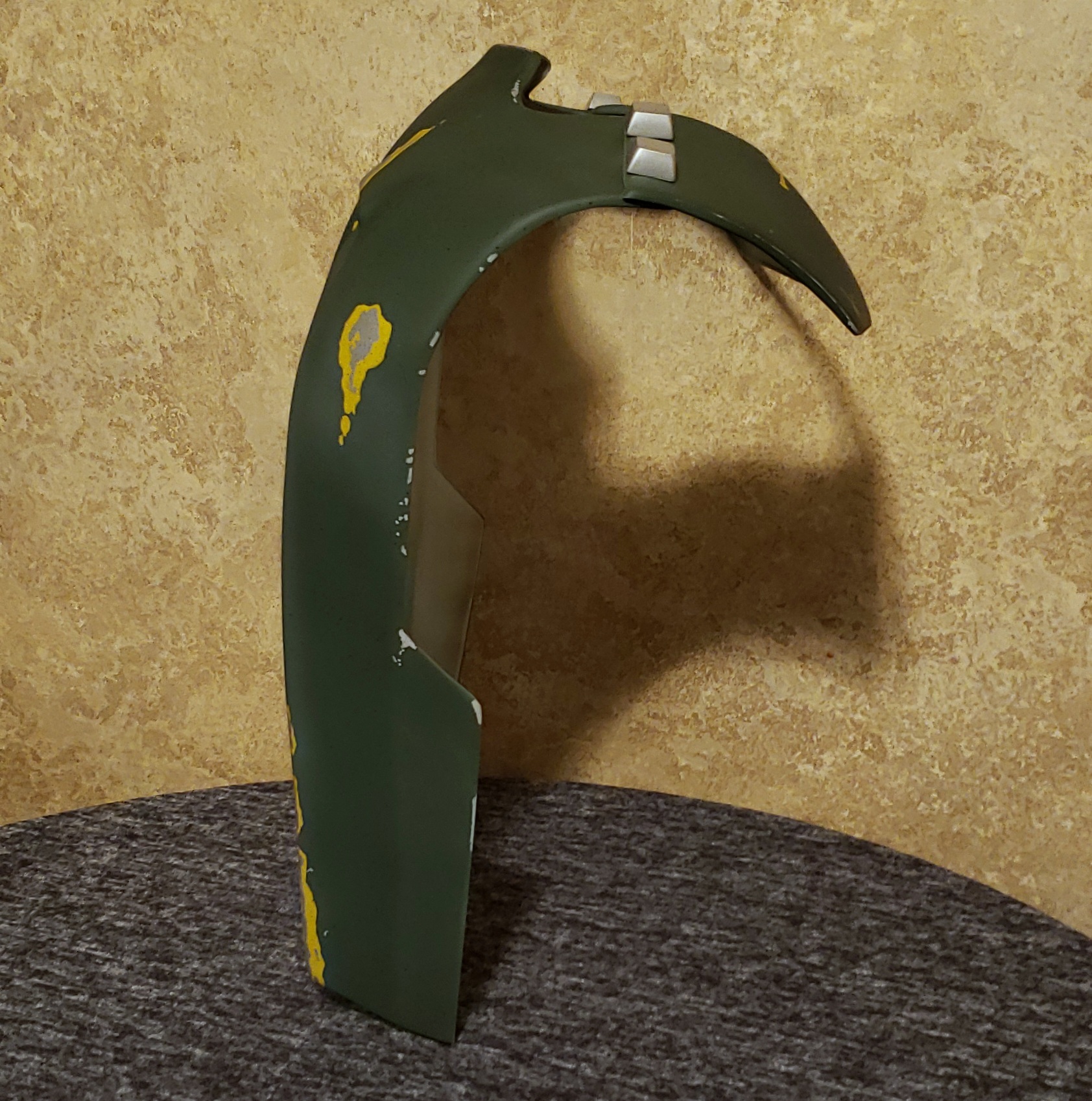

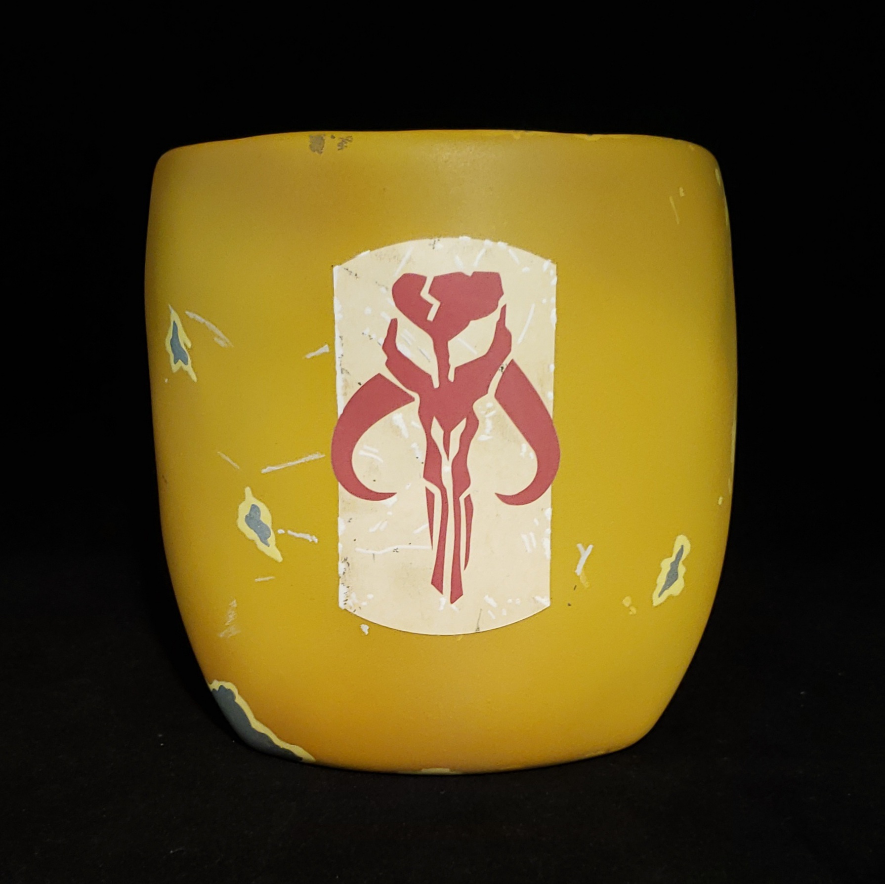

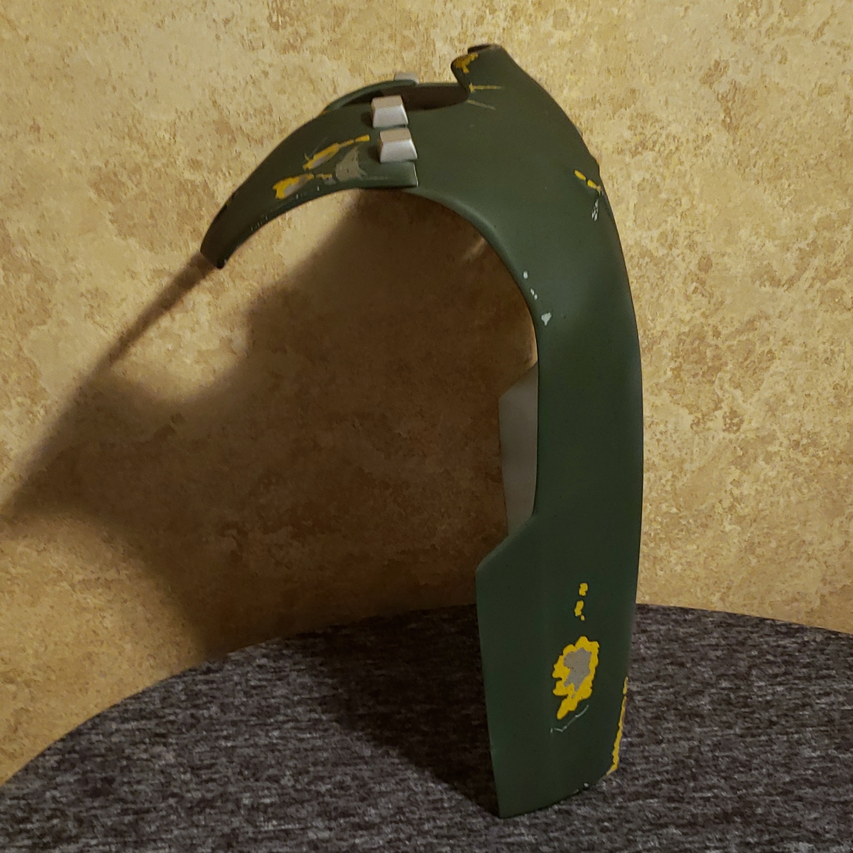

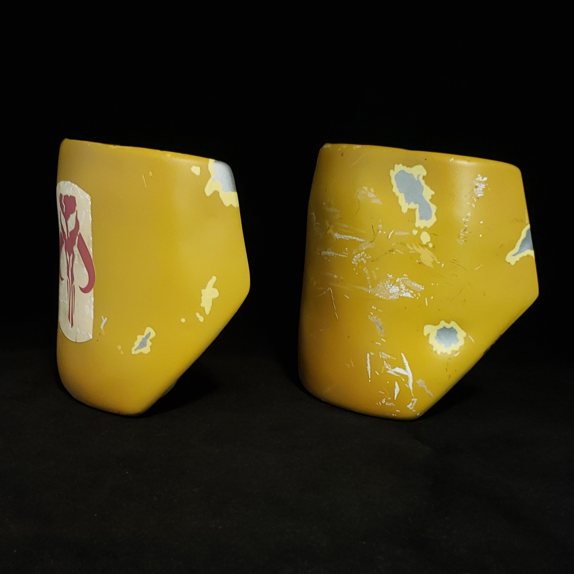

I've selfishly been working on my own gear again. ;)

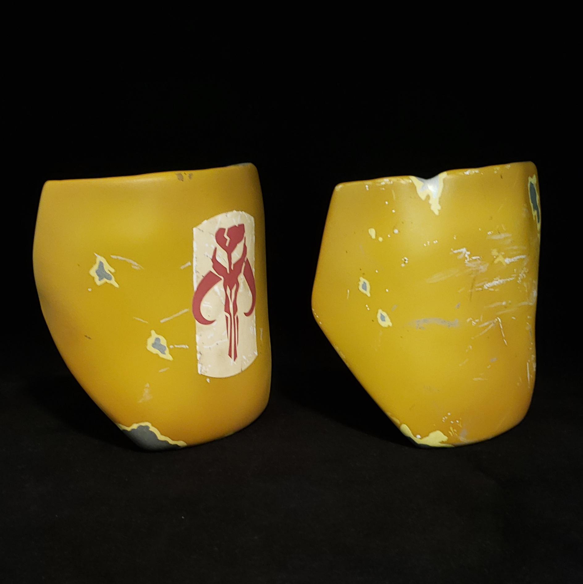

I finished the left shoulder for my SE armor build. As a reminder, these are shoulders made from the ROTJ "stunt" set sold at auction a while back. I got them in a partial trade from a friend of mine.
The decal was provided by Elliott Norton. Thanks!
Here are some shots of the shoulder along with views of the pair. I'm also including a comparison pic of the "stunt" shoulder and the one that used to be sold by Wasted Fett.
