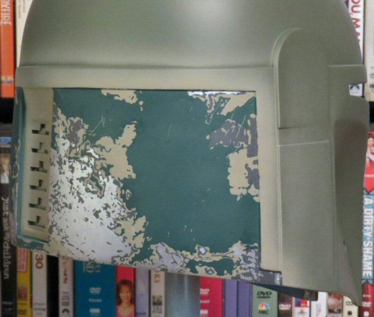

UPDATE #2: April 12, 2014
Right panel is done! :) There are some complex shapes in that area
in the lower right corner, but nothing like the huge silver area. Once again,
I used a sharp metal tool to do the very fine scratches.
Next up will be masking the back panels and spraying on the base coat for
the dome and cheeks.

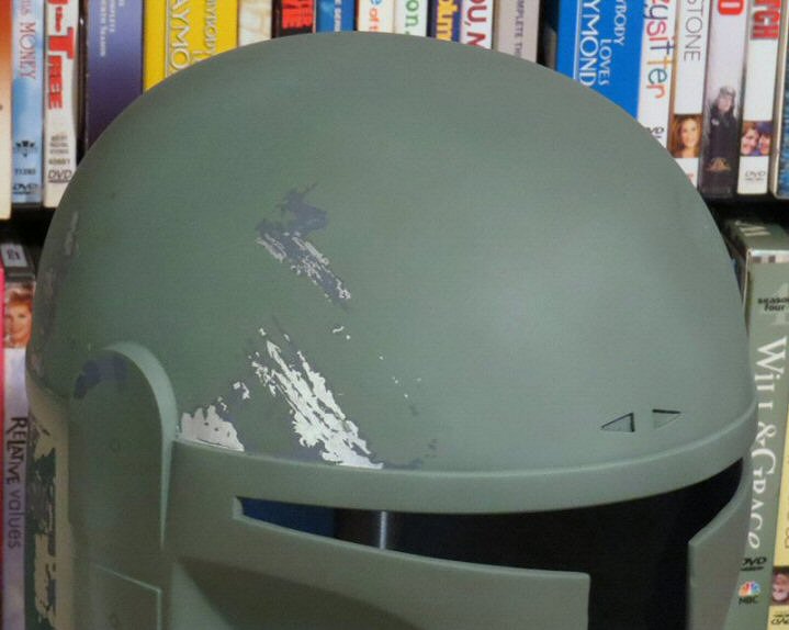

UPDATE: April 16, 2014

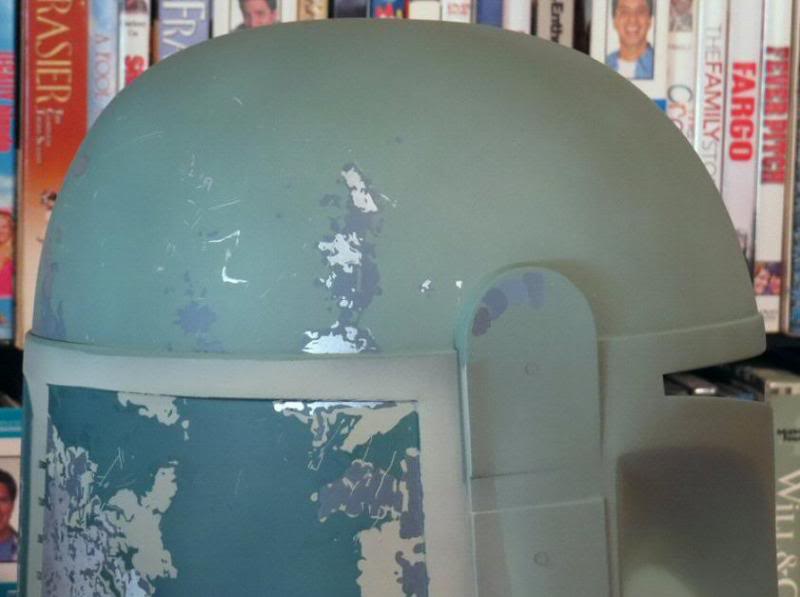

Moving around the dome now. Here's the area just behind the RF ear.
You can see some of the grays I tested on the upper platform.
Right after I post this update, I'll be crossing over to the front of the dome and
beginning the cat scratch and the associated damage. This is one of my
favorite areas to paint! So much fine detail crammed into a small section. :)

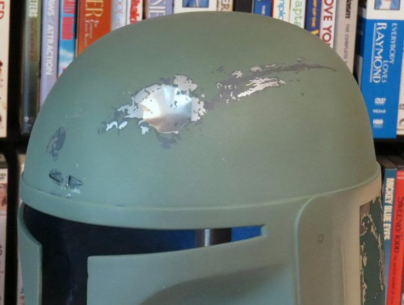

UPDATE: April 17, 2014

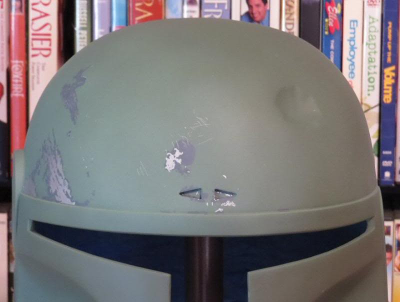

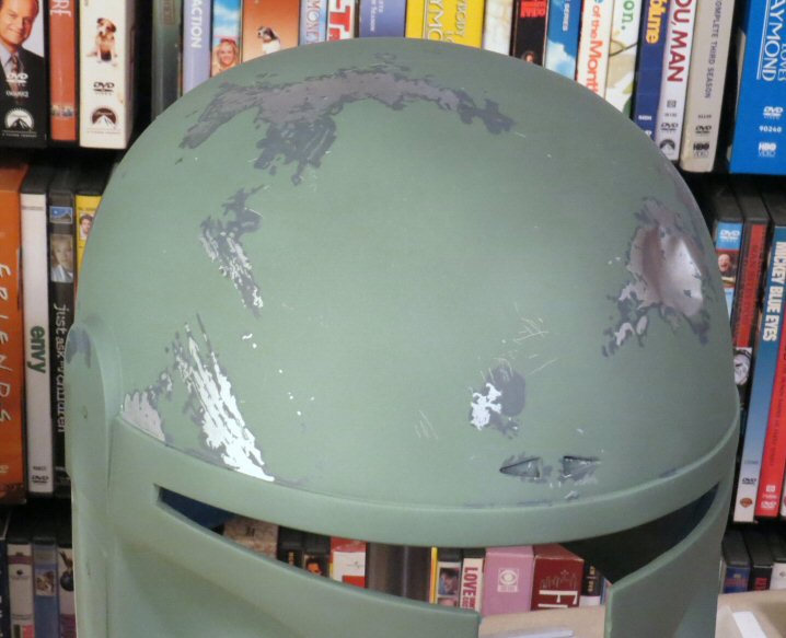

Couple of key features completed! There are 3 main damage areas in the catscratch section of
the dome. The catscratch itself, the smaller humped area just in front of the RF ear arch, and the
area above the catscratch. I generally try to do these parts together because they're sort of
interrelated as far as their positions go. The "negative space" between them is important, just as
the shapes are important.
I'm really digging this gray blend. It becomes stronger or slightly fades depending on the lighting.
Here are a couple of angles.
Next up will be the smallish scrape above the turn signals, then I'll begin. . . the dent!

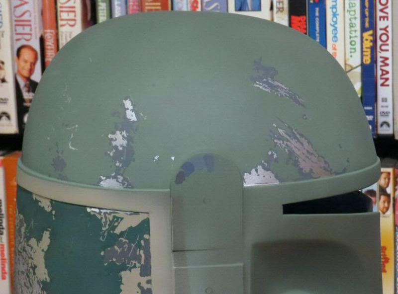

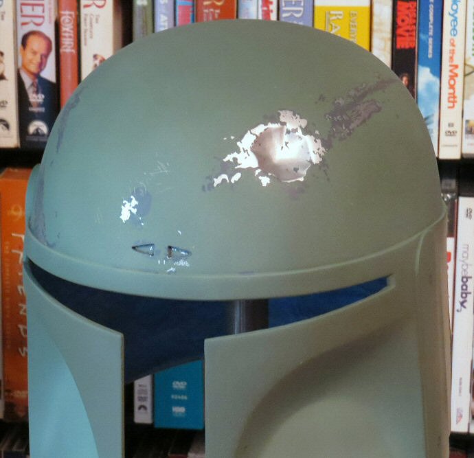

Got the dent area done! Still working with my gray and silver.
This is hard to photograph because of the reflections, so I took shots from
a couple of different angles.
The contrasting pale gray and the "blast damage" are yet to be added. I do those
steps toward the end of the project, just before the final protective clear coat.
Next will be the big crazy scrape across the top of the dome. After that
it will be killstripe time. There are a couple more silver/gray areas to do, but
their positions are dependent on the stripes, so I do those after the stripes
are airbrushed on.

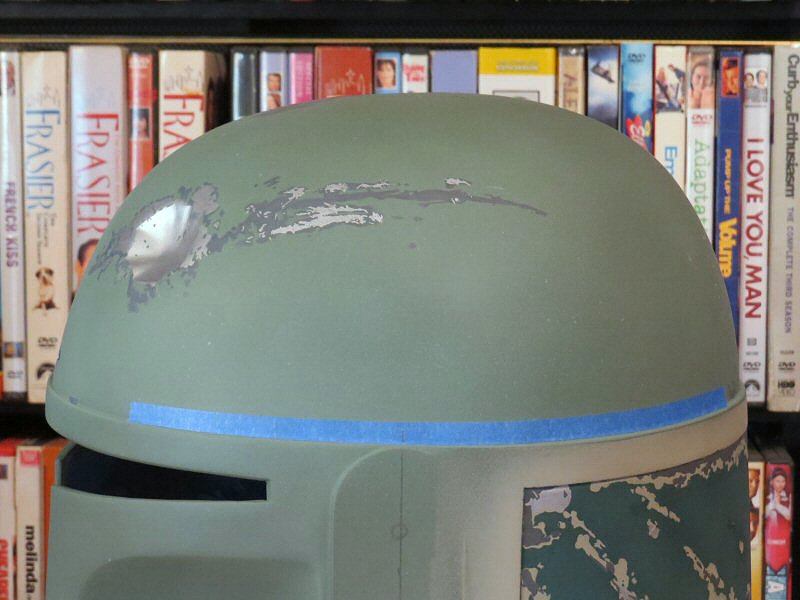

I begin by measuring out where the stripes will go. I use several reference pics to do this. It's
best to have reference pics that are as oblique as possible. In other words, pics where the camera
is at 90 degrees from the area you want to measure.

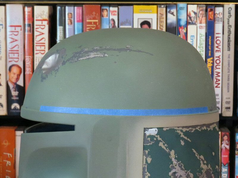

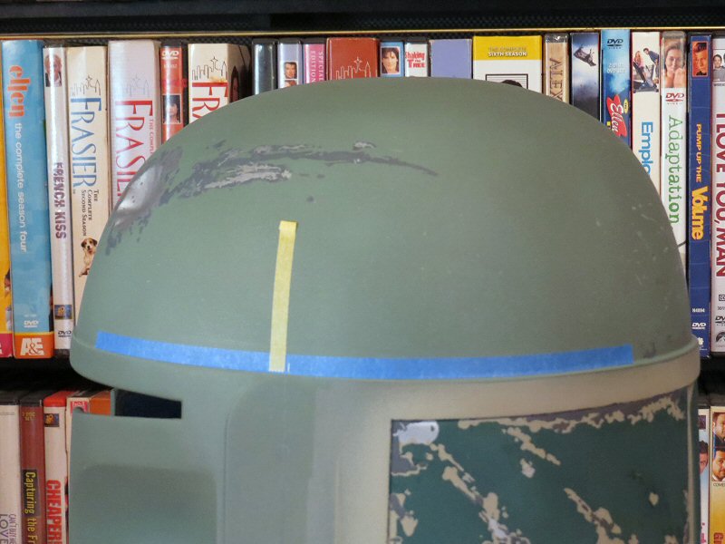

The first measurement I determine is how much space there is between the red band and the bottom
of the killstripes. The best measurement I could get was 7 mm. (I always do my measurements in
metric. I can get a greater degree of accuracy that way.) I cut a strip of blue painters tape that is
7 mm wide and apply it to the helmet. I keep it flush with the upper limit of the "hat band" ridge.

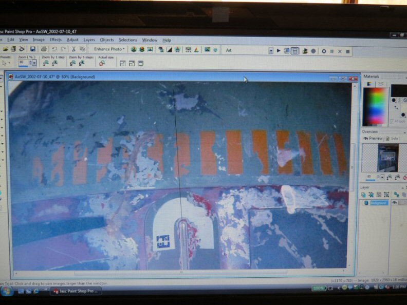

Next, I use reference pics to determine the position of the stripe above the left ear. In this pic of
my laptop, I have drawn a thin line that goes right up the center of the ear piece. It shows that the
stripe above the ear has its front edge slightly forward of the ear centerline.
I mark the center of the ear platform on the helmet and extend that line upward onto the
blue tape. This will help determine the placement of that stripe.

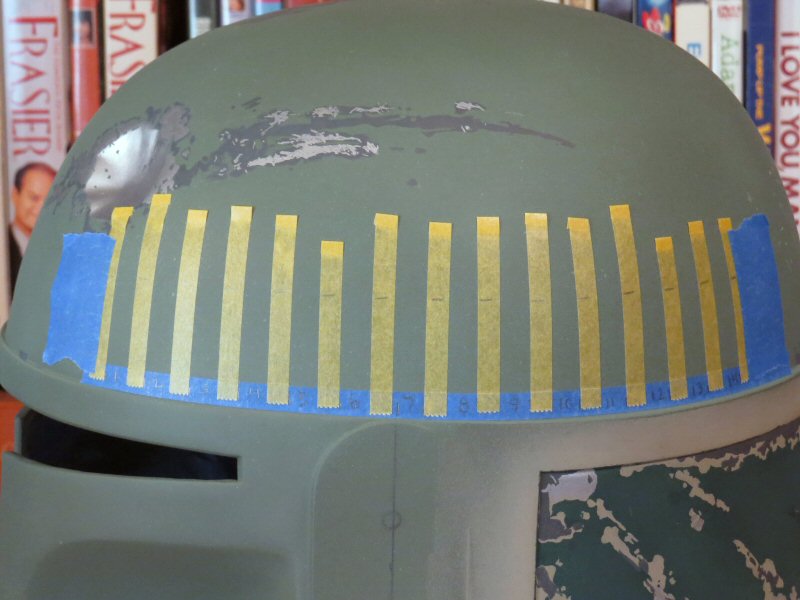

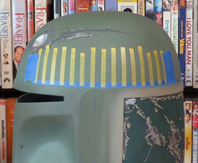

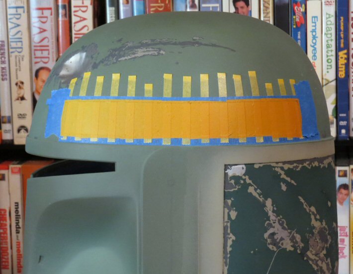

The measurements I have come up with for the stripes themselves are: 8 mm wide, 25 mm tall,
with a 6 mm space between each stripe. Tamiya makes a 6 mm masking tape, which is perfect
for taping off the spaces between the stripes.
I use the line I made previously and apply the first piece of Tamiya tape. In the following pic, you
can see that I've positioned it slightly forward of the pencil line. This makes the front edge of
that stripe slightly forward of the ear centerline, just as I explained above.

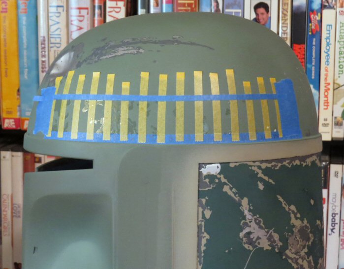

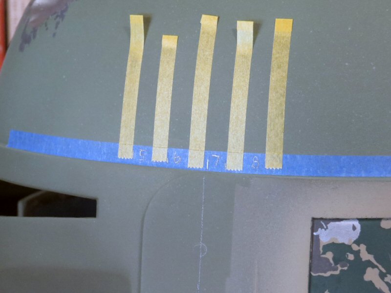

I then measure and mark lines 8 mm on either side of the Tamiya tape. Then I continue to
apply strips of Tamiya tape vertically, marking out the killstripes. I generally write a small number
below each stripe so I don't get lost when I mask off the chips! :)
I continue this process until all 17 killstripes are masked off. Ahaaa!! Caught you napping. . .
there are 14 stripes of course.
I then mark off 25 mm vertically from the bottom of the stripes (top edge of the blue tape).
I use another piece of blue tape to mark the upper limit of each stripe. I cut the tape thin
to conform better to the curve of the helmet.
Continued in next post!

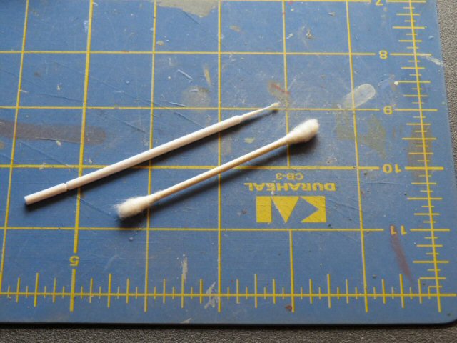

Now that the killstripes are marked off, it's time to mask off the chips. I like to use
Winsor & Netwon masking fluid. Just personal preference, there are lots of great masking
products out there. I also use the "Superfine" size Microbrushes to apply the fluid.
Here's a Microbrush compared with a standard cotton swab.

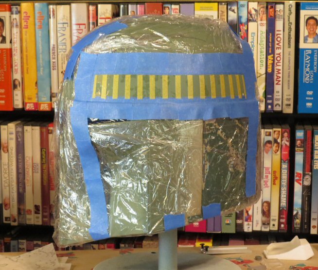

I've done quite a bit of work to the helmet by this point, and I don't want to take any chances
with any sloppy accidents, so I mask the entire helmet with some plastic wrap.
Now it's airbrushing time! (Pssshhhhhh. . . psshhhh. . . psssshhhh!) That was my airbrush
sound effect. I shoot a couple of light/medium coats of UP Armor Yellow, then give the
airbrush a quick rinse and immediately apply some orangey-red to the rear of the run of stripes.
It's a subtle color shift from about the middle of the run to the rear.
After I finish cleaning my airbrush, I go ahead and remove the plastic wrap. I leave the tape on
for a few hours while the paint cures fully. I use acrylics, so it really doesn't take a tremendously
long time. I also leave the tape on because I don't want to disturb the masking fluid while the
paint is curing. That can lead to headaches when trying to remove the fluid.

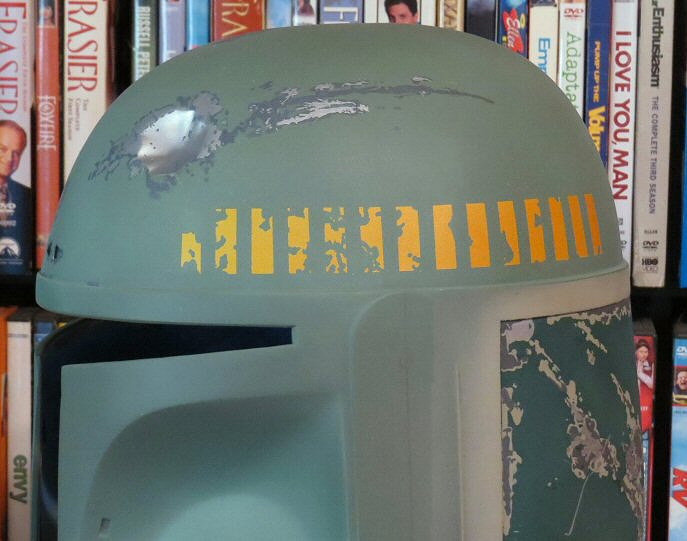

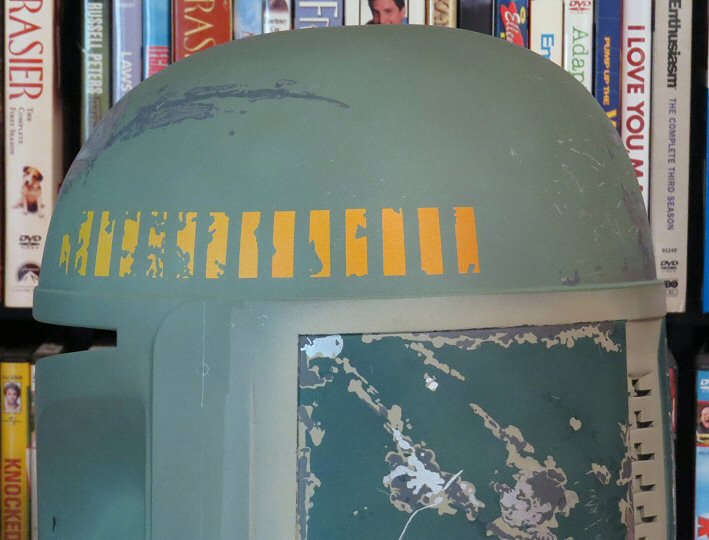

UPDATE #3: April 20, 2014
Results! :) Got the stripes unmasked and removed the masking fluid using my rubber cement
pickup. This is a very handy tool for removing dried latex-based mask.
Next I'll complete the damage on the dome by going back and adding the sections in between
and above the killstripes. Then it will be on to the inner cheeks.
