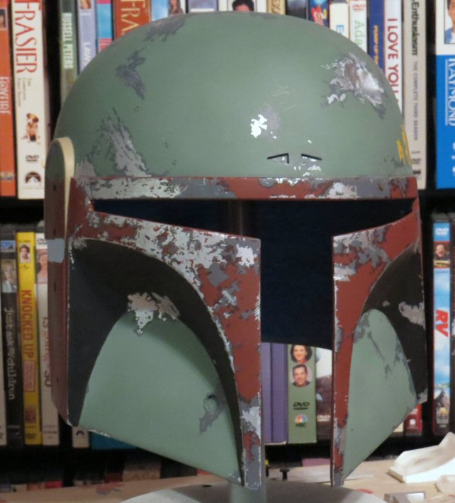

Right mandible is done. . . whew! This area takes me several sessions to complete.
There's such a wealth of tiny flecks and chips scattered through the silver and the
relation of each portion is important for the overall look.
Depending on which area of the helmet I'm working on, sometimes I apply the gray first, then go
back and add the silver. Other times I'll paint the silver first, then add the gray (and other colors as needed.)
With the mandible, I do the silver first to get the major damage laid in, then come back in 3 additional
passes to add the gray, the maroon, and a few key chips in the base red.
Here's a slightly closer look.
With this section done, the basic painting on the helmet is now complete! I'll begin the "effects" painting next.
This includes the fade beneath the killstripes, the white thumbprints, the "grease stains" on the back of the dome,
the contrasting gray, and the tan/rusty spatter over the front of the helmet. There will also be a bit of pastel
weathering around the dent, and on the inner cheeks. So there's still a little way to go yet! :)

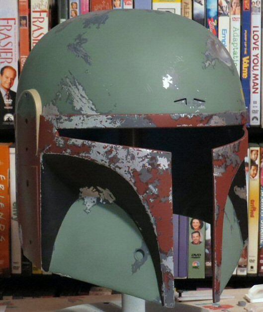

Closer and closer. . .
Got 2 small stages done this afternoon: the fade below the killstripes, and the white thumbprints.
The fade is subtle, and even more subtle in pics, but there's structure to it and I've tried to
replicate that as best I can.
The thumbprints are fun to do. Just some Tamiya flat white applied with a fine brush to
get the basic shapes, then "swooshed" back with a larger stiff-bristled brush.

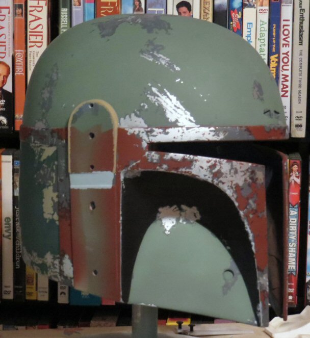

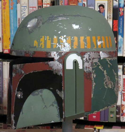

Here's what I've gotten done on the left ear so far. The base coat has been on since
I did the base coat on the dome, and I did the white arch today.
I measured it out and masked it off with tape. Then I used some masking fluid to do
the 2 chipped areas.
I'll work on the detailing next, as well as the detailing on the left ear pieces.
UPDATE: May 17, 2014
Got the left ear done and temp installed. Here are a couple of shots.
It probably takes me about as long to paint the bottom angled face as it
does to paint the entire rest of the ear! :lol:

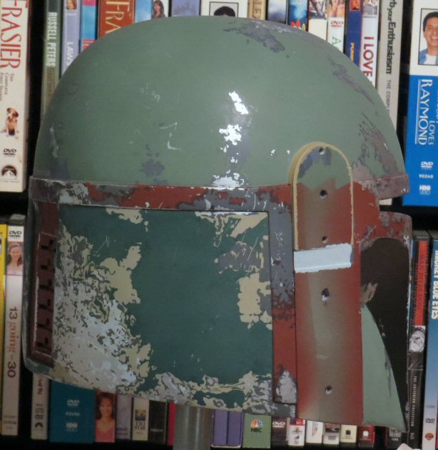

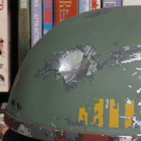

I've gotten all of the pale contrasting gray done. This is a nice subtle feature, and it looks very different
depending on the lighting angle. The gray is scattered all over the helmet, most noticeably on the right
rear panel and the dent, but it's in other areas, too.
Here's an angle of the rear panel where the gray blends pretty well with the silver.
When the helmet is rotated, it's much more apparent.
There's a decent amount of the gray on the edge between the right mandible and the outer cheek.
But it's much less than on the rear panel, so it's more subtle overall. Here are 2 different angles.

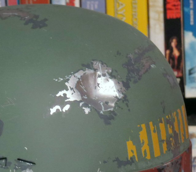

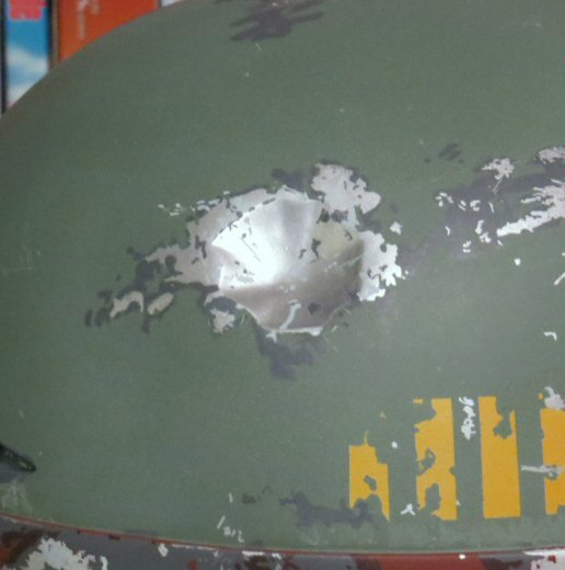

Within and around the lip of the dent, it's lots of thin strokes and chips. Here are 3 angles as
the helmet is rotated. Some of the gray seems to disappear then reappear.
So that's the gray stage complete. :) I'll begin working on the grease stains on the back of

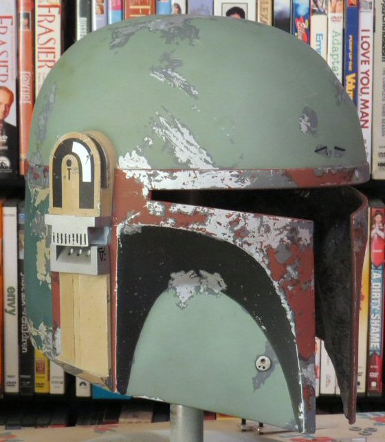

OK, here are a couple of shots of details I've been working on while I'm waiting for the
replacement RF stalk. Hoping it will get here soon, as it's just about the only thing left, LOL.

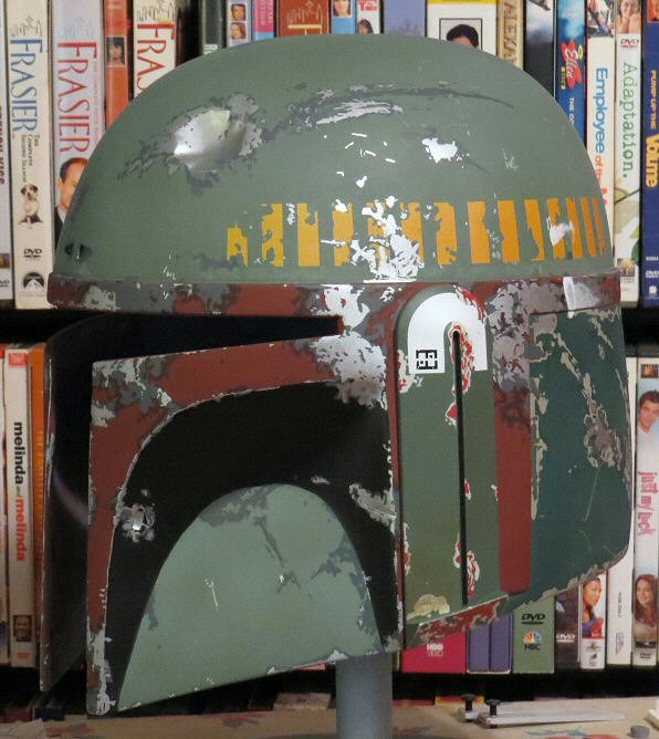

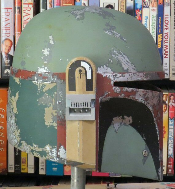

I completed the detailing on the RF ear. Did the gray and silver damage, masked off and
sprayed the Testors Metalizers, and applied the small markings.
I use dry transfer lettering to do the small markings. My technique differs slightly depending
on whether I'm working with resin ears with the bare metal painted on, or real metal ears.
For real metal ears, I rub on the letters intact, then use a sharp plastic tool to do the chipping
and scratches. The plastic tool doesn't damage the aluminum, so it's easiest to do it that way.
If I'm working with painted resin ears, as I am in this case, I chip the letters before I apply them.
I just use the tip of a brand new #11 X-acto blade and very carefully add the chips before
I rub the letters onto the ear parts. I tried chipping them after they were applied on another
helmet a while back, but it marred the silver paint and I had to sand and respray the silver.
Here's another angle.

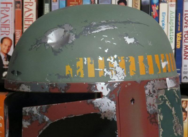

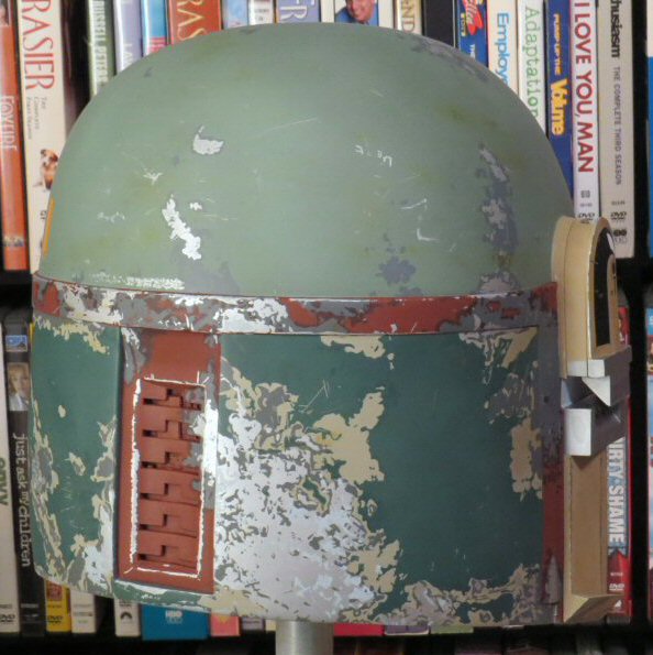

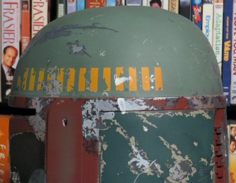

Difficult to see in the pics above is the spatter that's been applied over the front of the helmet.
I mix up a nice rusty shade using Tamiya Khaki and Red Brown, then thin it down so it's pretty
watery. Then I flick little droplets on using an old toothbrush. Primitive, but effective. :)
In the second picture above, and in the following pic, you can see the "grease stains" on the rear
of the dome. These are concentrated on the rear half of the dome, although there are some
stains on the sides of the dome, on the rear half of the red band, and even a couple of minor spots
on the rear panels.
