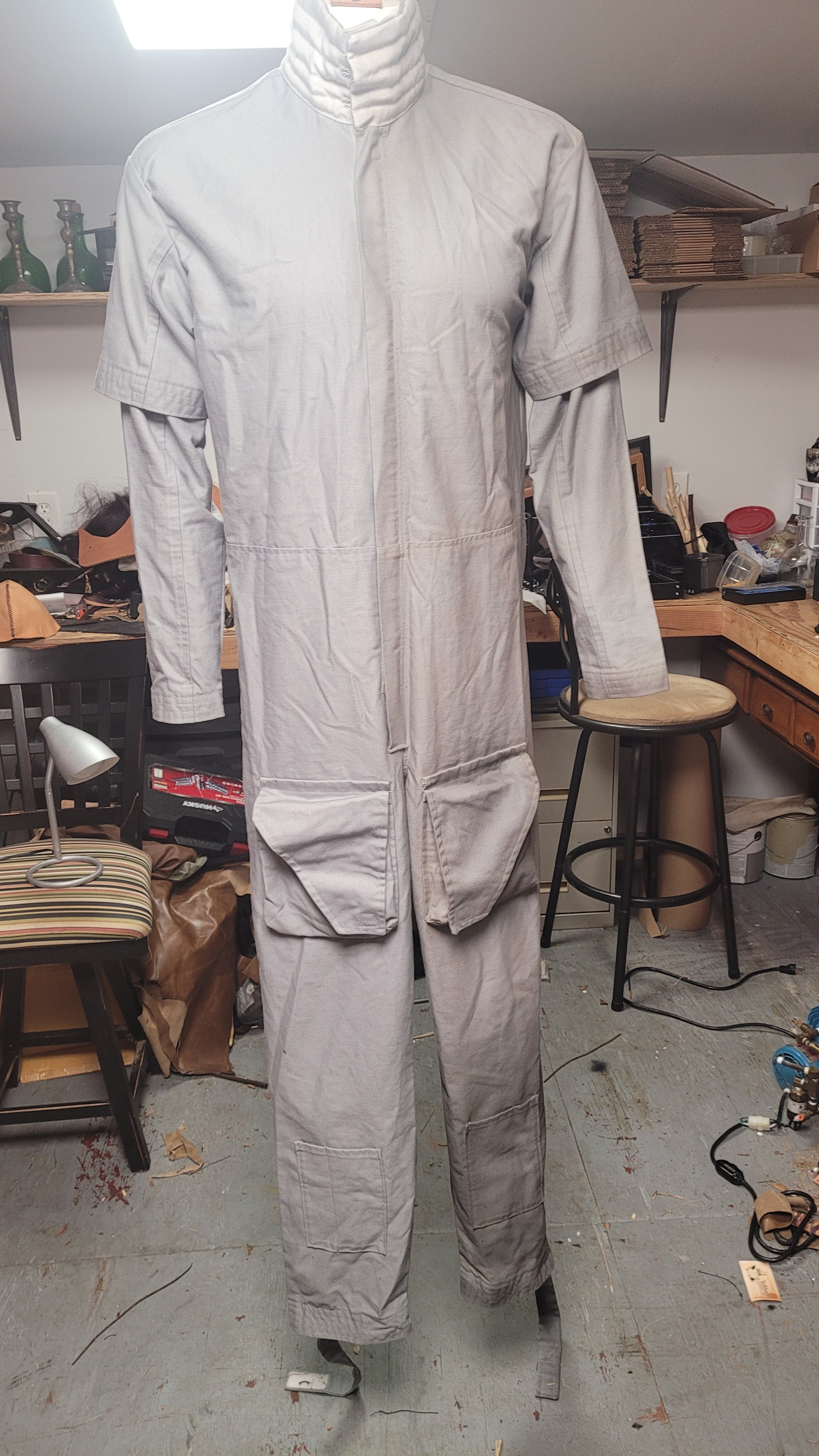

Tonight I began weathering the flight suit. My double action air brush took a crap on me due to stripped threads so I resorted to my single action airbrush midway through and feel like I was getting better results anyway.
I only weathered the left side because I wanted a reference point. Weather vs non-weather. I started with a 1:1 mix of grey and sandstone to lay in the desert sands. Afterwards I went straight nutmeg brown. Then I laid on the black mist for the heavy soot and dirt. I feel like I need more of the heavy soot though.
I took photos to close the night and as I write this post I SEE the picture difference. My jumpsuit is a light blue grey! How does it look tanish grey?! Lighting and camera. Just like in the films. Crazy lol.
So what do yall think? Input?

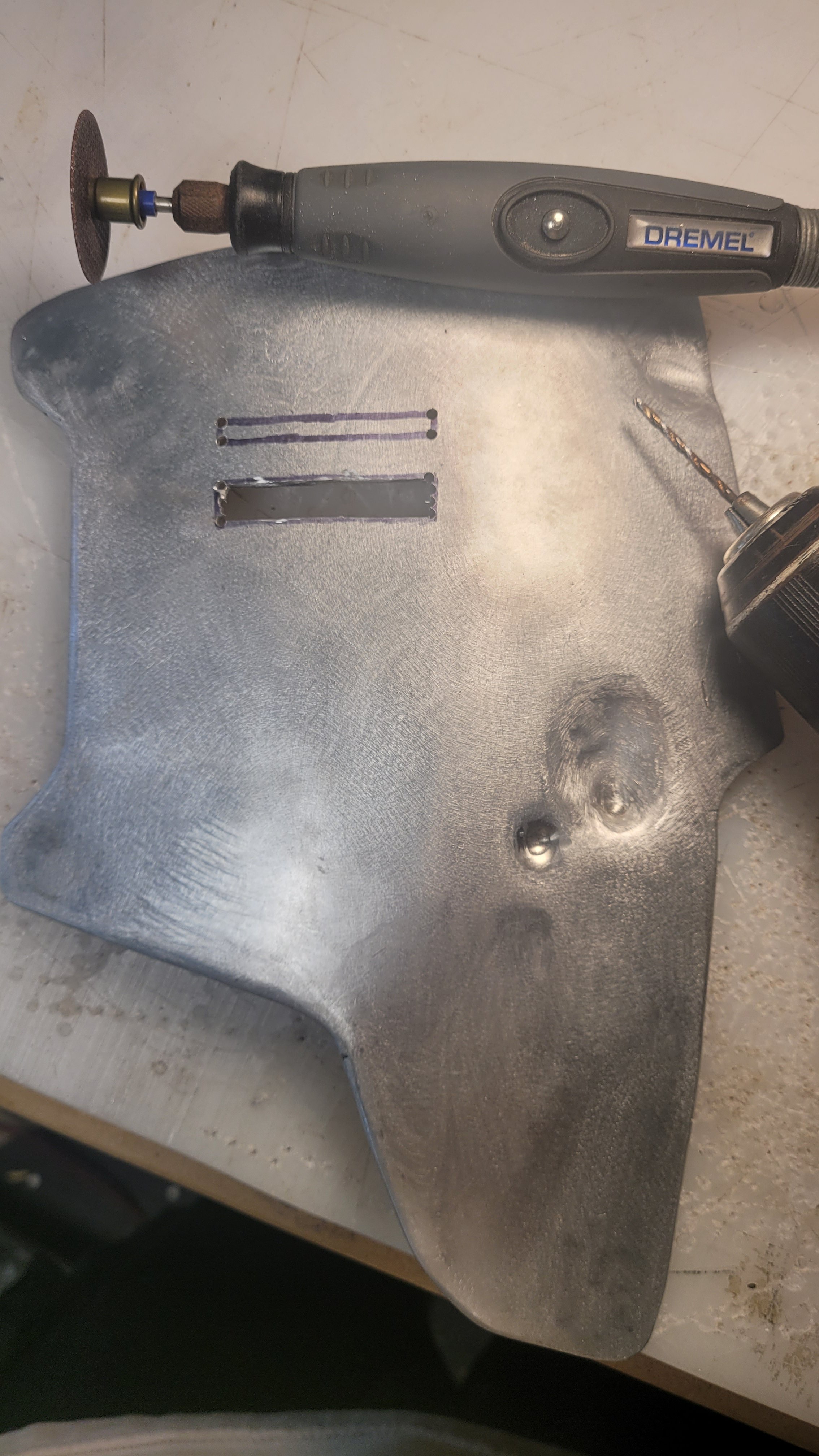

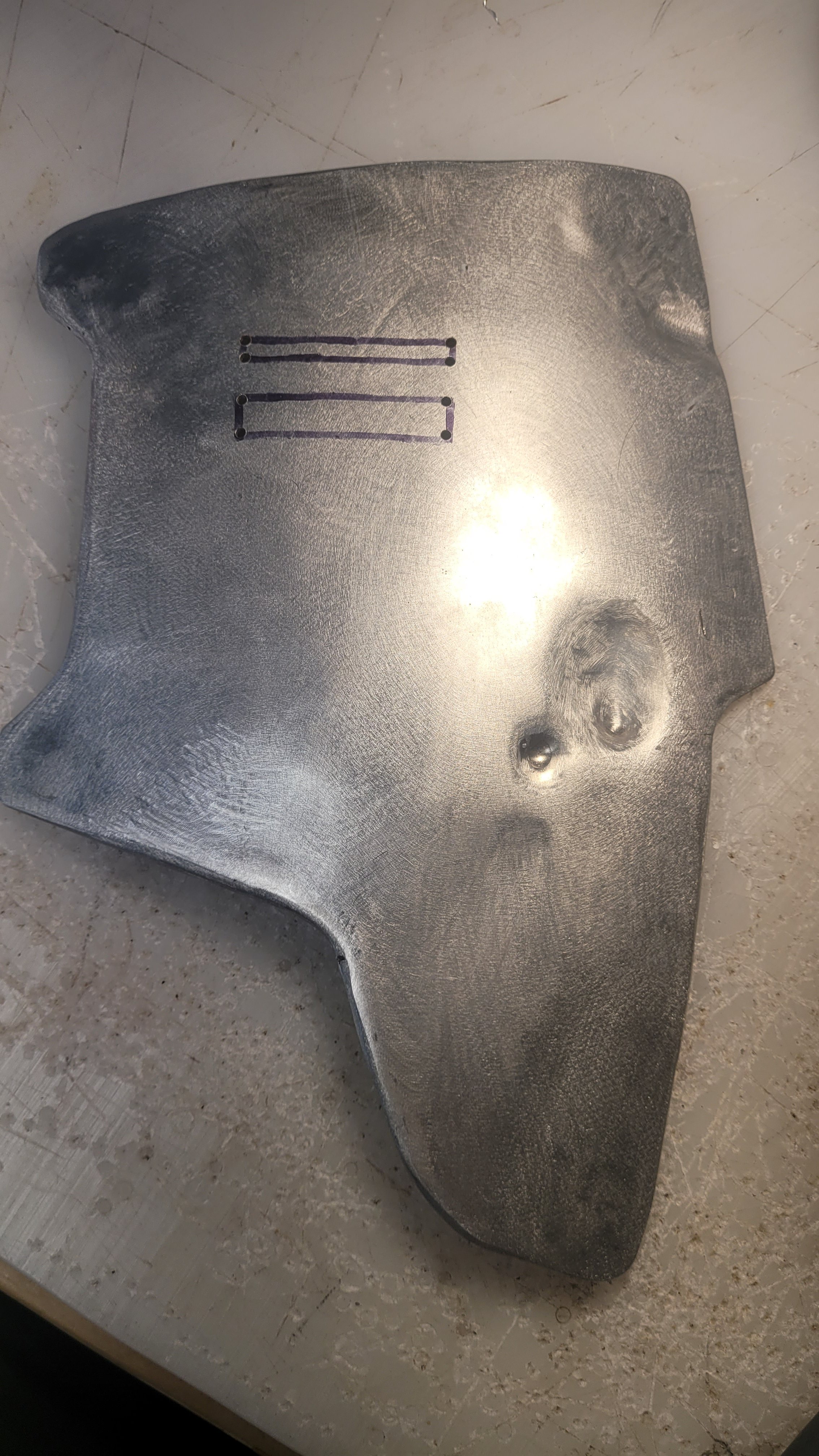

I began by marking out the slots where they would go.
Using a small drill bit, I drilled out the 4 corners of each slot and then followed up with a dremel cut off wheel.
Then a little bit of dremel stone clean up and so slow and methodical file work to get it just right.
A text fit of the first slot.
Omg it's so awesome.
Wow I gotta agree with you that looks awesome! And is the plate as heavy as it sounds, because it sounded that way. But it def looks the part…solid work.
It's not terribly heavy. I made it out of sheet aluminum about .0625 of an inch thick and folded the edges to make it LOOK heavy without it BEING heavy.
But it's super awesome that all armor pieces are aluminum! I mean.....beskar.......

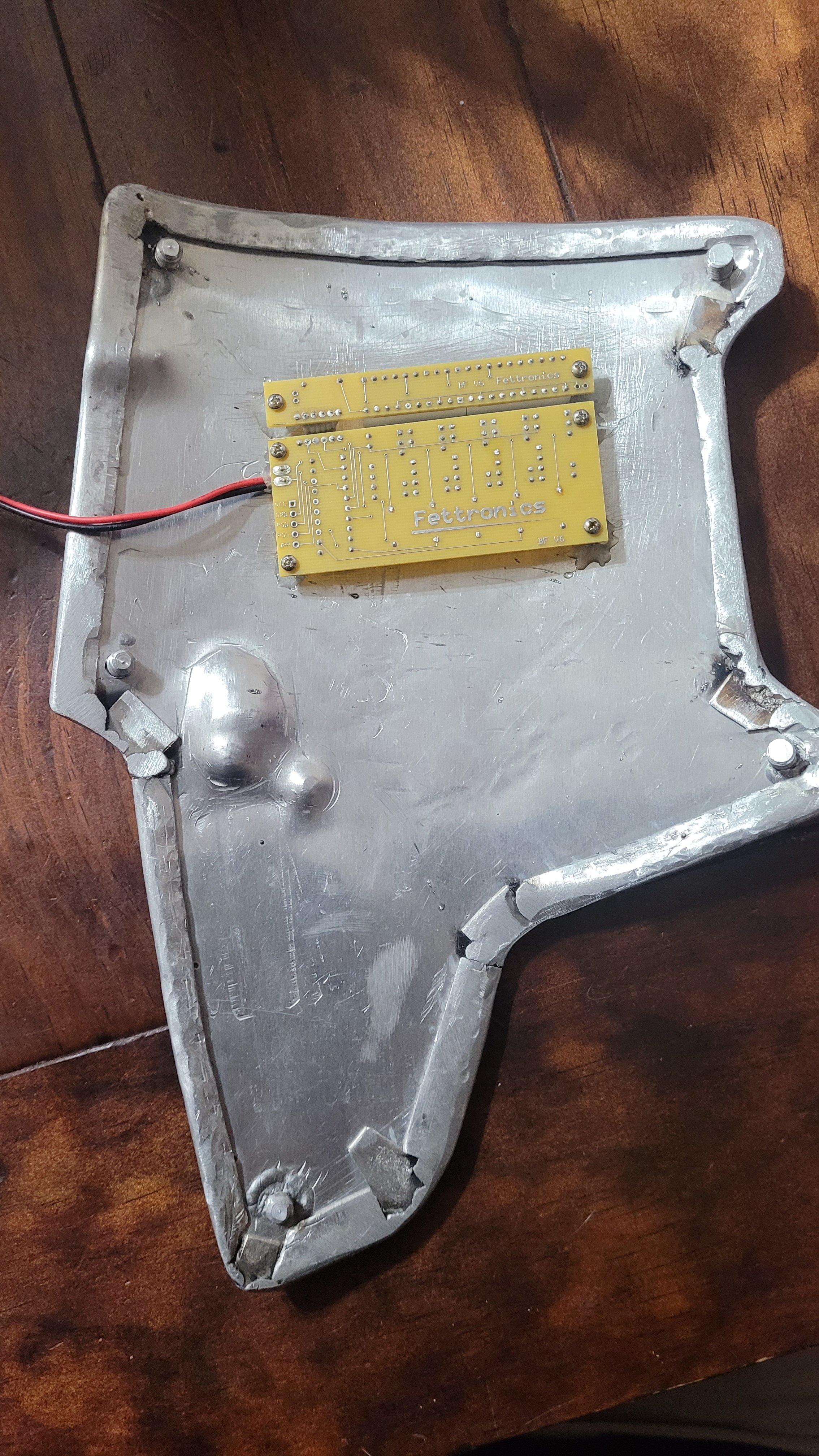

I did it today! Check it out.

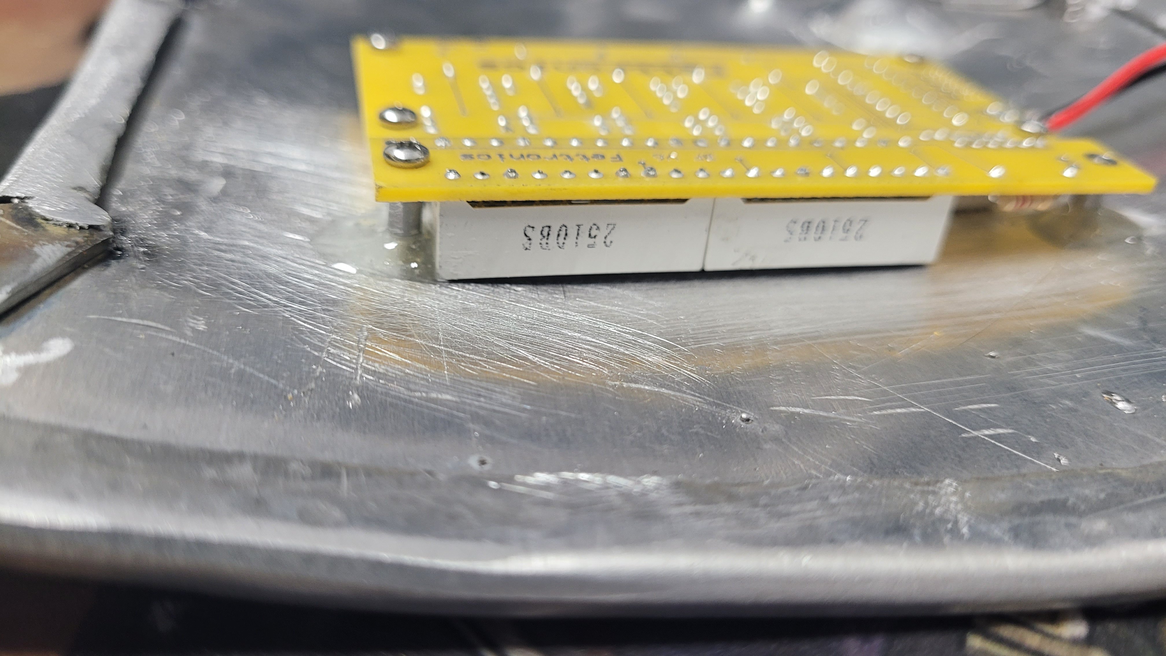

I ordered some aluminum standoffs and screws to fit the Fettronics' circuit boards and installed them.
I set them down on the aluminum chest piece and started filing the posts until I had the right angle and epoxied them in. Check out the video!
Here are some photos.
20240801_195420.jpg20240801_195434.jpg20240801_200436.jpg20240802_131303.jpg20240802_131309.jpg20240802_202810.jpg

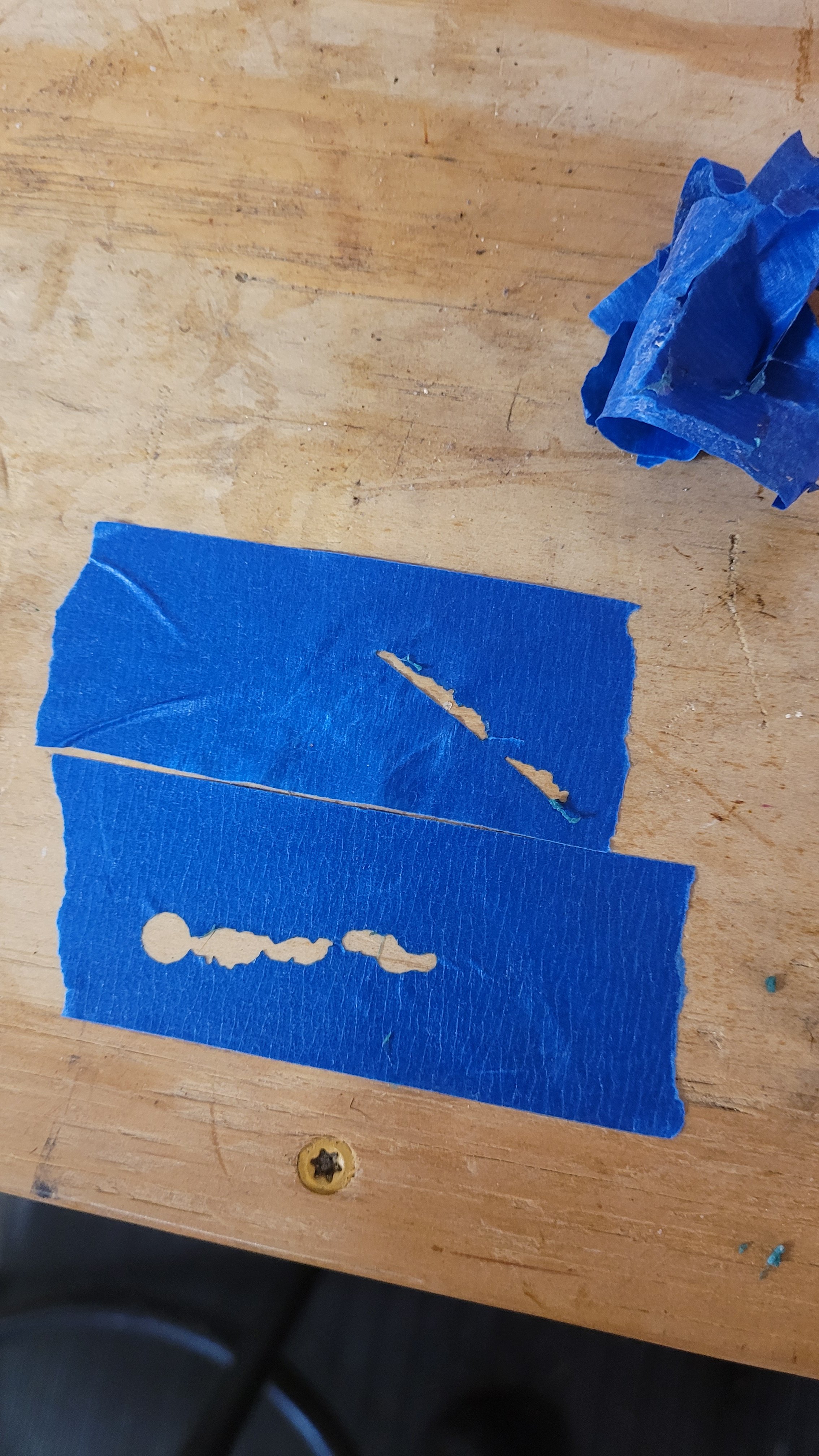

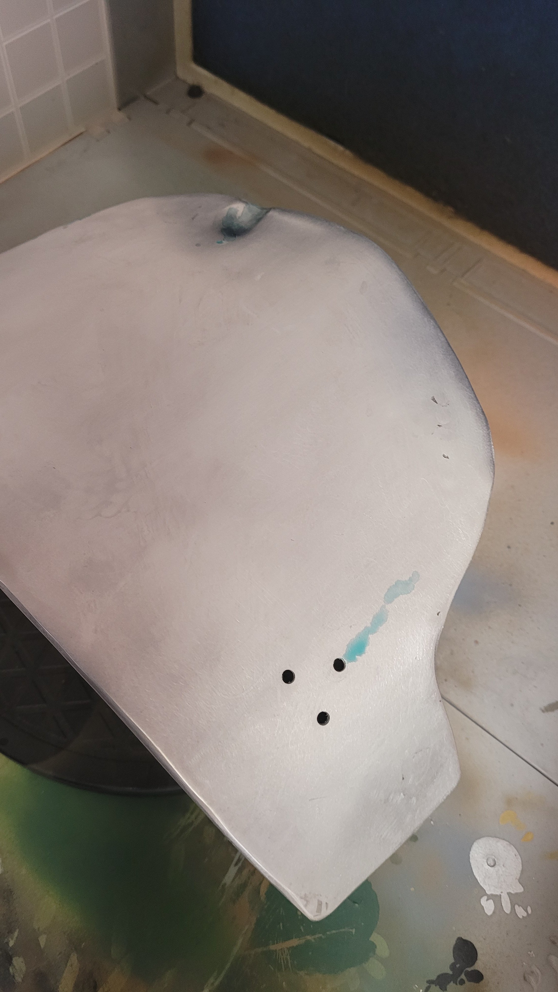

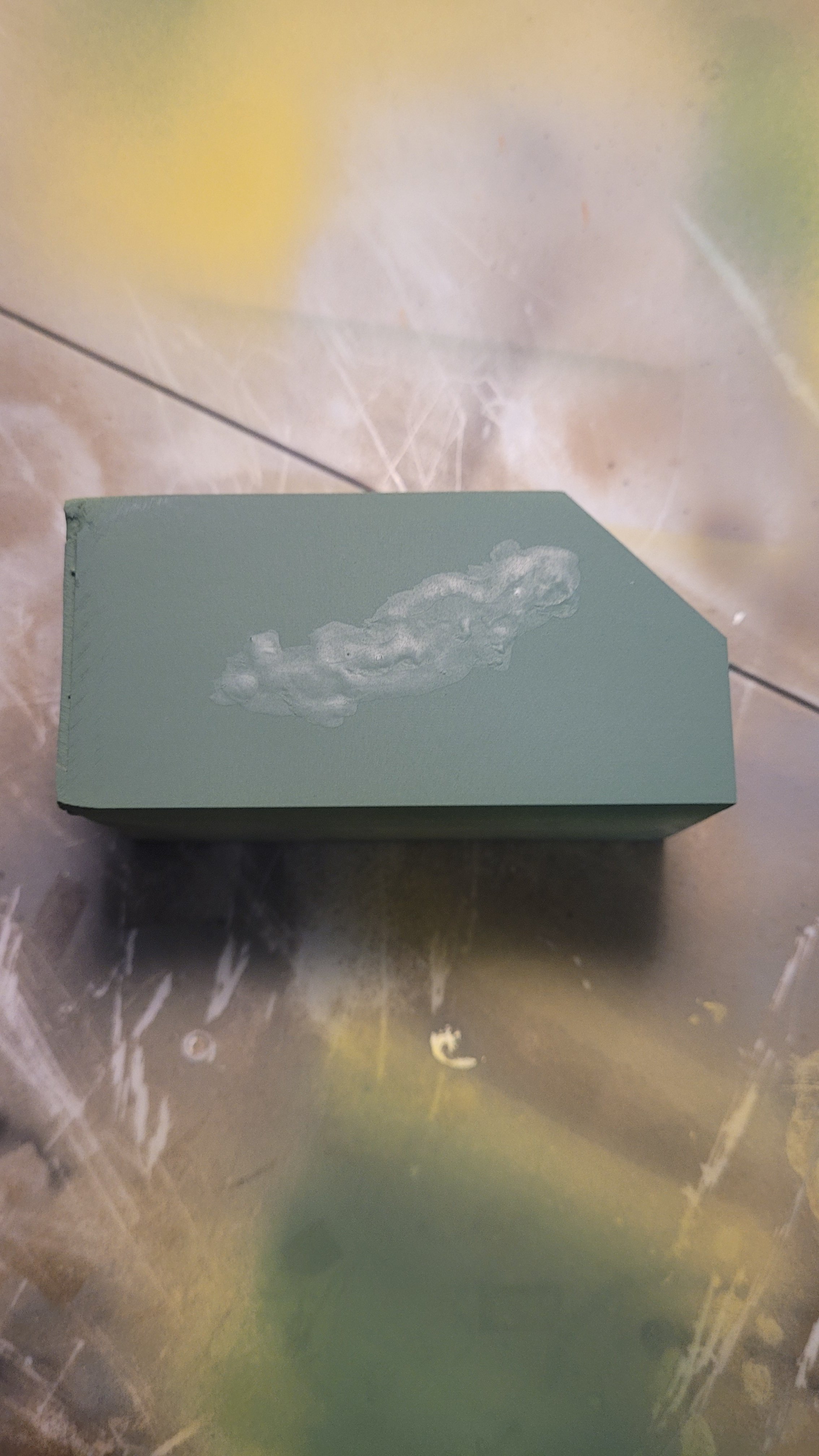

Well some paints arrived and I played around with them and masking fluid. I tested this on one of my extra aluminum ammo pouches.
Here's the video of the reveal:
That turned out pretty good, although you may get mixed results putting multiple layers of paint over multiple layers of the masking fluid.
