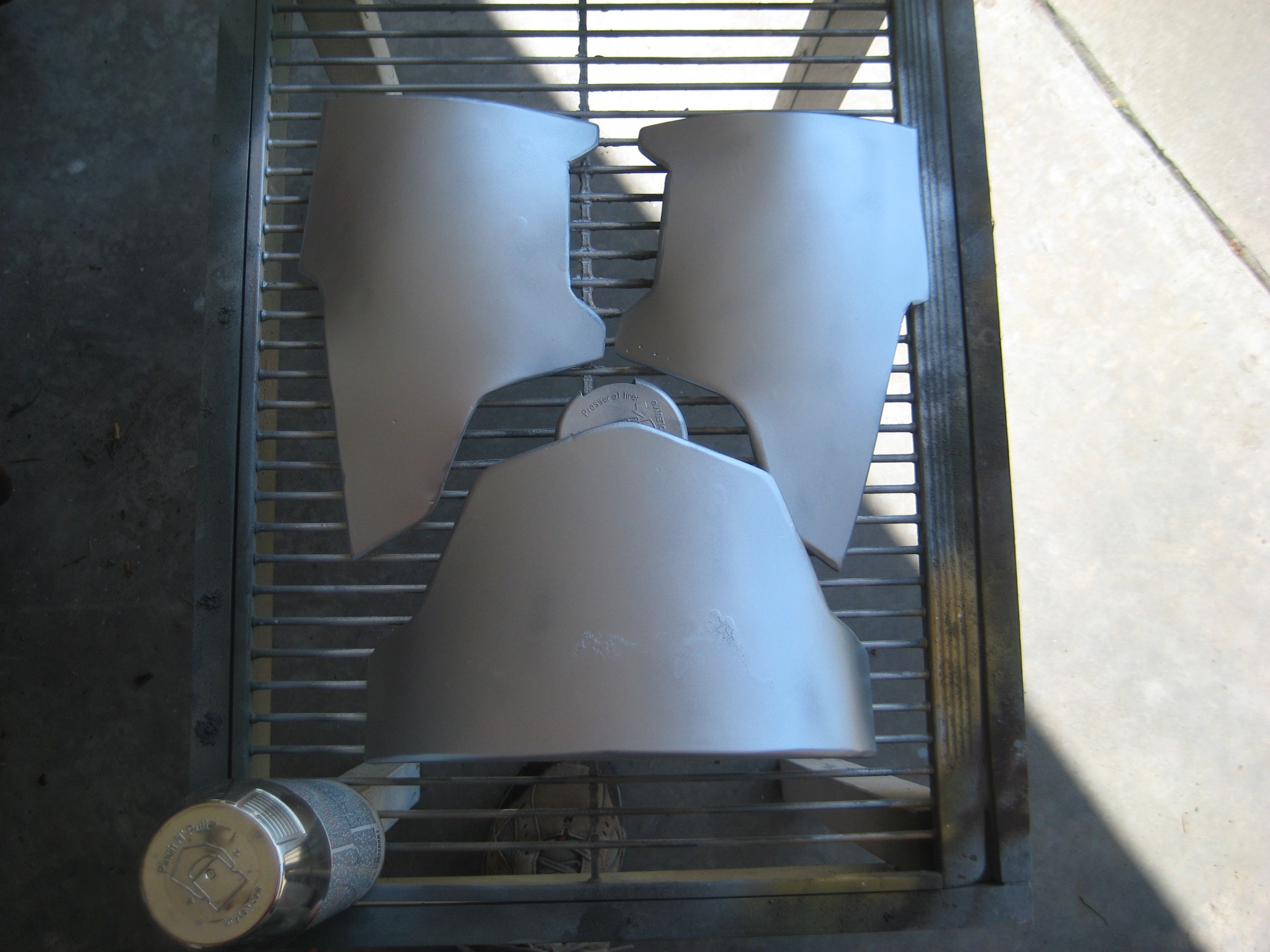

This is 6mm armor that I made a few years back when I had NO knowledge or experience in the hobby. So you can see it is not too tough to do.
Those 6 mm looks fairly thick. Do you have any experience with 3 mm?
