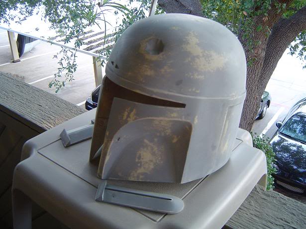

Is this area I've marked some kind of 'depression' in the surface? I'm wondering if it's something to be filled in, or if the angle of the lighting is making it look weird.
It does look like a depression, you might want to fill it in with more puddy and sand it down.
Yes, GCN, I verified that in post #38. It is a depression, and I decided to add a small bit of putty to even it out. It's not very pronounced, and the final paintjob will hide most of it anyway.

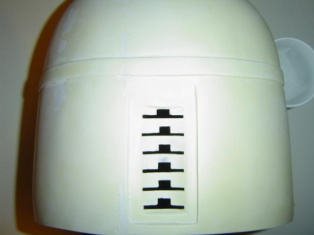

I've also worked a bit more on the keyholes:

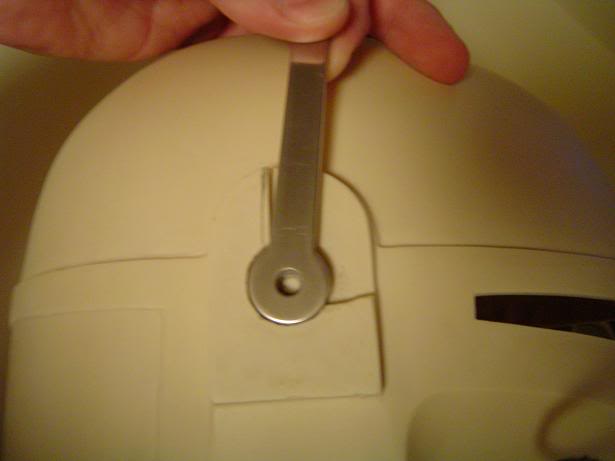

One thing I forgot to do was trim the 'stop' on the right earcap. I bought a new accurate BKBT stalk, and due to the angle, I'll have to trim a little off the resin (see the pencil marks):
I've still got some areas to go over again, but I should be pretty close to the first coat of primer. The paint will help me determine if there are any more issues.

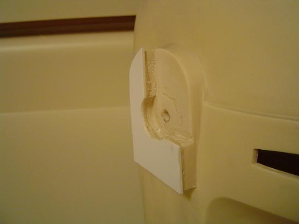

A slight detour...

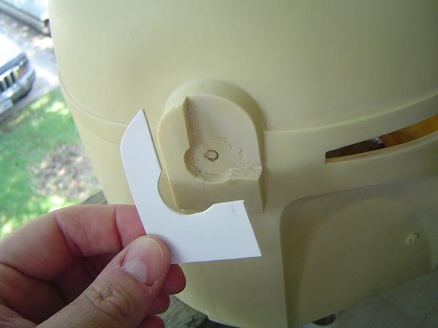

While working with the stalk last night, I noticed that the seat for the stalk is just barely the same width as the stalk. When I install the servo system later, the stalk may produce a little unwanted friction when operating.
Looking at the screen-used helmet, I notice that the correct way to avoid this is to sand the seat toward the helmet, as the seat is not quite as thick on the movie helmet. However, I didn't want to take a chance on sanding too much or sanding unevenly.
So I took a spare piece of 1/16" styrene and made an 'extension' to widen the gap a little. I'll glue this to the exisiting seat, and putty/sand the edges until they're uniform.

Batninja, so your helmet had the stalk angle thing too?
I was looking at my BKBT stalk, lined up with my Sarge helmet, a couple of days ago. And, I had to shave off about that same amount of the RF stalk holder, as you have marked. Otherwise, that stalk just sits off angle, like in your photo.
No big deal, it just took a minute to trim. I thought it might've just been my helmet.

Over the last couple of days, I've worked alot on the stalk spacer. For more pictures, visit my PhotoBucket album: http://smg.photobucket.com/albums/v715/batninja/Mystery Helmet/?start=all
Using Gorilla Glue (wonderful stuff!), I glued the spacer to the stalk seat:

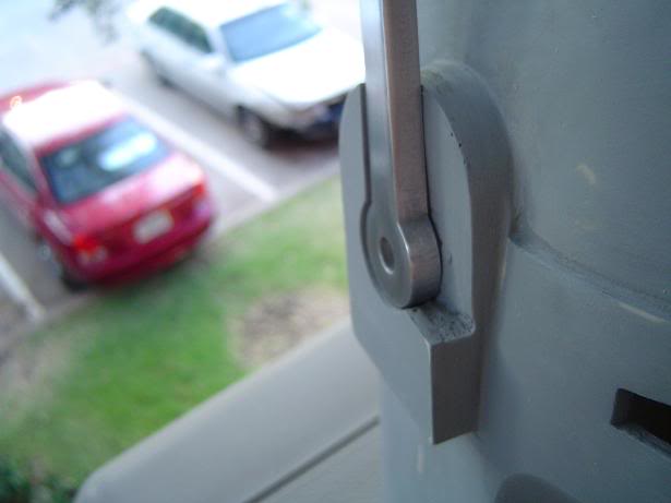

After putty, sand and primer, you can see that the spacer worked perfectly!
I was so excited, I went ahead and did a base primer, just to see what it looked like. I sanded with 320-grit sandpaper, and did a final wet-sand with 400-grit. I need to grab some shots of the rear of the helmet, because it came out great!

BN,
Did you ever reinforce the thin area by the keyholes? If so, how did you go about it? Just putty and sand? That area looks pretty scary... lol... I have no idea what I'm gonna do with it.
