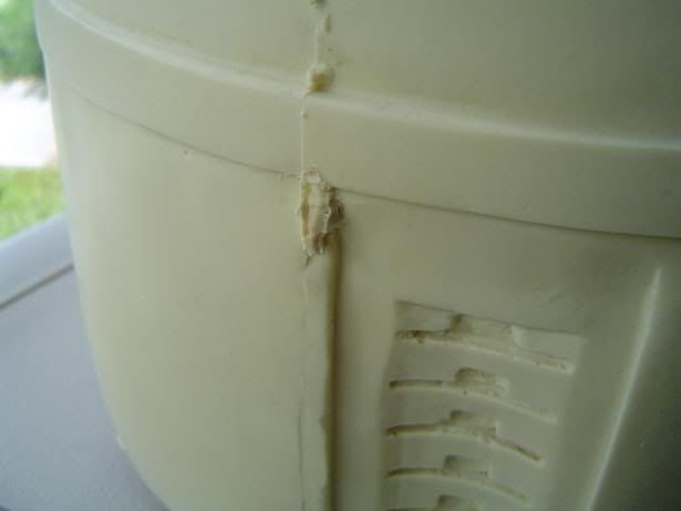

There will be some minor cleanup, but mostly more sanding than putty.

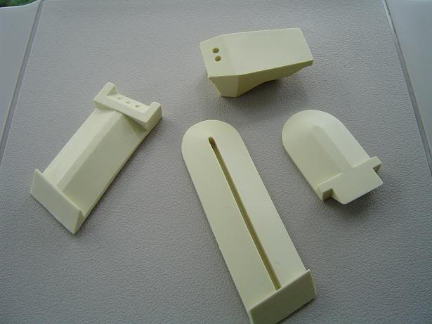

The range finder (not hollow) and ear pieces are extremely clean castings, and will require very little touchup. The right earcap is slightly longer than the post, so I'll use some styrene sheeting and blocks to build up that area.
These helmets, as opposed to some others, are not ready to wear right out of the box, and will need a little cleanup. Some hobbyists are discouraged by that. But don't fret - patience, as opposed to skill, is indeed a virtue for this project.
As for the durability, the only reinforcement I used on the first one was a horizontal brace across the mandible, about 2 inches up from the edge of the helmet. These helmets are also very light, and my headliner rig was held in place only by Velcro.
Cool review and great pics!
Could you explain the above a little more?
You're the second person (I think) who's mentioned an issue with the right ear on this bucket.
Here's a quick picture of the area.
I may use a scrap piece of styrene block to fashion an 'extension' to the earcap mount.
The other option, if you don't like the scratchbuilding idea, would be to mount the earcap higher, so that the top extends:
It may not be quite as noticeable this way.
Ah!! Got it, perfect pic. Thanks for explaining. :thumbsup:
That's a pretty minor thing to alter.

Either way, its not near as pronounced now as it was on the older version of the helmet.

No its not. Mine was about 5/16" longer than the base. I just chopped the base off and ordered a bobamaker earcap.
That's not a bad idea... :)
