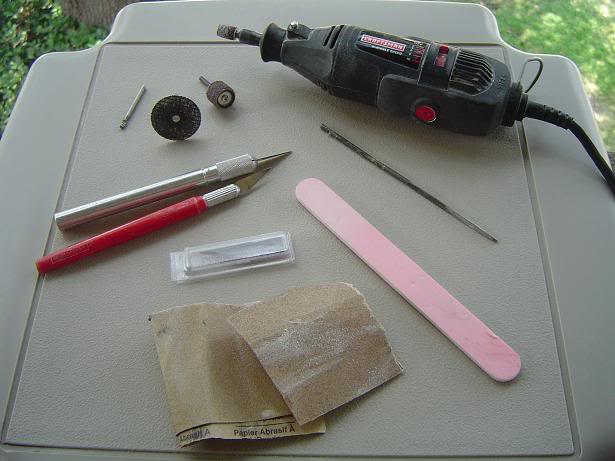

Here are the tools I'm using right now:

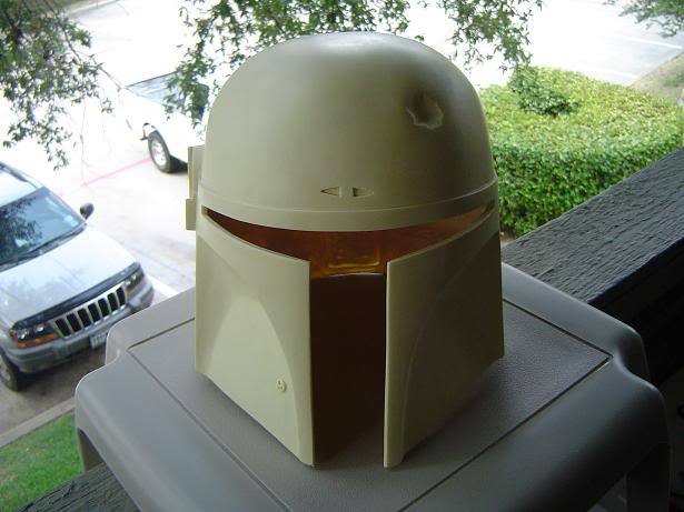

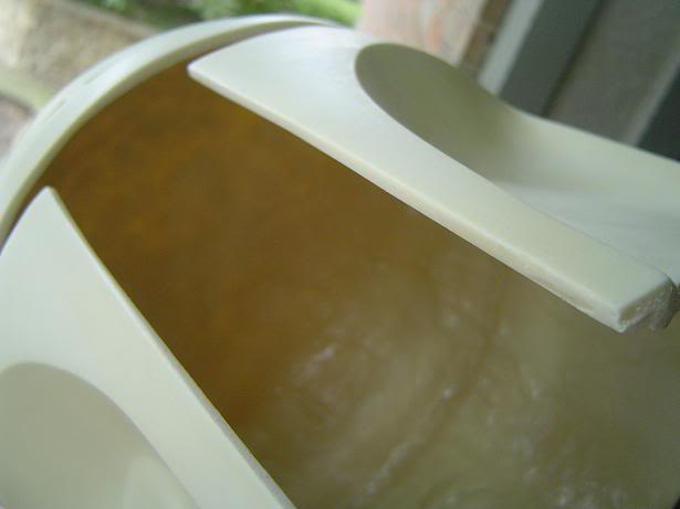

At this point, I've used a Dremel to trim the bottom edge of the helmet, and cut out the visor.
Then I used a sanding wheel and sandpaper to even out the width the entire visor opening, to achieve a uniform thickness. I will do the same thing for the bottom of the helmet edge later:
For the corners, I used an X-Axcto to carefully carve the corners, and finished it with a Emery board and a tiny triangle file:

You sure got that visor clean man!!! WOOHOO!!!

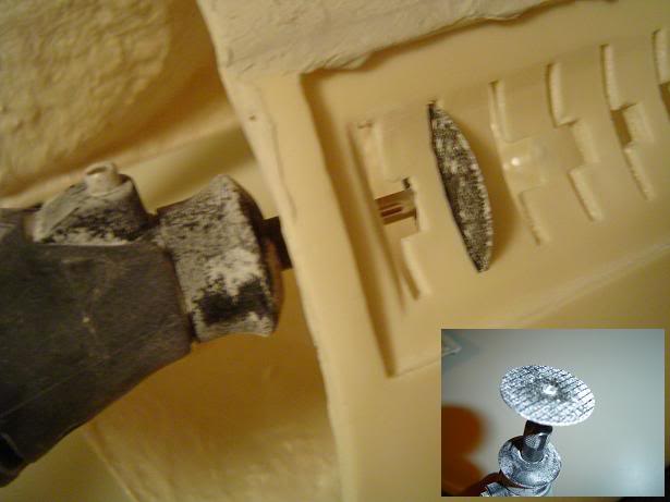

I tried something new for the keyholes. Using a large sanding wheel, I attempted to come from the inside of the keyhole out, hoping to sand away the entire hole at a time. However, I got very close to coming all the way through (see the fourth keyhole down). I'm going to use a few dabs of JB Weld to reinforce that area.
So I opted to use the cutting wheel to slice horizontally through the long part of the keyhole, and was able to clear away the majority of the hole. Then I used a small cutter-head, and cleared the top part of the hole. Afterwards, I used the X-Acto knife to trim the corners.

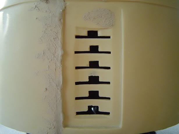

I've done some light sanding, but will work on it some more tomorrow. But for now, here are the keyholes:
http://img.photobucket.com/albums/v715/batninja/Mystery Helmet/progress_4.jpg
I've also added some putty to the split-line, and will try to finish this up tomorrow afternoon.

How do you get your lines cut so straight? I do it freehand, and slow, but if there's a way to cut straighter please let me know.
Thanks!
:thumbsup:
Using the fiberglass-reinforced cutting disc on a Dremel, I sliced through the backside of the keyholes, and carefully moved it up and down to 'sand' the area out. Afterwards, I used the X-Acto knife (with a NEW blade) to carefully shape the corner areas. This will take some time, so be patient and go slowly.
Let me know if that makes sense...

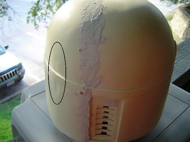

Is this area I've marked some kind of 'depression' in the surface? I'm wondering if it's something to be filled in, or if the angle of the lighting is making it look weird.
There is a slight depression there, same with my last one. But it's hardly noticeable once it's painted. I don't think I'm going to fill it in. That'd be like 'correcting' the wavy brow on an ESB bucket. :)
Good deal. Thanks for the info.
