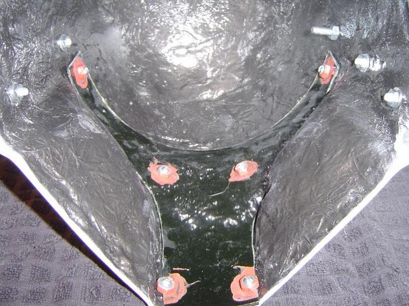

So today, following Spidey's suggestion, I coated the inside of the helmet with Rust-Oleum 'Hammered' spray paint. It gives the interior a clean, fresh-off-the-assembly-line look. I used black as my color choice, but in hindsight, I should have gone with a more 'metallic' color like silver or aluminum. I'll save that for my next helmet...

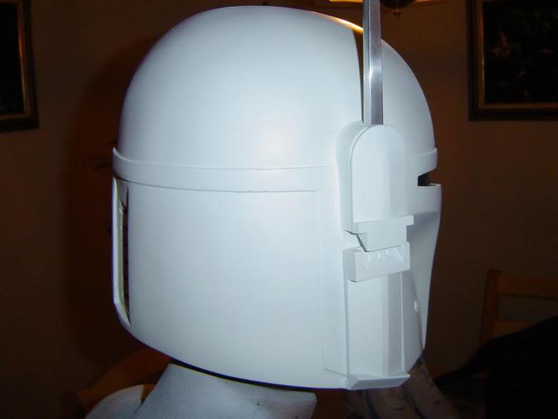

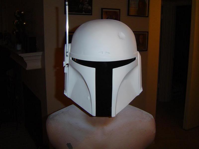

And finally, I applied several coats of Krylon white primer to the exterior and earcaps. It was at this point I learned an important lesson: to avoid overspray, mask off any openings (visor, keyholes, earcap mount holes) before applying the primer. I had to touch up the inside before continuing.
In between primer coats, I examined the entire surface of the helmet with my hand and good lighting, looking for any lint/hairs/imperfections that I could sand off.
The results speak for themselves:
The visor shown in these pics is not the final visor, as the heatgun episode caused me to have to make some adjustments to the alignment of the mounting posts. Once I had the visor and posts installed exactly where I wanted them, I dabbed a spot of paint around the existing hex-nuts. This way, I can verify the exact center of the holes I'll need to drill into the final visor. I hope that all made sense.
