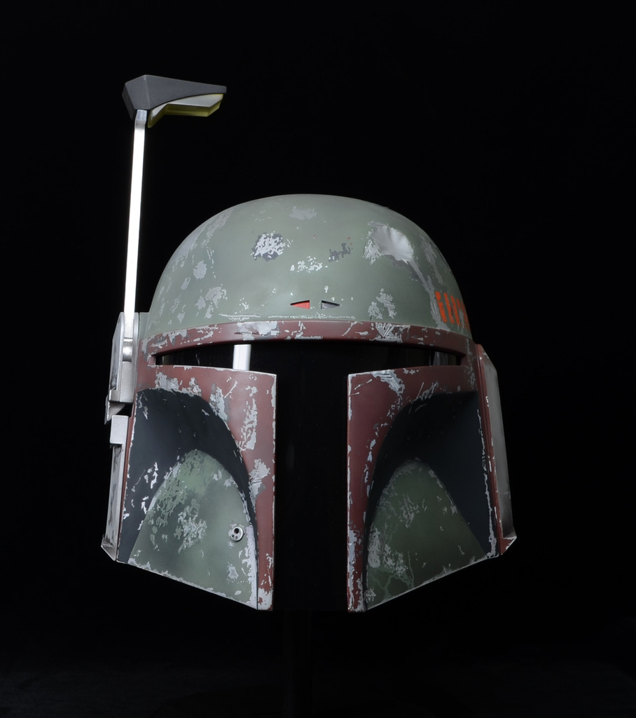

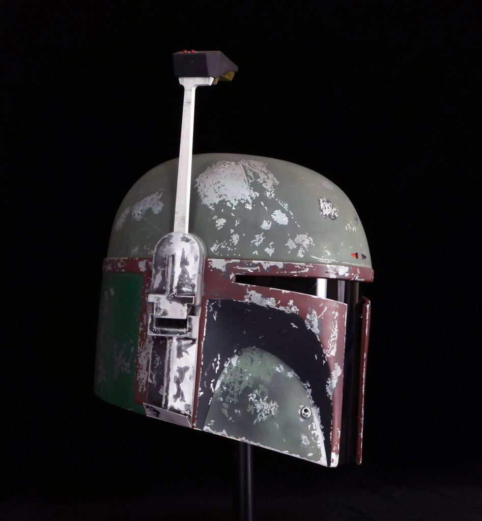

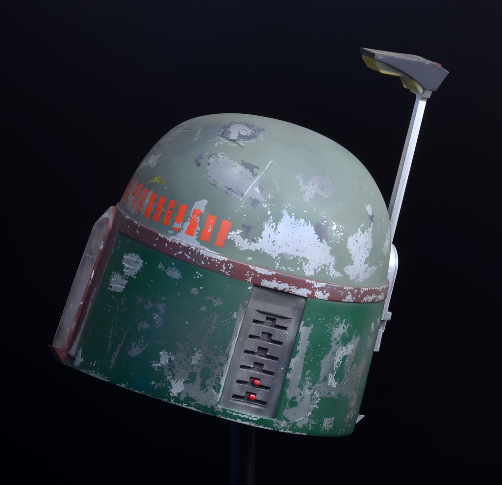

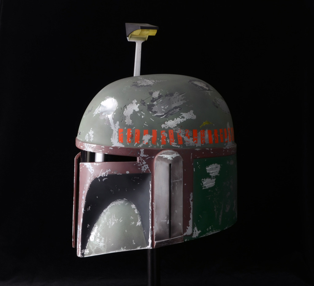

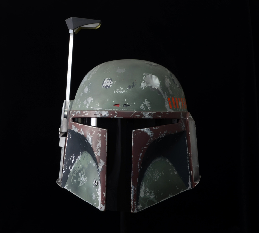

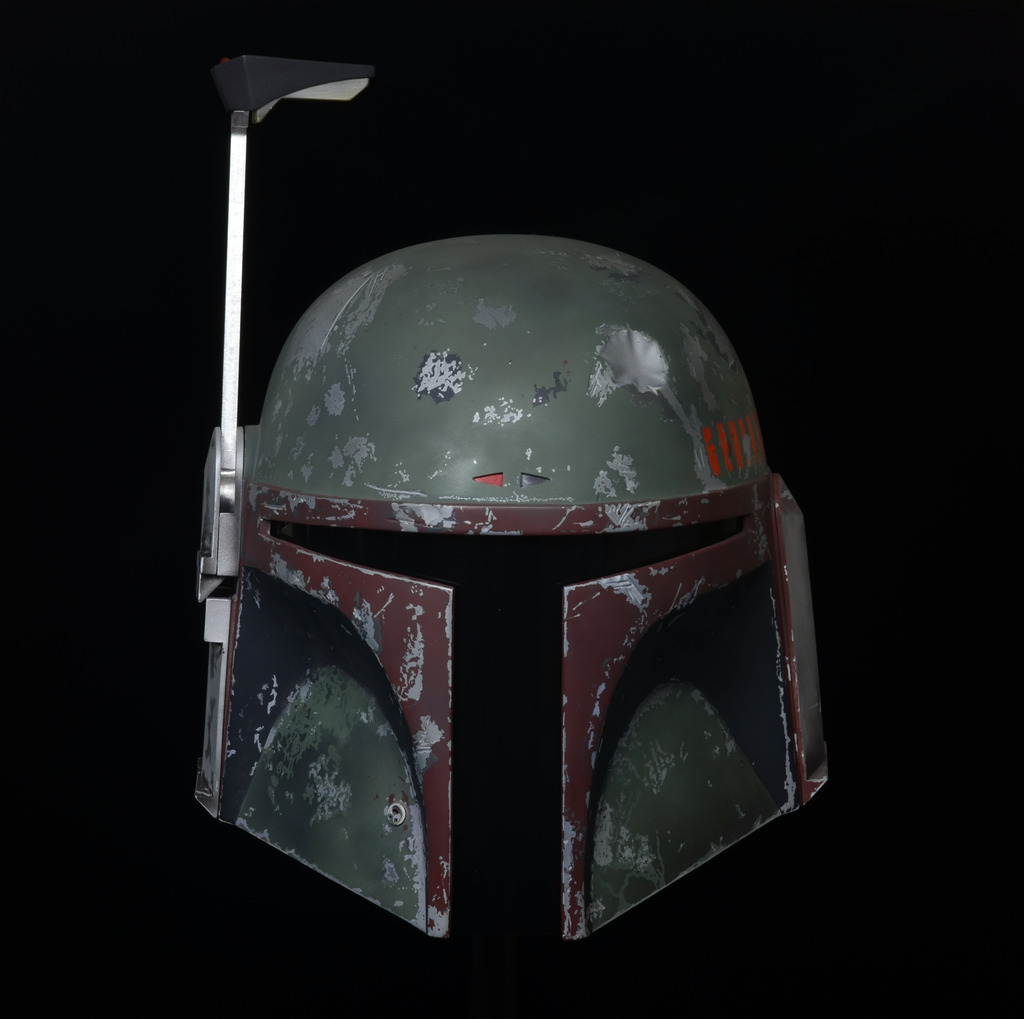

I've reached the 80% mark, give or take, and I decided to take some time to do a little impromptu shoot. Feedback, good or bad, is appreciated, as always. I'm sooooo jealous of AFFO$, he seems to be able to effortlessly churn out champion paintups!
Much more to do, and I'll tell ya, the rangefinder ear is a total PITA (c'mon, Dakota, get those metal ears going), but I'm pleased overall.
Let me know how I'm doing....

Lookin very good. All my research and color matching points to caboose as well. I just picked up 2 more bottles of it last week. Tested against the remnants of my old bottle, there was some brown mixed in with my last caboose bottle producing a rustier look than there should have been. Your paintup looks great.

Awesome work Man! Using Jayvees and your paintup as my guidance. The applied damage based upon the stencils has been the most difficult part with a dremel. A true work of art on your end, and something you should be proud of!

That is FREAKING AWESOME!!! Looks like it's straight out of the Lucasfilm Archives! Spot On with those ROTJ colors!!!

That is a thing of beauty Rubio!
question about masking technique: did you mask and peel between each paint layer, or did you peel at the end of each section (just keep adding to the masking on the layer underneath)...?

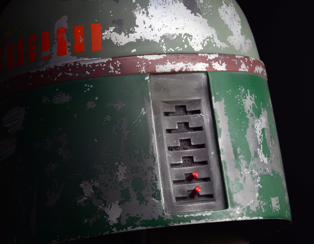

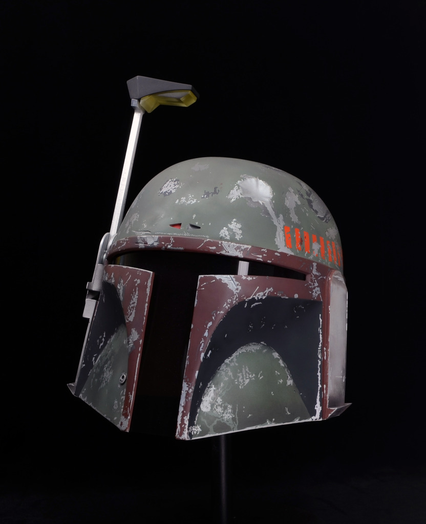

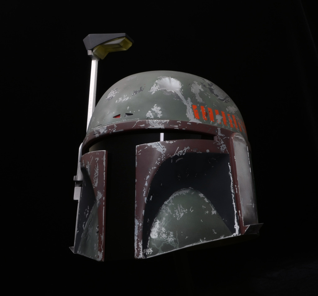

Slowly filling in the little details. Got the oversprayed green and Caboose on the right lower cheek. And painted up and installed Fettpride's dental files. SUCH a sweet addition to the kit!
