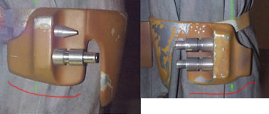

I'm currently scratch building a pair of ROTJ knees and have hit a small stumbling block.
Using the WoF templates as a guide and referencing this image...
Does this hold true for ROTJ too or is it one of the other various flavours of Fett?
What I'm interested in is making sure I understand that...
Left and right knees have a different back profile (red line) - the right knee has a smooth curve all the way to the back, the left knee has a little indent/bump as it follows the curve
Trying to look specifically at ROTJ reference images in the gallery - this looks like the left knee hasn't got the little indent/bump
Which is correct for ROTJ Boba -
two identically smooth curves
or a smooth curve on the right knee, an indent/bump on the left?
Many thanks!
Thank you! That's really appreciated - been trying to get confirmation. Was at a Mercs troop last weekend scrutinising my buddy's ESB Fett knees and getting weird looks, and I know that the suit at the Identities Exhibition in London was made up of parts from different costumes, so getting a definite answer on what constitutes the ROTJ is so helpful.
