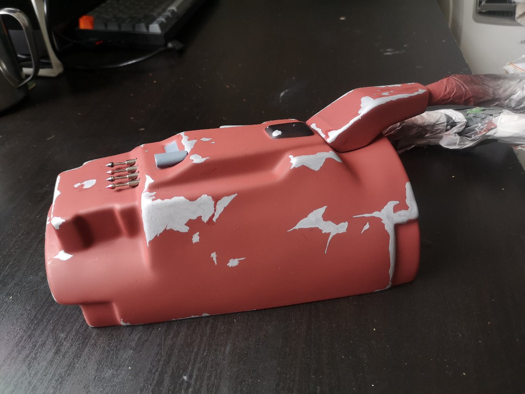

Just wanted to report back. I didn't use the Wine Red since it ended up ruining one of my cheap paint brushes when I was testing it for the color since I'm not used to whatever base Mr. Color is (urethane?). However, I did an air brush coat of Rock Island Maroon (no thinning needed paints great!) over my water based Walmart Matte Barn Red acrylic and then with Vallejo flow improver and Vallejo model air black did some really light black air brushing on top. It looks great and matches as close as I think is possible to BobaMaker's colors.
Just wanted to say thanks again tennantlim for posting this information on your build thread! I was able to save my gauntlet since I had some of the paint fully stripped on certain sections so I wasn't sure if I was going to have to strip everything and start fresh. Luckily, it isn't the case!

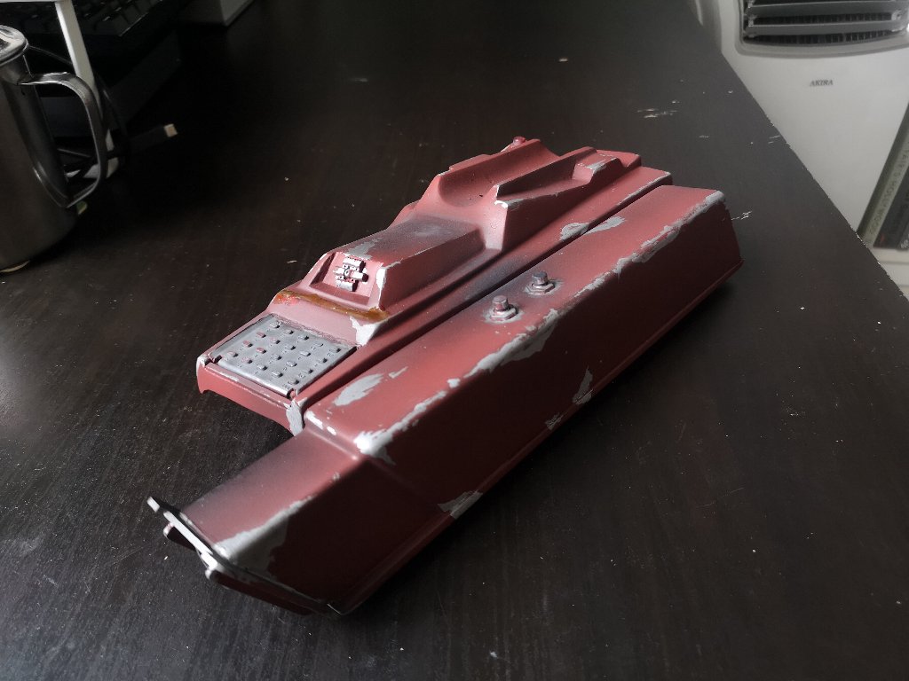

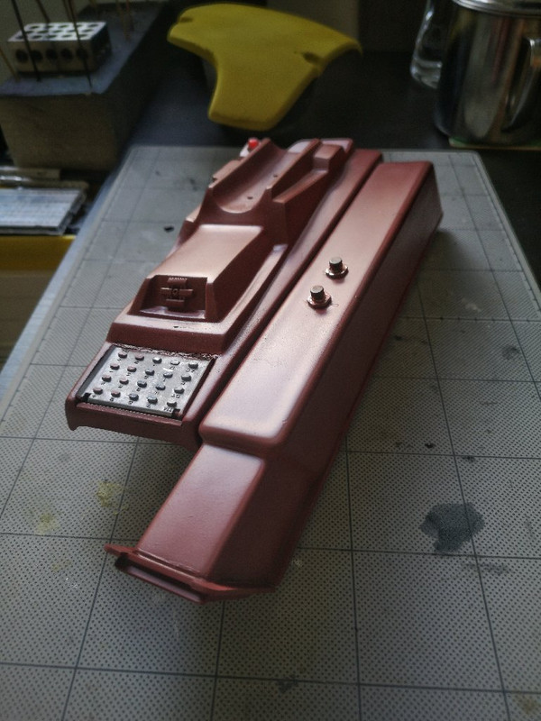

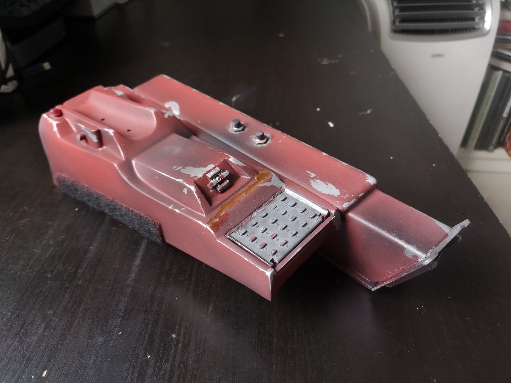

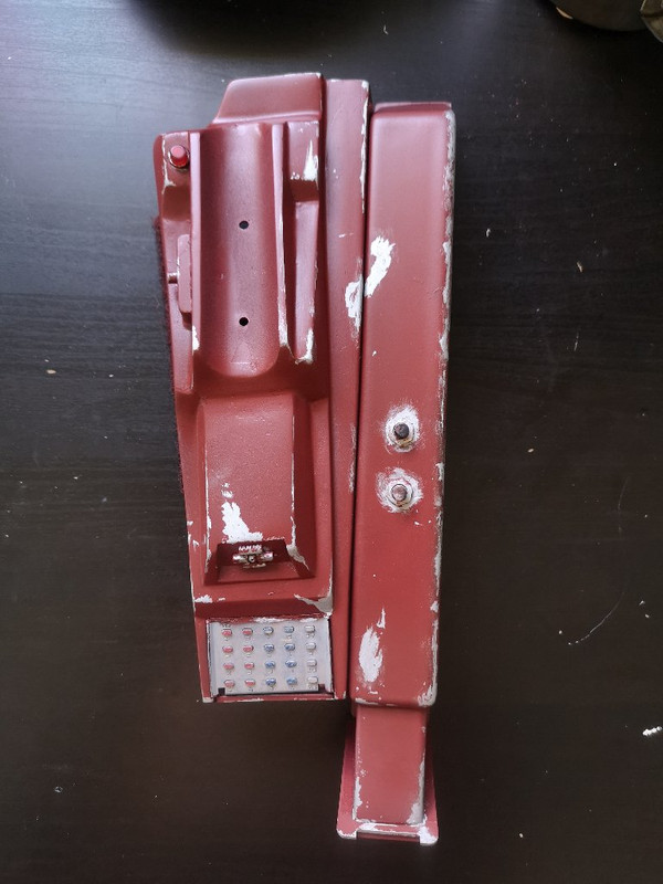

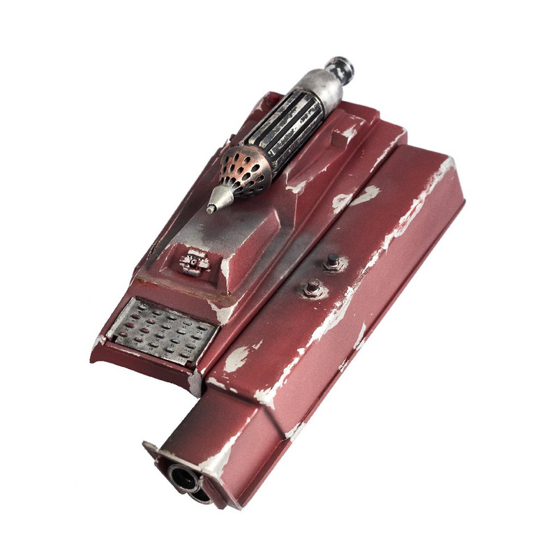

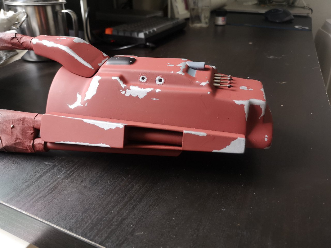

Long story short, I corrected my left gauntlet with the Hero weathering and a few details.

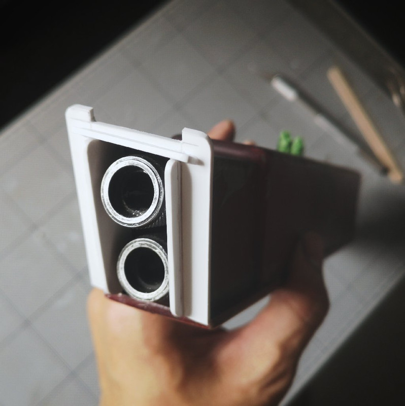

First, I fabricated the flamethrower lip with styrene. The upper bar was later removed as there is no evidence to suggest it was there.

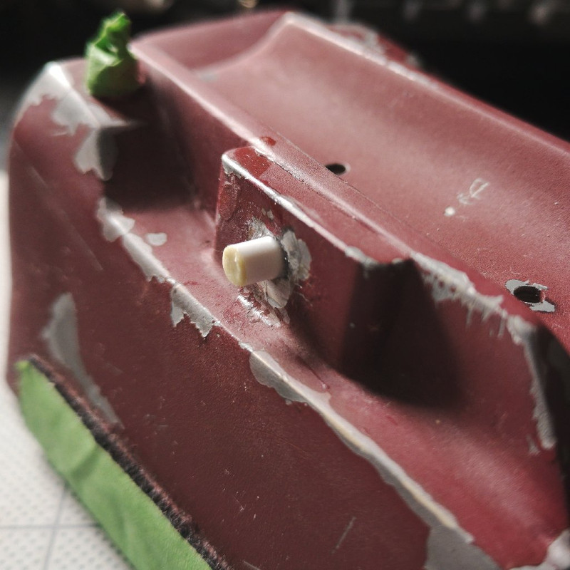

The switch on the battery cover was changed to the correct cylindrical form as seen on appropriate reference photos.

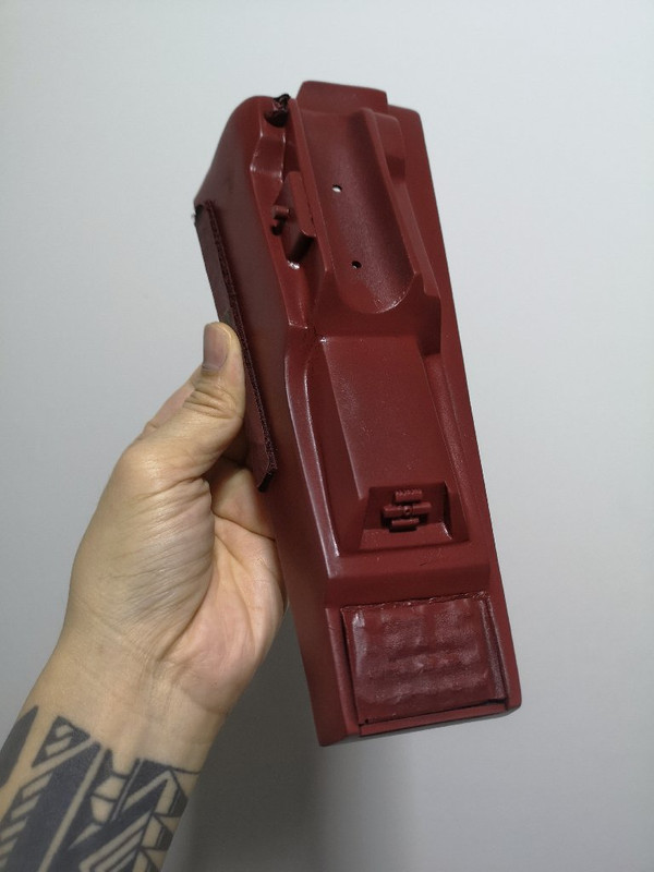

I decided to paint the silver weathering topically, so I painted Rock Island Maroon over a black primer base.

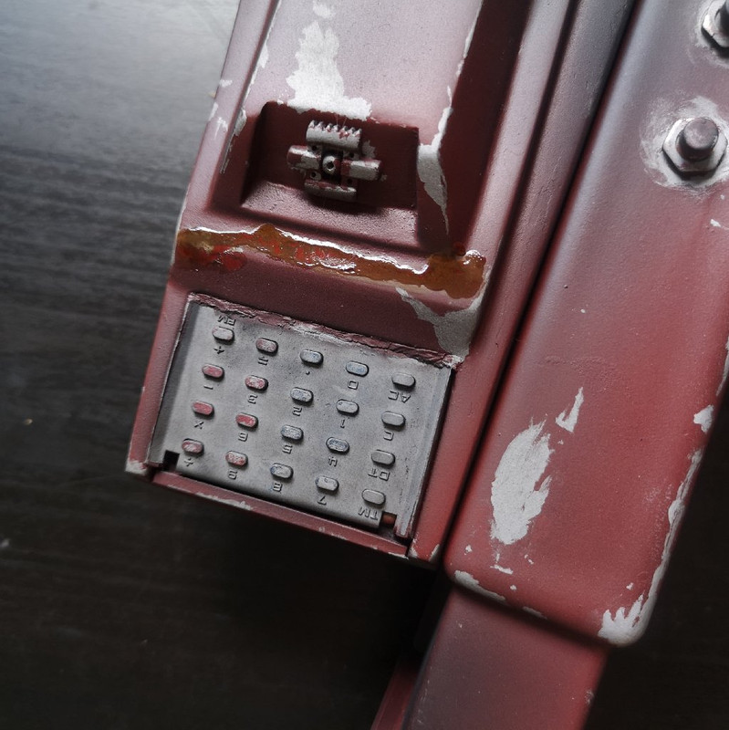

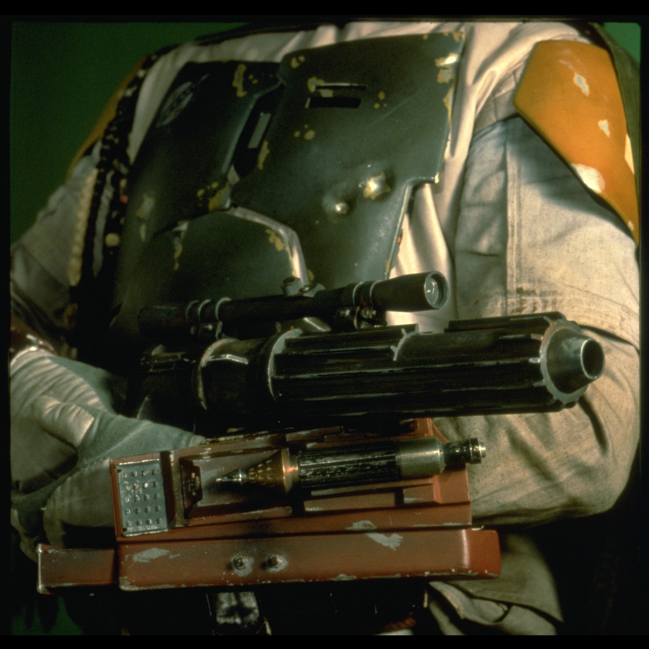

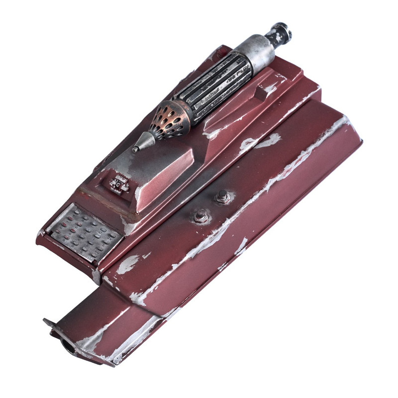

The Hero weathering is most identifiable by the flame-like silver marking on the flamethrower beside the keypad.
I cleaned up the brush strokes, misted over with black and grey, and added the glue stain just under the dental expander.
References and evidence for the glue stain can be found in several photos in the gallery like this one...
Final photos with additional finishing touches.
