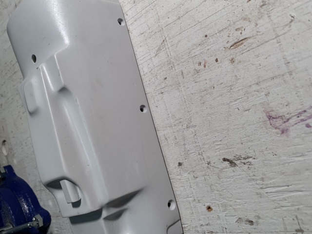

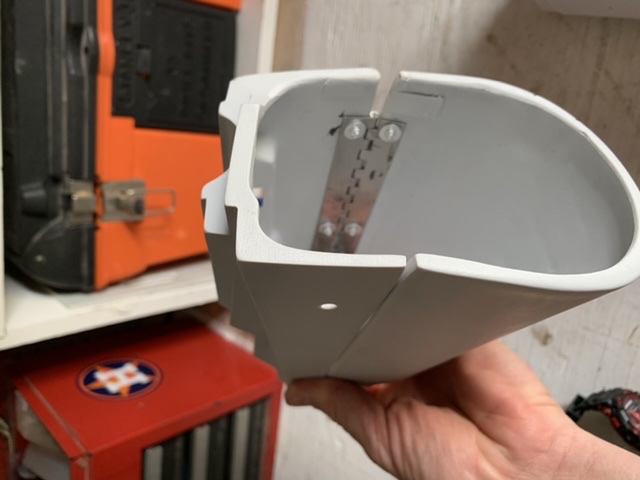

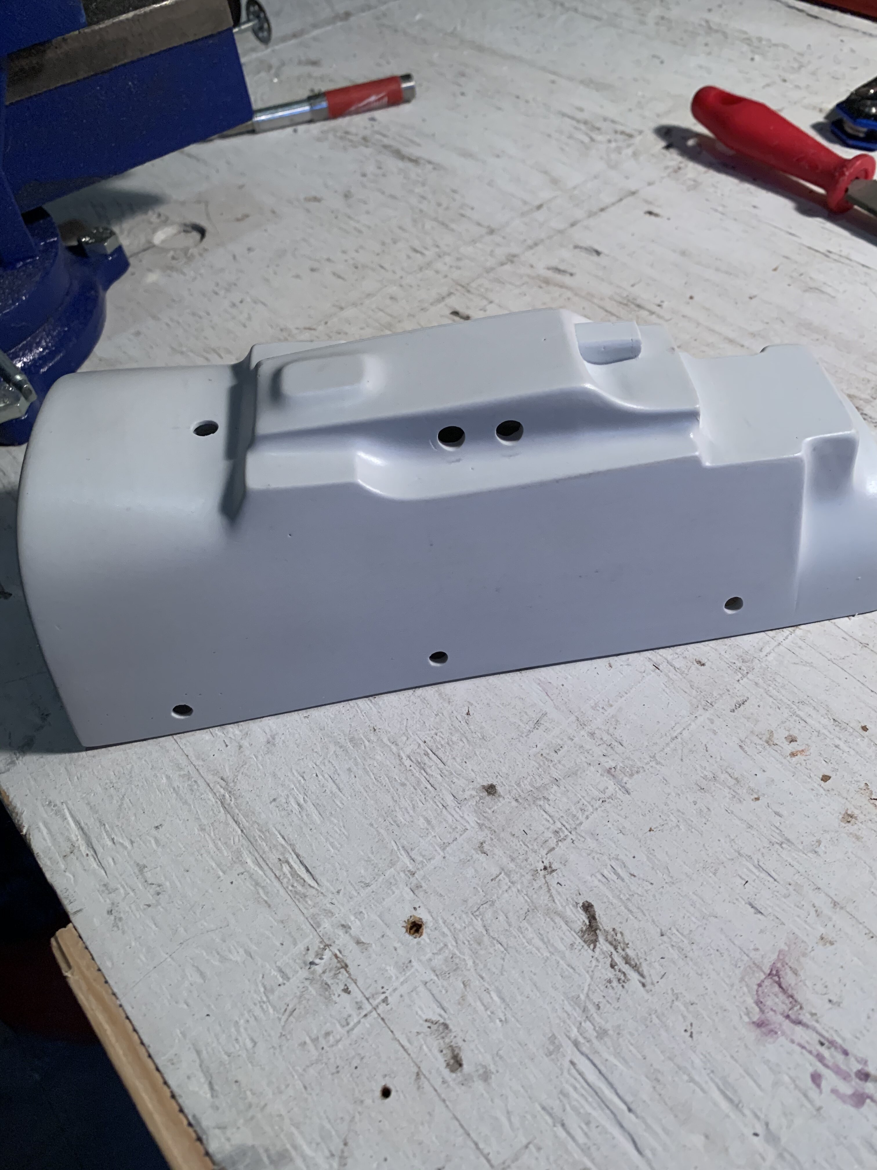

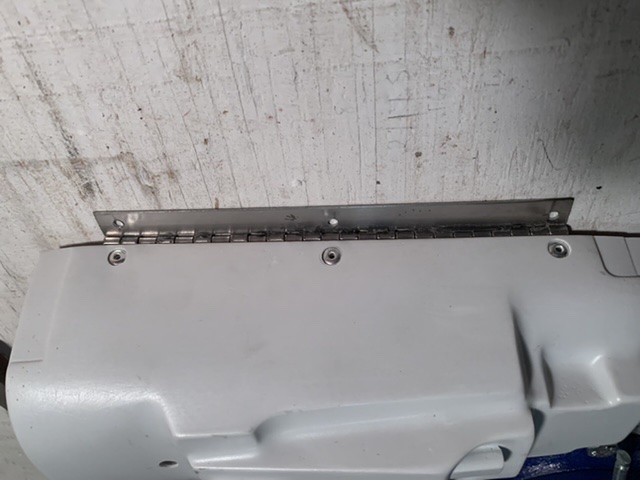

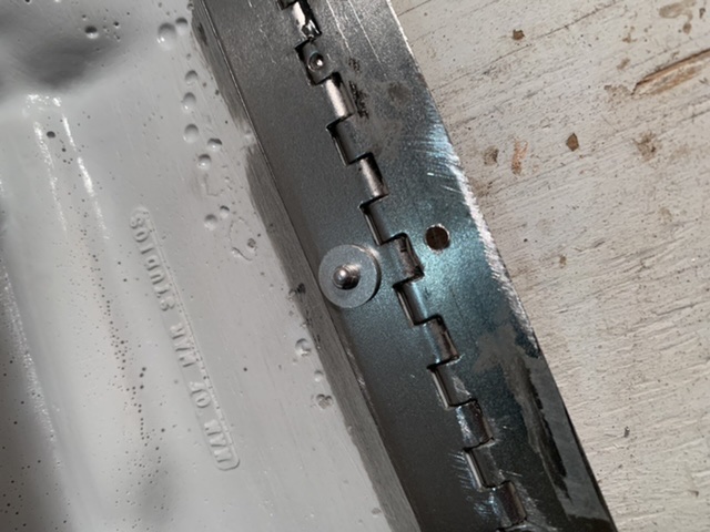

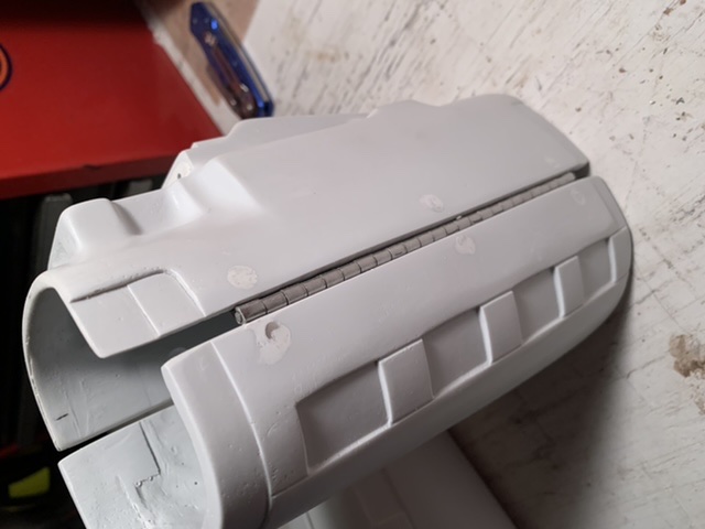

Ok. I’ll do my best. I’ll include some pics where I can that I took during my build. Before anything, you need to give all the pieces a wash with soap and water the remove any release residue as well as a general sanding of all parts. (There will be more sanding down the road).
You need to remove all the extra resin from the pour locations. I used my Dremel for this. The resin cuts very easy. Just be careful not to cut pieces off that you don’t want to.
If you plan on using the hinges, you need to decide if you want them on the inside or the outside. On my last set of gauntlets, I put them on the outside. For my MOW gauntlets, I put them on the inside. There are pros and cons to either. Note: If you are going for 501st approval, is is required for Level 2 that if hinges are used that they are not visible.
Anyway on to hinge attachment: First I drilled holes in the side I was attaching the hinges to. I countersunk the holes for the rivets so I could fill the holes with Bondo and sand it smooth.
That should get you started. Next I will show you what I used the attachment for the other side instead of those crappy clips that were included in the kit. Hope this helps.
View attachment 189196 View attachment 189197 View attachment 189198 View attachment 189199 View attachment 189200 View attachment 189201 View attachment 189202
Hey man, thanks a lot! I appreciate the help thus far, the breakdown and process so far seems fairly straight forward. I’m not going for 501st approval, I just want to make a nice looking set to wear for cons. I actually started this build As a Halloween costume and more so for fun! If I chose to go the non-hinge route, what would be the best alternative? Thanks again!

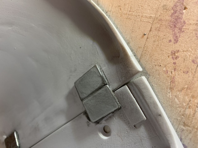

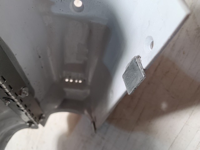

Here is what I used on the other side of the gauntlets to keep them shut.
Neodymium magnets epoxied to the ends. Found these at Hobby Lobby. Plenty strong to keep them closed.
ShortFuse
Mine didn’t quite line up prior to installing the magnets.
So I used a heat gun to apply gentle heat until it was pliable enough to straighten and hold until it cooled.
View attachment 189208 View attachment 189209
Magnets is something I haven’t seen yet, pretty neat!
