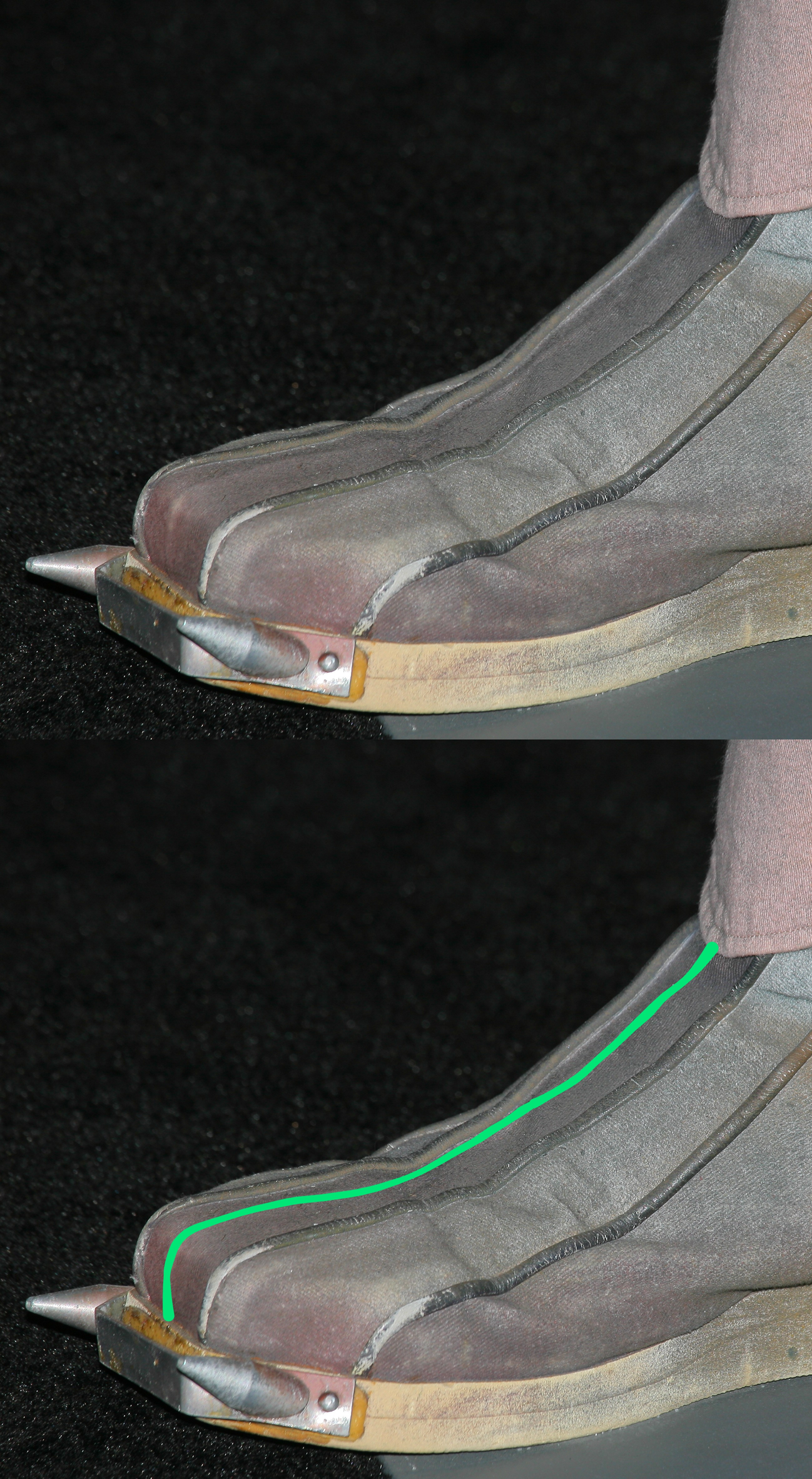

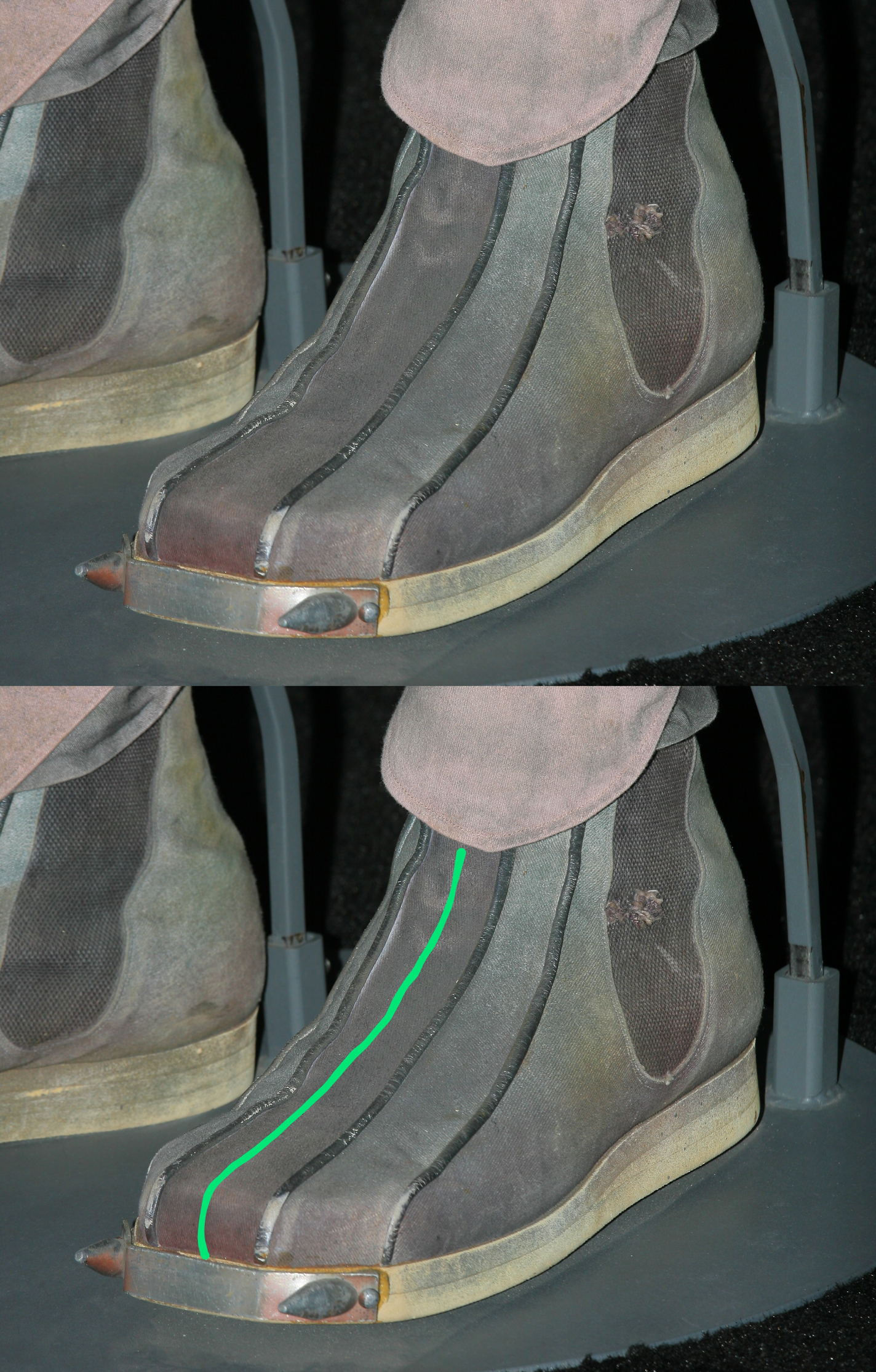

4. I noticed after looking at some pictures of the boots that there appears to be a seam running down the middle, covered by an extra piece of fabric. I highlighted where I think this seam is in green:
Does anyone have an explanation for this, or was I right in saying it's a seam covered by a strip of fabric?
I've never seen construction photos of the boots but there are some things that can be inferred based on what we do know:
- The ESB boots, like the rest of the costume, started out as all white and were painted or dyed to the gray/black scheme used on screen. In the photos you posted you can see chipping on the piping details near the toes, and in the first image there's a sliver of white visible along the edge of the piping on the wearer's right
- Because of the way it's constructed and installed, piping, whether vinyl or leather, typically includes an attached "bias strip" (flap of fabric).
- In the high-resolution images it's clear that the fabric of the front "stripes" was attached as appliques over the base boot (the fabric "grain" changes with each layer).
- Taking the previous two facts in consideration, the seam you've noted is most likely the point where the fabric of the left and right stripes meet (covered by the center stripe).
I'm sure someone has tried this before so you may be able to find a Fett-specific example or two (Fett-feet-specific? ). But if not two similar cases I know of are Din Djarin's boots (leather appliques over off-the-shelf Skechers - Crowprops sells the covers) and bespoke Clone Trooper (movie) boots.

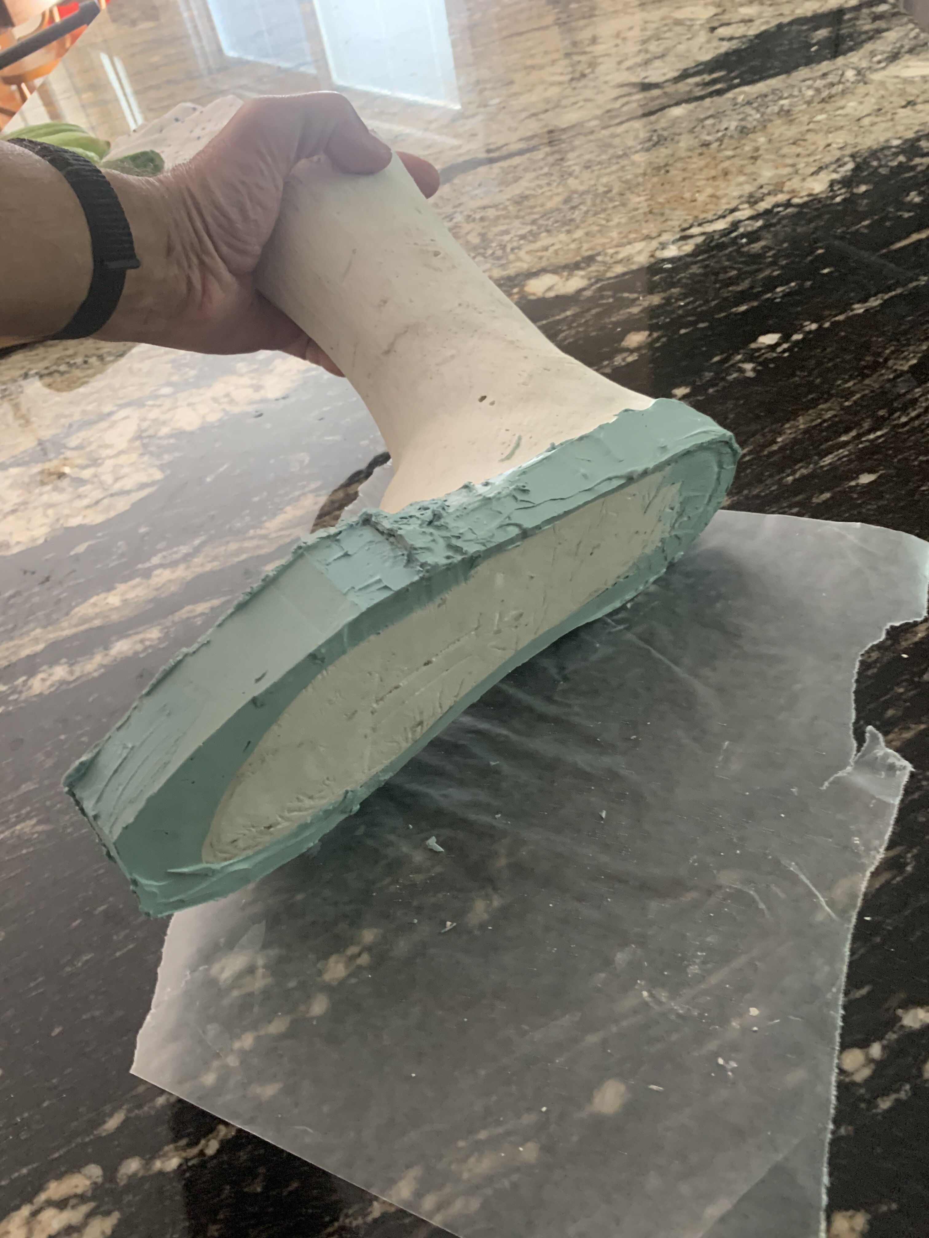

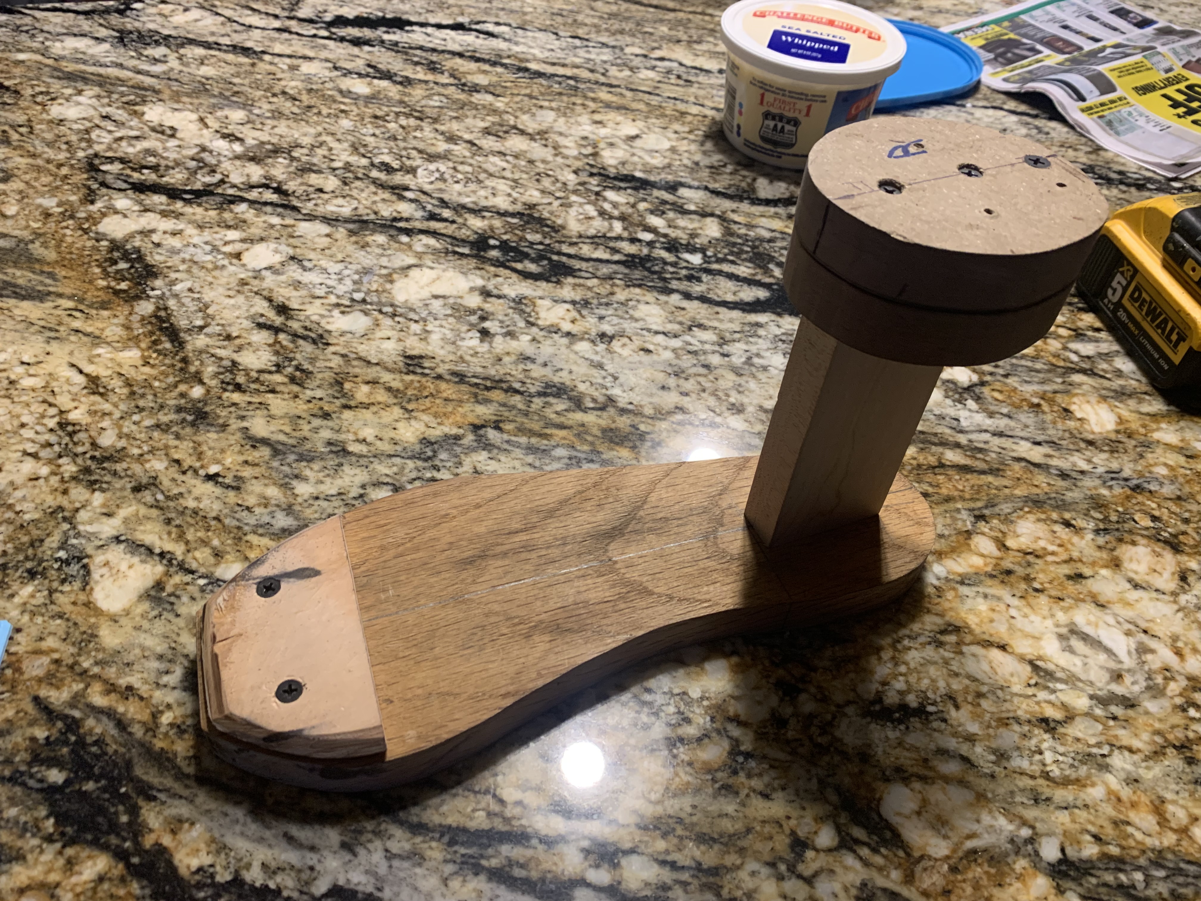

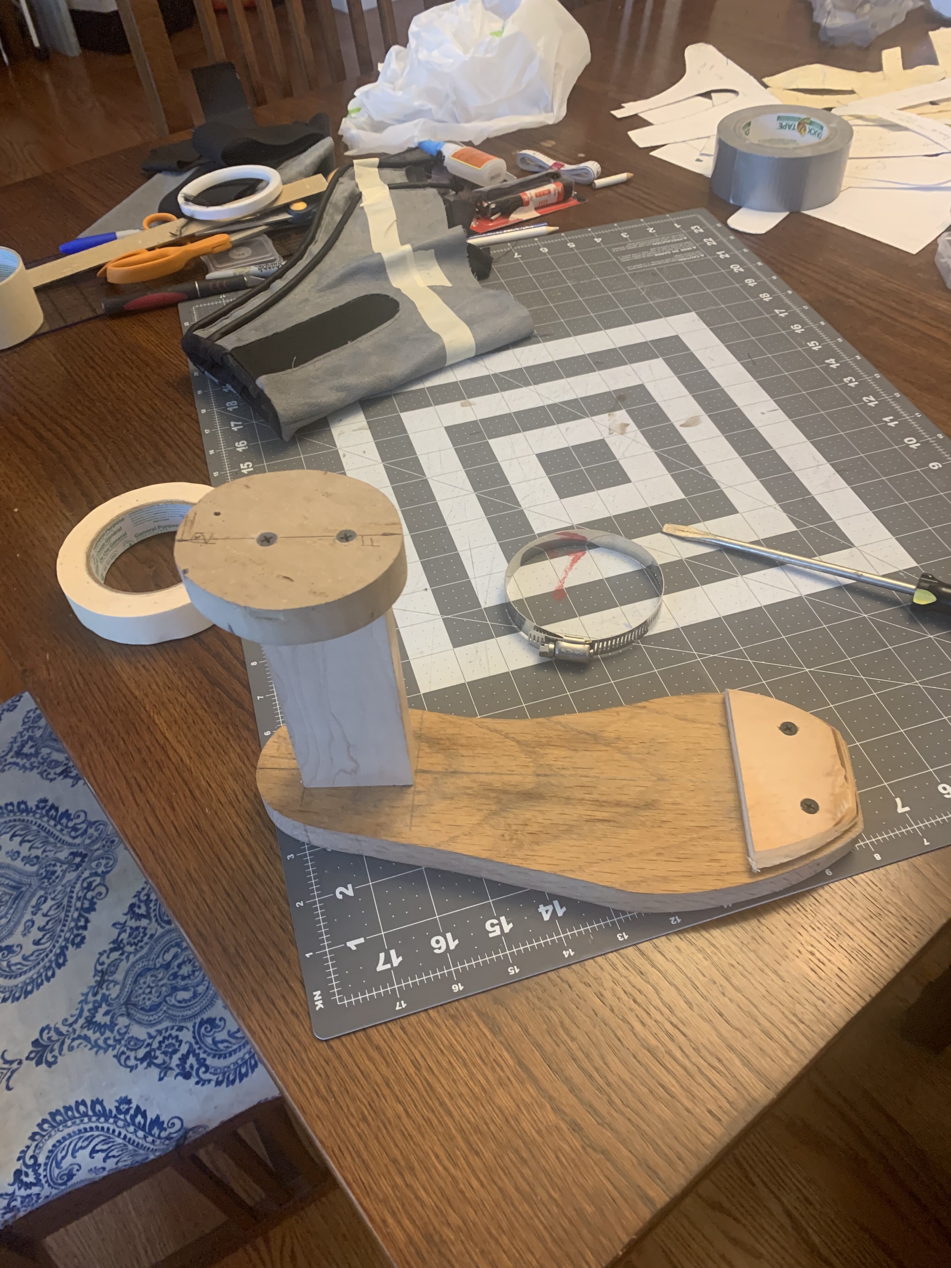

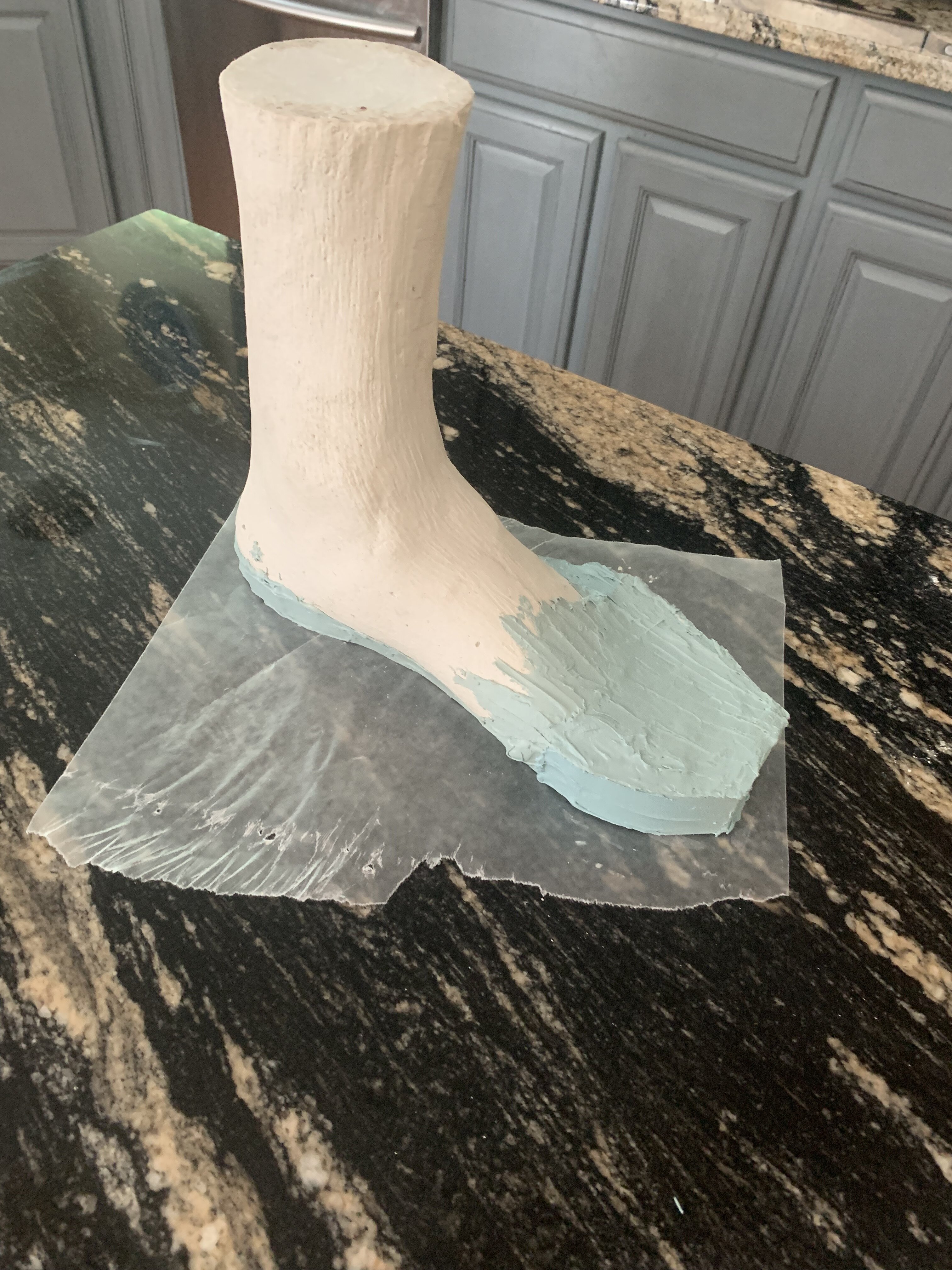

I've made a pair of shoes from scratch. I can answer question #3 above. To make them, you will need to make a plaster cast of your feet (or at least one of your feet) and use it to make a shoe form (LAST) (I made mine out of wood and reversible for left and right feet. I can share some pics if you want.

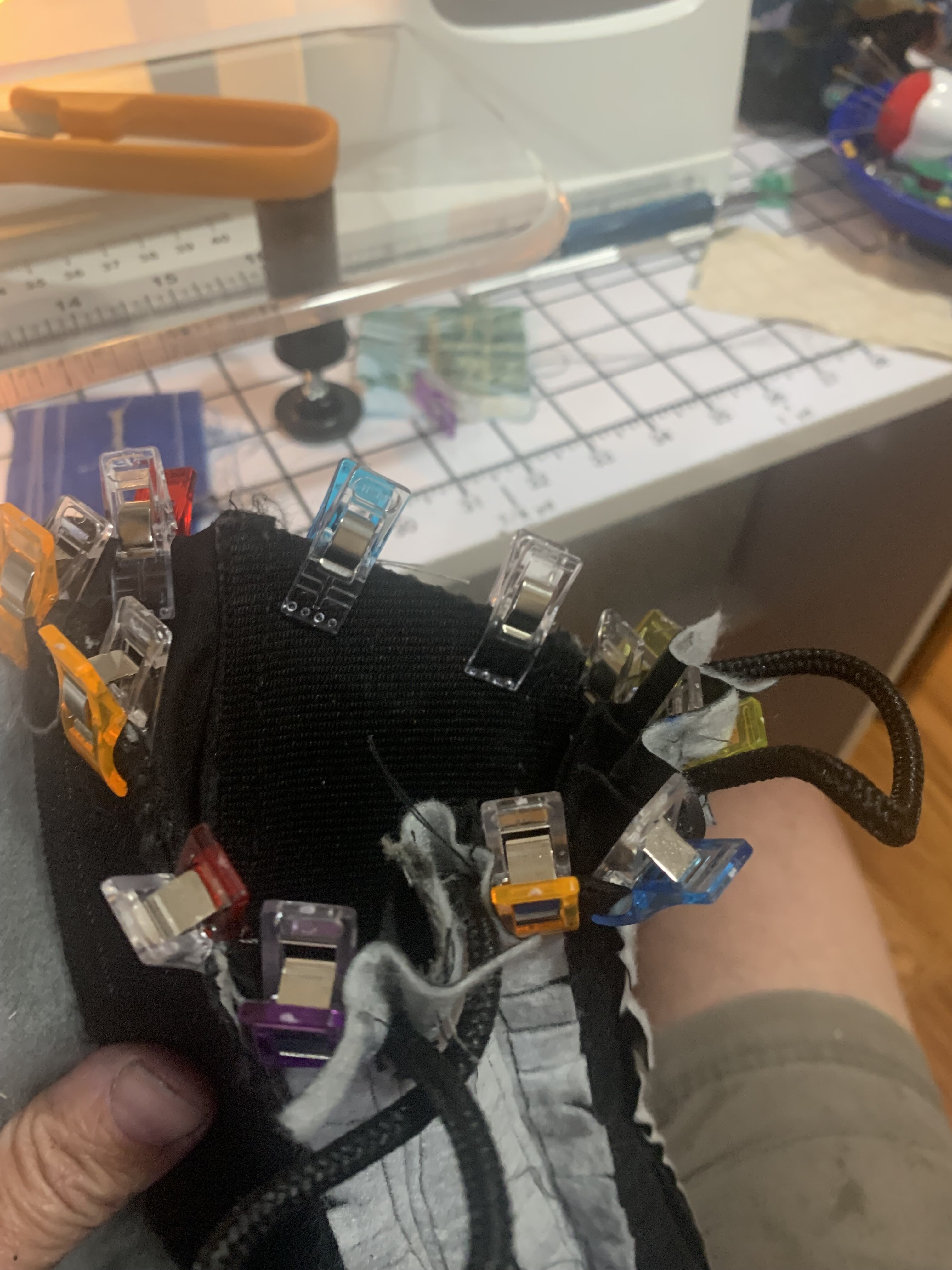

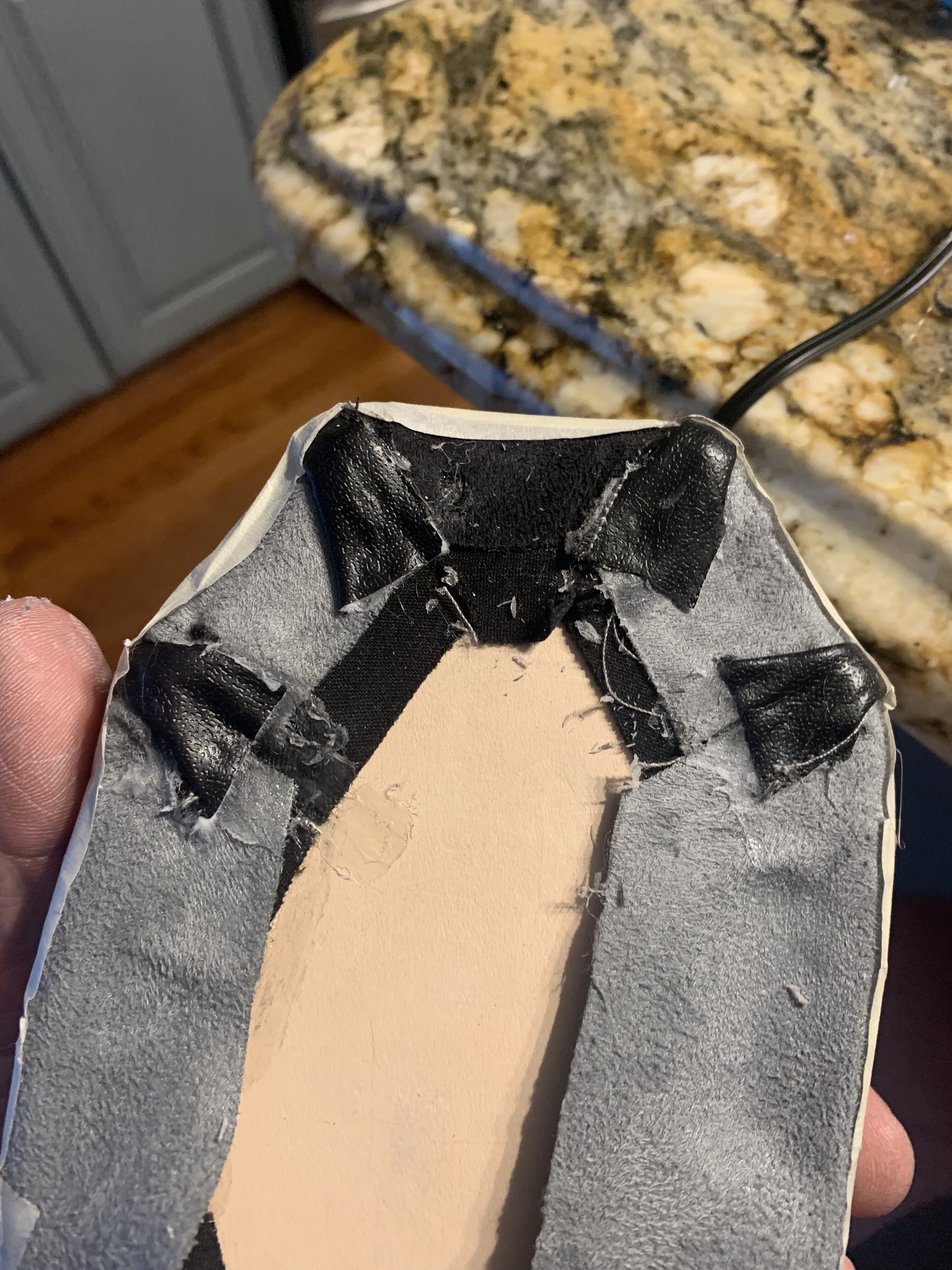

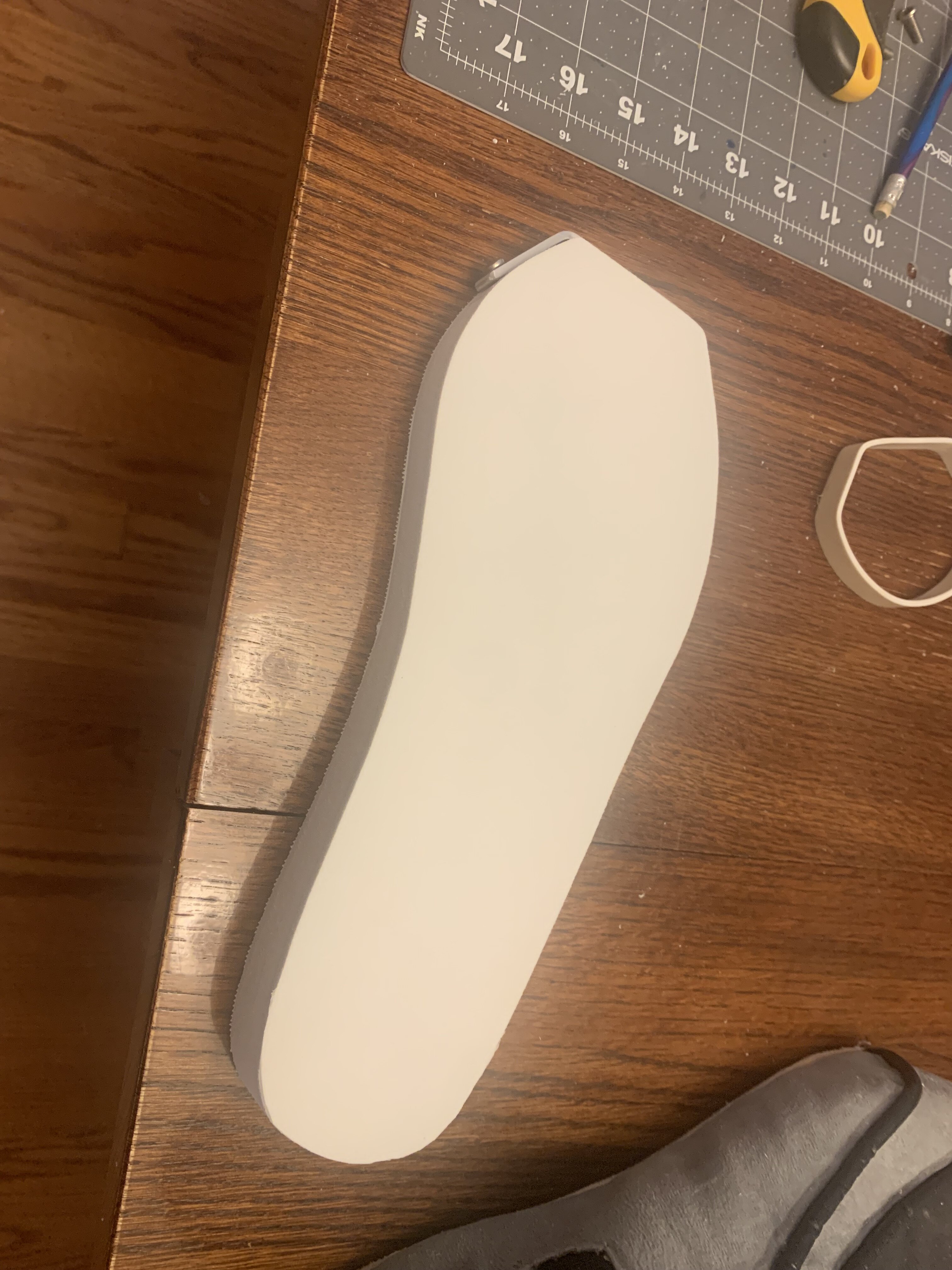

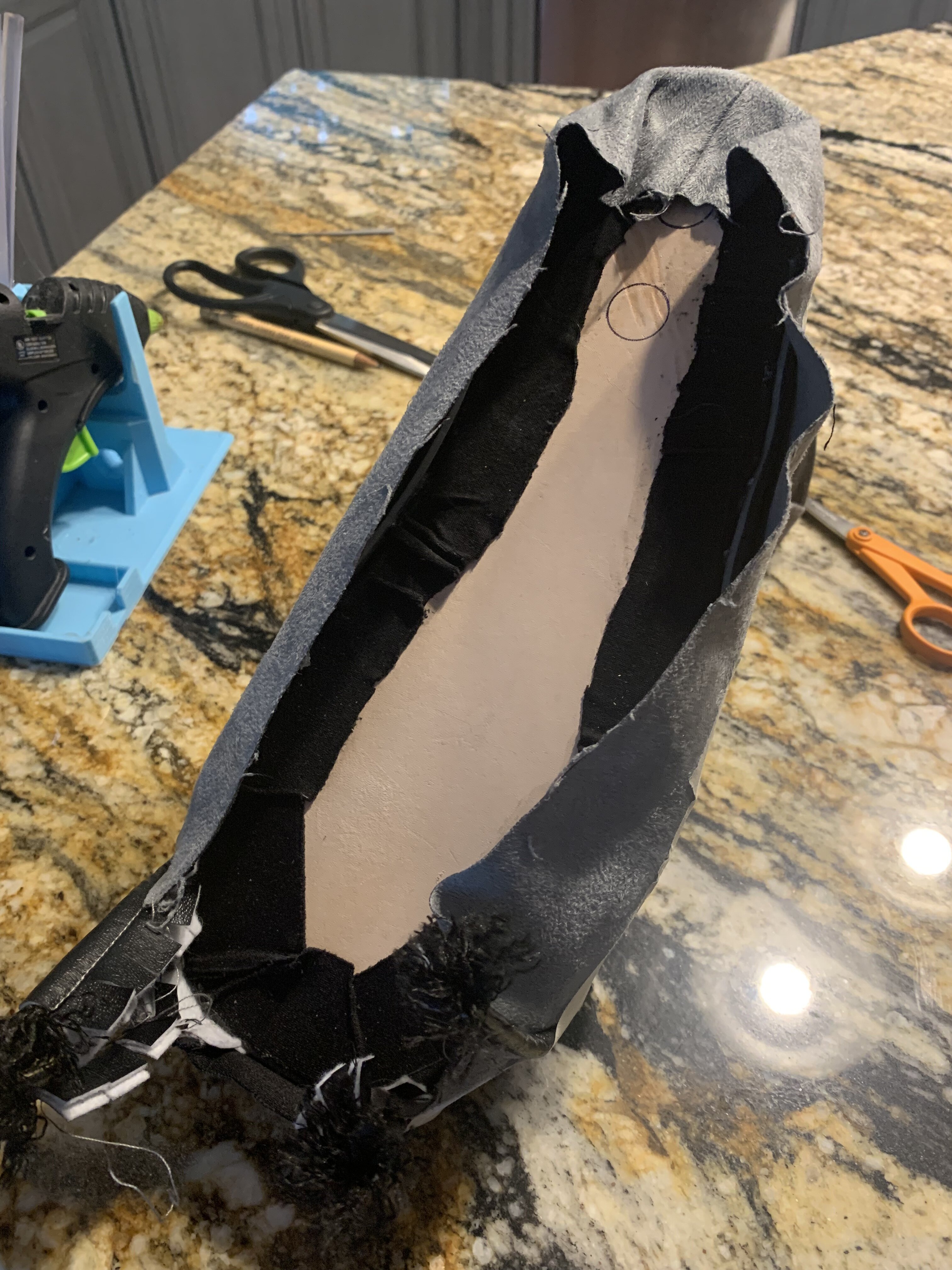

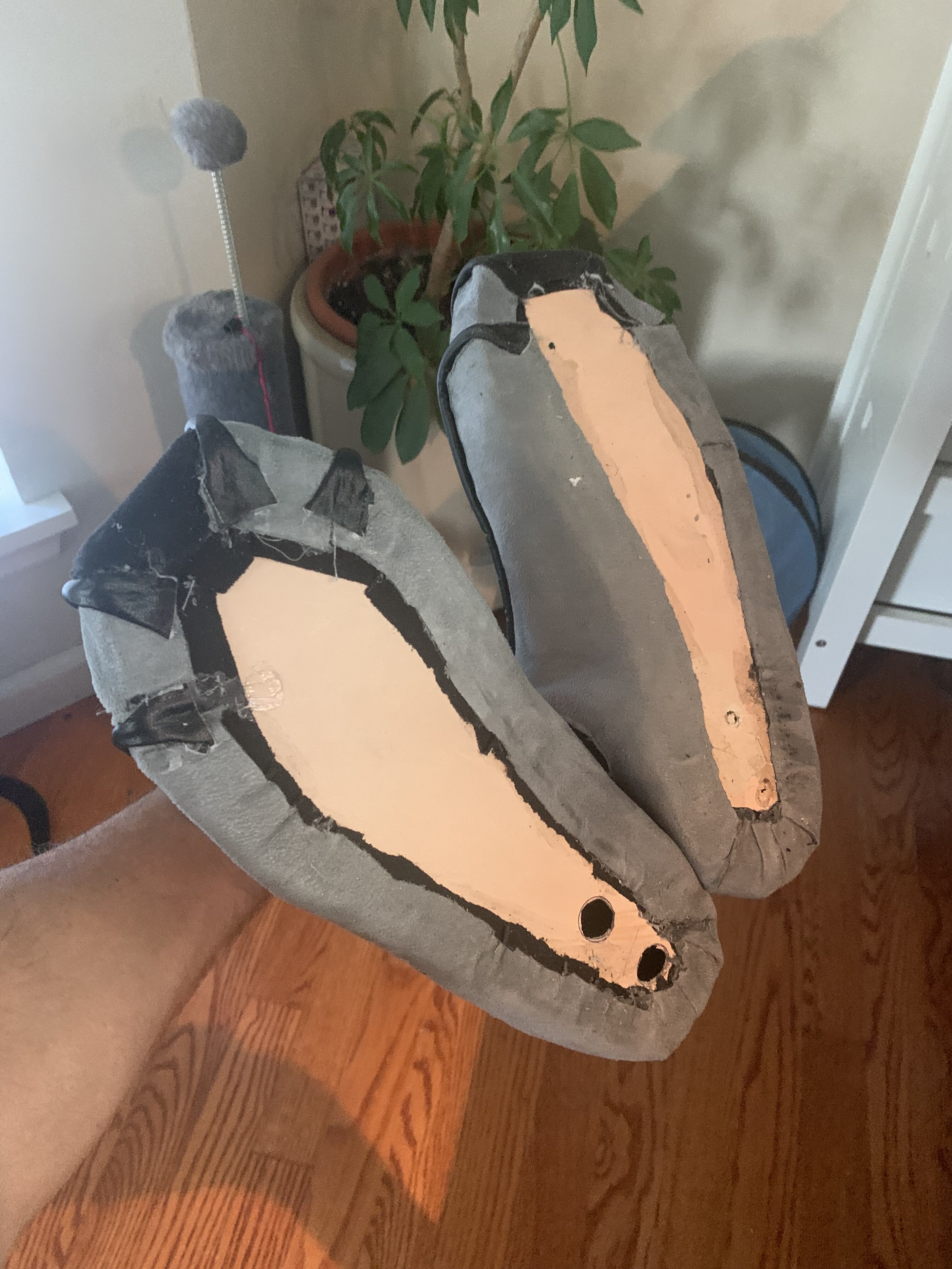

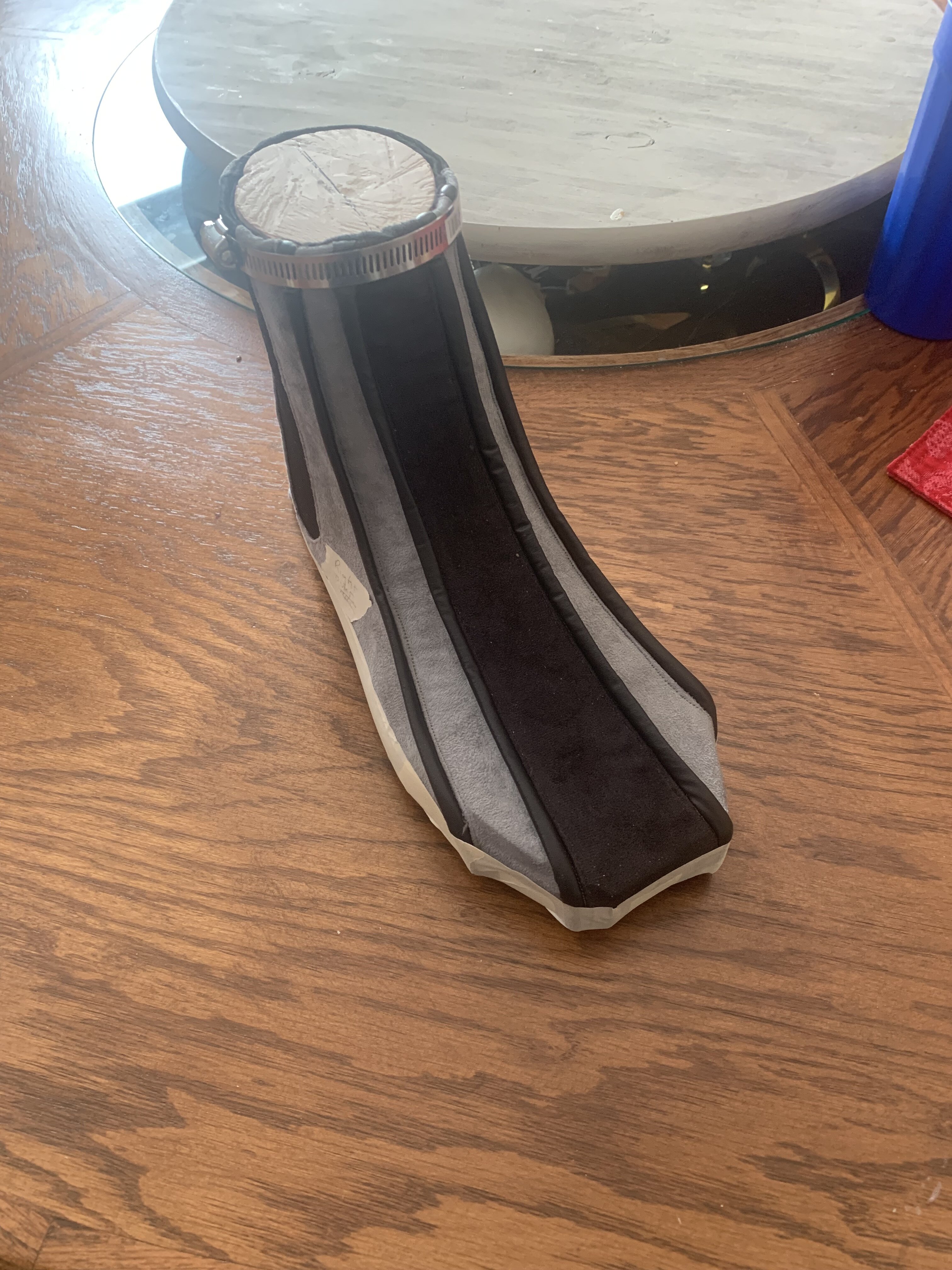

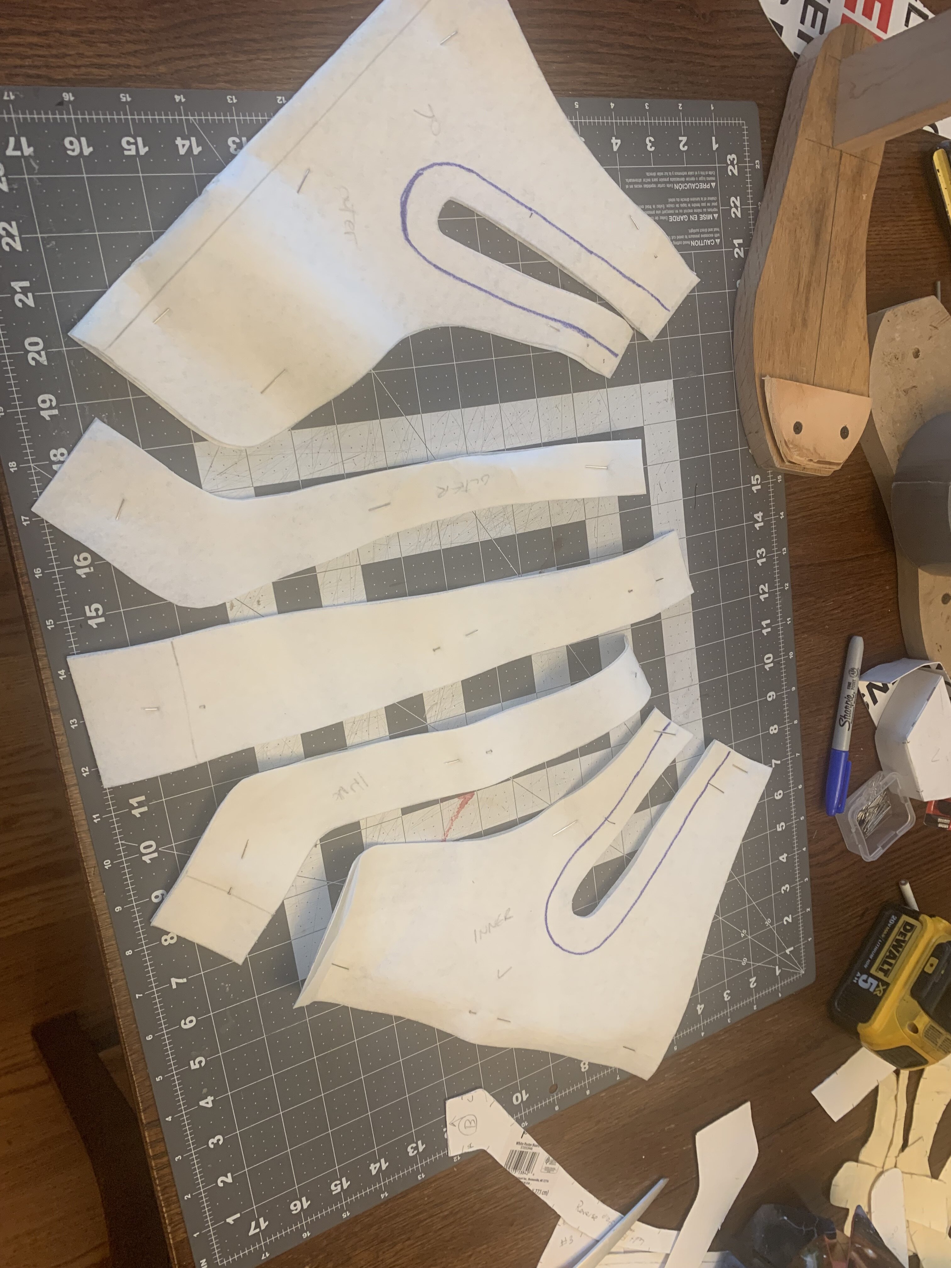

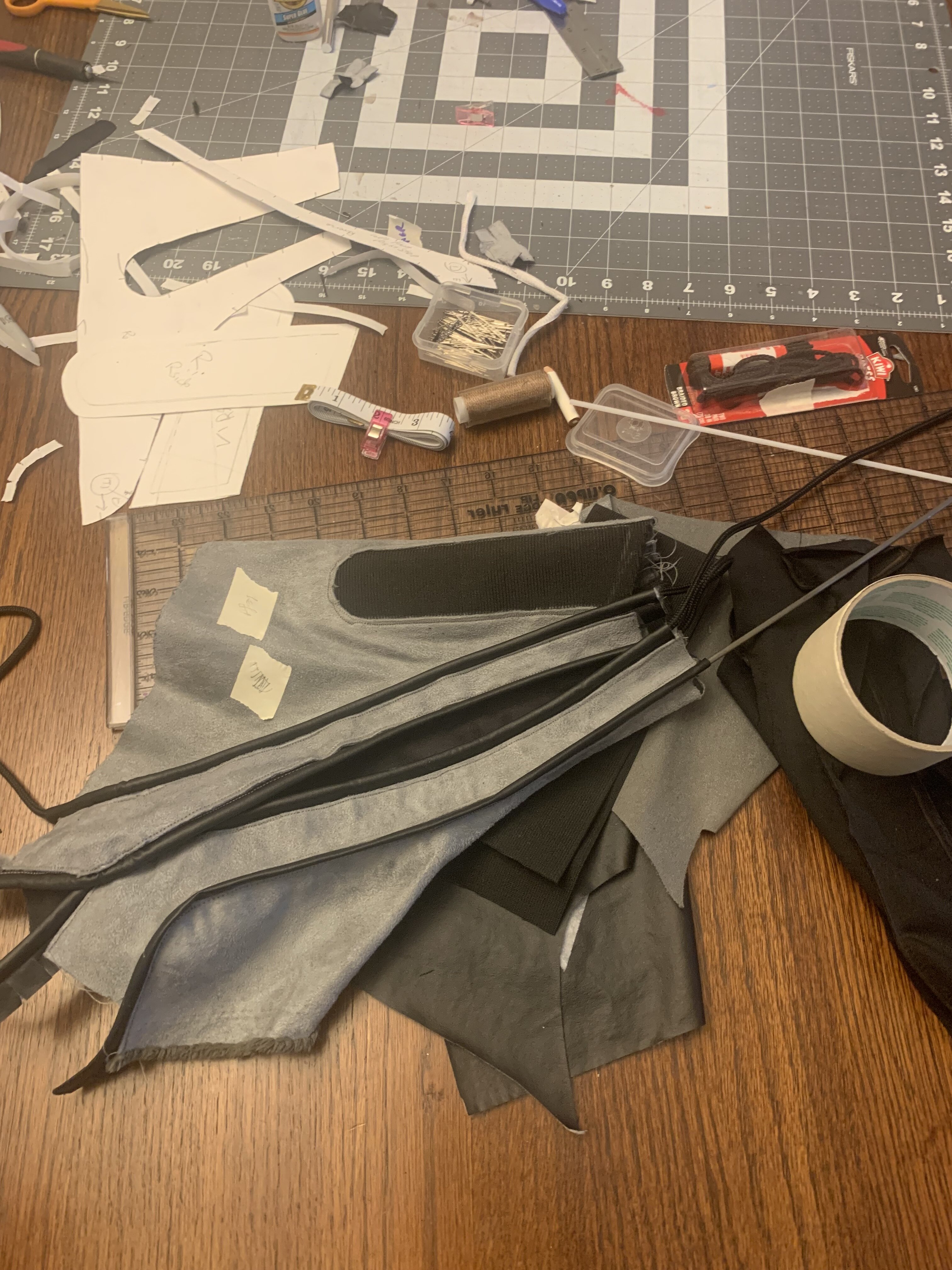

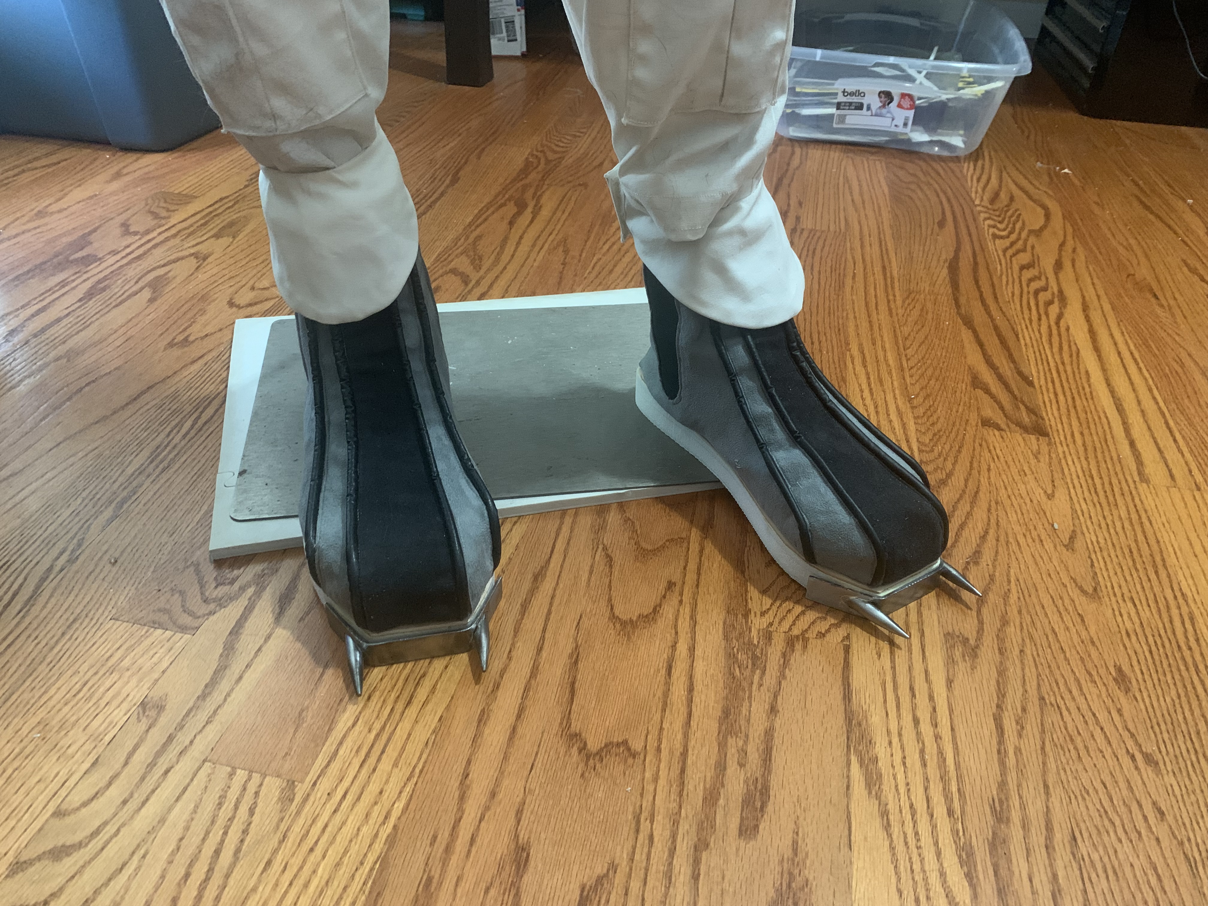

Here are a couple of the high points. The black edges are elastic so you can get your feet in. I used a faux leather for the black piping (it wasn't very elasticy and if I did it again, I'd use something different). I'll see if I can find a pic. The boots themselves are a faux suede from Michaels. I can't find it there anymore unfortunately.

One question, (I'm new to shoe-making) what kind of "thread" do you use to attach the sole to the rest of the shoe? I put thread in quotes since I hear it's more like twine...
Very nice, this helps out a ton!
I used a wax thread and heavy duty needle and leather punch kit I got from Amazon. I think Joanns sells them as well. I’d never made shoes before so I watched a couple videos on youtube and knew I’d need very strong thread for the soles. For the actual shoe, it’s just cotton thread that’s the same color as the fabric. I’ll see if I can find a better picture.
Also, invest in a lot of contact cement (DAP or Barge, or whatever). And make sure to use leather or faux leather that is really strong.
