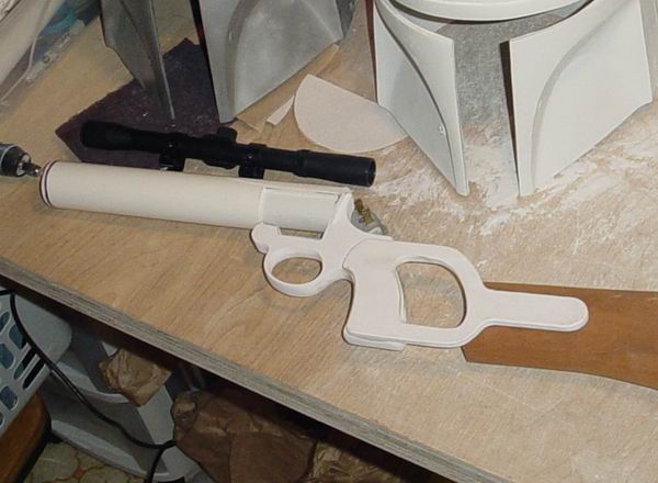

Ok some of you may have known that I have been working on a mostly PVC blaster for quite some time. Here is what I did:
I picked up some PVC pipe from Lowes (one 10' section) and I grabbed some scrap 1x6 pvc trimboard from work.
I resawed the trimboard to about 5/8" thick to use for the frame of the gun. I took some self-made templates as well as Wizardofflight's and made some tracings, cut and cleaned them up. I then went and picked up some PVC closet rod from Home Depot and sanded the crap out of it and slid it into the tube that I had cut. I put a notch in the end that would fit the top of the frame and used two screws to hold the frame to the barrell.
I then took some left over sintra and cut it for the receiver shroud (you know the piece the seperates this gun from any other revolver). I heated and bent it, and then used plummers PVC cleaner and glue to adhere it.
I then grabbed some masking tape and taped off the open should area and commenced to fill it with bondo. This made the entire assembly very rigid, like one solid piece. While the bondo was setting up and reaching the gel stage I started carving and shaping. Below is what I have so far.
Most details are still undone, this is just a very rough begining.

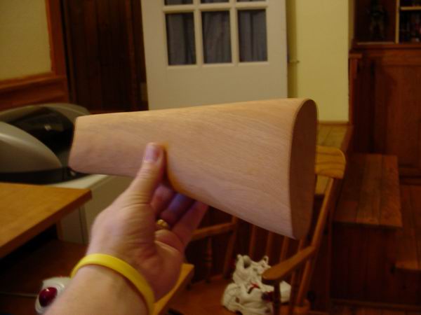

I'm also wondering how you went about the stock construction and what kind of wood you used. Looks awesome altogether.

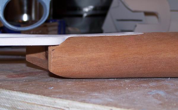

The Stock is made form solid 8/4 mahogany. Hand shaped and sanded. I cut it using WOF templates (Which I can confrim are spot-on!) I am quite happy with the over all look. I still have to clean up the shoulder area of the stalk, but you'll see what I mean later tonight when I post pics.

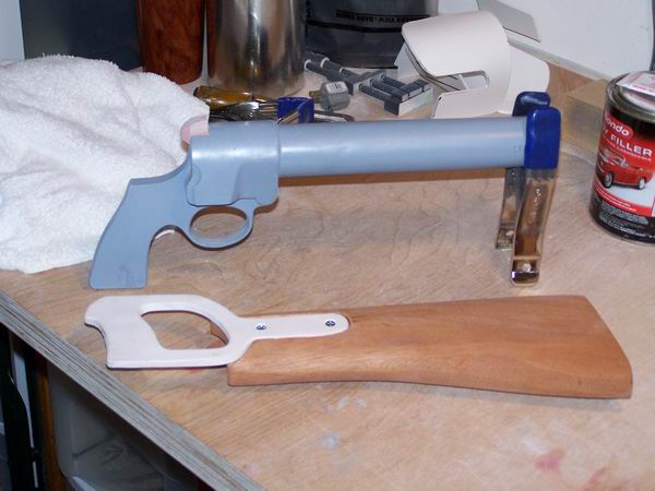

-The main gun frame has been cleaned up with spot putty. I am adding the rear nibs on the back of the receiver tonight, and test fitting the hammer and triggers. Once I get that bondo out I'll also clean up the reveiver area near it's hing point, then I will prime everything.

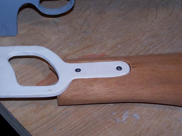

-I spent about 30 minutes routing and chiseling out the area for the stock bracket. It came out better than I thought it would. I am going to hold off cleaning it up until I get my final bracket (aluminum).
-I also took this time to cut and shape my handle. The overall countour isn't exact, but I think it'll work for now. I am going to get some new blades and see if I can take some time to give it the "grip" knurling.
