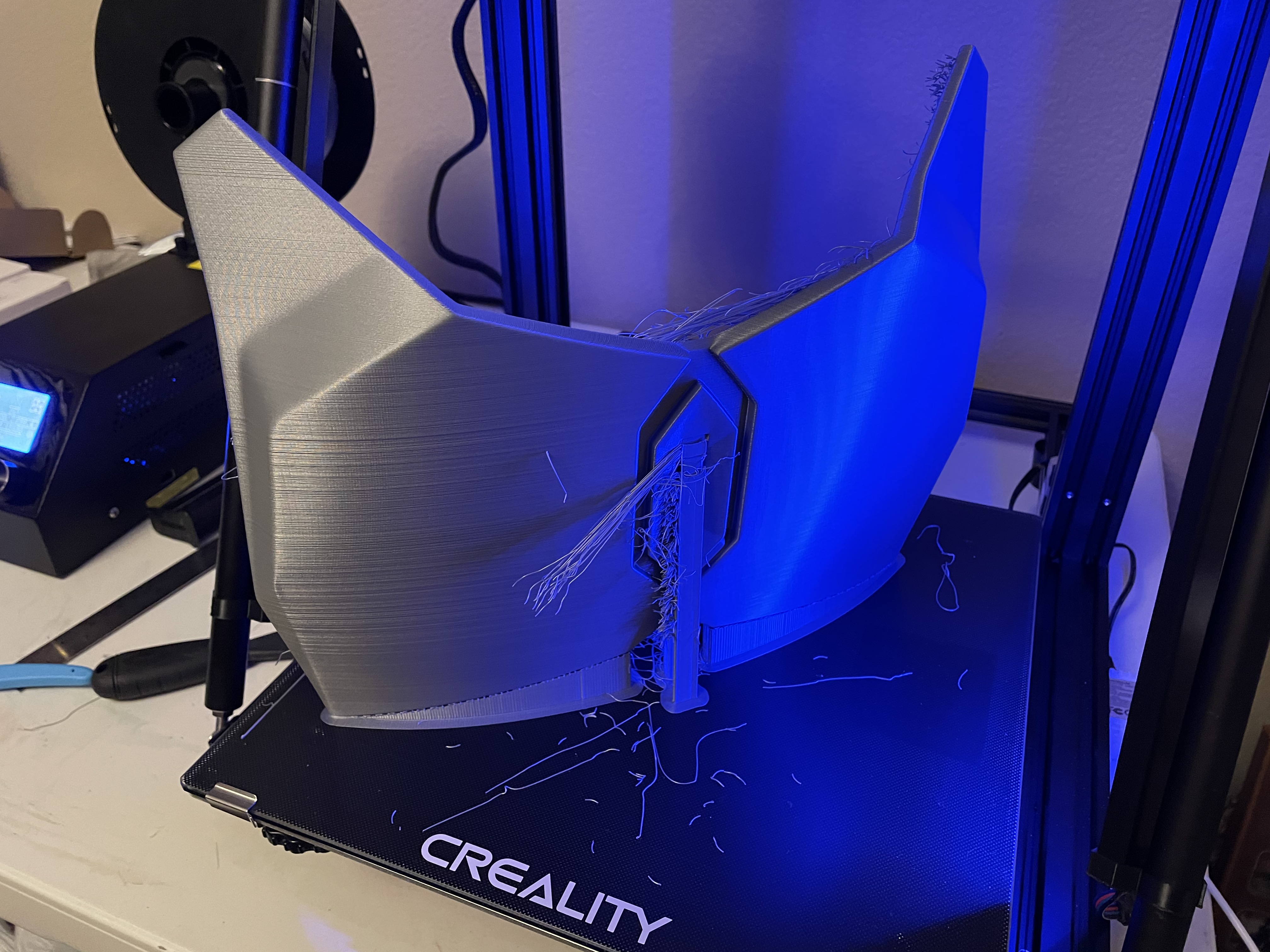

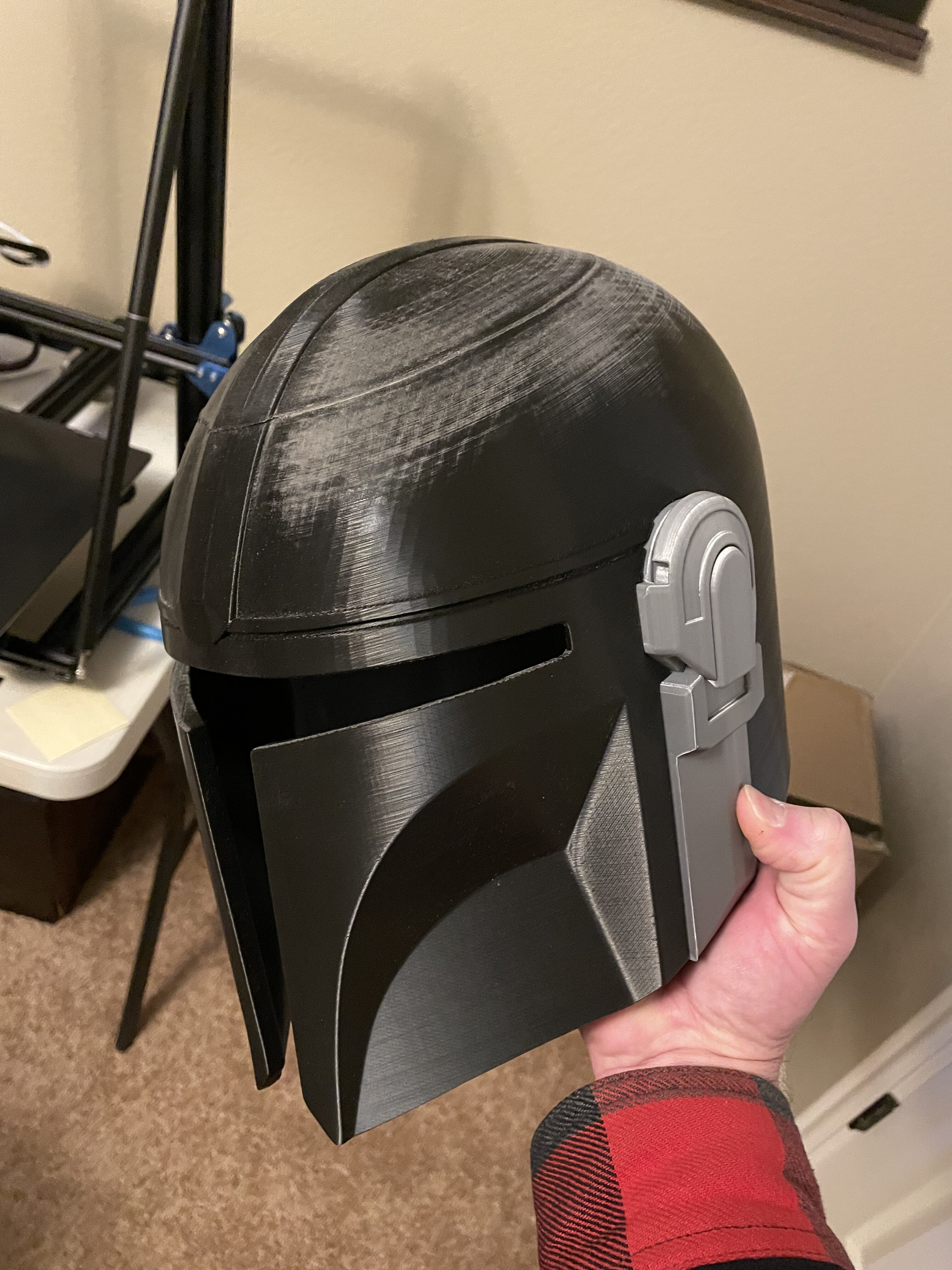

First off the helmet - Lots of models out there and since I still wasn't seeing doing a full costume yet, I started with the Mando helmet from Rob Pauza (3D Printable Mandalorian Helmet - v2 by Rob Pauza). I watched most of the helmet print videos on YouTube and wanted to tackle this in one piece. Being new to 3d printing, I thought I was off to a good start -until I decided to wipe off the bed rollers with only 12 hours to go. The printer is still pretty new and I'm guessing that there was excess grease on the roller bearings which was starting to build up a few fuzzballs. Unfortunately, the rag I was using got caught in a roller and threw off the y-axis by just a couple mm.
I stopped the print and ended up with this:
I took note of the z-axis height on the printer display and then printed out the "cap" a mm taller than needed. I figured I could sand this piece down and epoxy to the shell. After printing the cap and earpieces and glue up, I ended up at this stage with just some basic sanding. More to come...

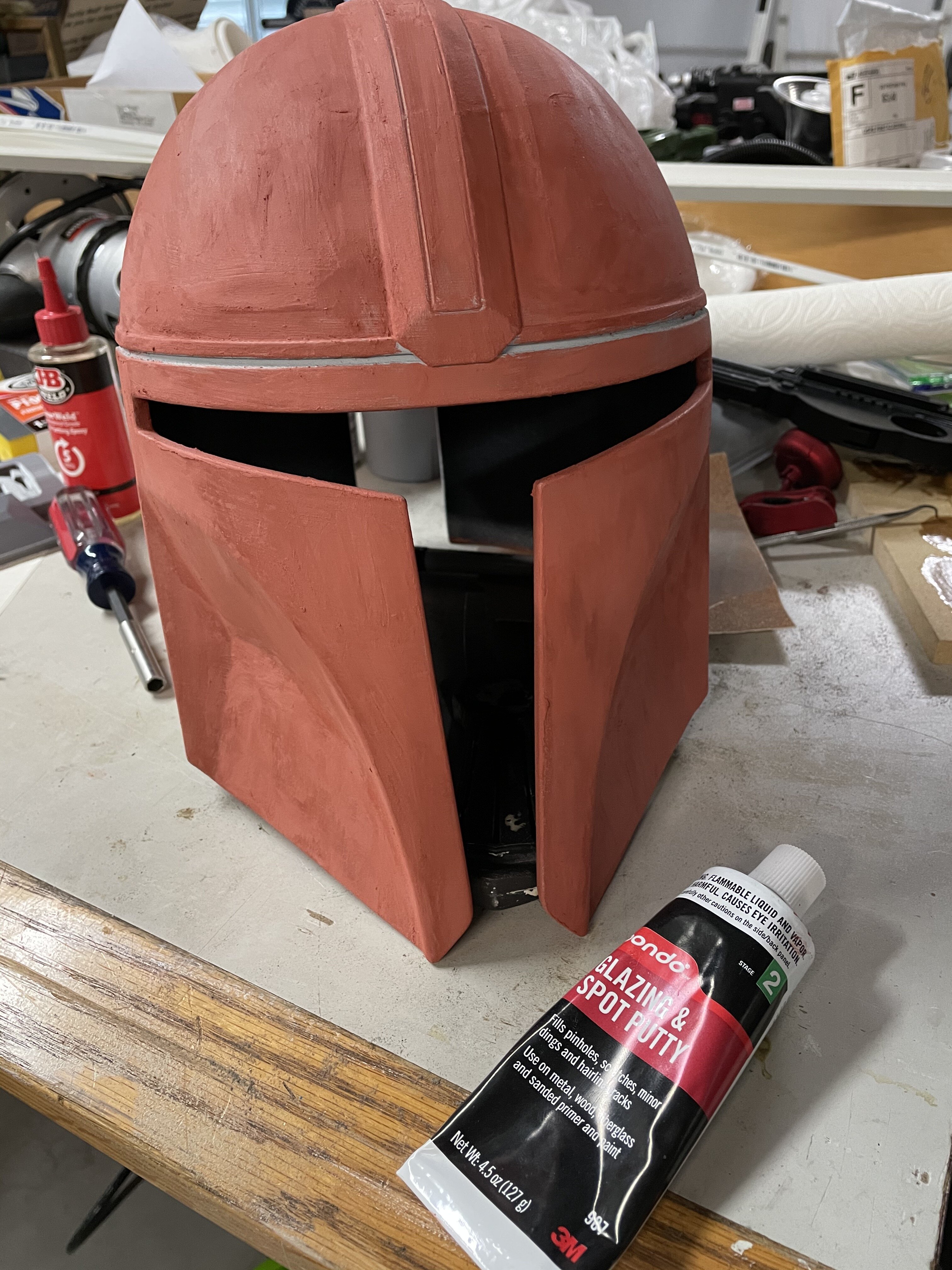

After some rough sanding, primer and spot putty, I ended up here:

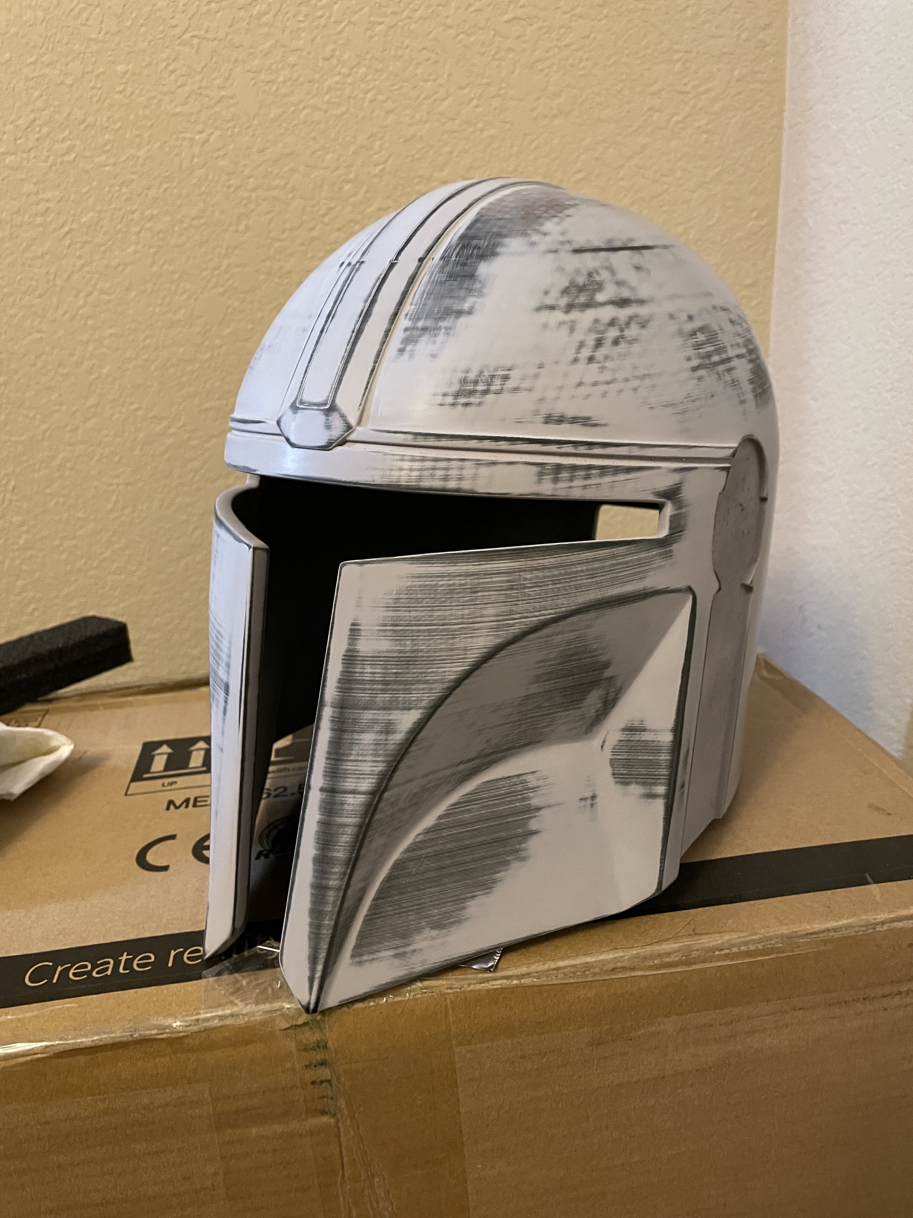

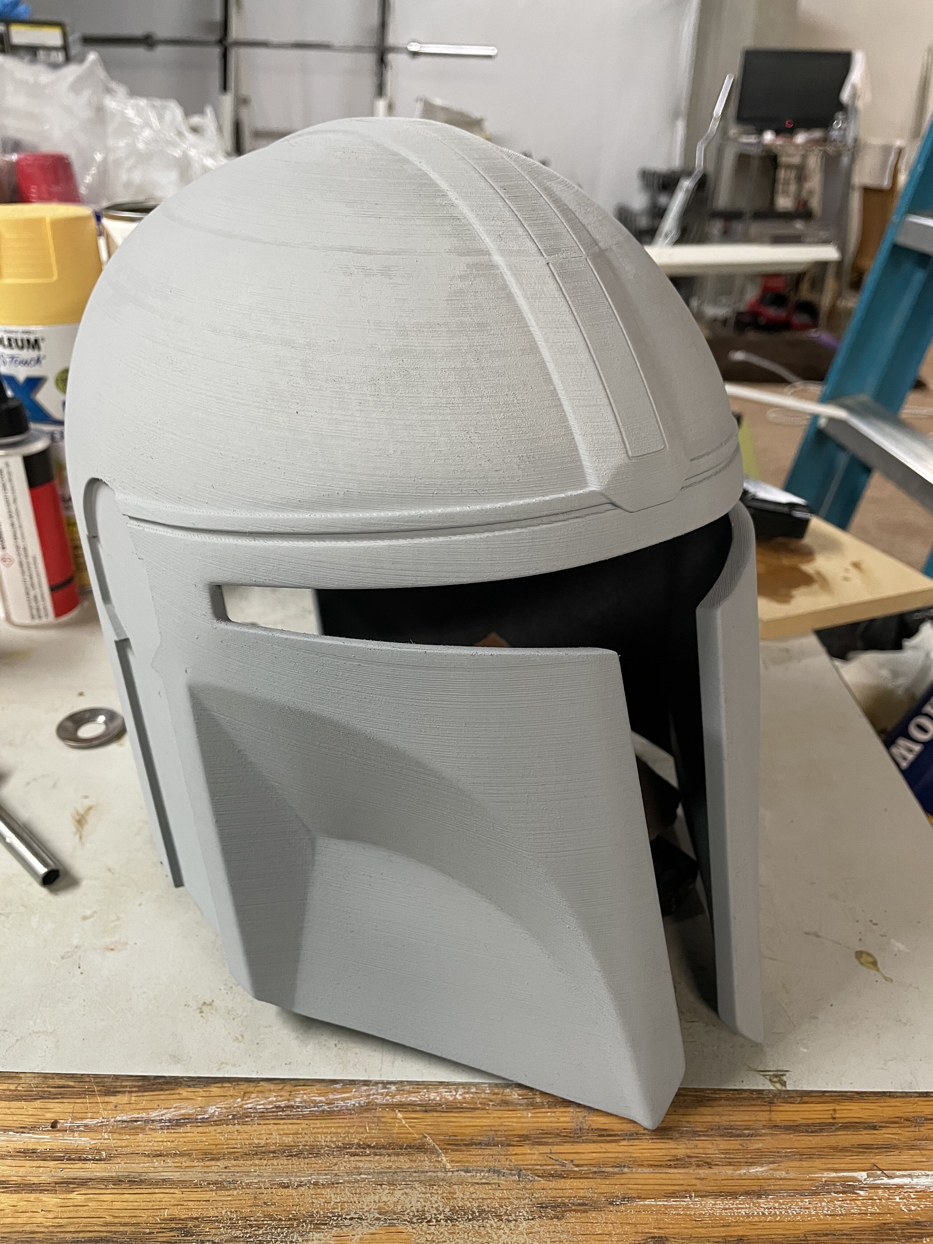

Multiple sanding starting with 100,120, 200, 320, 400, 600, and 1000 got me this point. I think I finally have everything smoothed out. The cap was definitely a pain to get smoothed out and I probably won't use this helmet for anything other than a prototype. I recently picked up Niko's updated helmet files from him and will probably print those out later.

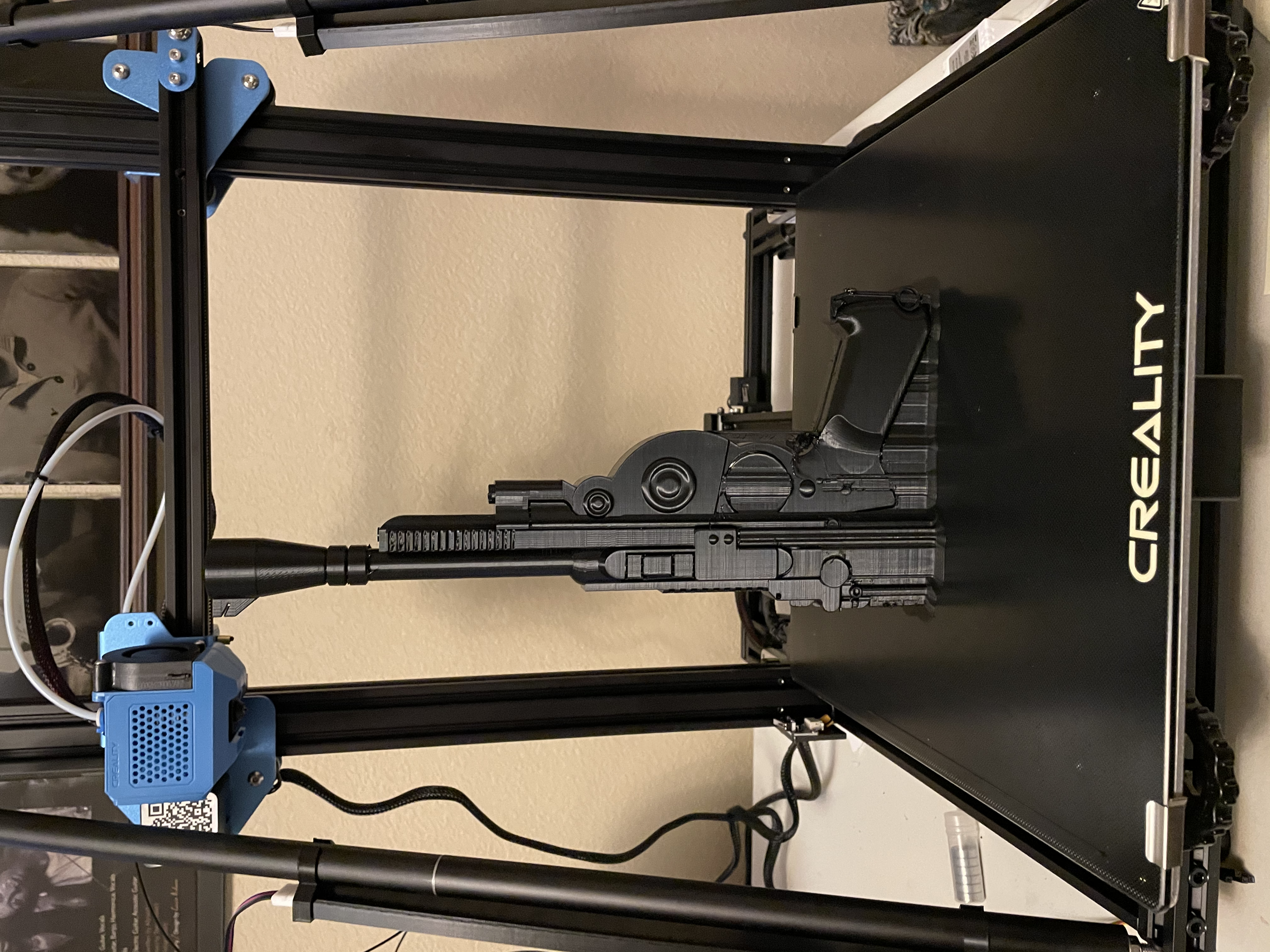

While waiting on paint to dry, I ended up printing the Straeker's Mando blaster from a Thingiverse model (The Mandalorian Blaster (Final Version) by Straekers_Armory). Wanting to test out the printer, I did this all in one piece with plenty of supports. They ended up being difficult to remove around the hammer, but the rest of the print turned out well. This one is just sitting around for now until I sand and prime and pick up some paints to finish.

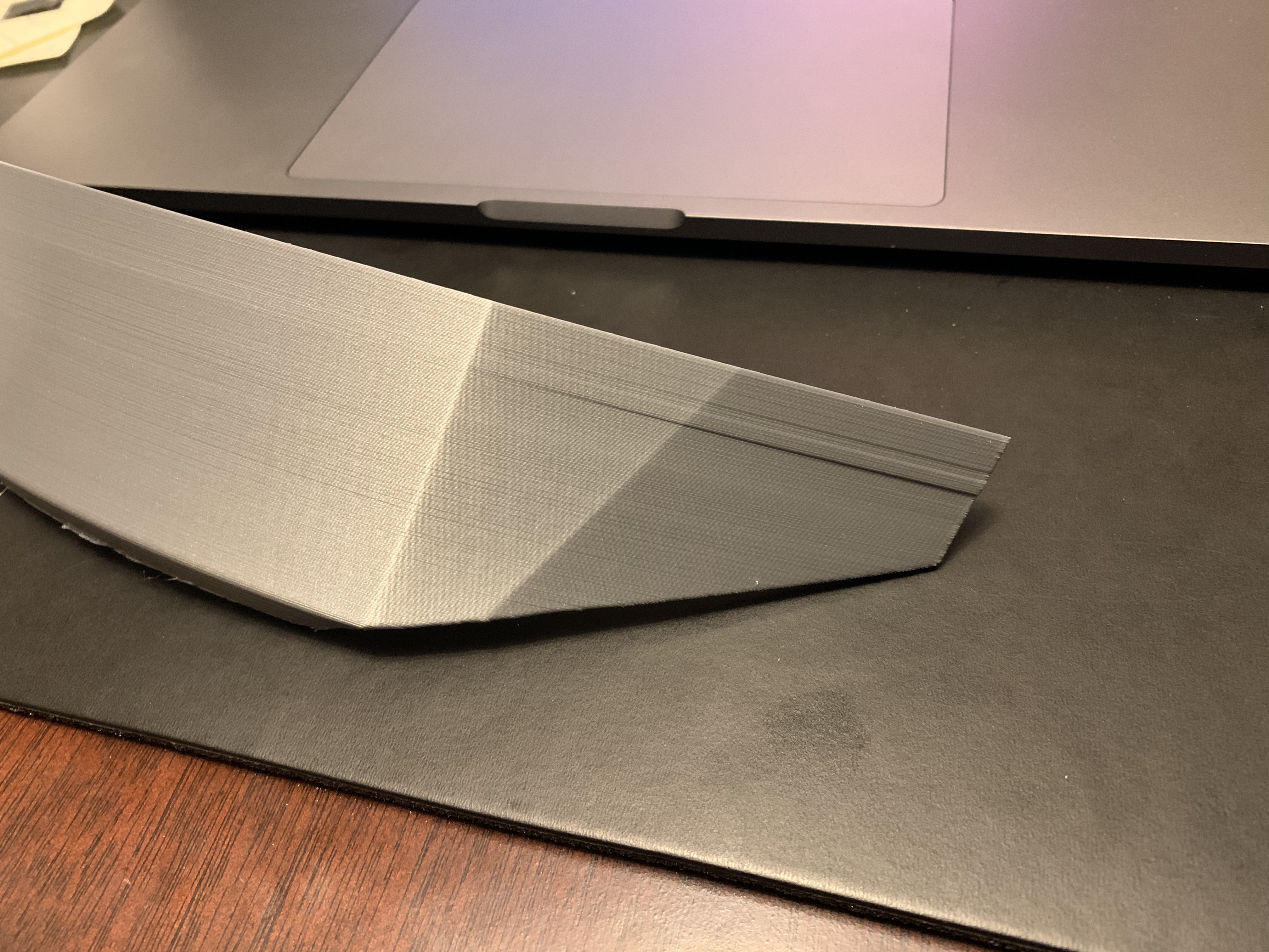

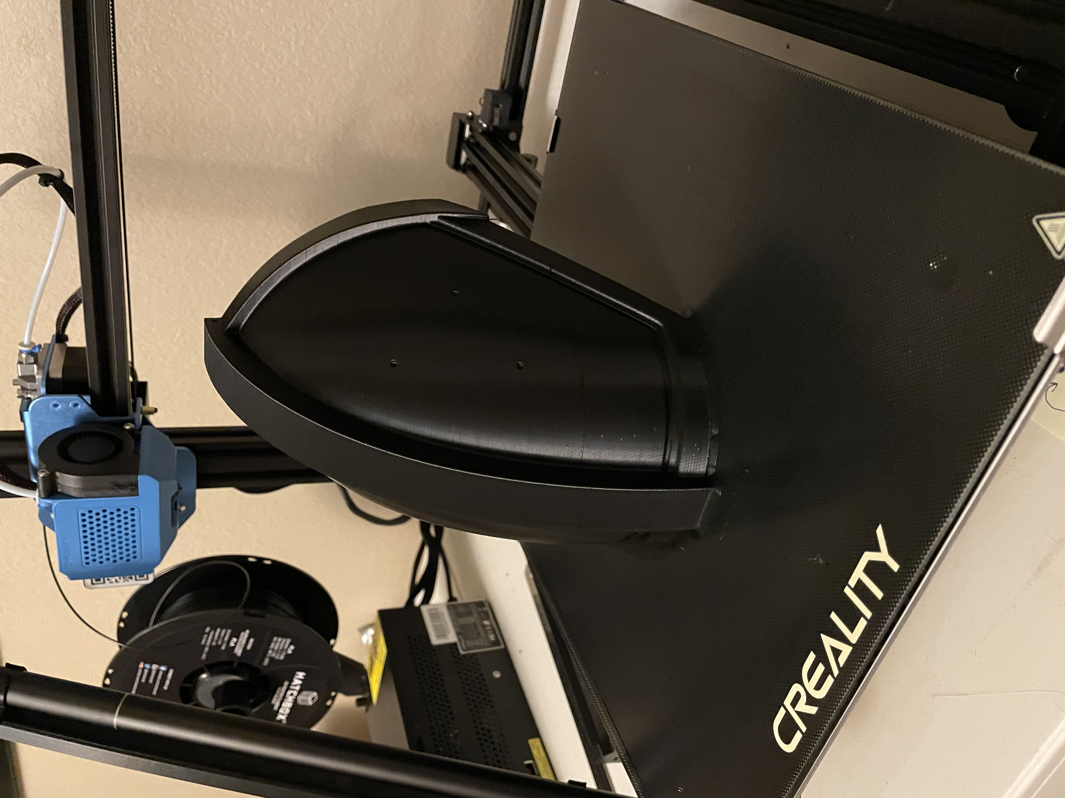

Latest print - I got the GreatApe files off of Etsy recently and started working on a few of the other Beskar pieces. Started with the mud horn shoulder pauldron. Most print videos I've seen show the print in a horizontal orientation, but I played around in Cura a bit with how to minimize print time, supports and a smoother finish. I ended up with an upright print at .16 layer height at just over 24 hours. Probably will do the rest of the armor at .2 like the helmet. I did have 1 layer about a third of the way up that didn't print well, so I had to epoxy the back side to keep the pieces together. Printing the mud horn badge out now.

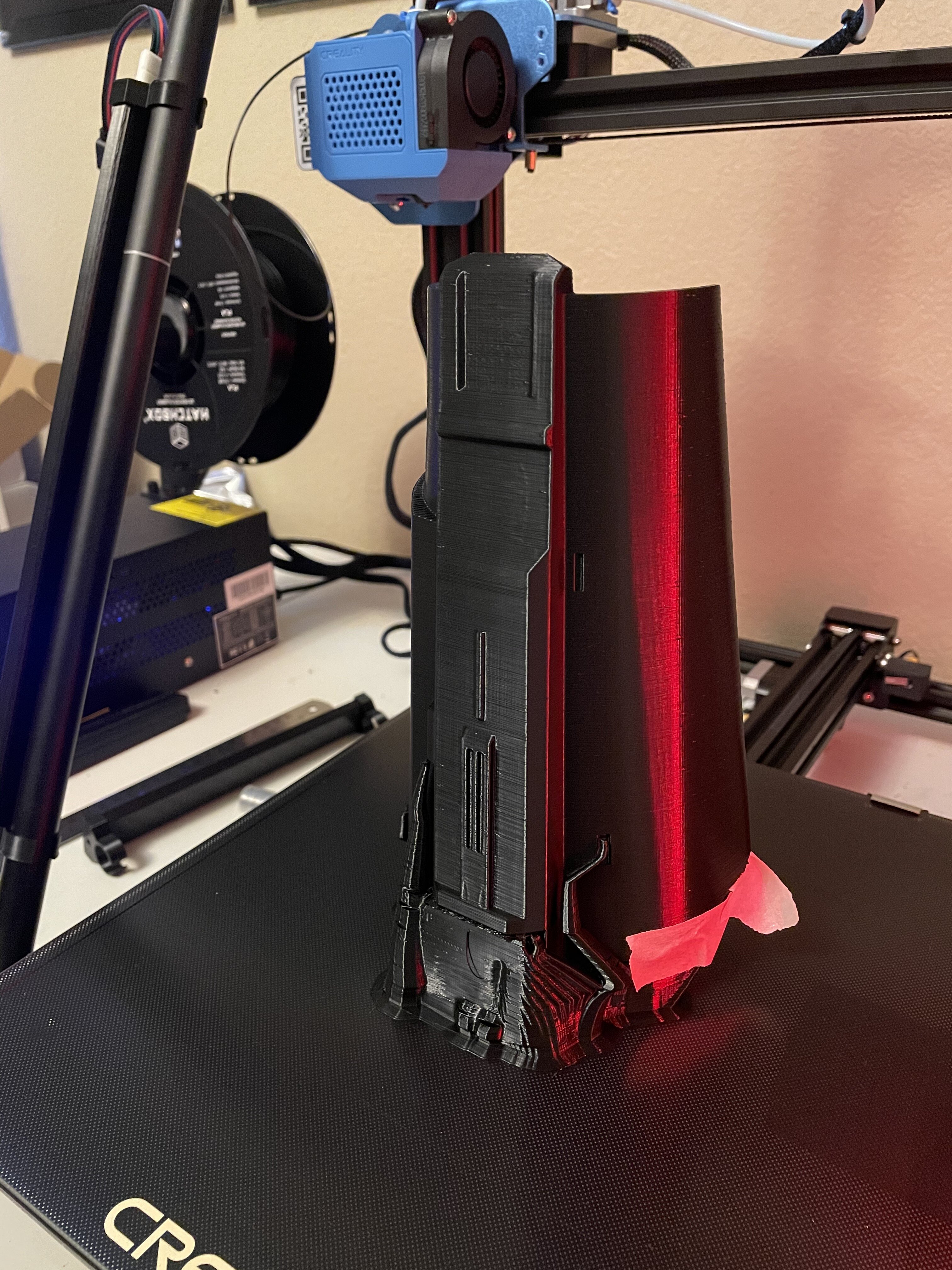

A couple new prints over the last few days. The right gauntlet is done, although it separated from the support on one corner while printing. I thought I'd try to save it with some masking tape and I got lucky. Also finished the breastplate with a lot of stringing on the supports but the plate itself is pretty well intact. Working on the lower ab plate now and while the gauntlet and pauldron is being primed. Still need to do a few more pieces on the upper then move to the lower parts and re-print a better helmet.

Also had to restart the ab plate print. I noticed that one edge came disconnected from the supports and was bouncing around a bit causing some layer shifting. Replaced with a jacketed support wall on the edge to help out. Currently at 52% complete and looking much better. It's a pretty thin piece to print vertical and keep everything lined up so hoping for better luck on this print.
