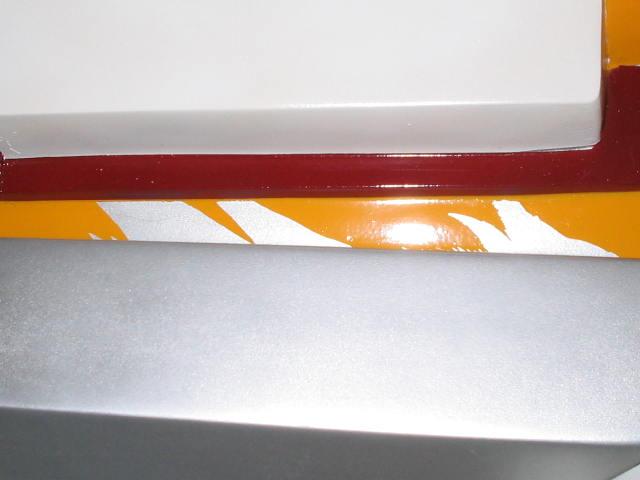

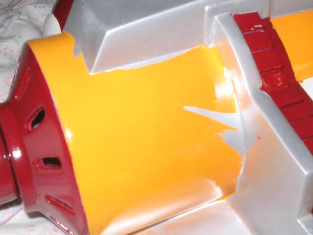

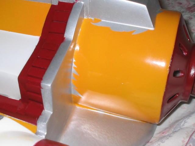

Here's the damage as promised.
Fettster,
it's not that the tape is sticking to the color that has been masked, it's peeling the paint that I just sprayed.

I can't do the touch-up idea. The paint isn't just a soild color. It is the equipment yellow with pumpkin misted in the corners. it's subtle , but it's there.

Thats what mine did, and it looked just like that!!!!! Telling you its that silver you have on there. You might have to sand it with something like 1000g or 0000 steel wool. Then again how long did you wait for that paint to dry? But im telling you it's the silver.
Yea ... its the silver. Thats exactly what mine did too. Try sanding the silver with a fine grit sand paper. You do not have to sand it all off, but you do have to rough up the surface enough to give the next layer of paint something to stick to.
Sand the blue areas too, or you will run into the same problem. For some reason the yellow and blue (Rustoleum Royal Blue?) do not want to stick to a metallic based undercoat.
What brand / color did you use for the silver?
