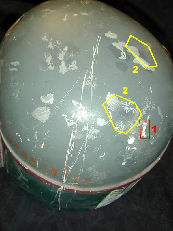

A couple of things regarding that image of the dome.
#1--The white "blobs" I was talking about earlier. It appears as though some of the silver/gray damage lays over the white. This would be a strange trick if the white got spattered on the helmet after its paint work was complete.
#2--As I highlighted in these 2 places, it looks like an odd mix of layered work here. If we consider this as a layered paint job, it seems that a base coat of silver was applied, then misted with some darker tone. After which, some areas were masked and a layer of green applied, allowing the mixed silver/darker gray to show through. Then, in some places, it looks like entirely new silver patches were added topically. :confused
IMHO all the helmet was painted the layered way (as all the helmets painted by Sandy), then the dark-weathering applied making the effect of darker zones over the green, I don't know about the white spots. And 99.9% sure it's not POG for the dome.
I'm convinced this helmet was totally layered, but then I would be...:) I think the real secret is the masking tape "pull" effect through the top coat, down to the base silver; the silver seams too detailed to be painted either topically or with liquid mask. Maybe the secret to the extra damage ( especially seen on the wear on the ears, between the publicity shots and the final images with it's present owner ) is the lack of key between the silver layer and top coat, very easy to pick off paint layers, but also easy for paint to be chipped/rubbed off accidentally...
Interesting point in #2 except you missed a step. The bright silver would have been liquid masked first, then the grey pre shading applied, then select areas of grey or silver grey would have been liquid masked before the green top coat.
Garrett, yeah, I see what you mean. My brain just doesn't think as 'layered' as yours! :)
The PP2 is reminding me of the ROTJ I did a while back, it's all masking and pre shading on the silver and even that stage has 3 or 4 layers before any colour goes on and then there's more shading to be done! I'm still scratching my head over those white marks on the back as they do have grey/silver within them which would suggest another explanation other than real damage...:confused
TF, after all the paintjob is done, the helmet was weathered over it, just as RotJ, that would explain the weathering over the white things.

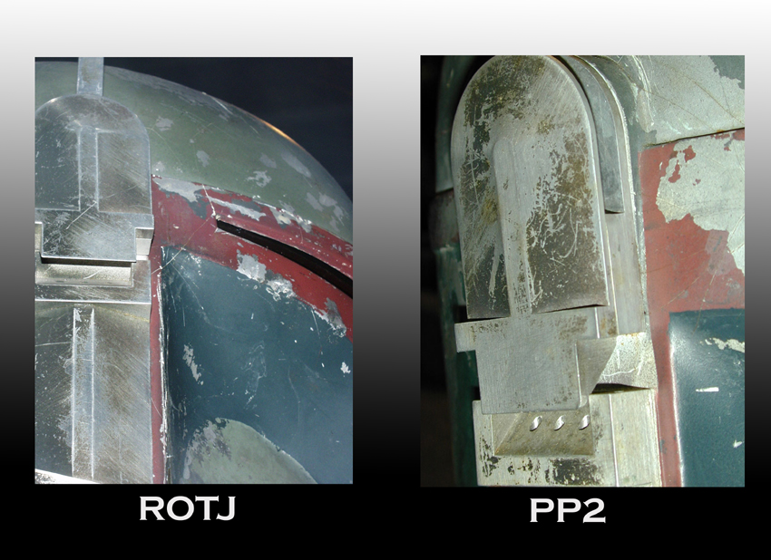

As everyone so far has said, we all know Sandy painted the ROTJ and the PP2... so IMO paints would probably be along the same lines... as we can all see that the misting, weathering and paint colors are equal when comparing the two helmets...(compare shot below)
attachment.php
I've painted three ROTJ helmets in my day... not many, but I came up with a color list that I still use to this day.... so I will probably use the same colors from my ROTJ list. Now I base these colors on a silver layered underneath background or base color, as this will determine the over all hue ... and as others have said there are weathered layered silver scratches throughout...so layered is def the way to go.

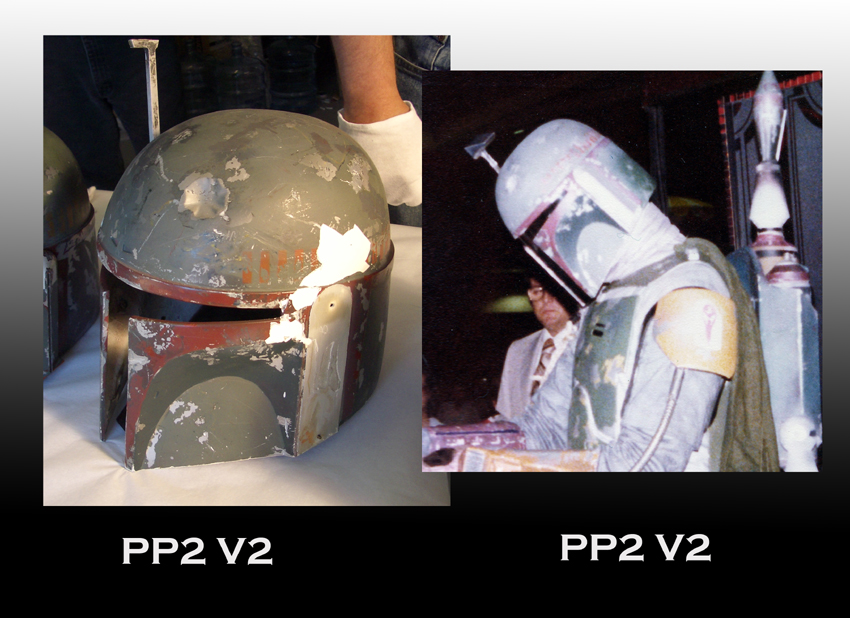

Here is an example of the PP2 V2 promo helmet in the Archieves (no flash) and the same helmet with during a promo event (with flash)... :thumbsup:
attachment.php
I'm seeing colour within the white damage, not on top, if that makes any sense? That means it's a layer and not topical...:confused
