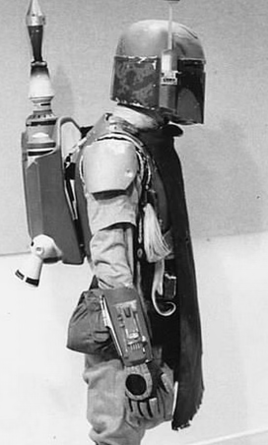

Just wanted something similar. Adjustments also made to vest and flight suit.

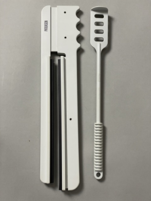

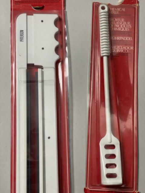

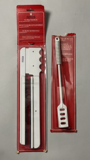

A look at a pair of unspoiled, period-correct Paterson squeegee and chemical mixer in original packaging. The mixer will go on my ESB. I already have a correct version vintage squeegee for the costume that's already cut.

another comparison of the color of the old against the new (new in middle). Besides the color, there is little difference between a modern mixer and the old. The modern is a hair smaller and sometimes has a tiny little dimple at the top of the rod where it joins with the handle.

I've been debating sacrificing my vintage squeegee....:lol:

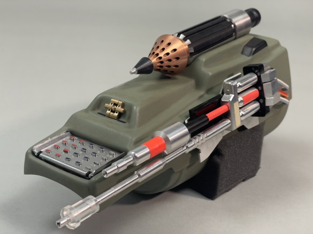

On to the left gauntlet...

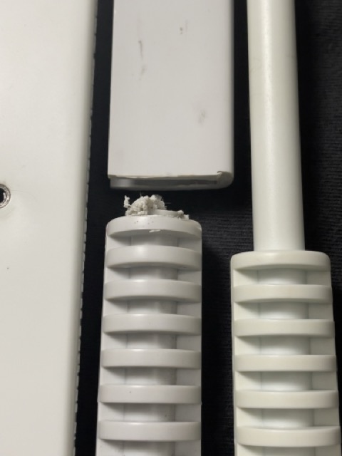

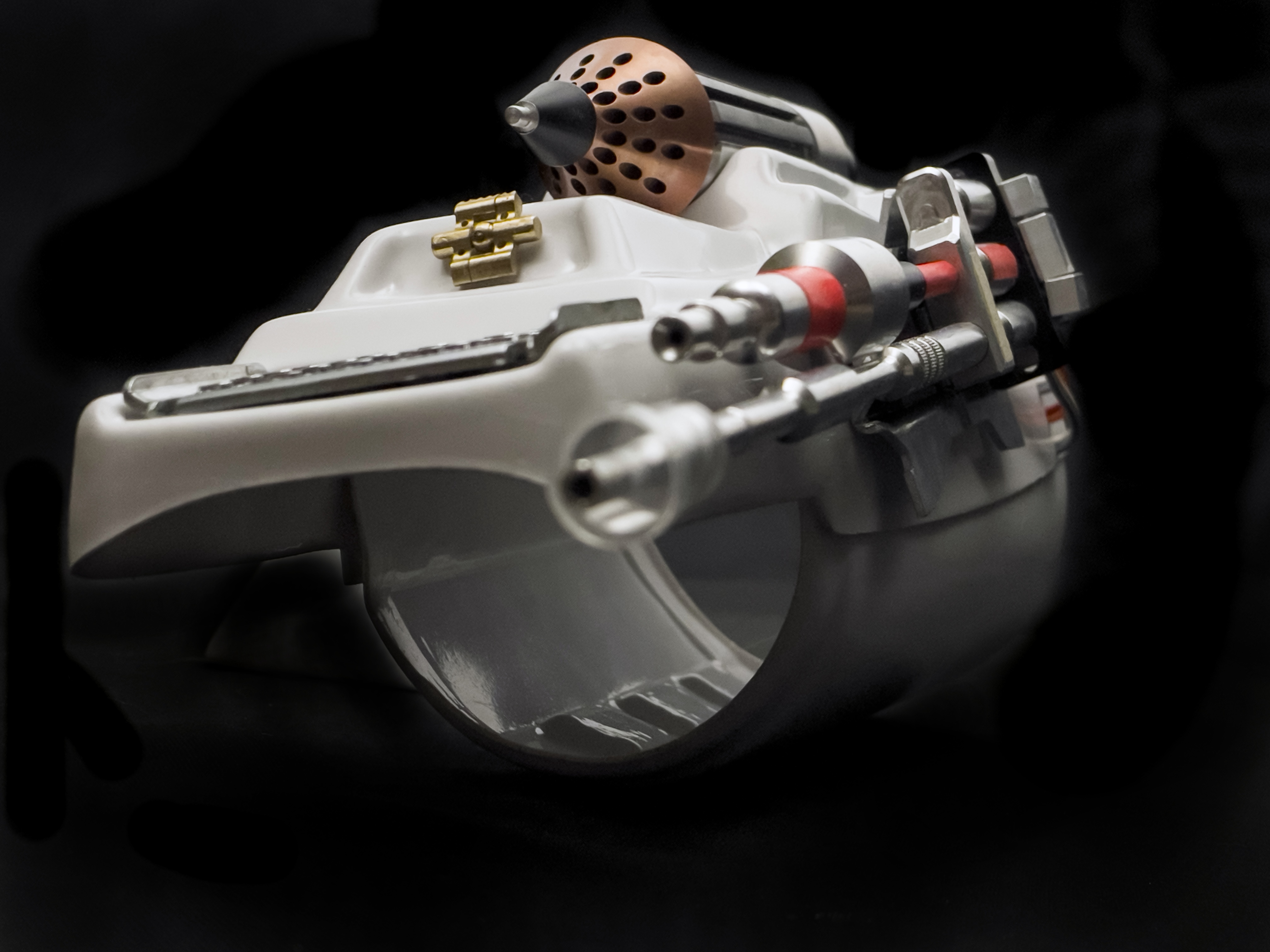

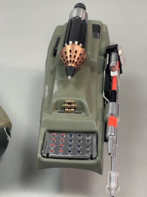

I've waiting to complete this gauntlet rebuild for two years, and in the meantime something happened to my Elstree gauntlet rocket. I guess when I polished and sealed the copper tip a year ago, I didn't seal the bottoms of the holes, and I got this lovely mess...
this was really hard to clean up. Thanks to my friend @ConvergenceProps for getting that out for me. So be careful when you clean these and make sure you seal everything that was polished, including the hole bottoms.

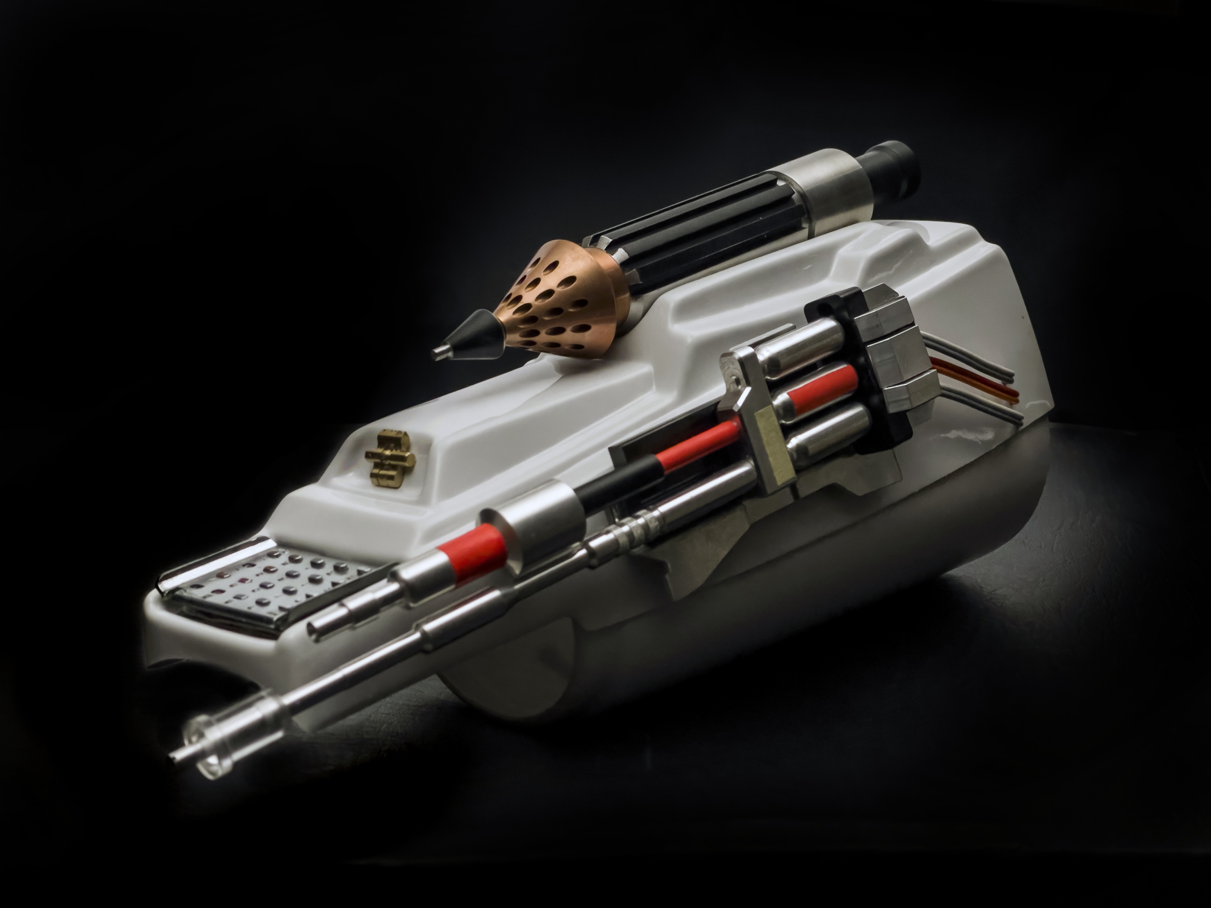

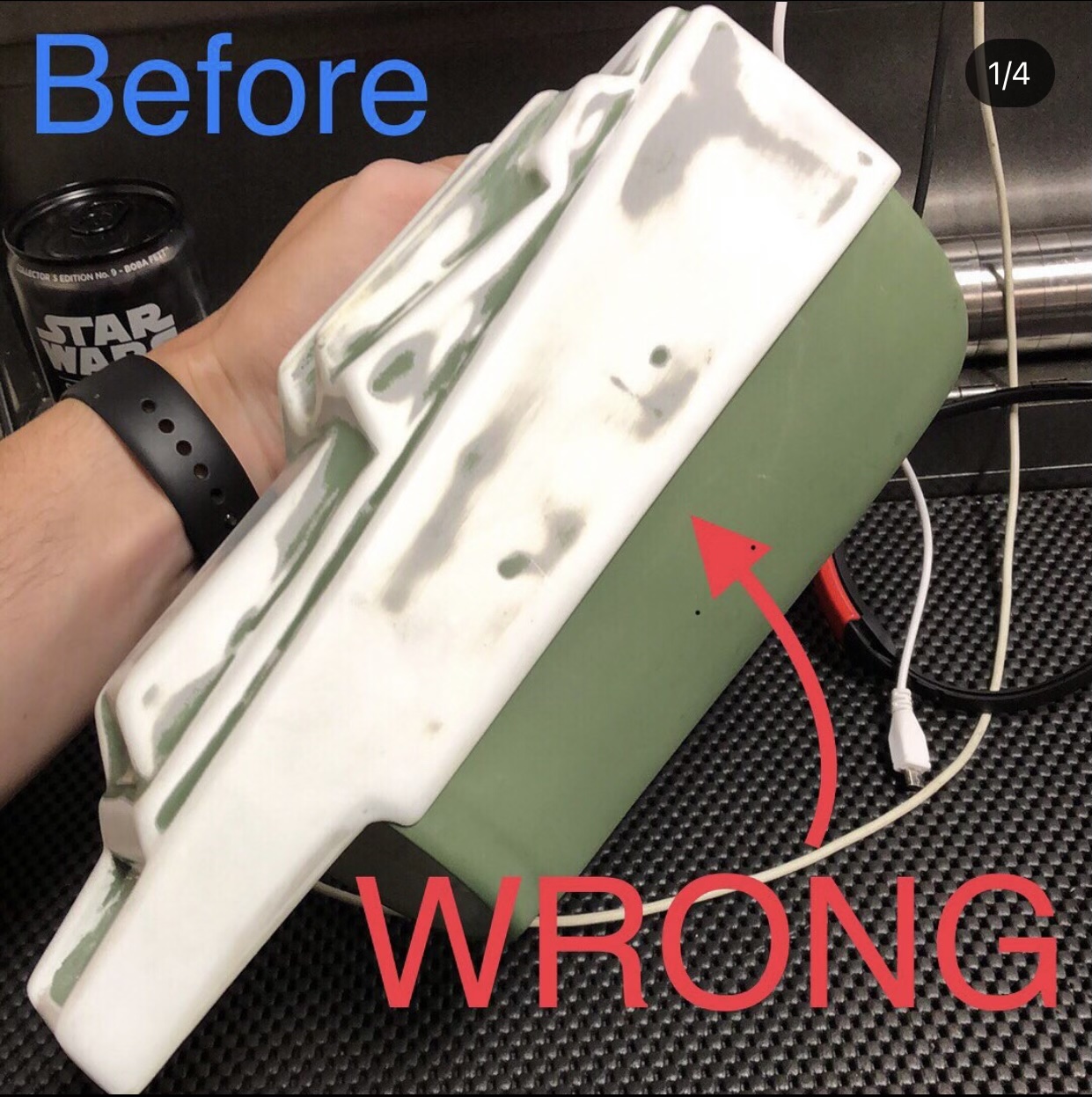

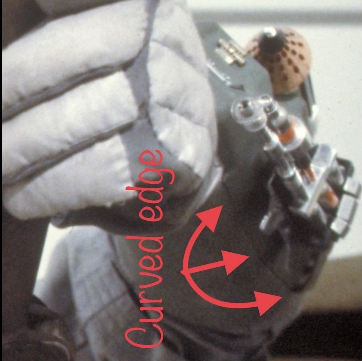

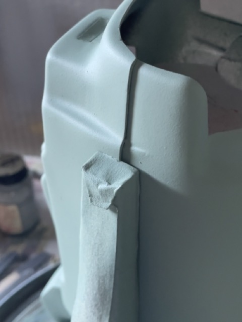

The build of the left gauntlet is not as difficult as the right in my opinion. The only thing to be careful of when trimming is to make sure to get that curve on the outboard seam. The temptation is to cut it straight, but as @ConvergenceProps rightly pointed out for all of us, it is not straight.
I was probably a little conservative on my curvature...
Just be sure to mount the flamethrower up as high as you can. It's actually up higher than some people seem to think. I line up the top of the aluminum backplate to the top edge of the gauntlet. Below you can see where I put the screw holes for it.

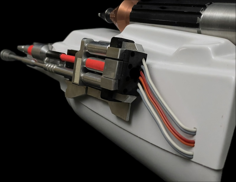

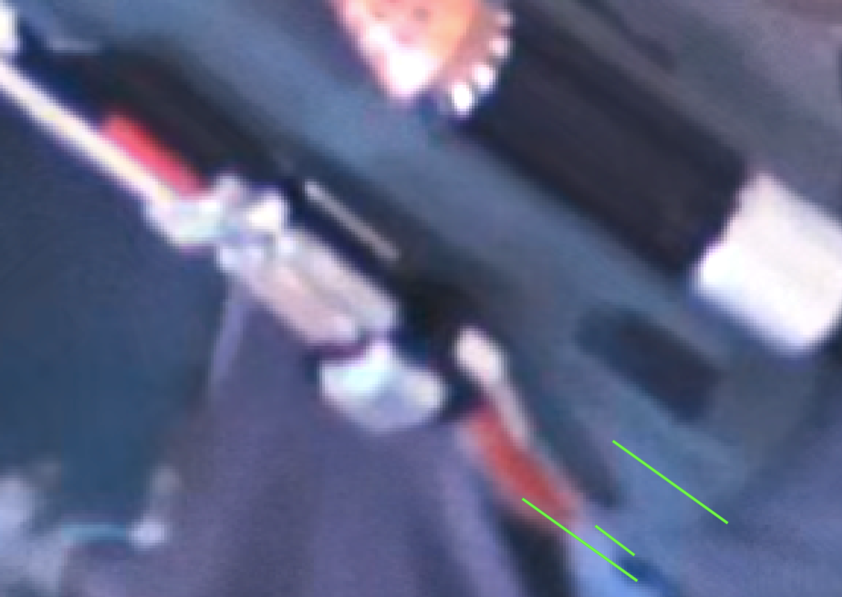

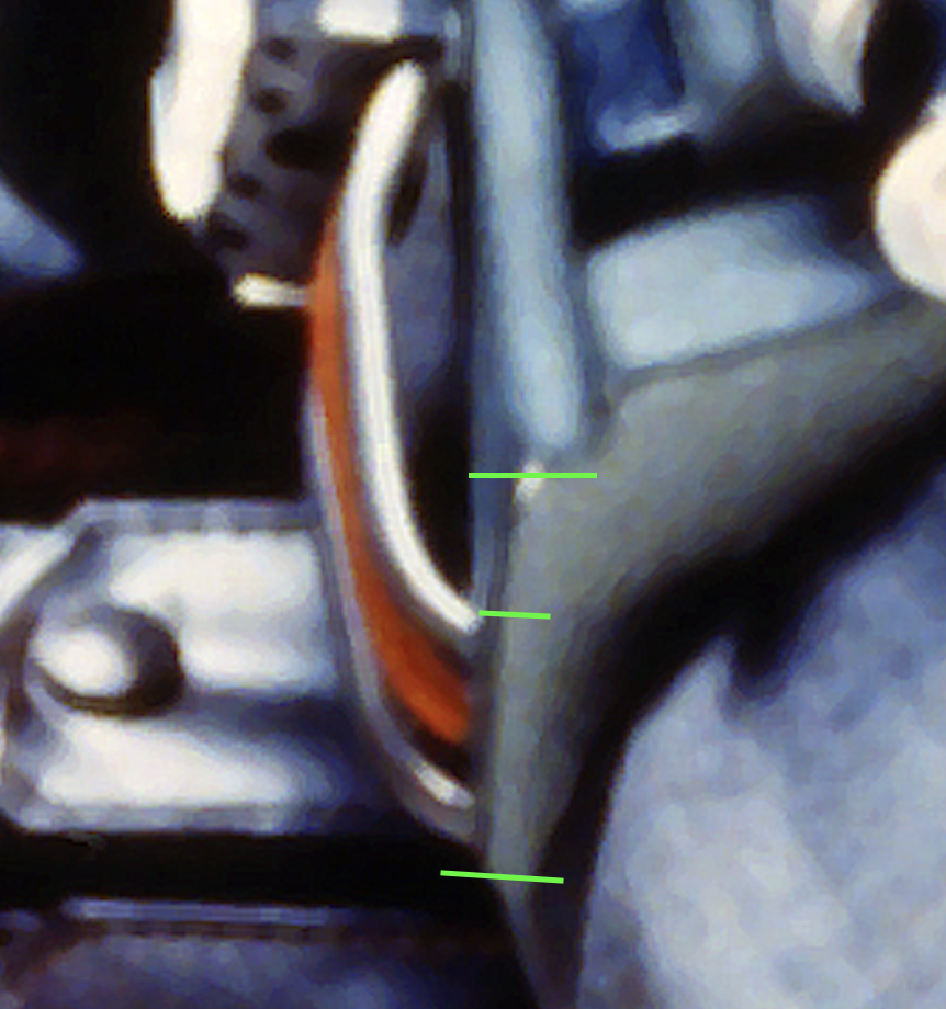

I agonized over the placement of the wires in back. They seem to drift from scene to scene but I'm not sure most of that is optical illusion of poor resolution or difficult angles.

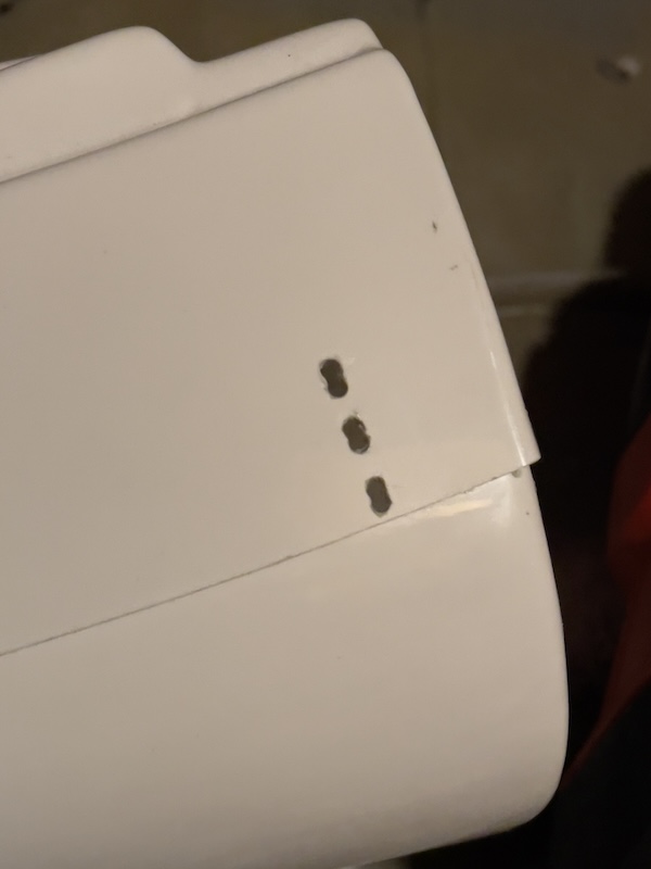

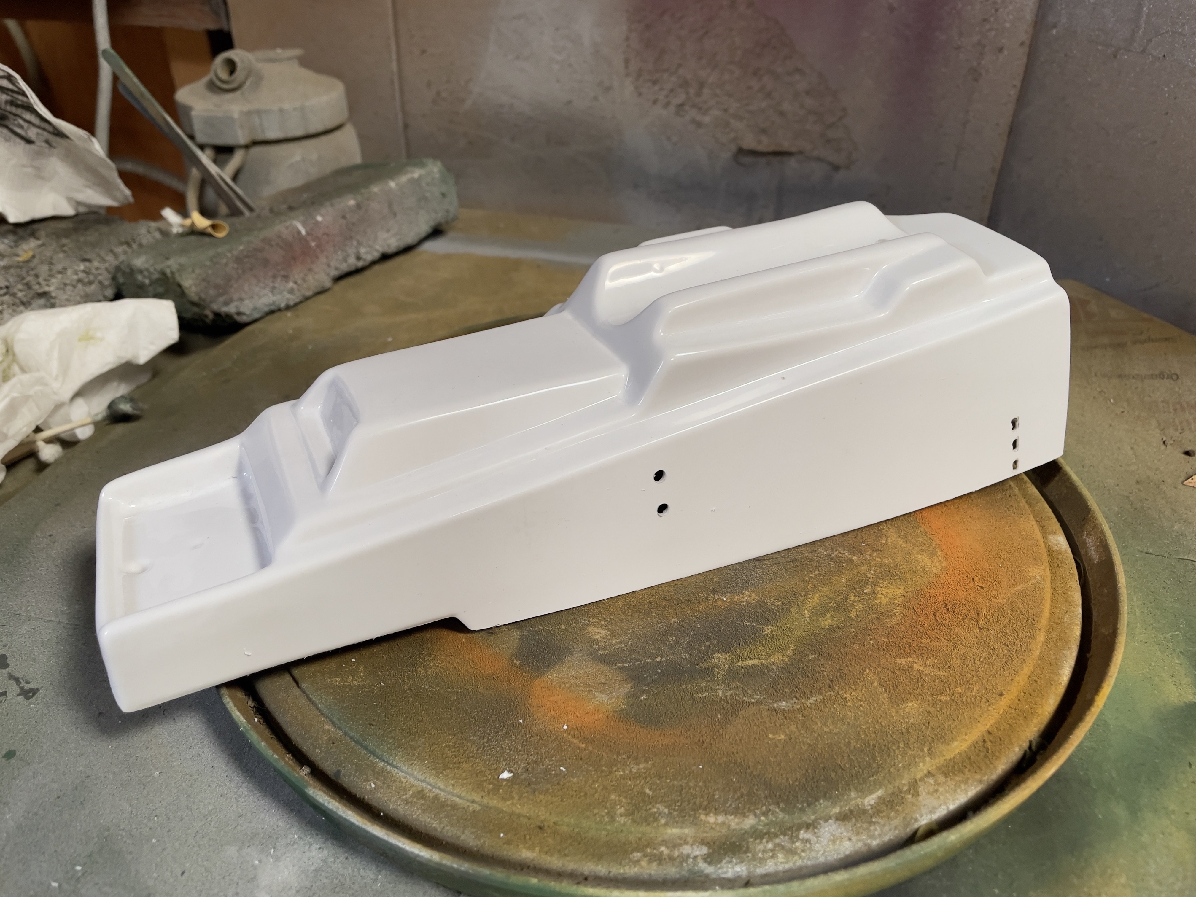

In the end I decided the holes seem to line up with the back end of the black painted bump feature on the topside next to the rocket.
These are holes just big enough for the wire gauge, drilled side by side so to end up conjoined like the wire. I then just stuck the wire ends through and bent them into place, and plugged the other ends into the back of the flamethrower.

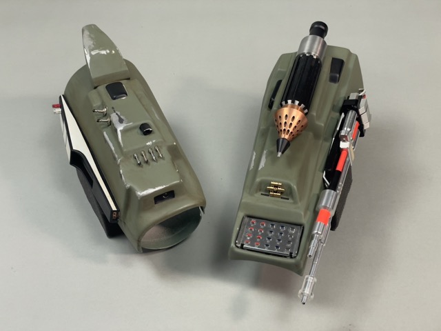

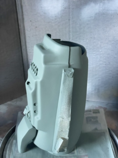

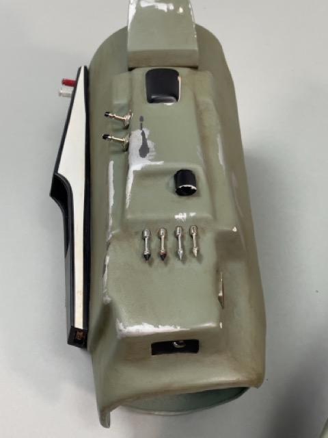

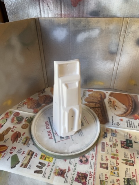

So then, paint. I went through a whole lot of mixes to come up with something better than I used last time. In the end, I went back to what I used last time. SAC bomber green mixed with light gray. Seemed to work better than anything else I can conjure up. And easier.

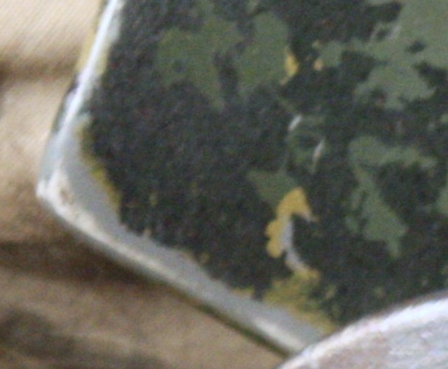

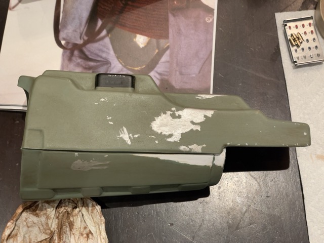

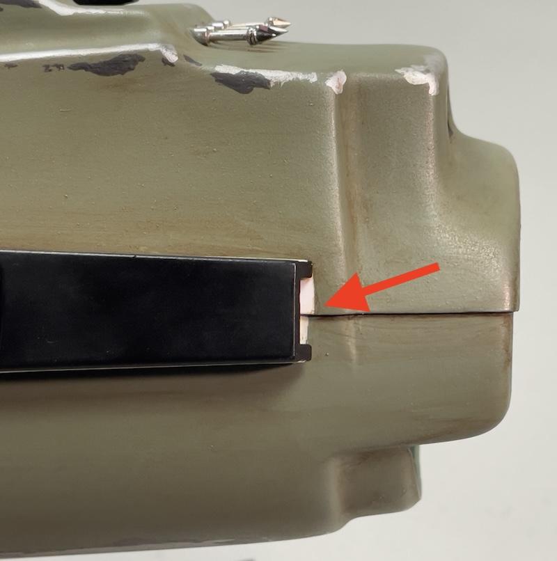

I took everything off the left gauntlet just to make it easier, but I kept most parts on for the right. This was to try to replicate some of the masking errors on the original.

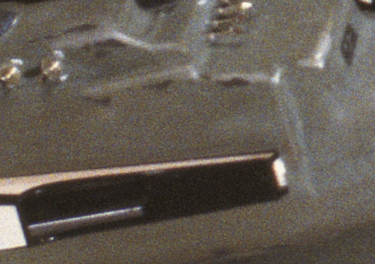

for instance, below, masking off the whipcord housing with good old fashioned Scotch masking tape, I intended to get that white spot at the tip which I was not even aware of the first time I did my ESB gauntlets...
And this was the result, as expected. It's not rocket science.

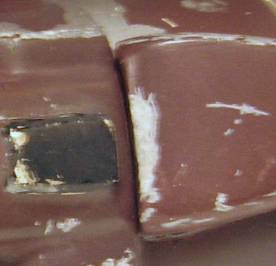

from reference:

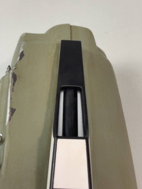

There are other various details like this elsewhere. Nothing big.

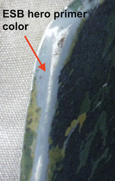

And also, masking the whipcord like this keeps the inside around the stylus brush rod nice and supertrooper white as well...
Notice the white is a different tone than the white on the whipcord. The whipcord white is warmer... that's from the dark brown wash which you slather on the whole gauntlet except that recess inside the whipcord because you can't reach it when trying to get this prop finished in time to get it to the production stage by 7am the next morning and you really don't even care.

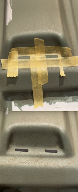

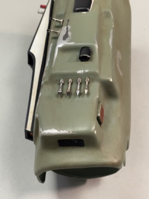

these marks around the switches on the right gauntlet were something else I missed on my first set of gauntlets.
I could be wrong but I came to the conclusion they are not silver paint, they're too bright, but tool marks where the paint has been scraped down to the plastic, presumably with a tool that tightened the nuts on the switches into place. So I made similar marks by scraping away the paint.

from reference:
