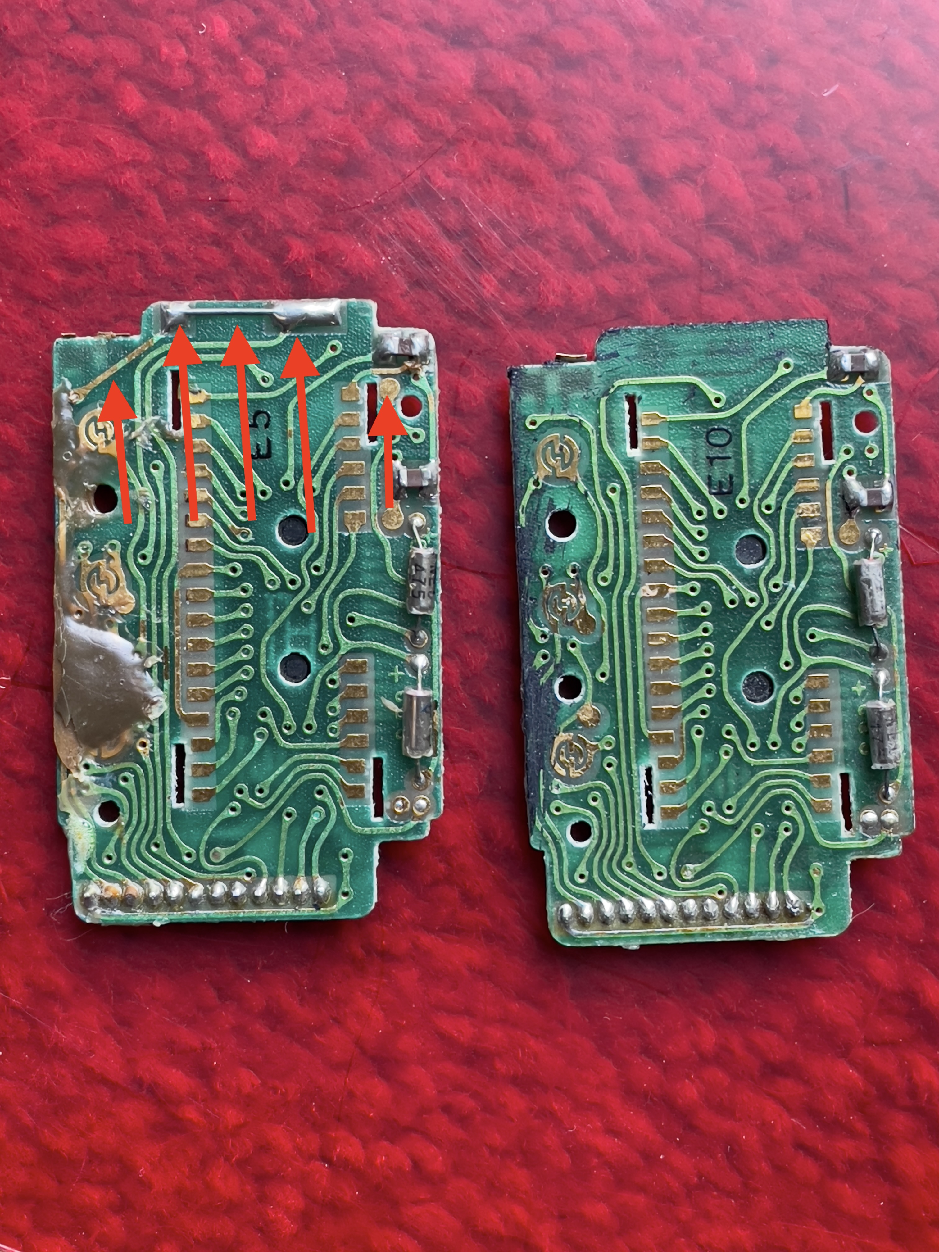

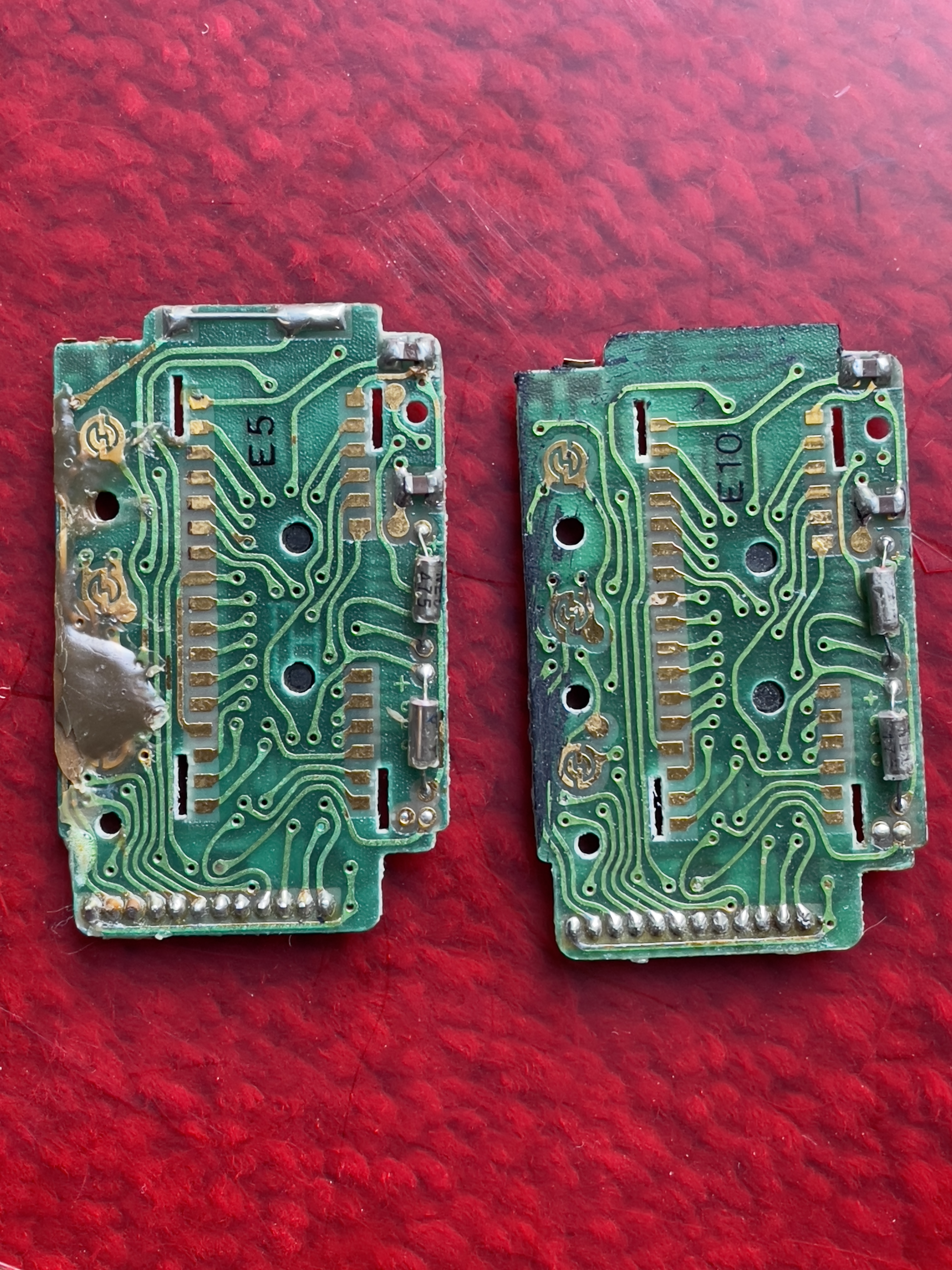

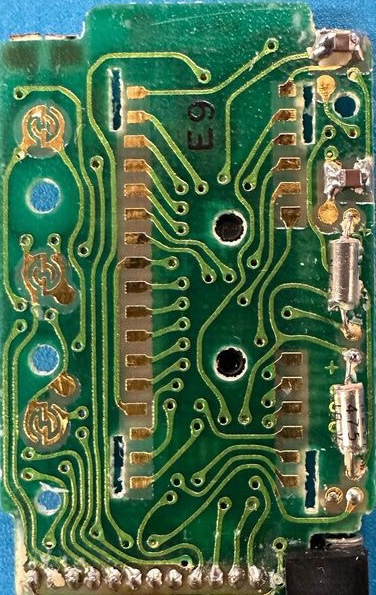

I'm still in a holding pattern on this build while I wrap up my PP2 build, except I'm prepping a new helmet. And while I was doing that I made an observation about the MQ-1 board I've not seen discussed before. Apparently there are variants. Disclaimer: the following is for research and archeological value. It's not intended to piss everyone off about found parts which are already enough of a pain in the butt as it is.
Below are two boards. They have slightly different layouts (ignore the brown gunk on the left side of the left one). Both of these are incorrect compared to what is in the ESB helmet.
Christmas colors. Merry Christmas!

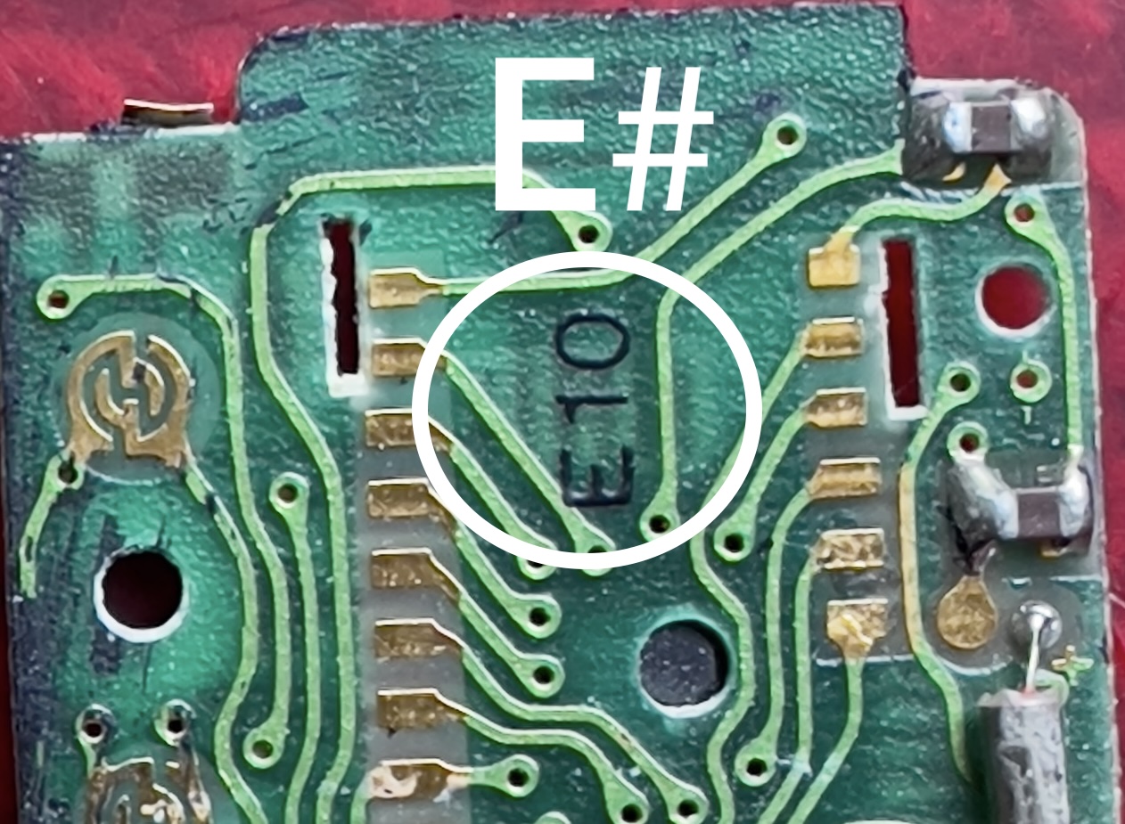

The boards have different E#'s. I believe this designates different 'editions' or something of that nature. So different E numbers should have minor differences. The board in the ESB helmet is hard to read the E number because there is too much old adhesive gunk over it in the available pictures.
The two boards pictured are E5 and E10. The one in the ESB helmet is most like the E10 but retains one of the E5 elements. The element on the far right with the red arrow (a gold disc next to the hole) is present on the original board but not the others.

Below is an E6 owned by Deancfh. It's a physical match for what is in the ESB helmet from what I can tell. It doesn't have the extra components at the top but retains the gold disc next to the upper right side hole. It's possible E7, 8, and 9 also look like this. If you have any of those numbers on your board please post pics of them here.

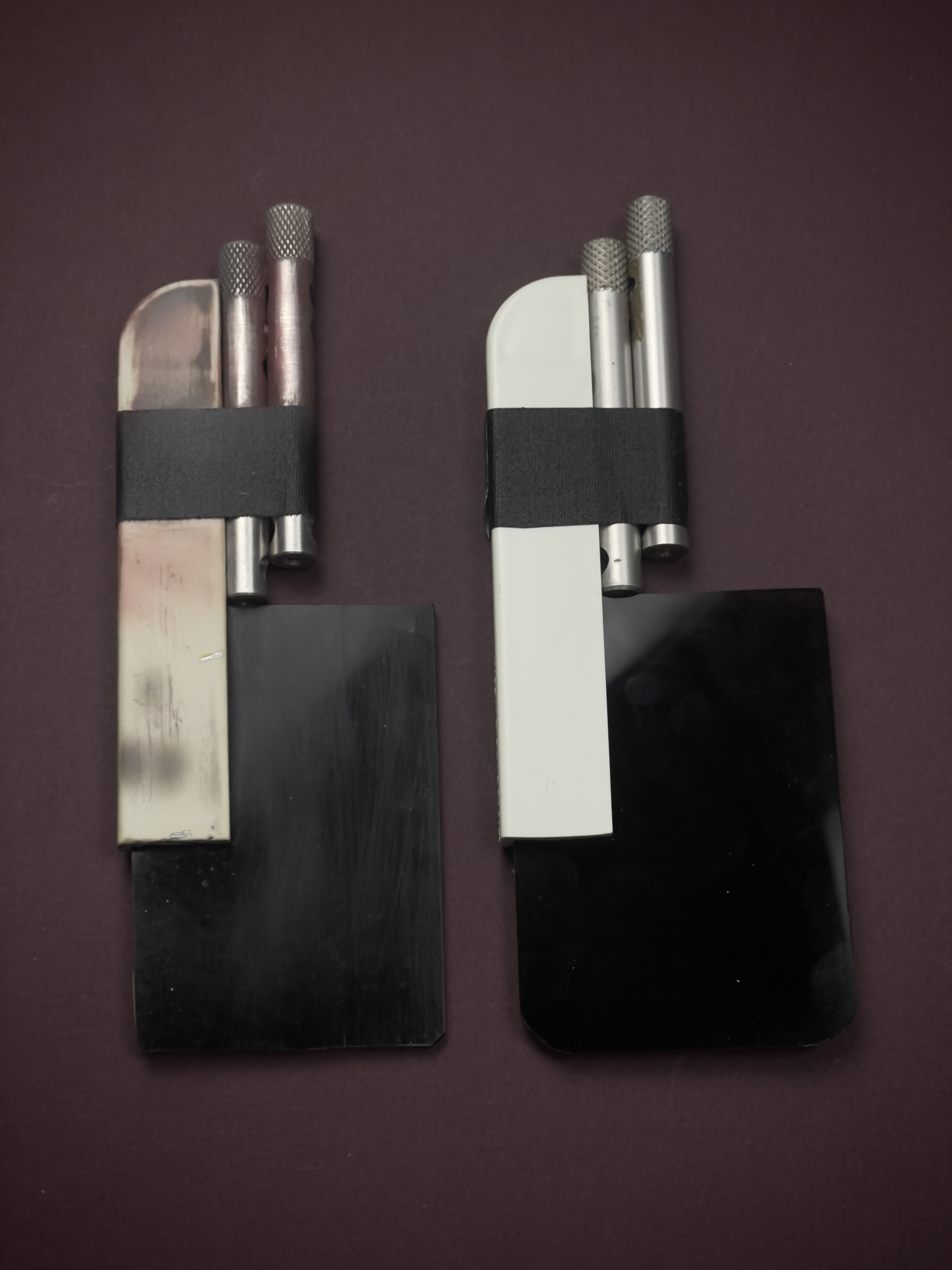

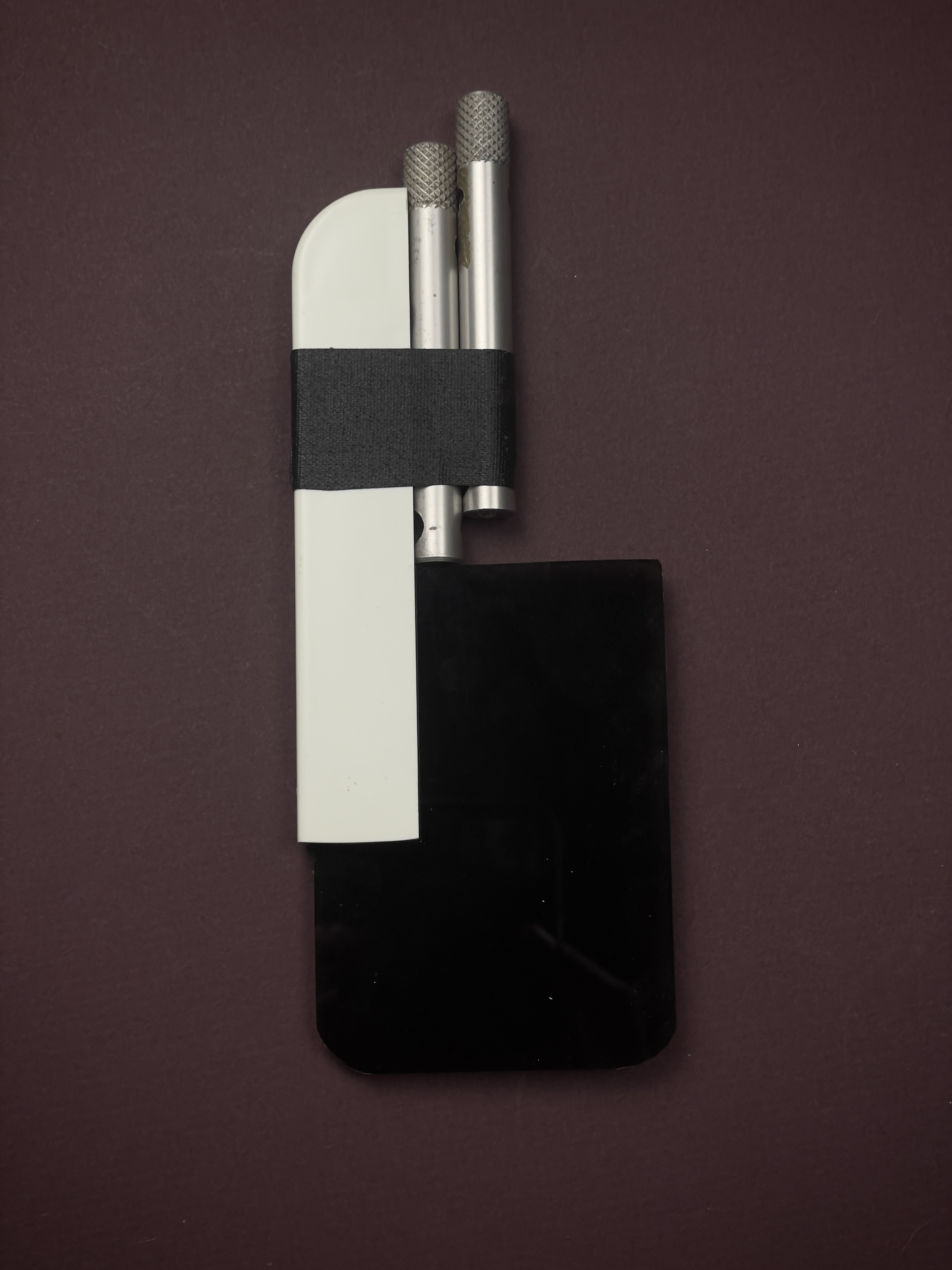

Continuing to be in a holding pattern waiting on a few items, but I realized I could actually go ahead and re-do the 3rd shin tool (the one with the pair of stylus brushes on it). I've forgotten the fictional name given to it. Is it the vibroblade? (edit: Anti-Security Blade) Whatever it's called, it's the shin tool in the left shin inboard pocket on ESB.
I'm re-doing all my shin tools. I think this will be the third time in this build. Maybe the last! If I don't screw it up. I acquired vintage correct Paterson parts some time ago as well as a second real stylus brush and held off doing the vibroblade tool because I was thinking of getting a friend to tap the second hole in the stylus brush rod for me.
But he couldn't do it right away so I sat waiting for a while. Then I changed my mind. I got worried about damaging the stylus brush, a very rare found part, or worse. I decided to just assemble it without the extra hole and screw. If I change my mind again later its not a problem to add the extra hole whenever I want.

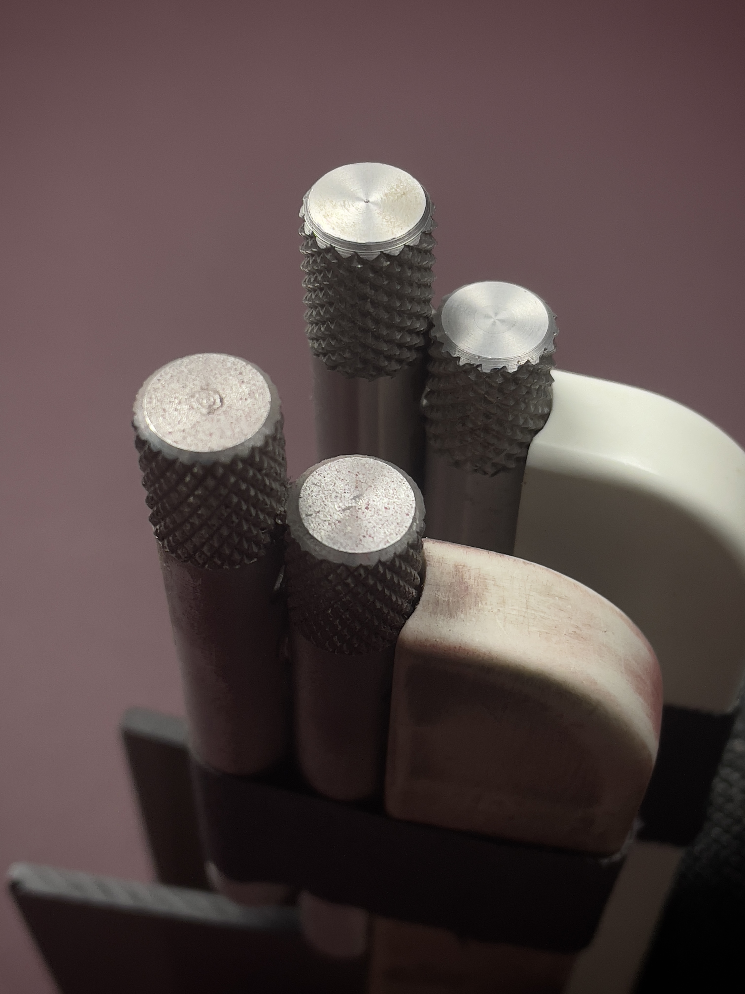

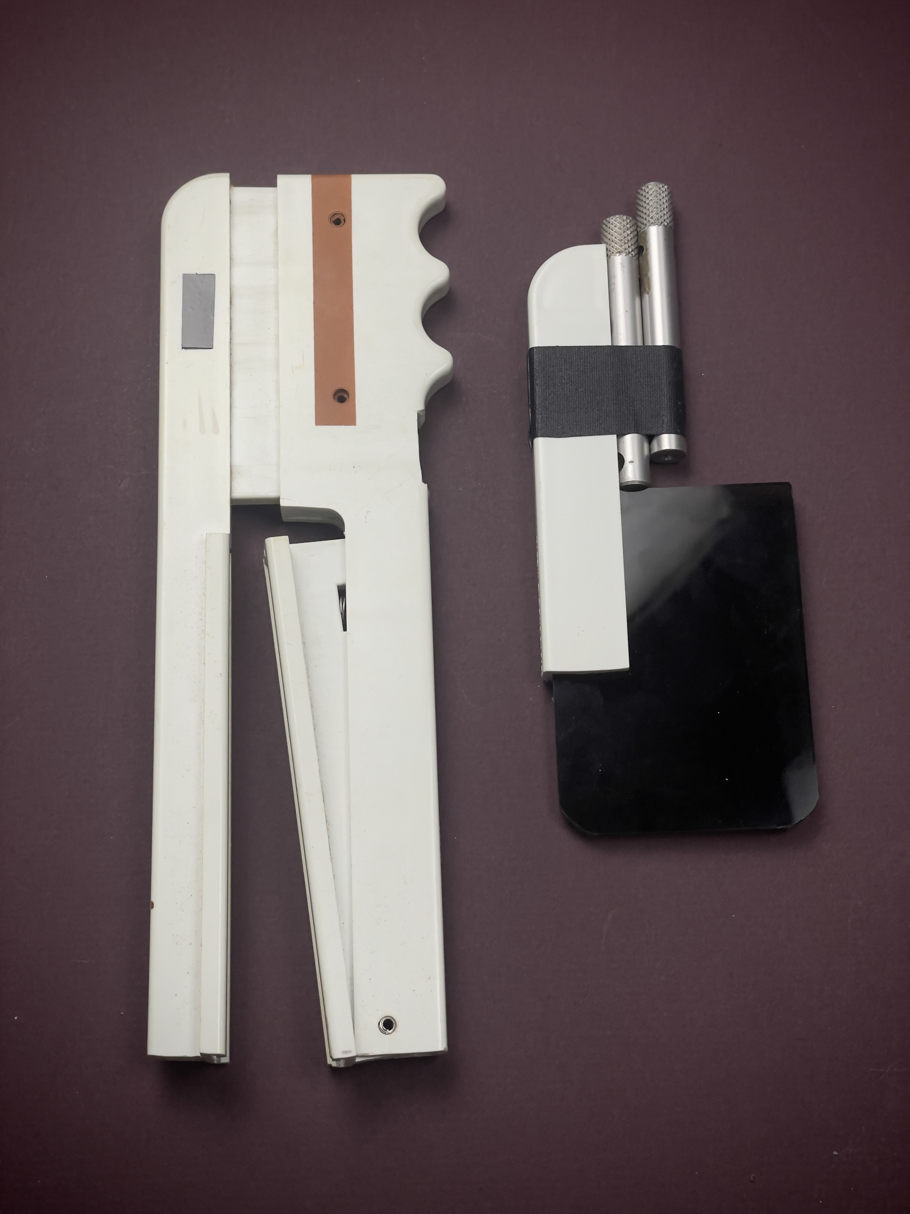

As before, these are the parts, this time with all correct vintage pieces, the correct vintage Paterson squeegee model, and two vintage stylus brush rods.
Was it gaffer tape or electrical tape? Maybe different ones had different tape. Only the gods of Fett can tell us 100% for certain. Unfortunately I am only a mere mortal. The shim is there because the gap in the squeegee cutoff is 5mm wide, while the smoked visor plexiglass material is 3mm, so a 2mm shim helps make a solid insert for the plexiglass. That's how they did the originals, too.
I'm using RafalFett's dimensions for the smoked visor piece.

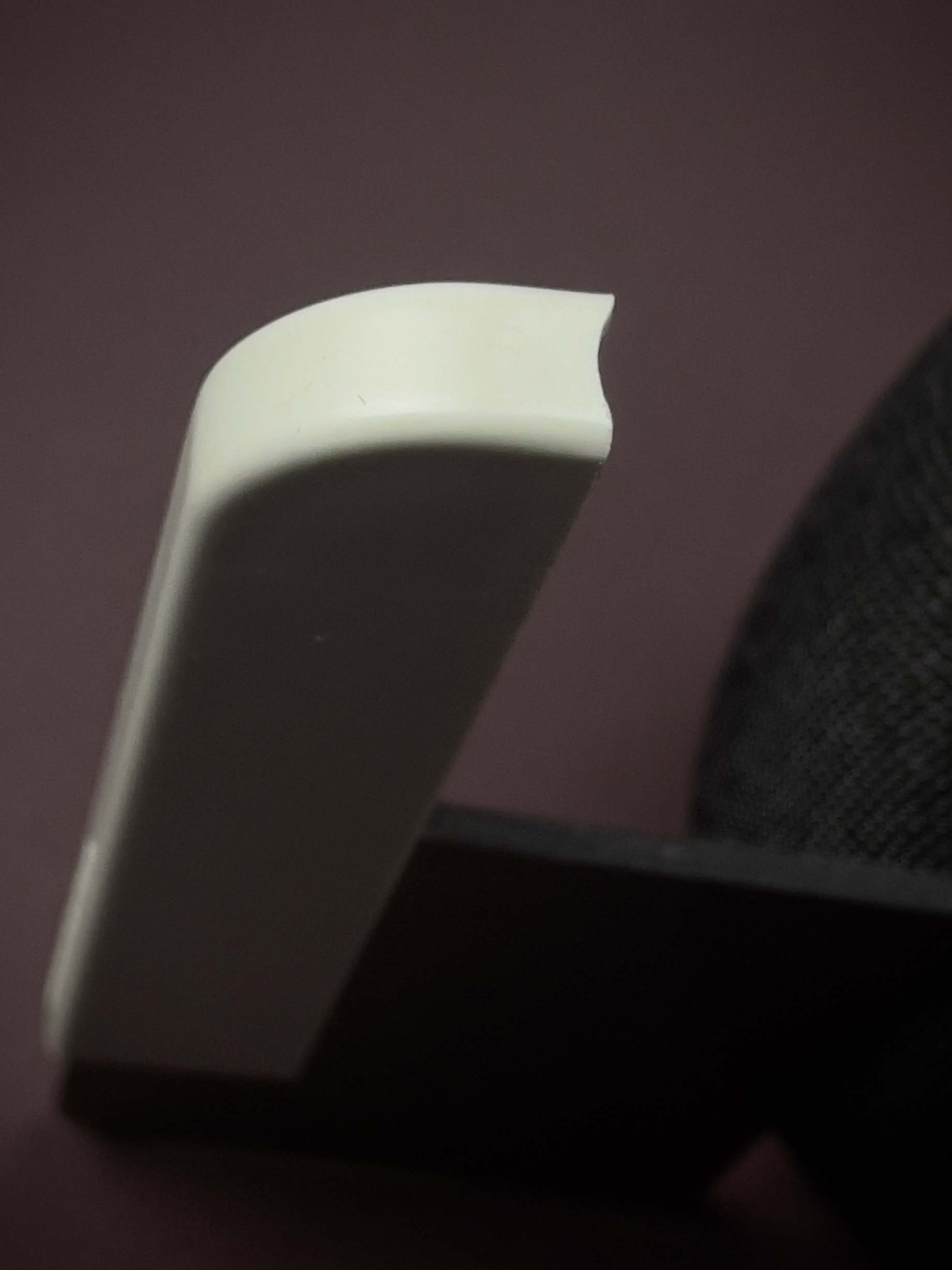

One little detail to be mindful about is making a notch in the squeegee arm at the top end so the top of the rod can sit inside it a little. This allows the body of the rod to sit flush against the edge of the squeegee arm.
I'm not sure it matters as much with the replica stylus brush rods since the knurling on those tend to be a bit on the shallow side.
This is the assembly without screw in the top. The tape is the only thing holding the rods on. As long as the tape is taut it seems to be fine.
The assembled ESB next to my weathered PP2 version:
Our references for ESB don't really show the weathering on this very well. In fact it mostly looks unweathered. I might hit it with some light weathering that it would've gotten while in the shin pocket when the suit pant legs were getting weathered.
More comparison with the PP2, which has replica stylus brush rods made by Mojo Fett :
Here it is with the unweathered vintage squeegee:

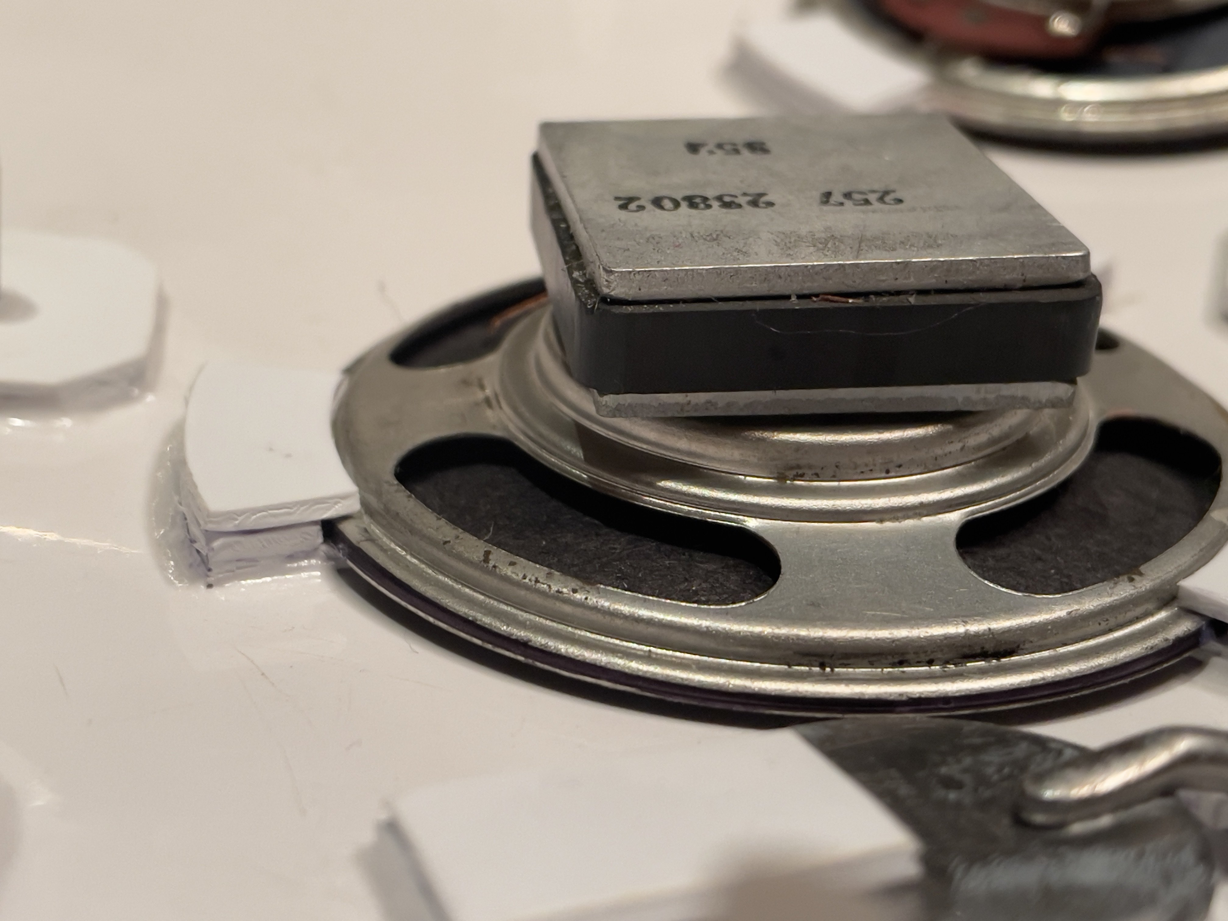

Sometimes waiting for parts is the biggest battle of a build. I got the parts for the ab plate speakers a year ago but they are in pergatory, waiting to come back with my helmet, so I got a backup pair instead and decided to just move forward because progress is progress.
I wanted to install the speakers on the backside of the ab plate which we know were on the filming ESB hero because they are still installed as evidenced by their appearance in the exhibits.
Here you can see the magnet portion of the speaker behind the hero ROTJ hero ab, which was the repainted ESB ab:
I did find out on my own research these were manufactured by Wiener Radiowerke, or Vienna Radioworks.
Another exhibit photo reveals how they were secured to the ab plate with plastic tabs and glue, just like everything else.
It's sort of a plastic tab sandwich that holds the lip of the speaker. Here is my imperfect interpretation:
My main reason for installing these is not necessarily uber accuracy for the sake of uber accuracy (this installation is certainly not correct because I've not had a look at the backside of the hero ab -- It's just guesswork), but I wanted these on the ab because the weight and size of these will have a real affect on the vest and how the ab sits on it. These speakers aren't exactly light and I think they'll pull down on the vest and make it stick out a little like we see in some of the references. I'm curious how it will look.

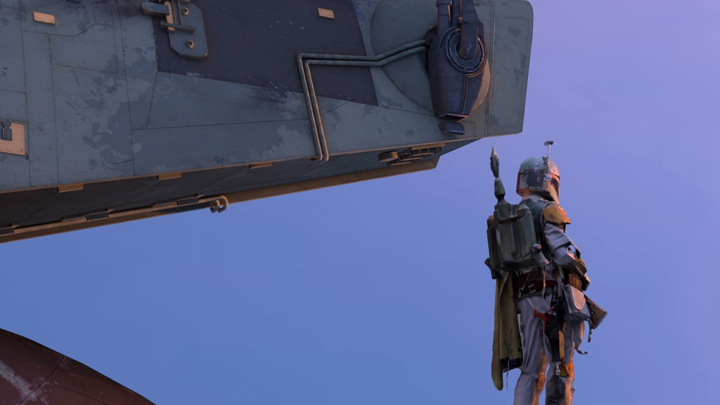

Here is a CG animation of my build on the manny as it was at the end of 2022 with a CG Cloud City.
