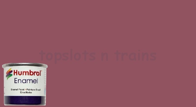

it's just that when I do google Humbrol wine 73, it does look a little purple-pink
this is what i come up with in a quick google search:

Hi, to answer your questions regarding the colour list:
Humbrol wine 73 can sometimes look a little pink, but nothing like the image from your google search! An important step that has to be done with this colour especially, is the buffing with 0000 wire wool. This will deepen the colour hue and avoid any pinkness, this only happened to me once and caused I think by poor spray gun application or mixture.
On the updated colour list, red 60 is there to pick up the bright red details that appear randomly around the mandibles and trim. To me red 60 appears as an additional layer below the red 73.
