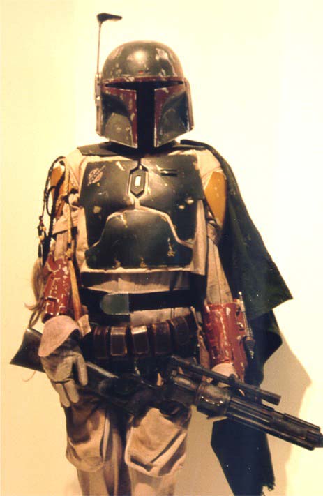

The side pouches were worn on the leather belt at the MoM display,
but the AoSW display had them attached to the girth belt.
MoM/AoSW is a HORRIBLE ref when it comes to how the suit was assembled... Don't believe me? Check out the pic below. Need I say more?
Ankle spats, wrist spats, aren't they all the same? :facepalm
The ESB pouches were definately not worn on the leather belt, but under it. Now whether or not they were attached to the girth belt or to the underside of the leather belt, I don't know. As far as RotJ, I'm still looking for a good, conclusive picture to post.
Agreed BF. I haven't been able to find a TRUE RotJ pic but I can verify that the RotJ:SE setup has the pouches attches the same way the ESb does. The large cargo pouches come out from under the leather pouches...
:lol: Brak's, where do you find this stuff??
:: that pic makes me wanna start work on my F'dUpMOM Fett suit ::
