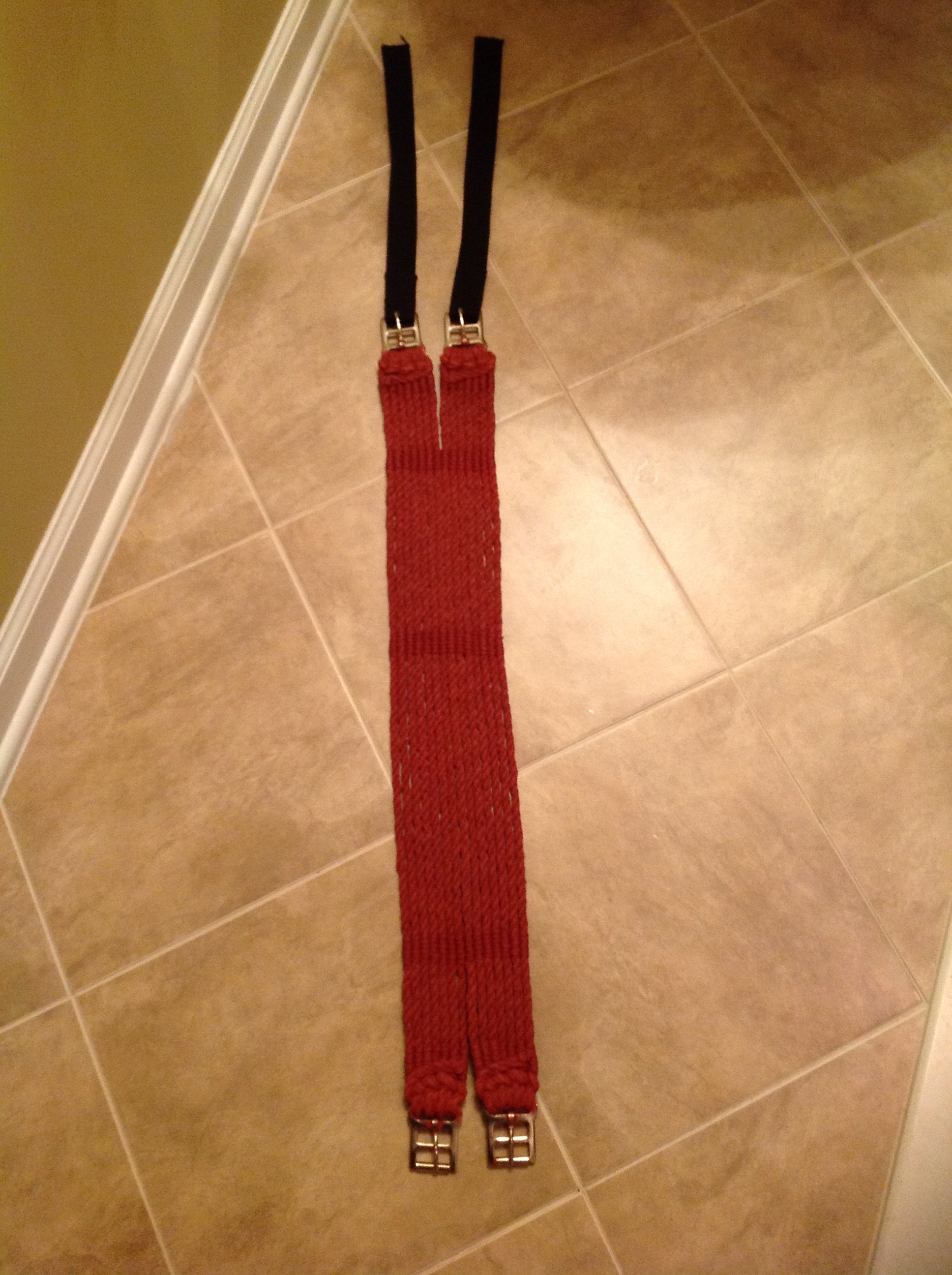

Pics added though red that shows up in photos looks like it has been dragged through dust in person...

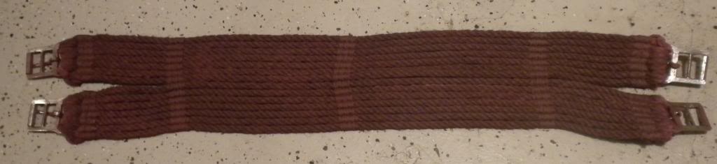

After failing with dyes also I gave this method a try. Still dont know if i got the color down, here's how my ESB version belt come, still need to clean the buckles but what y'all think? In person its more of a rust color with the red undertone but picture makes it seem a light brown.
