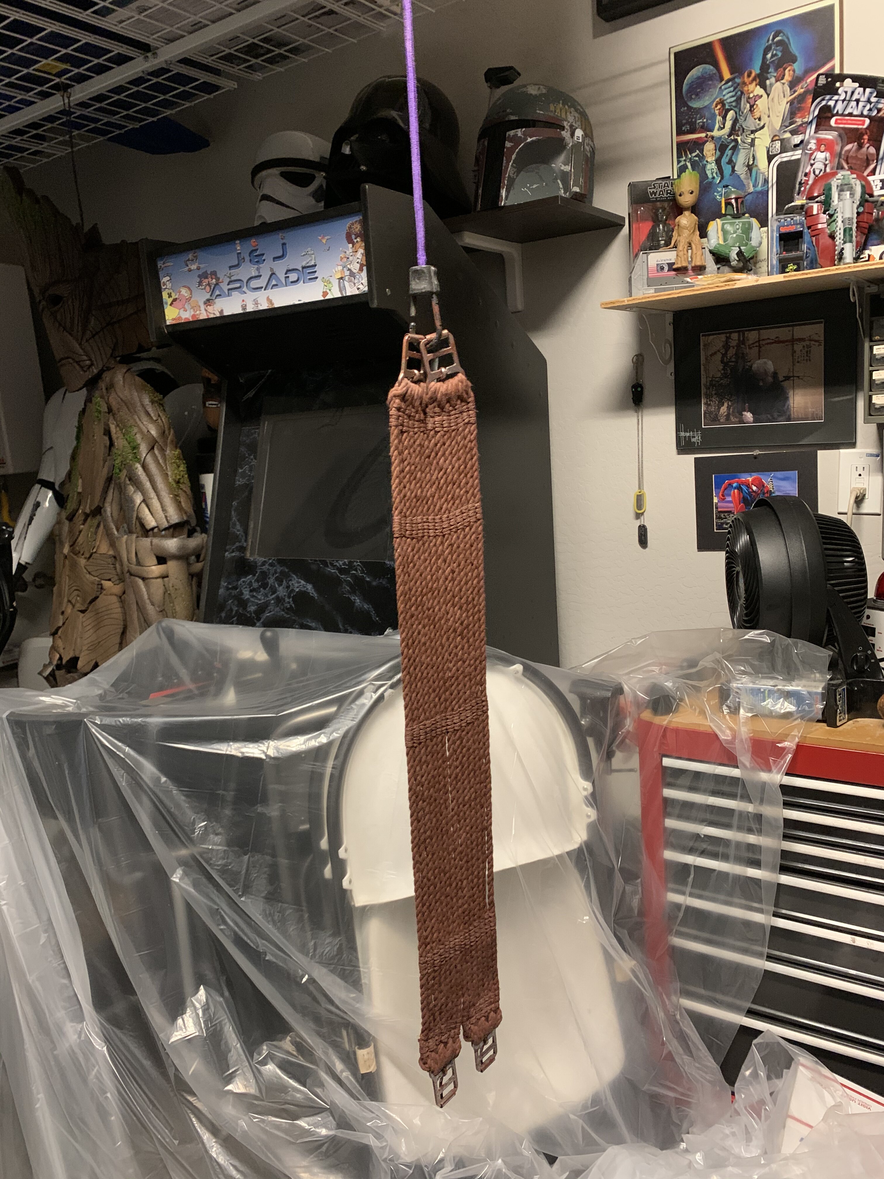

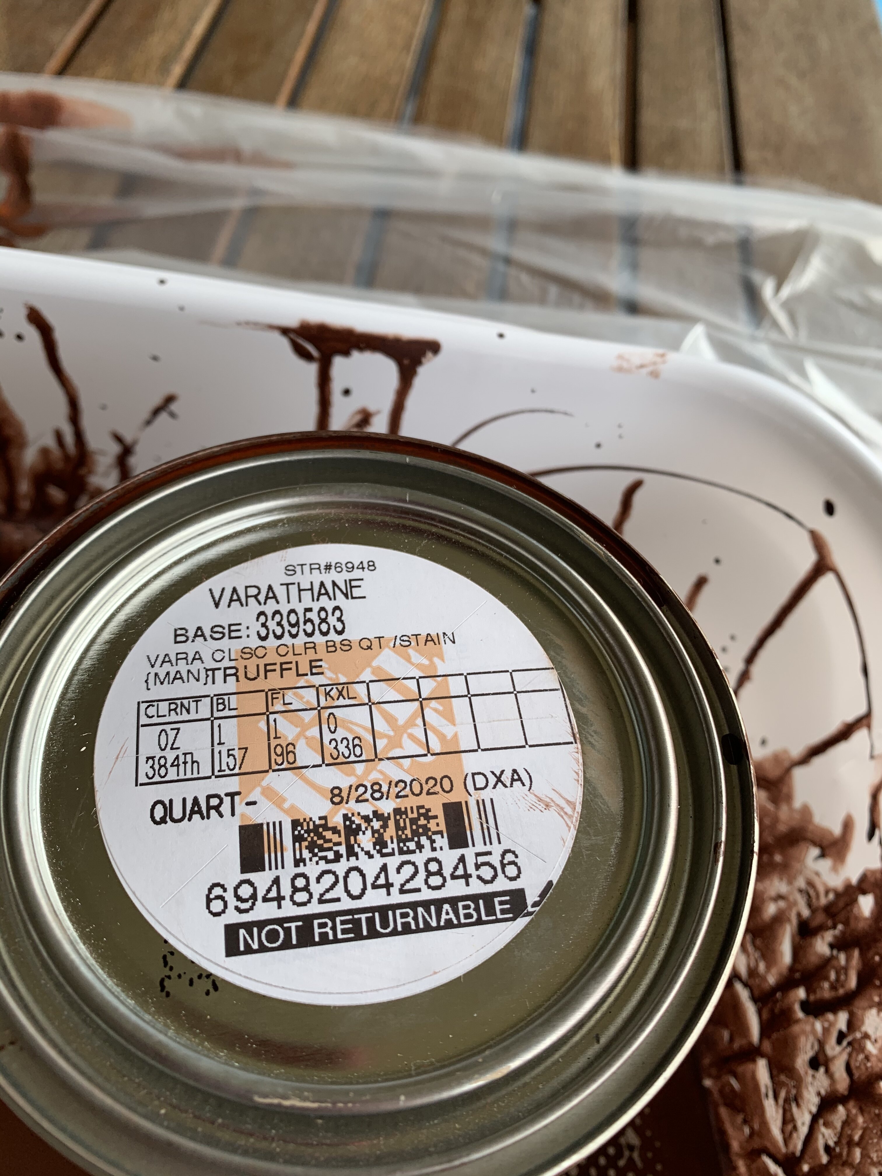

I ordered a girth belt on amazon and gave this a try today. My local Home Depot doesn’t carry Minwax anymore and said the Verathane wood stain is the closest thing. I printed the ESB girth belt pantone color from the CRL and brought it with me to match. Verathane has limited colors and I picked Truffle as the closest and had the paint guy add some extra tint to darken it a bit more. The staining was easy and I used less than 1/2 the can, wrung it out in the paint tray, then hung it up and dabbed it with a rag to remove more of the excess stain. I’ll let it hang dry for 24-48 hours and see how it looks. I saw one recommendation to stain it twice. Any other thoughts on whether or not that is necessary?
Overall, super easy to do and cost me less than $45 for the belt, stain and supplies. Thankful for this tutorial!

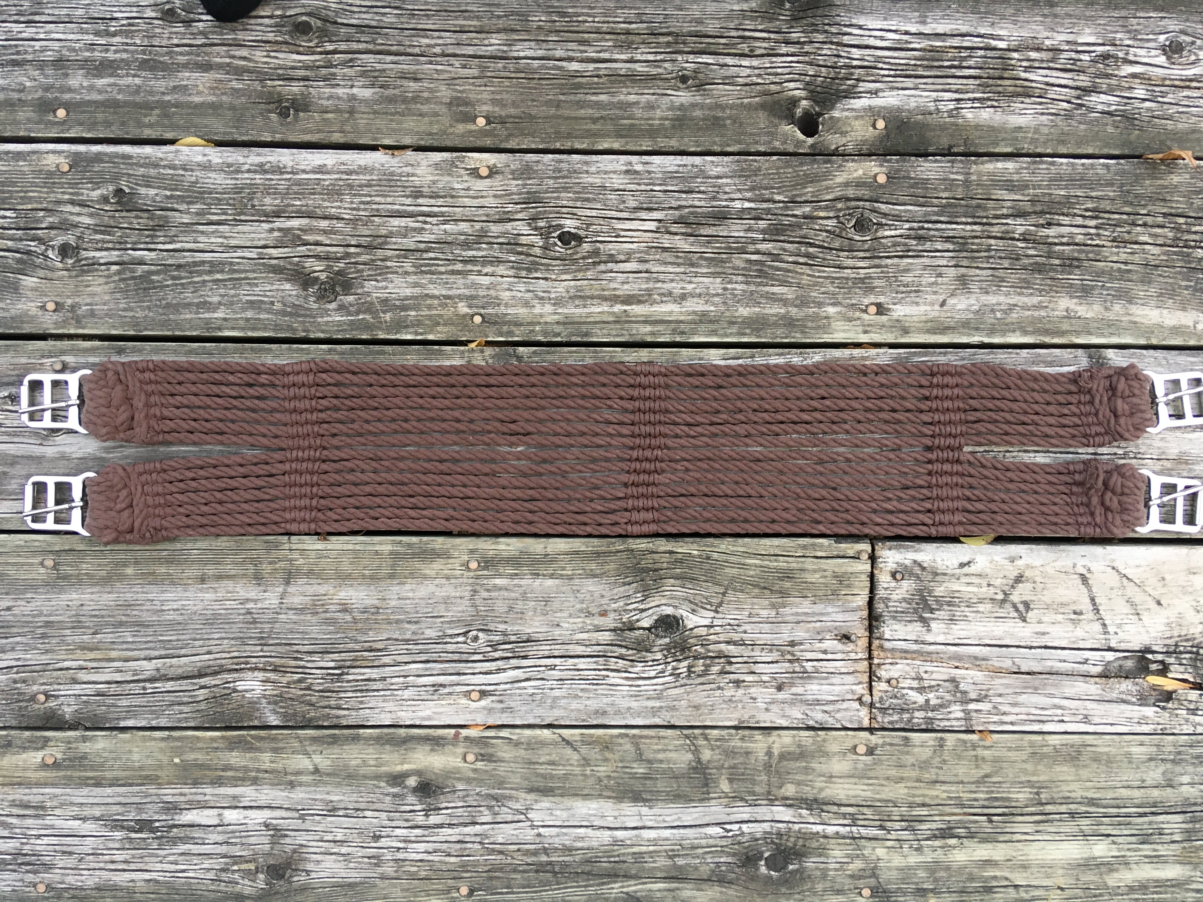

i just did mine a few weeks ago and I stained it twice. After first round i rinsed it until water ran clear. Dyed it again l, let sit another 24 hours and again rinsed until water ran clear and then let dry.
Came out perfect.

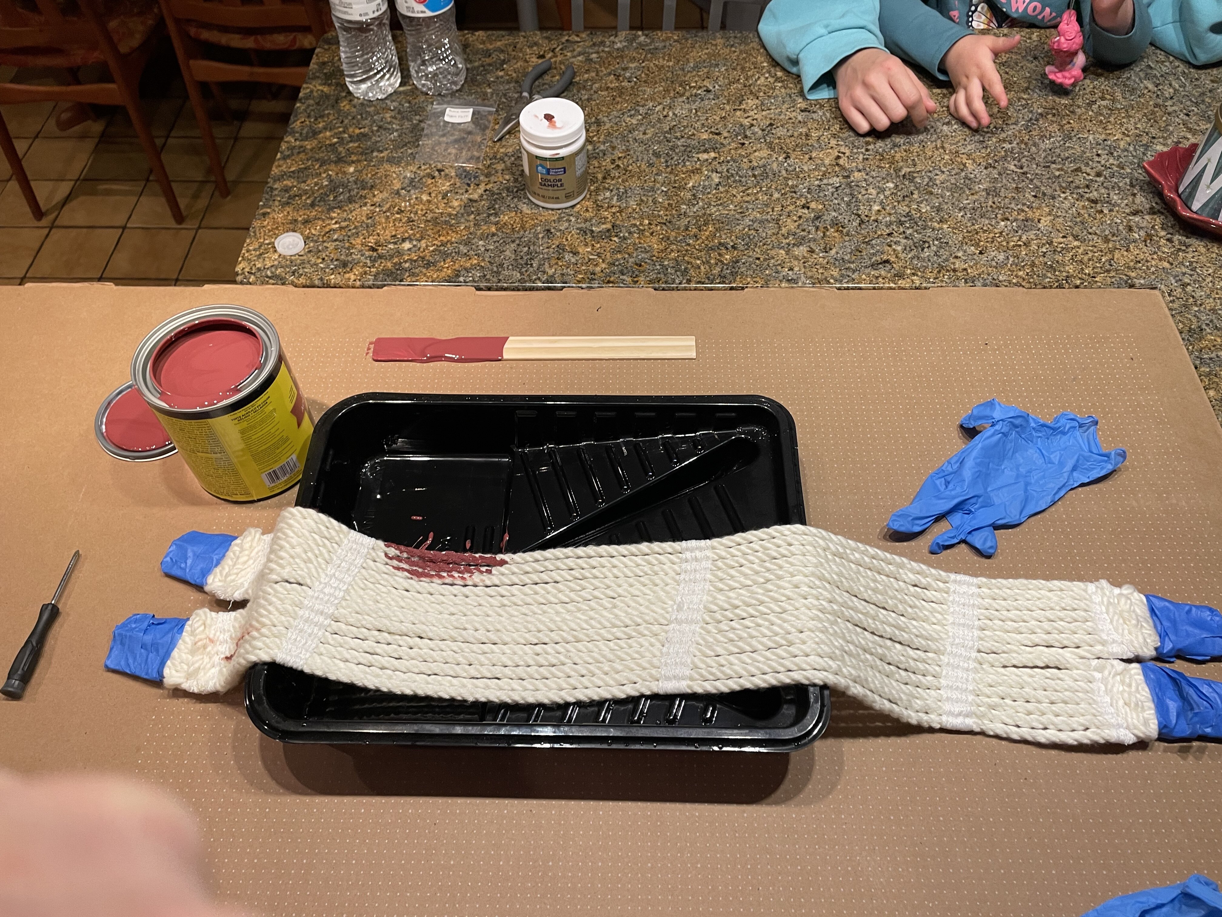

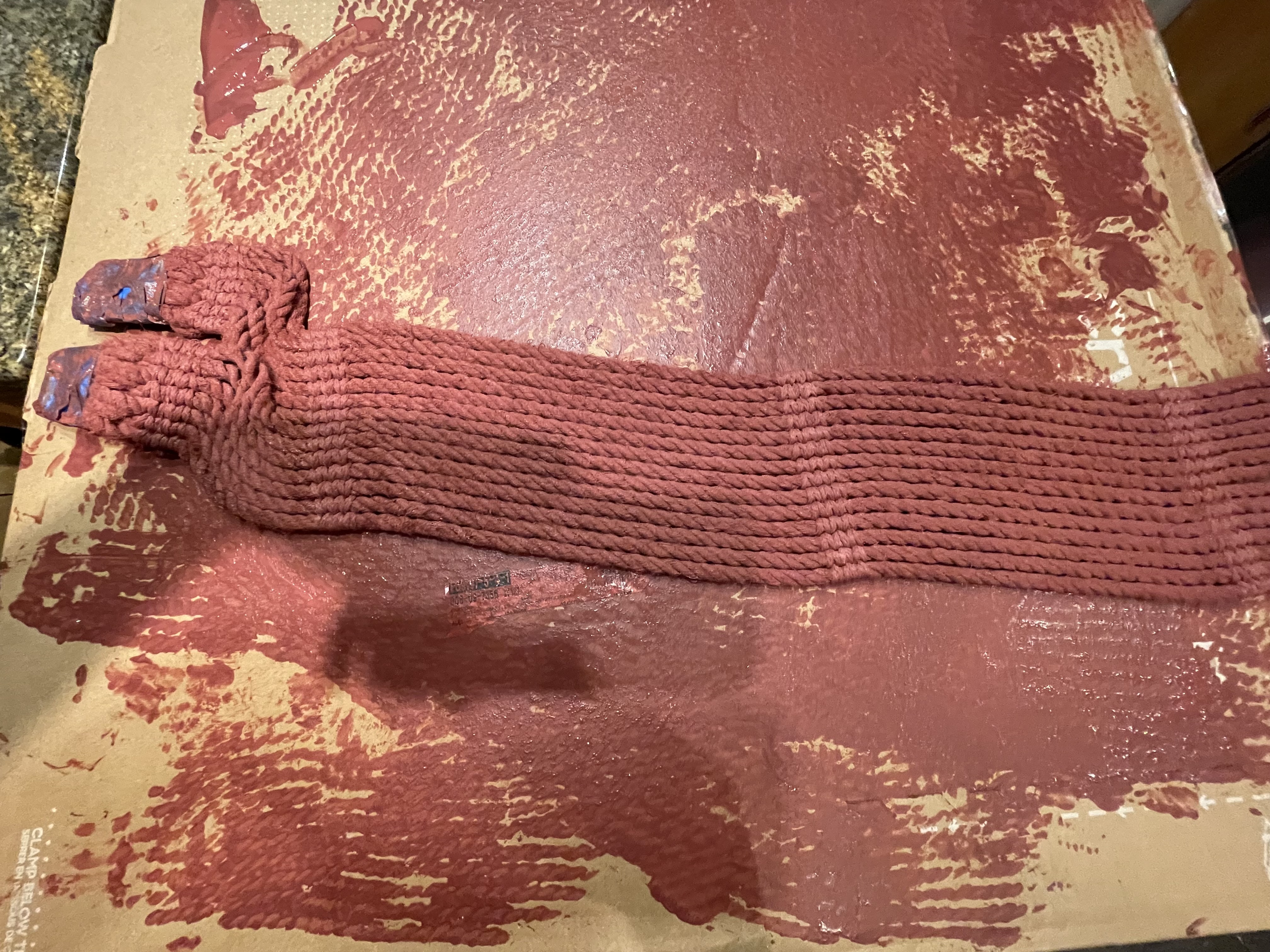

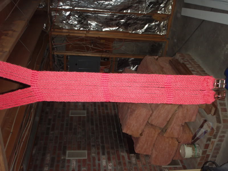

So after trying to dye my girth I finally lost it and went down to my neighborhood paint store. I brought a color so they could match it correctly and bought a LATEX stain to dye it with. It worked amazing and its so much easier and it does'nt rub off on your flightsuit. So heres what I did
First I get my paint roller liner, stain and girth ready to dye.

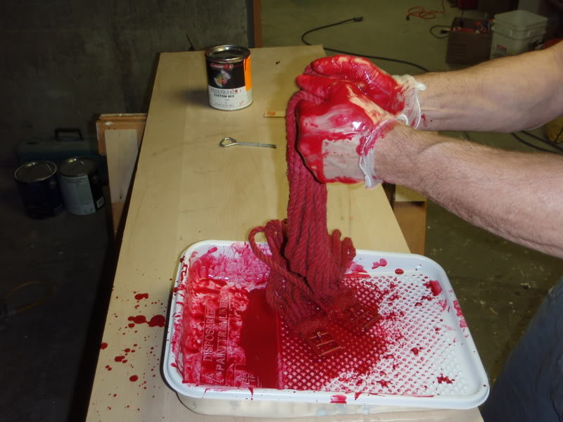

View attachment 86613 Then I pour the stain in the liner and begin to soak the girth untill its obsorbed enough stain so theres no white showing. Make sure you force it in with your fingers and hands.
Then once you have it soaked with stain your gona want to ring out the excess stain so it can dry quicker.

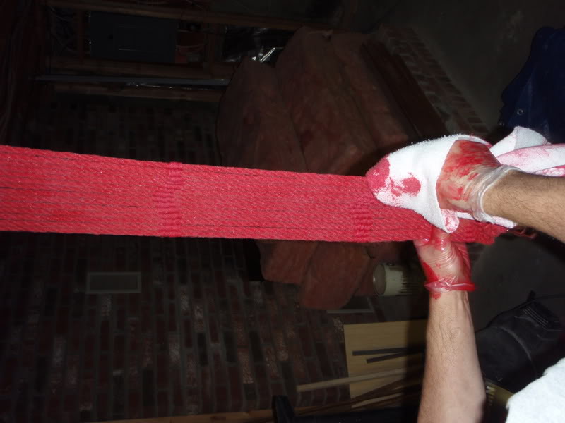

Your going to want to hang it up so it can dry but while its hanging get a rag and blot out as much excess stain as you can. Make sure you don't rub it or it will fray, only blot it. Then when thats done just let it air dry for about 24 to 48 hours and your all set. The key thing is to only get latex stain because all other stains will eat and corrode your girth. A pint of stain costs about thirty bucks but it saves you all the headaches that come along with dyes. A pint will dye two girths so if your doing more then that I suggest to buy a gallon. I have only done this in ROTJ color but they can match any color you like.
