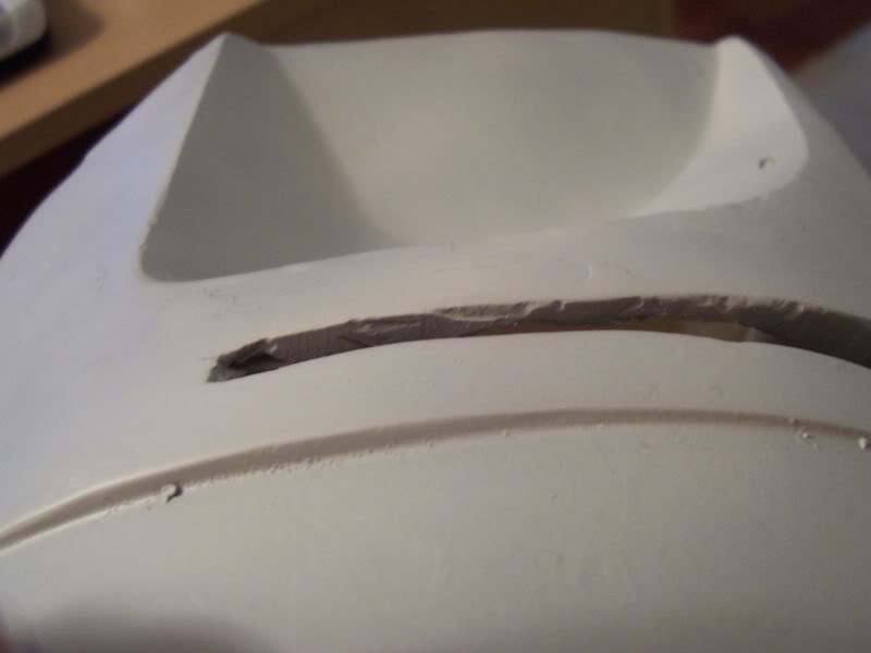

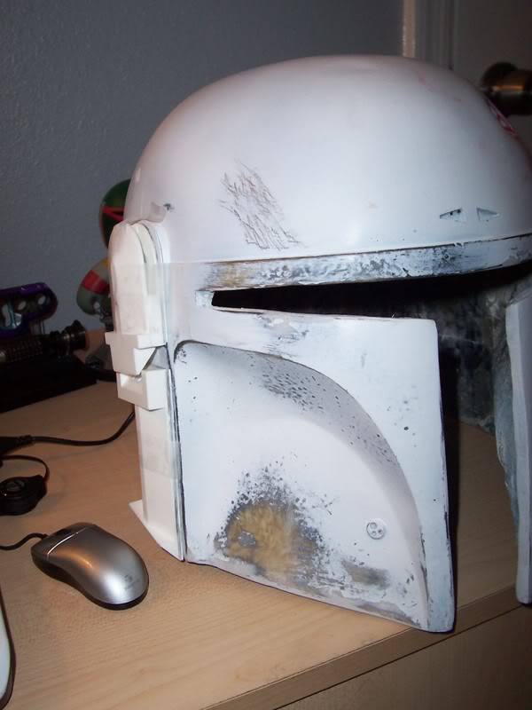

Alright. Im done for the day, I can only take so much of it lol

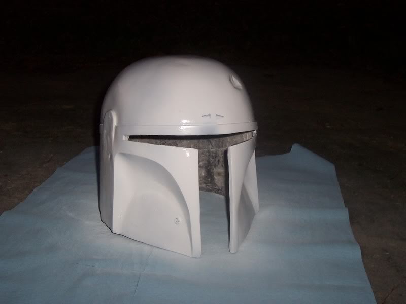

Here it is right now, I used a dremel to reach in and sand off the excess bondo on the inner mandibles. It actually worked out for me in a way; I cut off the fiberglass re-inforcement where the visor is going to sit, so I now have sort of a lowered area to put the visor. for the top inner rim of the visor (where the forehead is) most of that is still too uneven and nasty. So im going to try a technique to get the bondo to stay in place, while making it all even. Im going to cut a strip of styrene plastic so that it run the length of the inner rim, from side to side. Since its uneven, the space between the fiberglass and the plastic should be somewhat open and have gaps. From that, I will apply the bondo to fill in the spaces and then sand it down until all is smooth. Thats the plan of course.
Anyways, here's a pic of it with the primer. Dont be fooled, theres a ton more work needed. I can never seem to spray an even coat of primer onto anything...

Looks like you got a good hard days work in there!
It's looking very nice!

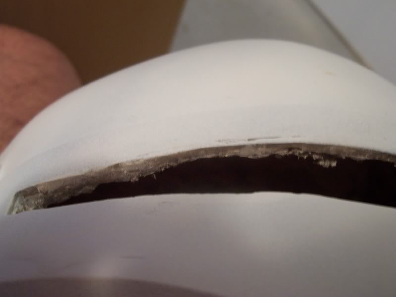

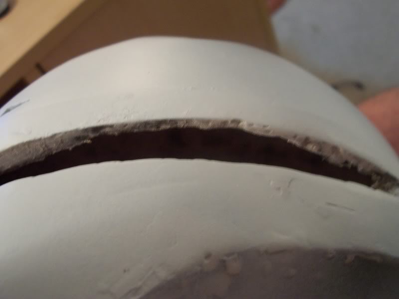

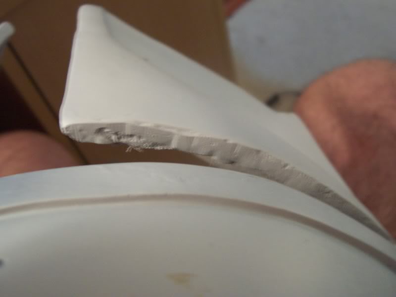

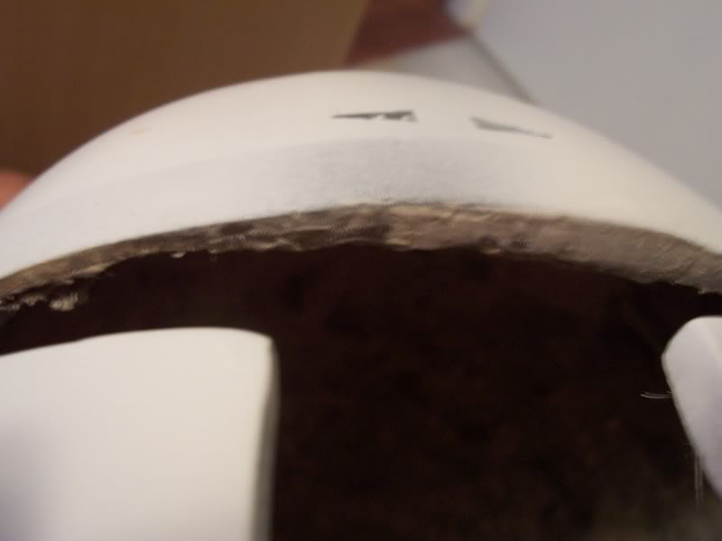

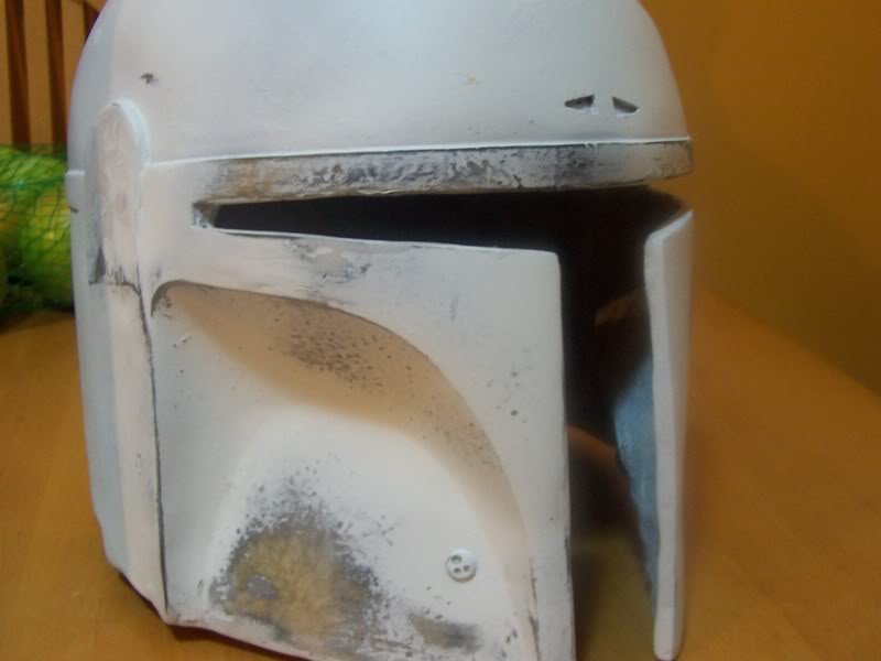

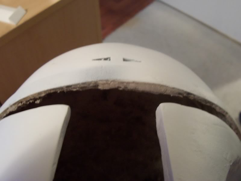

Anyways, the primer just finished drying for the most part. Its revealing aloooooooot of problem areas on the surface. there are alot of little bumps and whatnot that I need to sand off. The dome is another issue, there are several dips in it, and I need to fill with bondo and sand, so that I can get the dome somewhat more round then it is now.
Alot more work is going to be needed. Gimme a sec, and I'll post the visor pics for you
Nice pictures, my friend!
Looks like it will be good to go after a bit of sanding!
Not to be picky, but I was hoping for a picture of the inside, on the vertical section of the mandibles? Where the actual visor will sit? :)
looking good! great attitude too mate. I had a similar time with mine when some epoxy putty didn't set, must have been a bad batch. An absolute swine to scrape out and clean up -but hey, keep on trucking!

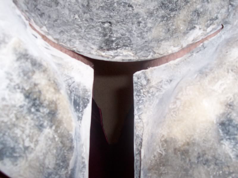

Thanks for the pic of the inside of the bucket!
Doesn't look too bad! Looks like you won't have too hard a time prepping it for the visor, eh?
As you can see from the pic I posted, I'm going to have to buy a BIG file, lol.

Anyways, the primer is there now, not looking as ugly as before. Im going to be going out of town on thursday, got an "field training exercise" (FTX) but its going to be more of a little vacation, going to ft stewart (my like 5th time there), flying out on shinooks, do some tank/bradley sims, and then get to wander around downtown savanah. So yea, a mini-vaction to me lol
Back on track, Im going to do some more surface sanding tonight, nothing major, but I really want to clean up the outer surface a bit.

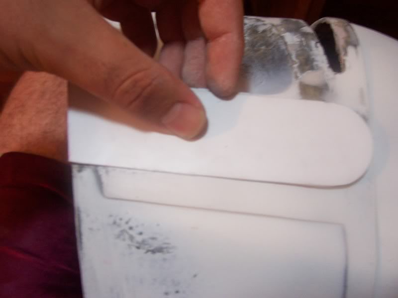

Now, the next thing I decided to do, was try to help the ears sit better on the helmet. I studied the FPH for awhile, to see what I can do, to make it more accurate, that is, while still trying to make it usable lol.
I used the FHP as reference for 2 reasons:
1) its a (insert 4 letter word, including "ing") awsome helmet
2)I have a set of the FP ear's
So taking what I see in the pictures, where the ears sit on the sides, are actually elevated areas in the same shape of the earpiece. So what Im doing, is tracing the ears that will actually touch the helmet, onto some styrene sheets ive been using for my DT jump jet pack. That way, I can attach the strips to the sides, whit its still thin enough to not stick it out awkwardly, I can also smoothly attach the ears with out the need for more bondo. It will also bring out some of the lost details at the bottoms of the ears, where you have the angled sections, as well as slightly extend the sides to help shape the walls when its attached.
Will post in a bit
Okay, well just finished. Its not 100% perfect, but it will, or at least should work.
I didnt take a pic of it, but the RF side, the top portion is still extends somewhat out, where the curved portion is. What I think im going to do, is attach it where I want to, and just fill it in with some bondo, and basically sculpt/sand off the excess to make it even and look right.

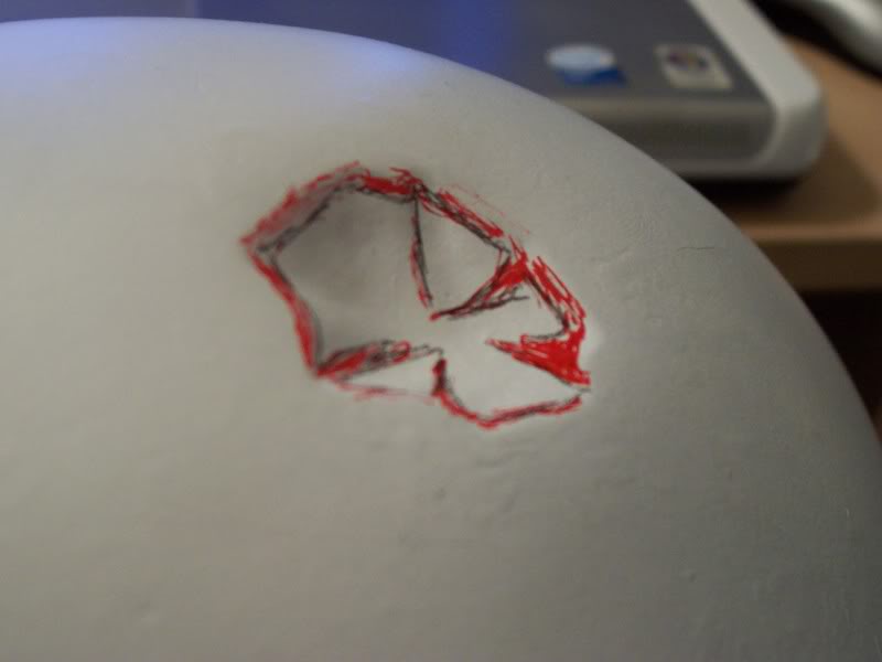

Now, I havent been gettting high off the fiberglass fumes or anything, but when I applied the primer, something *appeared* to me while inspecting it's surface. Im either going totally nutz, but....I can see what appears to be the "cat" scratch where its sopposed to be if you painted it. I didnt sand it in the hopes I can get a decent pic of it though. Its not so obviously clear, but its sort of a physcial detail more then just a visual. You would just have to look at it at certain angles, and you can see the shadows, which it is clearly an elevated portion...Anyways, back to reality, here are some *pics*

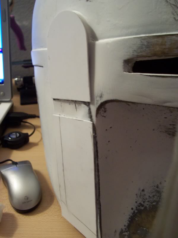

Well I ended up having a busier day then I thought, but was able to attached the sytrene "risers," which imitate how the FPH has molded onto it. Everything appears to fit fine, except for the top RF ears Just need to fill that area with bondo, sand and sculpt it until its in the appropriate shape. The other ears fit perfectly fine with it. The only thing that I really need to do, is yes, more bondo, to go around the edges to make it appear as part of the helmet. Another good thing, is that at the bottom, where the rim is, the risers act as a guide for the future bondoing, so that I can cut it off evenly.
The top RF ears in the pics are a little loose, only had regular clear tape to mock it up.
Here, you can see the whole area I need to fill with the bondo
