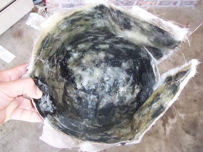

Ok, well it turned out just as I thought it would. The newer cloth is sooooo much better to work with and I think looks cleaner in the end, over the matt. All the area's, minus the keyslot area is covered and Im just waiting for it to cure and the re-inforcement should be done. I'll try to start the massive bondoing that it will need. I think Im going to spray primer over it too before that, just because Im kinda sick of looking at all the scratches/nastiness on it, as well as clearly point out the problem areas.
Oh yea, Im going to get the gel-coat stuff in a can from west-marine so that I can coat the inside, and keep myself from getting cut up.
You can see one side is the newer cloth, the rest is the matt.

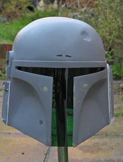

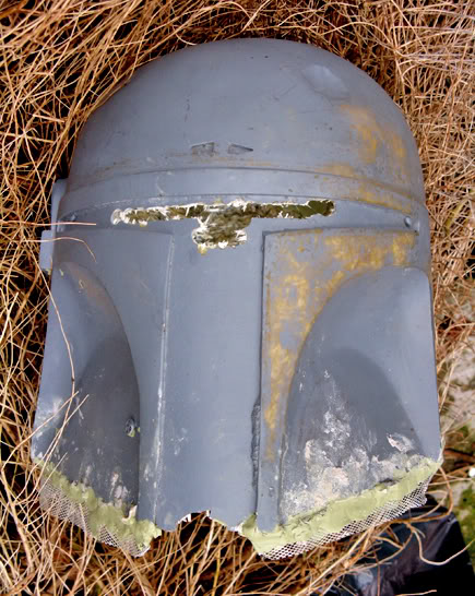

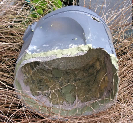

Hey mate, here's the shots of my ugly bucket with the rim during/after repair. It's kind of reassuring knowing someone else is scratchin' their noggin over similar problems around the same time as me!

Its cool to keep up with your progress, looks like its coming on nicely! I was going to FG the inside, but like you said previously its so messy I couldn't handle evrything in the garage sticking to my gloves and immovable fibres on the driveway which happened last time I experimented. So i just epoxy puttied it, with some body filler too.
I'm sure its been said many times about Fett but it really tickles me how much work you can put into a piece of **** just to getting it look like... a piece of **** :D I guess its just a very particular and charming piece of ****.
Which version Fett are you doing btw?

It takes a lot of guts to tackle a wasted bucket like this dude! And a lot of craftmanship, which you obviously do not seem to lack! Great stuff! :thumbsup: More pics please!!

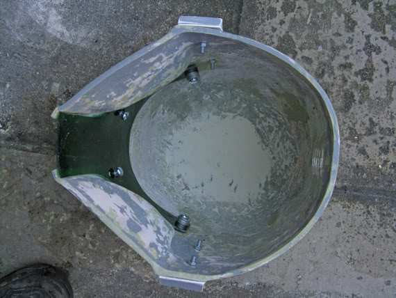

Well I just start a little more clean up of the visor area. Using files and such, I began grinding down the excess fiberglass and pieces that shouldnt be there. Its not 100% clean, but its ALOT better then it has looked. I trimmed the extra FG from my -re-inforcement, and left a little sticking out of the rim so that I have a "wall" to form the bondo onto.
Some areas, like the inside, top portion and bottom parts of the mandibles are partialy hollow, as I said before, some areas are either just too thick or too thin.

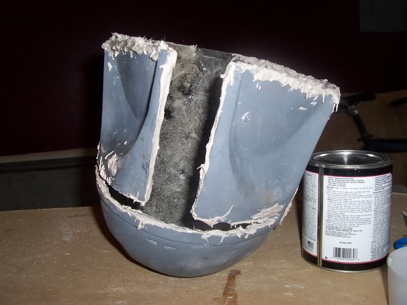

This thing just gained another pound or two.....
Anyways, its pretty self-explanatory, I applied the bondo to where I could right now, I was frantically rushing because it starts to set pretty quickly. I also choped off the ear that was already attached to it. Turns out that it was just one giant piece of solid fiberglass resin, nothing else. So I bondo'ed that up, and I just need to adjust it so that I can fit the FP ears that I have.

Dude.. is that regular Bondo? Because the standard Bondo I got this week turns dark pink when you mix the hardening paste with it... it's the colour it is in your picture before you add the hardening paste to it.
It won't cure unless you mix the two together.
It might be different stuff than what I got, but the Bondo I bought came with a tube too.

I just bought the auto body filler, its the one with the car on it, and has a reddish color to it. Im starting to think that I may have not added enough hardener to the mix...
I took that pic shortly after adding the bondo

yeah it looks too white. waaaay to white. you might wanna wipe off and try again. :(

Yeah, so you did buy the one that came with the tube of hardener, eh?
That's what I used... it will stay very soft if you didn't add enough. It should be a dark pink (have a look at the terrible job I did on my keyholes on my Budget Bucket thread... that's what it looked like when I used it... it was still curing when I took the picture)
