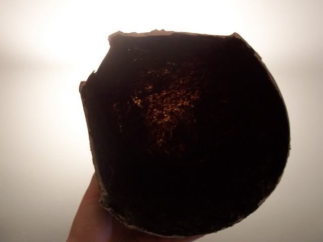

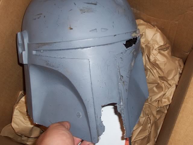

Awhile back, I picked up a recasted mystery helmet from cookiemongoloid here for cheap. I wanted to use it as a possible test prop to learn a little about fiberglassing.

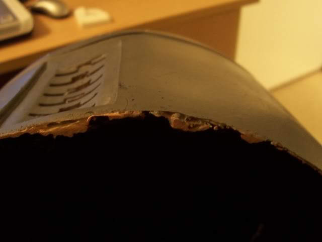

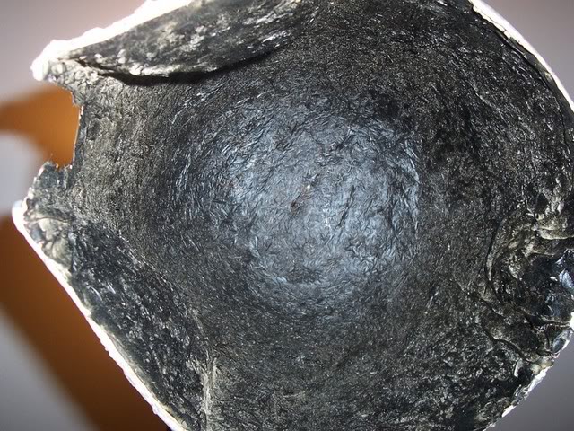

This thing is pretty bad, well, at least the inside, back, and the rim at the bottom is. I honestly dont know how I can turn this thing into even a somewhat decent helmet, but I can see it in my head.
Tonight, I decided to cut what was left of the visor and did a little bit of trimming to get some of the right shape going. Several areas along the visor are either really thin, or really thick. Typical recasted qualities. Since today was my real first attempt at fiberglassing, I did the inside of one cheek that was very bendable, which I worried would break off.
Here's pics from when I first got it, I'll try to get some newer ones in awhile when the resin sets a bit more.
BTW-that is light shinning through it...
-tubachris

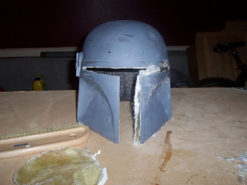

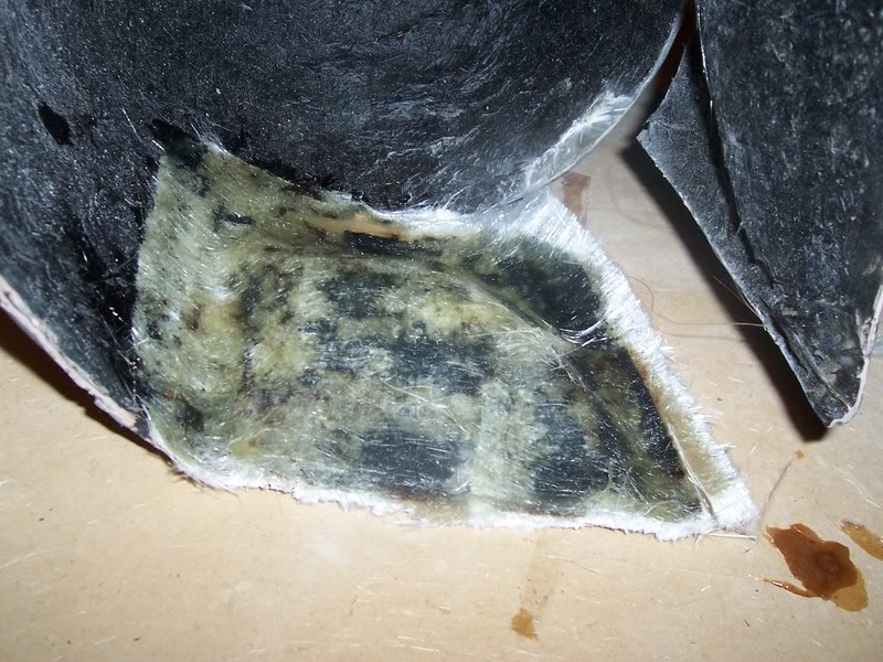

Well here's today's first progress pics. Nothing spectacular, but it was a major step for me, cause like I said, it was really my first try at fiberglassing. I wanted to practice on something, like making a cast of a cup or something disposable, but all i had was a small paper plate. You can see it right next to the helmet lol
Anyways, you can see the visor was cut out and now one cheek inside is re-inforced. Before, it felt like I was able to just snap it off, would actually bend under its own weight..but not anymore!
I still need to learn to do this better. One thing I instantly noticed about this, is how messy it is, especially the fiber matting when your cutting it..So anyways, here it is so far.

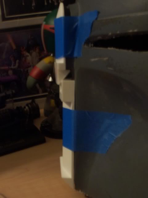

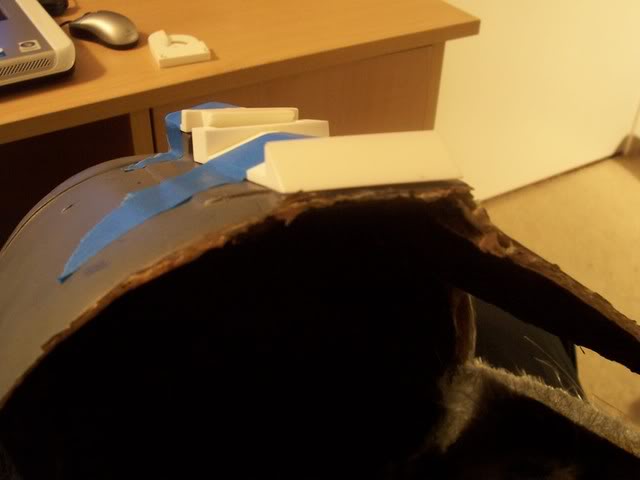

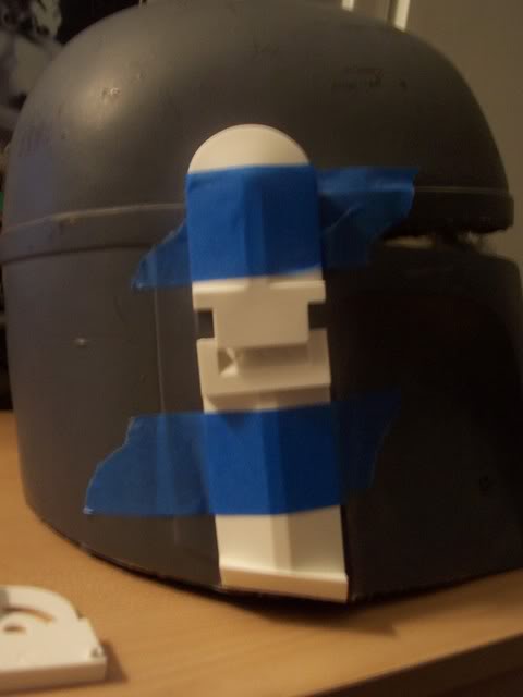

I just recieved the FP earcaps and a flat piece of smoked acrylic (which Im goin to shape to make a visor) today in the mail (Thanks Ripcode!) Im a little concerned though, the earcaps IMO appear that they may just be a tad to large to 'work' with this helmet. The earcaps are amazingly clean casted and sharp and I would love to be able to use these. I just need everyone's opinion on it. Here are some pics:
I think this side just barely makes the cut..
This side is what Im really worried about
I think that this makes the ear's look to big. The helmet already has the innner ear cap casted into it, which I was originally going to chop off anyways and replace with the FP cap. You can see here that the outer RF cap is larger then the piece attached:

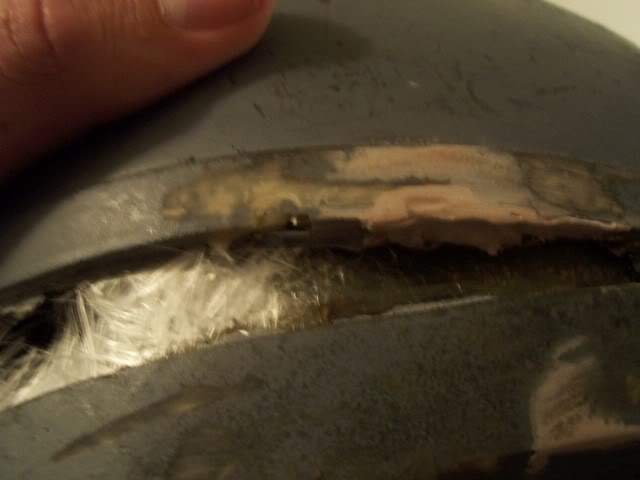

Other then the earcap dilema, I wanted to show the actual problem areas of the helmet, because the general look from the pics above dont show the actual problems that well.
Most of the issue is the helmet rim, most of it is cracked fiberglass resin/bondo, leaving areas really thin and very uneven.

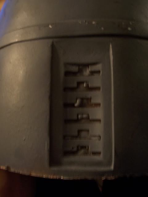

Now here's something thats been really annoying me. The keyslots. From the instant I first held this thing in my hands, the first thing I said, was "these keyslots are horrible," and I still stand by that. Fortunatly, Stellardude gave me a link to a maker selling them as a seperate unit, which I will be getting in the future.
Im still wondering what the measurements between the keyslots and the rim is sopposed to be.
Just wanted to show you guys how bad it really is, before I start any more work. Theres a whole lot more then this, but I wouldnt want to cause computer's to crash! Going to continue with more fiberglass re-inforcement tomorrow, and then move onto bondoing.

Wow man! Those keyholes look MUCH better than what I was working with! lol
They're a little off in terms of being completely uniform, but nothing a little Bondo and a hobby file wouldn't fix.
That fella with the spares does seem to have nice ones though! Just be sure you can cut that original out cleanly.
I have some earcaps that are a little smaller. Nice casts for the DP 96.
I bought them last year, and my helmet exploded before I used them.
If you decide you wanna trade lemme know. Ill ship first and if they dont fit either you can just ship them back.
I'll consider it, but I want to wait to see how this will turn out. I really appreciate your offer, but like I said, these ear caps are really amzing and I would really, really hate not to use them at all.
I just looked at them on the helmet again, the RF side, and one side of the upper cap lines up fairly well. So I think it can work, but I want to hear from more experienced members before I decide to switch them out.

Anyways, I got more fiberglassing done, I got the other cheek covered, along with that side of the helmet, extending halfway up the dome. I would have done more, but gravity wont allow me to rofl
